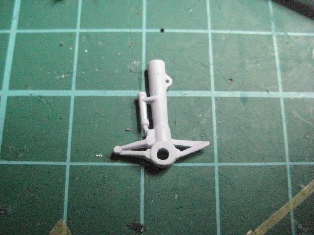

The progress made in the past week. Turned main gear into soemthing more interesting

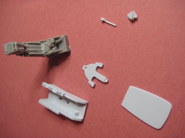

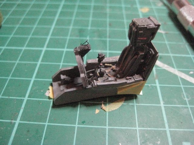

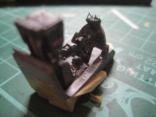

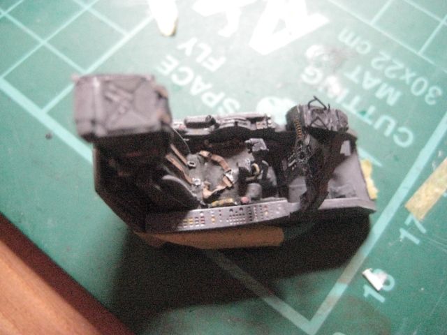

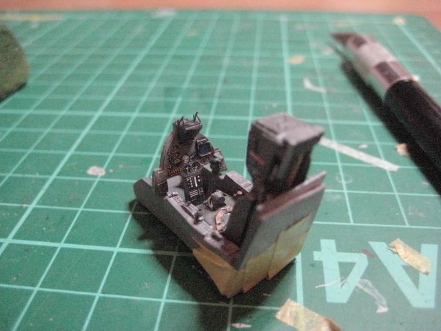

and did some scratching in the cockpit on the bulkhead, added PE consol and IP, scratched a throttle lever and new upper part of stick. Decals are cut from the kit sheet to ft onto the Eduard IP. Turning this lot
into this...
Next up detailing the Aden cannons and other weapons and stores....or shall I close up the fuselage :hmmm:??? ...very nervous about that after all the work to get to this point...just hope it fits !!!!

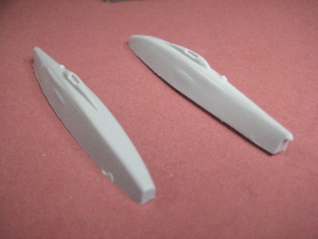

I took a long time getting my Aden cannons to look the part. Thanks to Nick Greenhall for some excellent photos of the real ones and his brilliant renditions too. Thanks to the guys here as well for their help
Corrected overall shape, especially around the muzzles, drilled out and shaped the rear end and added a bit of strip inside for pull handles. Drilled out the holes behind muzzle (did them “handed” until Nick G kindly pointed out they weren’t). So filled and redid one of them. Bit of brass tube up each muzzle for barrels. Couple of smaller vents between the holes beneath the muzzles and the ejector chute.
New bulges – SAnded old ones off and then I experimented with building them up with either filler and then sanding or making them roughly the correct shape and size in Evergreen, gluing and sanding in situ. The latter worked better for me and looked better (the bulges nearer the shell ejector ports). Scribed some panel lines, used my ponce wheel to add some rivets (can’t really see them yet) and some plasticard seals (or, seemingly, applied sealant by the look of piccies – hence the not perfect shape)
Turned these….
Into these, which I am quite chuffed about….

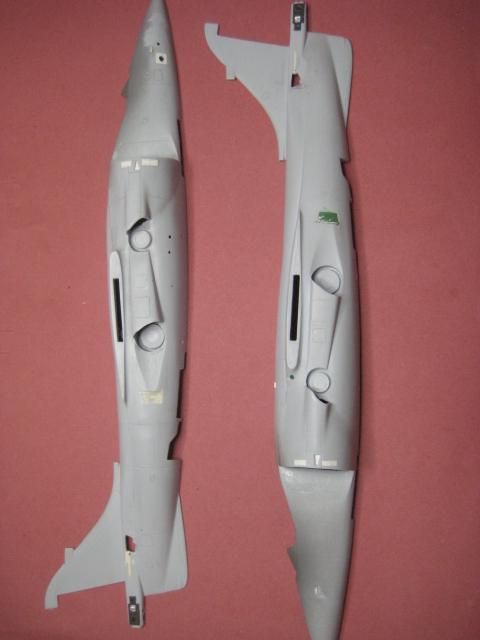

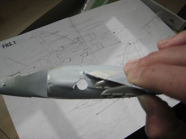

Thought I'd have a go at the vents on the tail and the GTS/APU above the engines next

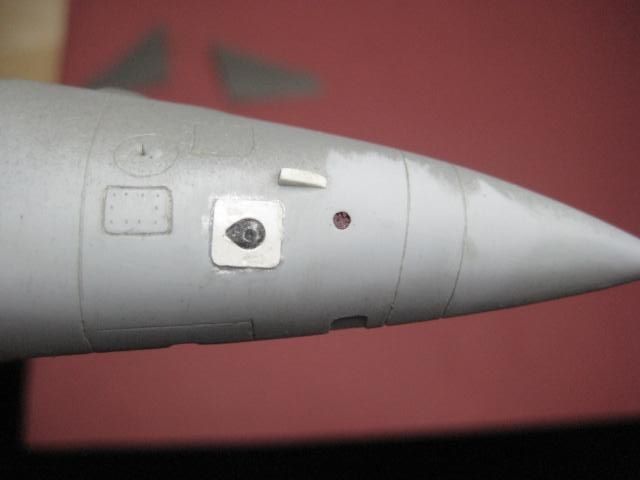

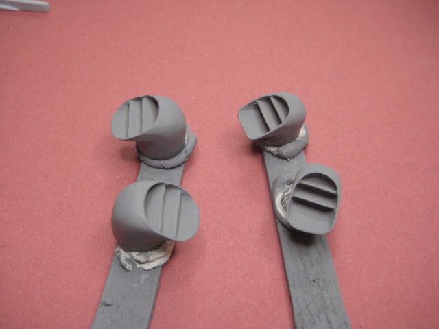

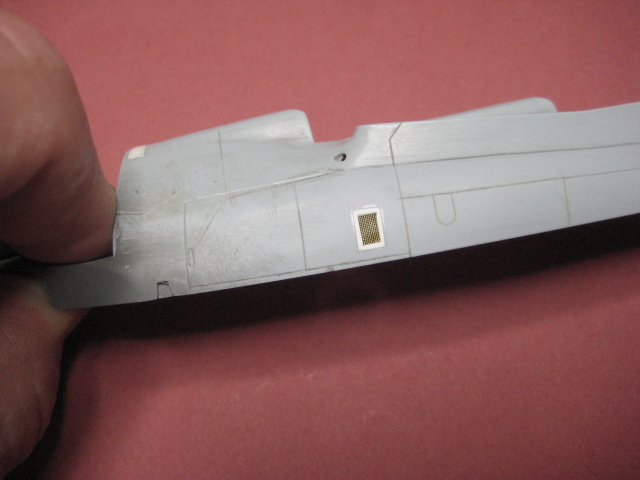

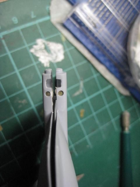

The first two underneath I was quite happy with having thinned the inside wall of the fuselage, which broke at the weakest point (between the hole drilled for the vent and the join).
So patched up with a bit of spare card and filed and sanded carefully. For these two I used a common or garden nail punch from LHS which worked satisfactorily (bit rough around the edges). I set them in place with sparing amounts of Liquid Cement.
This held them firmly but then considering the weak area, the sanding around the join down the line and masking of the vents (don’t want a buildup of primers, paints etc. clogging it up) decided to hold them in place and brace the area with some rod, built up with some dissolved putty and fixed with Liquid Cement.

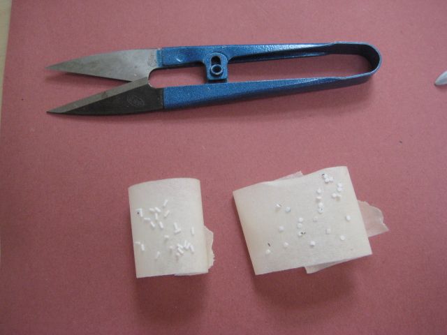

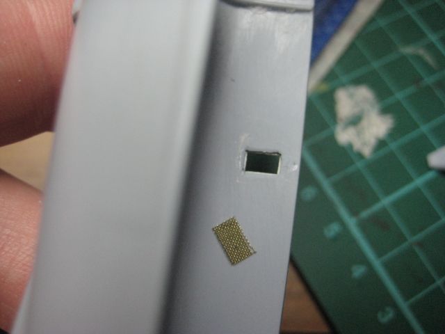

The aft most underneath RCV vent I decided to try a different approach. I used my trusty Shesto shears to cut the mesh in a small square roughly the size of the vent. Trimmed it to make a hexagonal and then tidied it up to make an almost perfect circle. This is possible cos the shears are brilliant. They can cut, if you have your Optivisors on, fractions of a millimeter of the tiny wire of the mesh. With this more accurate shape and size I was able to push it deeper into the hole and held in place much more solidly by sparing amounts of LC. A touch did run onto the mesh but not so noticeable to worry me.

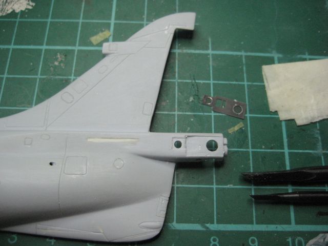

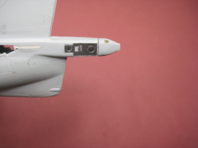

I started on side to “chase” into the plastic to recess the Eduard PE tail fin bits - if anyone has a good tip on doing this I would be grateful. Wish I hadn’t as could probably make my own now I am a vent expert (not!!). So will decide whether to fill and sand or use the Eduard (erring on the later as drilling etc. into the filler might be an issue (Could LC some shim in there instead… :hmmm: )
Just spotted – Is there an RCV vent on top of the rearmost point of the tailfin??????

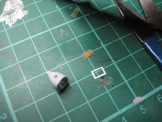

Decided to do the upper GTS/APU vent. I cut a hole in some 5 thou just smaller than the aperture cut into the fuselage to act as a frame or surround for the vent. Then cut carefully around the hole to leave the frame. I fixed this in place with sparing amounts of LC, so not as to melt the 5 thou into a soup, so there was an internal overlap to the aperture (See picture above).Then cut an accurate rectangle of mesh with my beloved shears to fit into the vent from the underside.
Again held in place with LC. I did get wary and reinforced two sides of the vent with shim LC’d in to hold it firm. I might well make a small box under the whole thing – not sure on that one. Looks ok from the top (mesh looks wonky here but is more square in reallity).

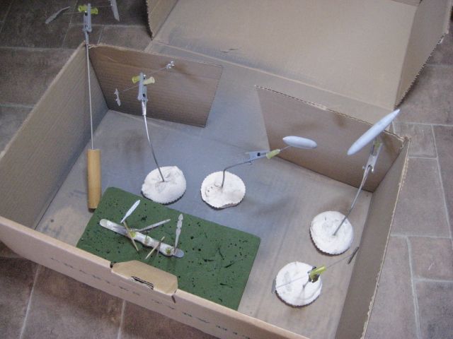

To have a break from vents I cleaned up the Pavla nozzles and cut the vanes back a touch inside and thinned them a bit. They are primed and ready for my new toys – My first selection of Alclad when it arrives!!!! (Thanks Paul at Little Cars)

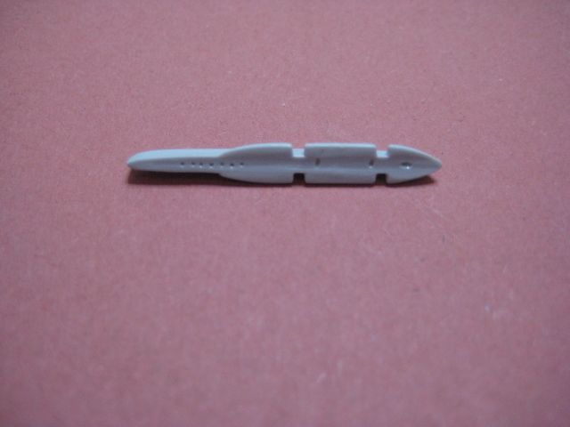

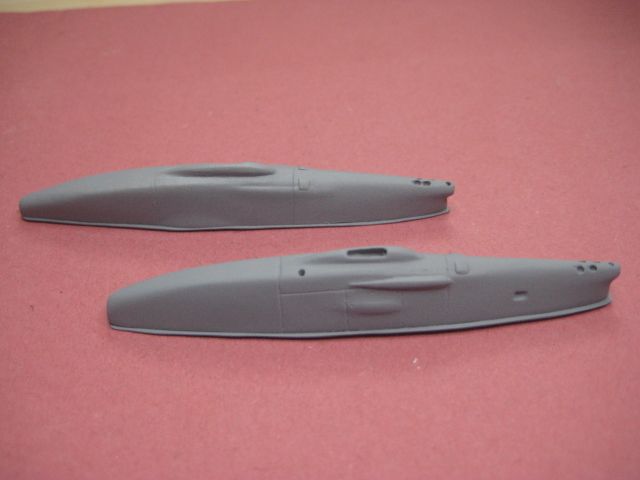

Putting off doing the tailfin vents I fashioned a centerline pylon from a spare kit (hope the Pavla ones are up to the job)

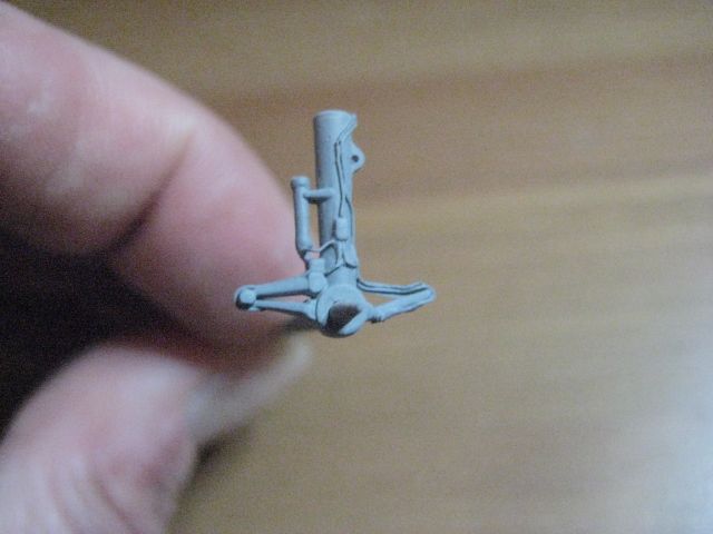

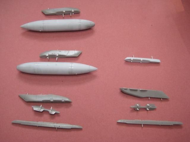

Drilled and pinned up all my pylons, mounts, rails etc. Think this will make them a bit sturdier and means I can take them apart and put them back together to paint etc

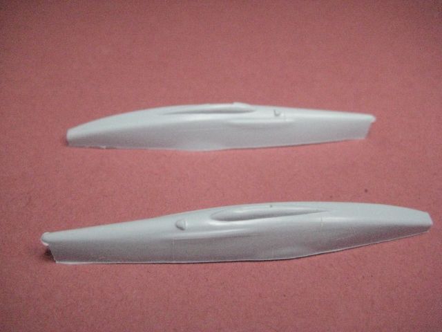

Scribed some detail, including rivets onto the drop tanks
Fashioned and added 20 sway braces to the mounts (after making them too big, trying to trim them, bu@@ering them up and redoing them!)
Then remembered that RichF had an issue (here) with the Pavla pylons not level. I checked and indeed the outboard Sidewinder rail downs point below the horizontal. I sanded (overdid one and had to add a shim) but now think they line up ok (although the picture suggests otherwise! Will have another look)
All that lot is now primed and drying in the gallery
I bought 2 micro chisels as advocated by Nigel Heath. They are great and in the hands of a craftsman (rather than a ham-fisted oaf) would be wonderful. They do a great job of chasing into plastic (and fingers) but after tidying my first effort on the port tailfin did an agreeable job on the stbd. Drilled through and set in the PE with some CA and then ran liquid cement around them – they need a bit of clean up but with do when put the fuselage together.
Cut holes for the moving tail plane and drilled through to connect the two tail planes. One side is 1mm brass tube the other side .8mm. when the fuselage is shut I will push through both bits of brass and CA the other tail plane in place rather than try to locate the two ends blind (glad that occurred to me!)

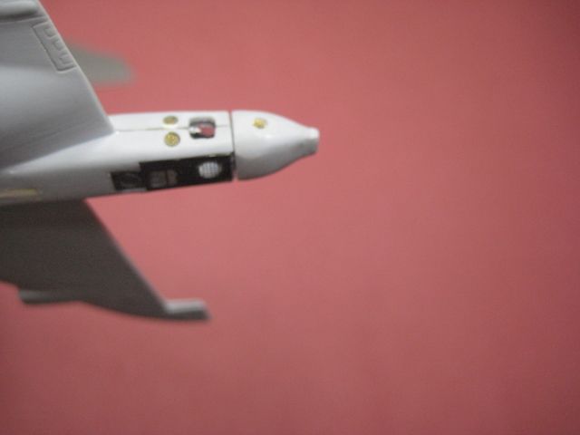

Lastly, fit and the little window I had fabricated for the camera and fit the camera – needs a tidy up but will wait til all has set.

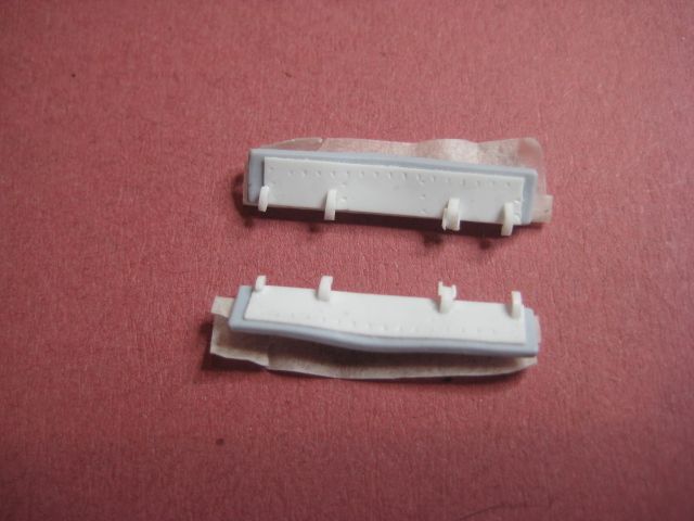

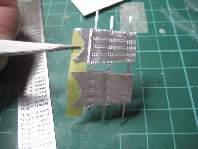

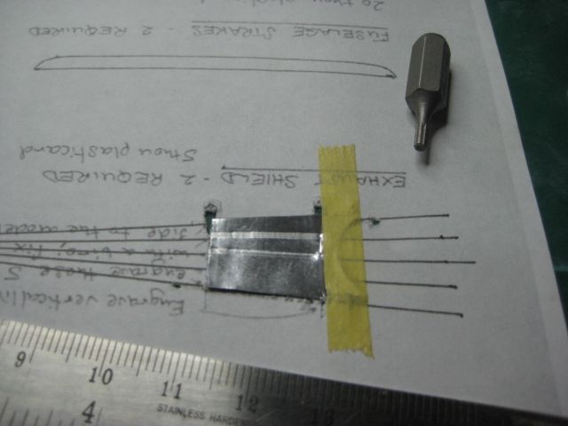

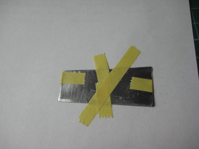

Decided to do the defelctor plates. Ummed and aarred about hoe to do them and decided on wine bottle foil. So, using Nick Greenhall's excellent build notes, fashioned a couple. Used small hex head bit from the "big" tool box to scribe the lines on the plates, my scriber to add the rivets and foil strips CA'd across the back of the plates to act as the fastner brackets when the time comes to fit them in place. They are quite flimsy so may add plasticard to the back to reinforce.

Impressive work with the chisel!
How do you know the depth? (to cut with)
