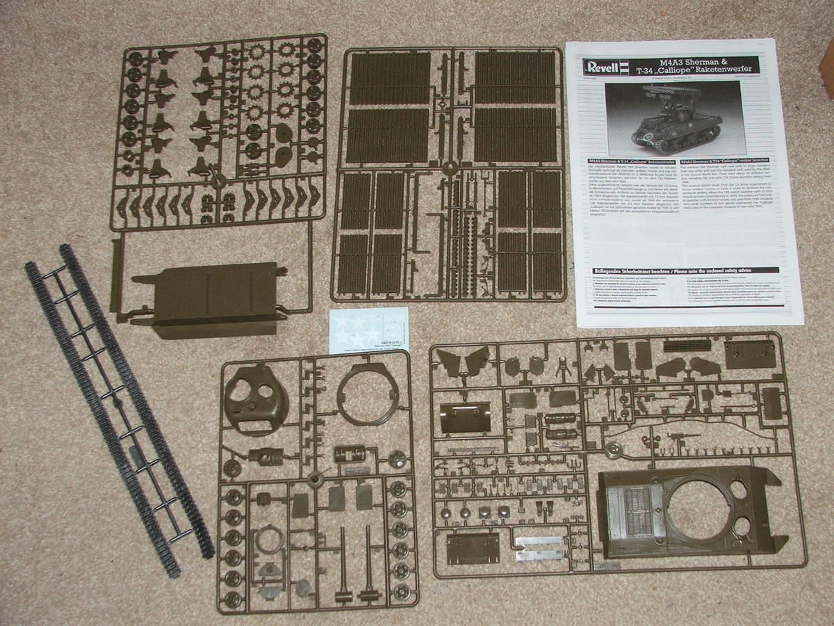

I picked this up in ModelZone a while ago as it was on sale half price... I felt it would have been rude not to buy this kit for a tenner! So here is the box:
and here is the obligatory sprue shot:
Just for once, I'm not going to complicate things by adding lots of extra accessories or customising it - this will be built Out of the Box. OMG how will I cope? I'm sure I'll manage some way to make life difficult for myself, its just the way I work!
Now I am a total novice as far as Shermans go so please be tolerant with my mistakes :) For starters, how accurate is this model from the box? From what I've gathered in the minimal research I've done is that there were not many of these conversions made and were all used by the US Army. So is there anything else I need to know before embarking upon this expedition into unfamiliar territory that is WWII US Armour?

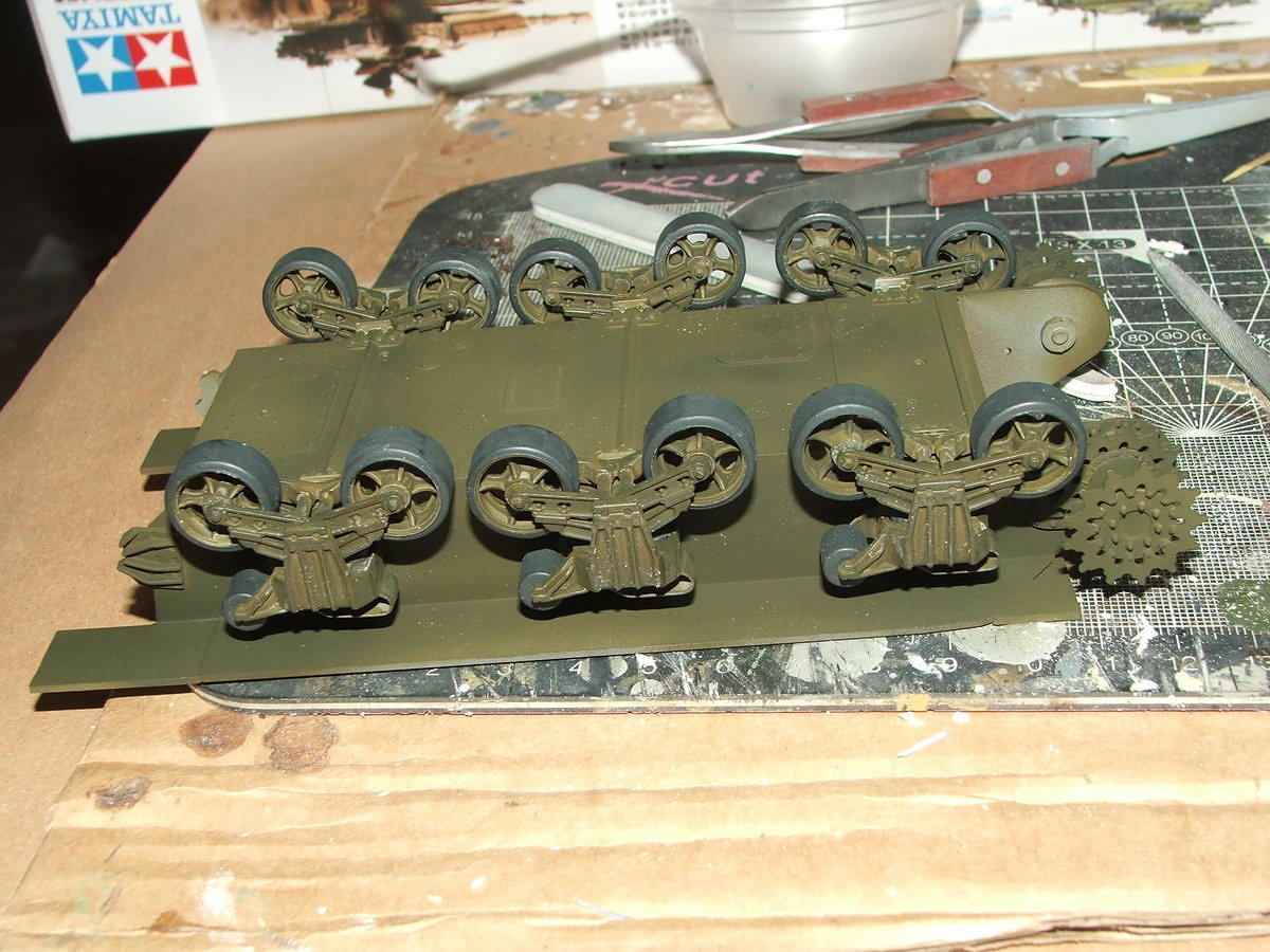

First off when building a tank is of course is the road wheels:
Now I have a question - those "spring" like things on the top of each assembly - is it s spring and what colour shoudl it be? I've painted them olive drab for now but I couldn't see if they should be another colour - well apart from "mud and dirt"!
Next is the base of the hull with the roadwheels attached and olive drabbed...

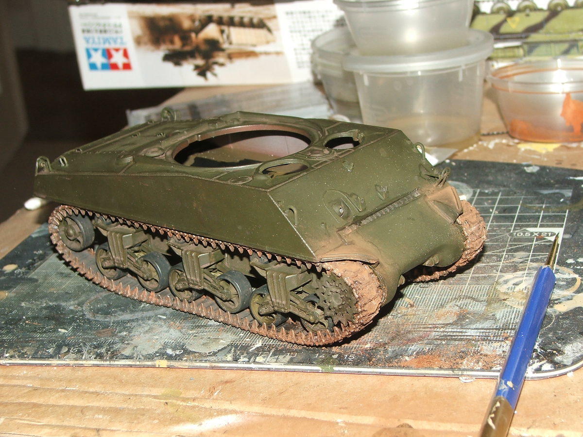

Been a bit of a slow week with lots of little bits of progress, such as adding bits to the hull and applying some weathering to the front tracks
This was done party through a minor cock up. I decided to put some lead shot in the front of the hull to give it some real weight as it had a habit or riding up on the front suspension because the tracks are so rigid. So I poured some slightly thinned PVA glue over the lead shot in the front only to discover about 15 minutes later that it had founds some small gaps in the front hull and seeped out into the tracks... So while clearing this up I realised it was a perfect opportunity to add some mud to the front tracks as there was already PVA glue there to fix it...
To try to fix the track problem I did take the off earlier in the week and leave them for abotu 3 days clamped to get a decent bend in them for when the went over the drive sprocket and return rollers. I will still need to add some glue to the upper return rollers to fix the tracks onto them as they should be. Overall though, the weight does seem to have helped.

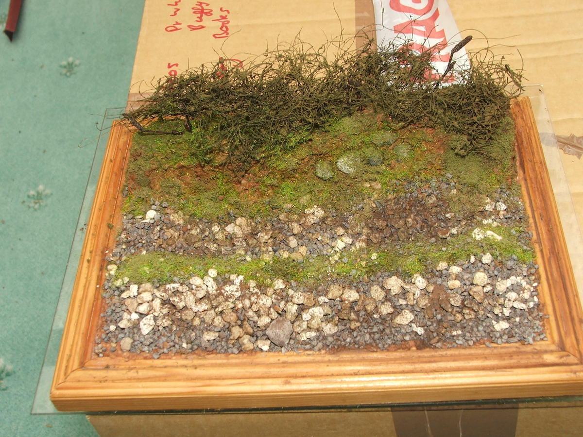

I had knocked together a bit of a base yesterday:
but I think it might be a bit too small to do this vignette, so I may need to repurpose that base for something else later and do another one slightly larger...

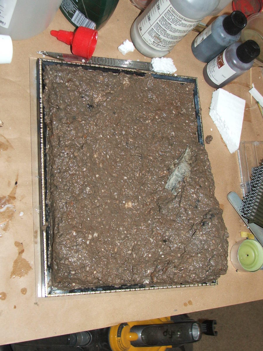

So since I diecided to make the vignette, it needs a larger base, so to this end, I broke out the polystyrene packing and air dough plus some claycrete mixed with artist acrylic paint...

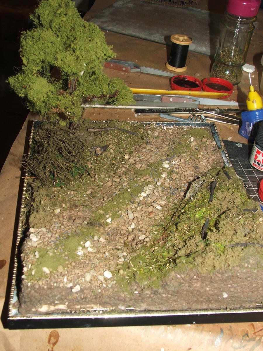

which looks remarkably unpalatable, and rather messy to put together! However, with a bit of rock ballast, grass flock of varying types, some static grass and a scratch built tree, it ends up looking like this...
I sadly didn't take any photos of making the tree, but I used the technique from Richard Windrow's Terrain Modelling book which twisted wires for the armature, with a layer of Tetrion over the wire, painted with artist acrylics, then dressed with Woodland Scenics light green foliage, which is a sort of hairy green flock mat which you rip into pieces to glue to the branches.

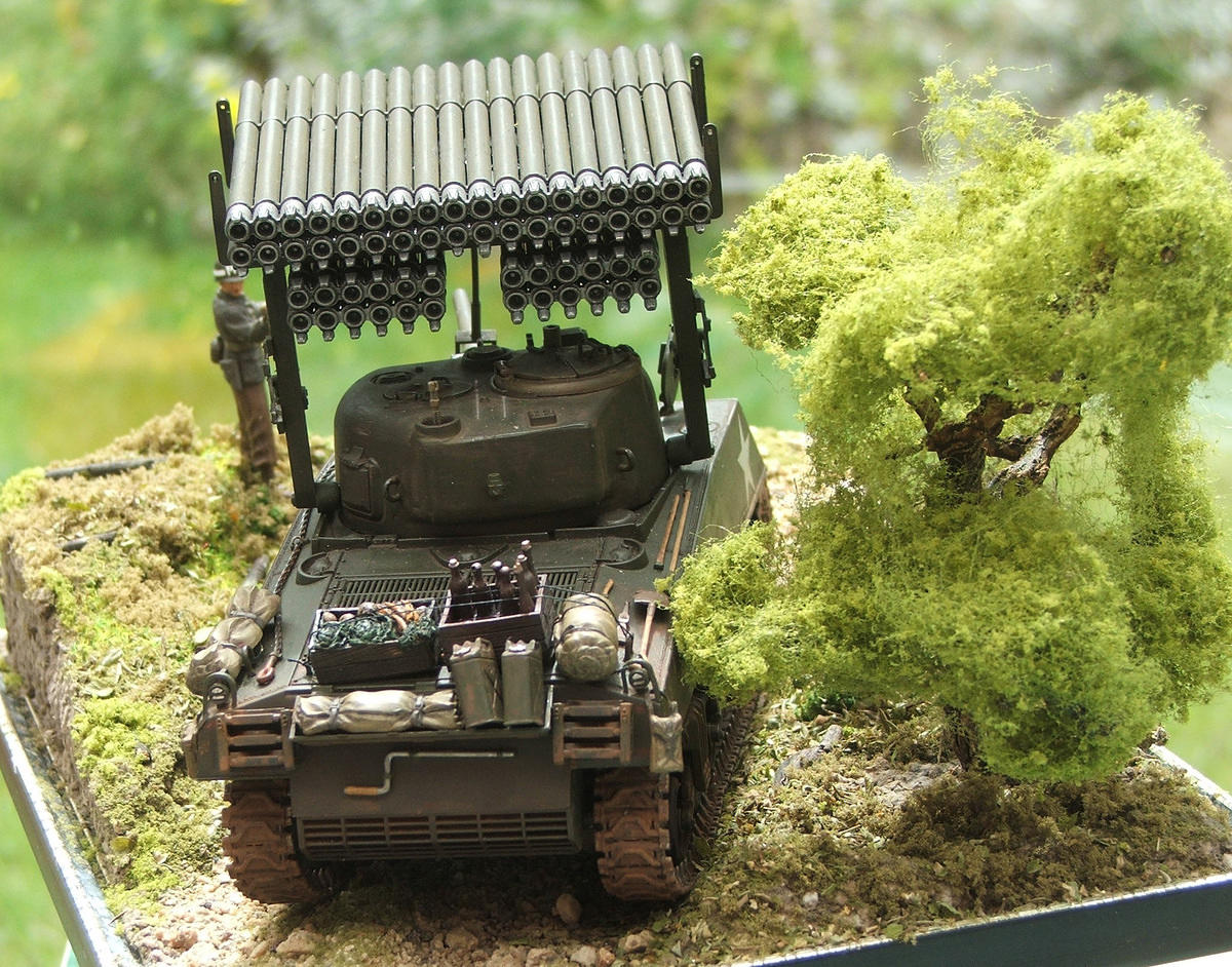

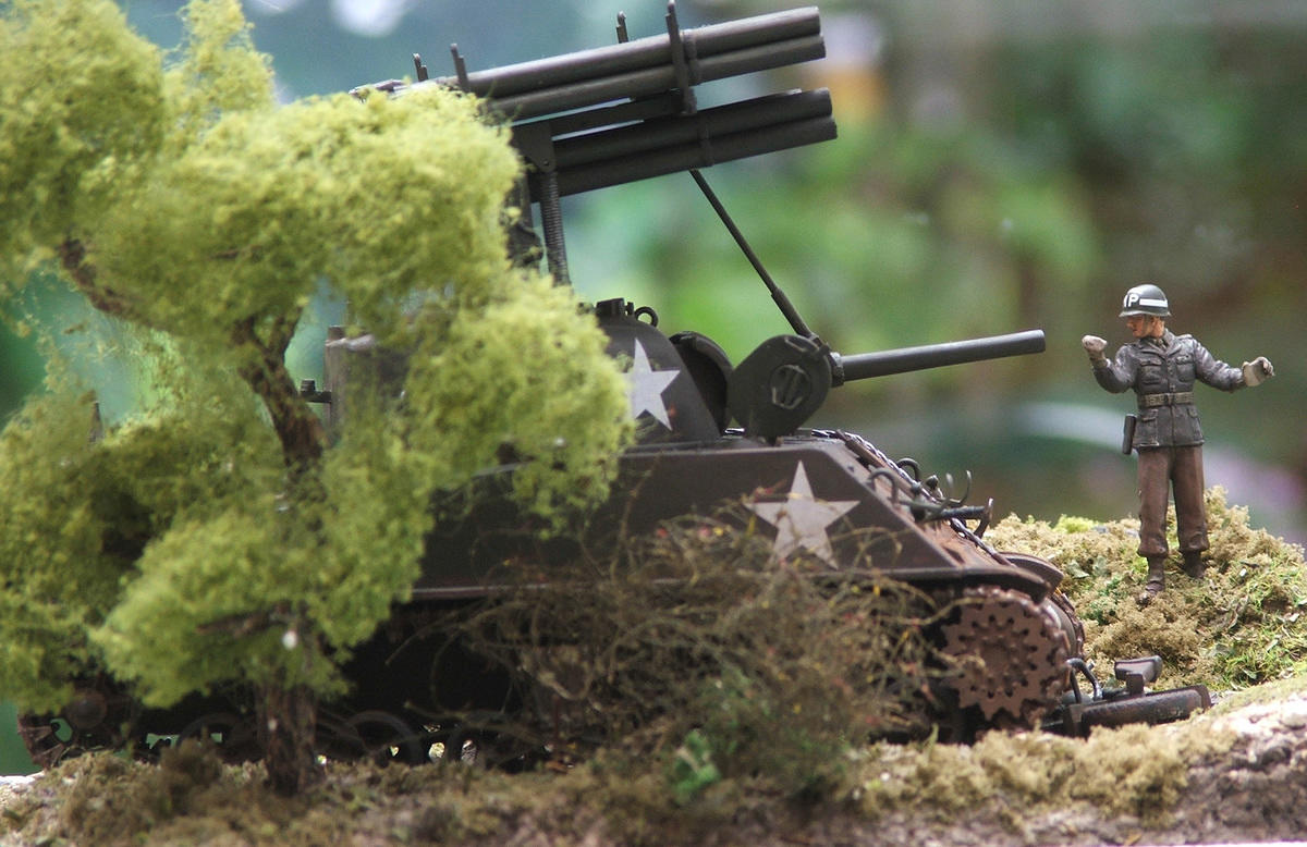

Well I think I am going to call this one finished!
Rockets added and stowage. Pinched some bits from a resin set I got last year that included French-style provisions, including a crate of wine! More mud added and everything placed appropriately on the base...
The Laughing Tanker!
Edit: Oh bugger just realised I forgot the decals!!!
Edit 2: Decals now applied and undergoing weathering. Will post updated photos tomorrow once the daylight returns!!
Edited by Kallisti

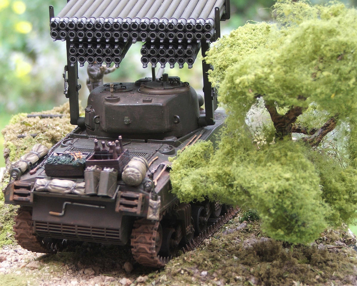

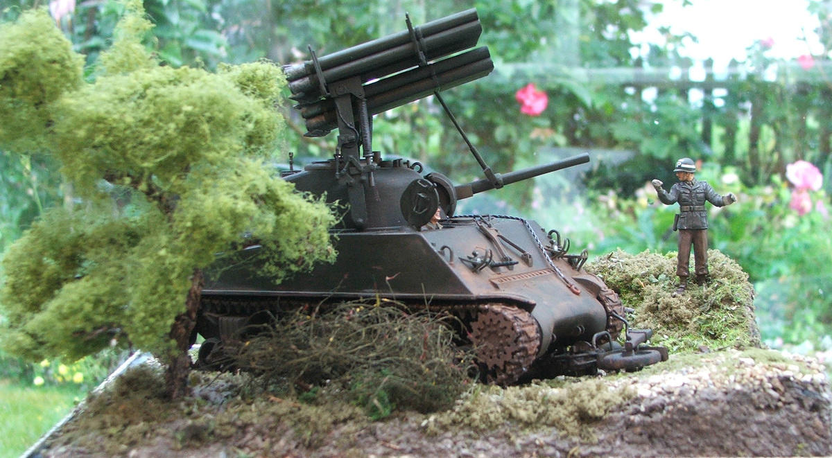

So here are a selection of the final photos, best 4 posted in the gallery...
This was a hugely fun build, much simpler than some of my more recent creations so it was a nice refreshing change, readying me for some more complicated builds to come (particularly the next!).

It looked even better in the plastic at the club last night, excellent work.
