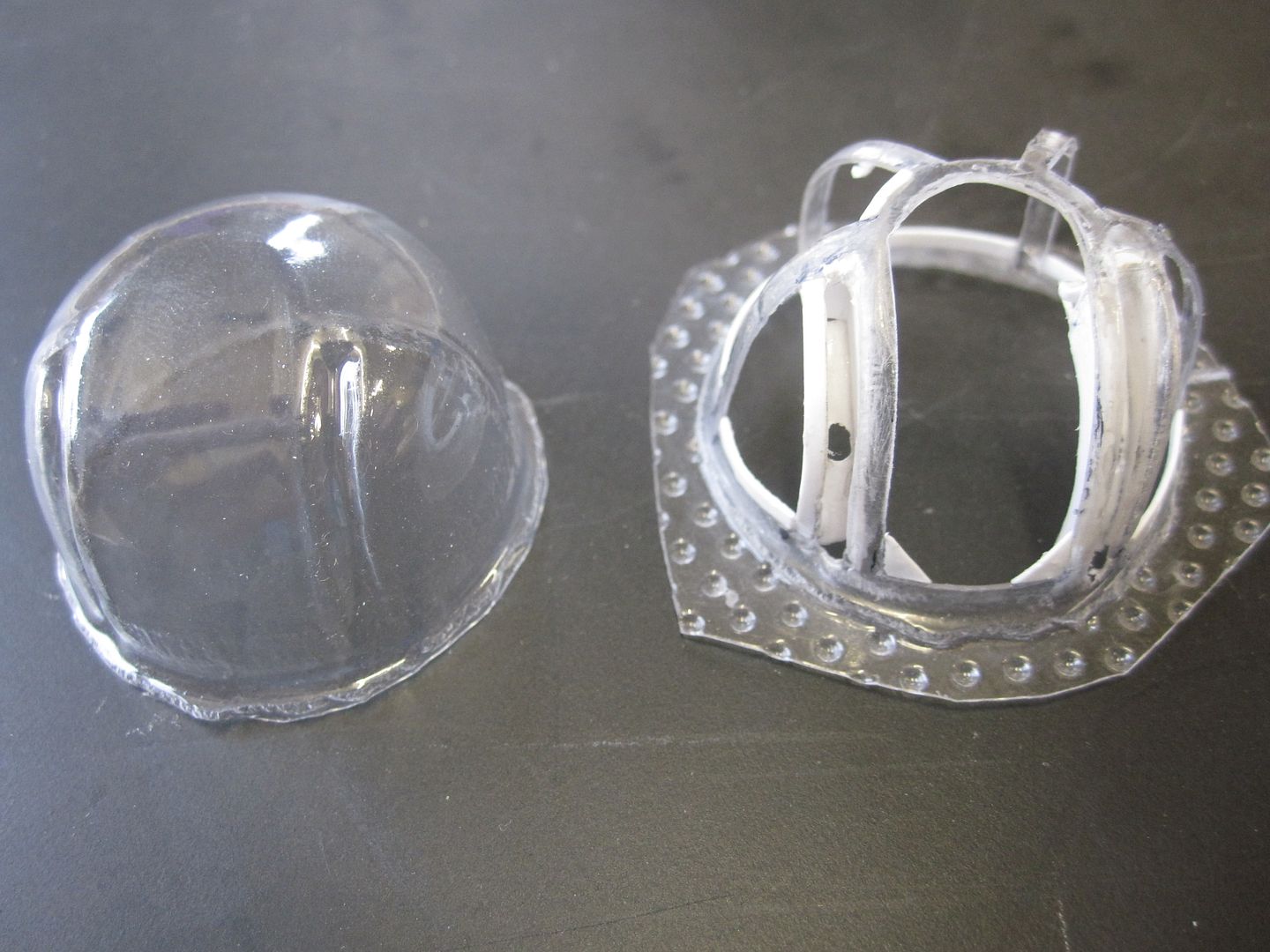

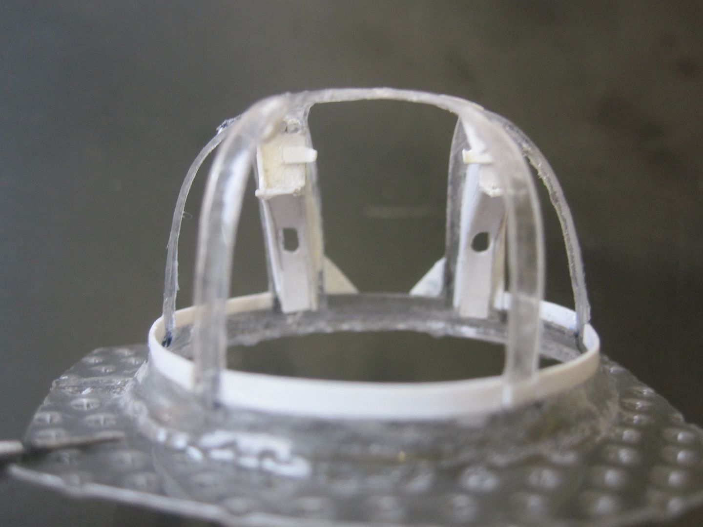

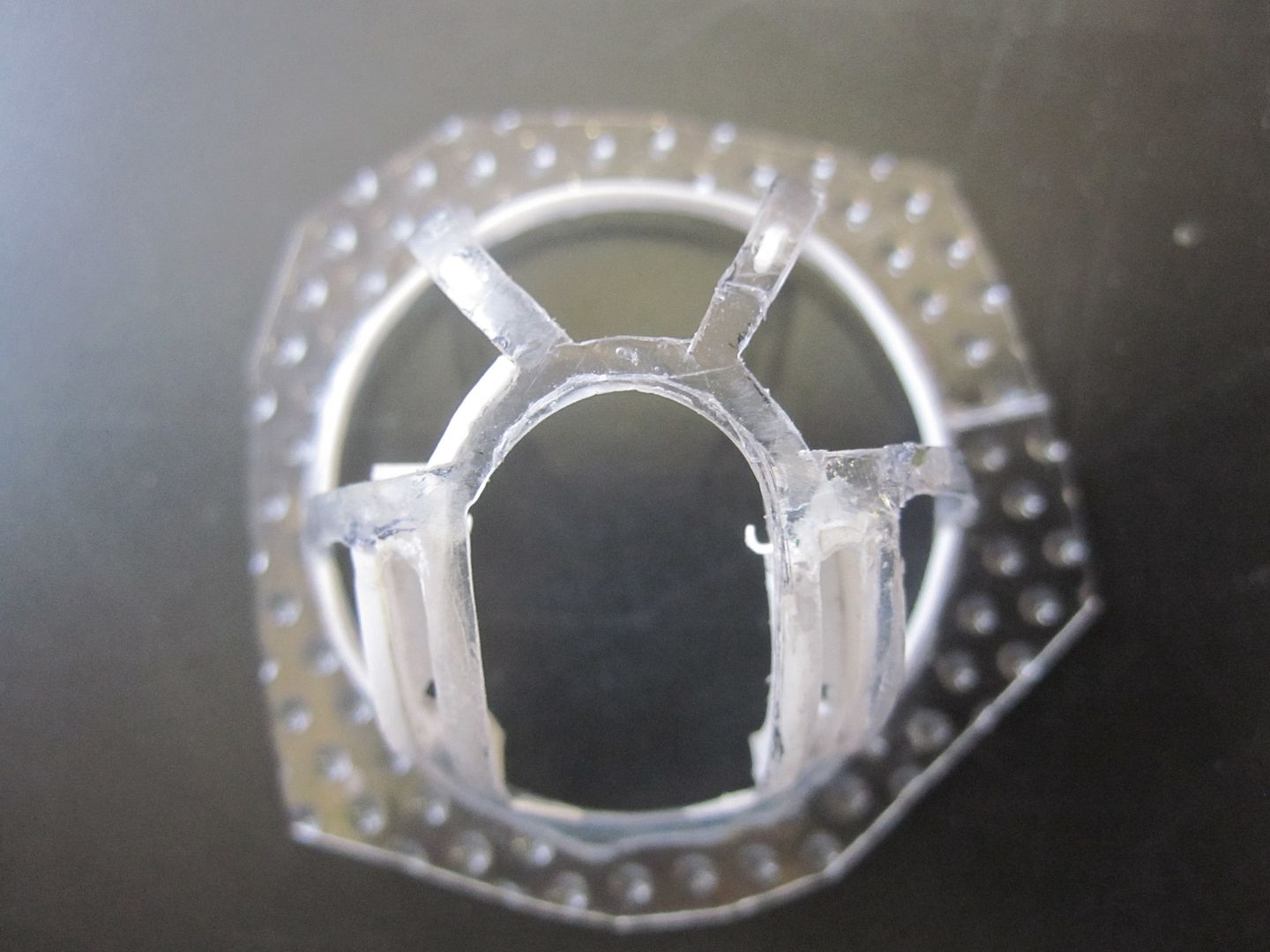

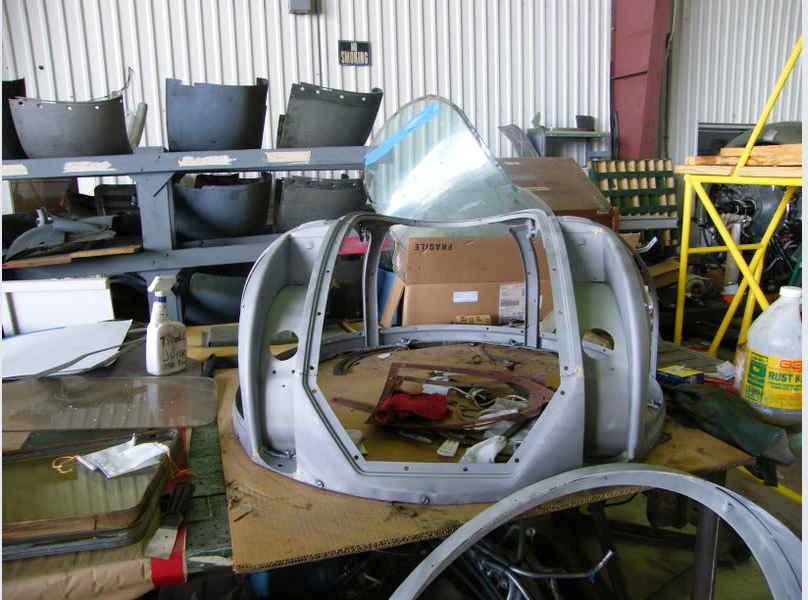

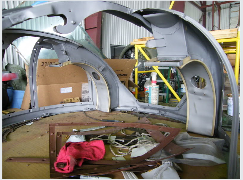

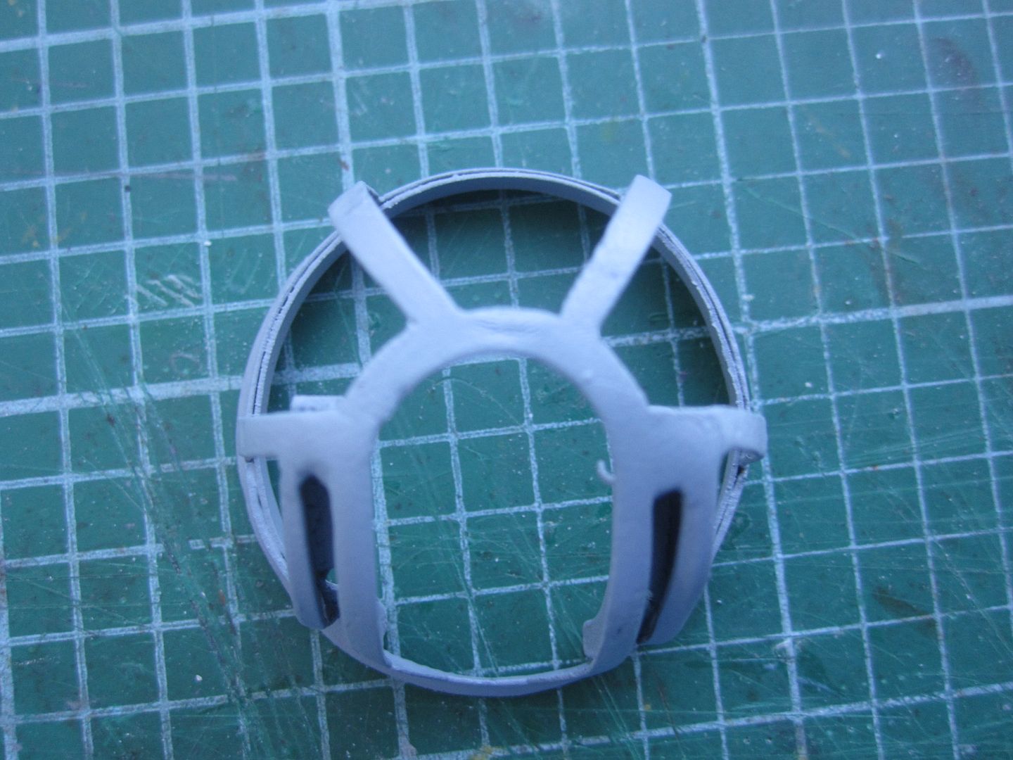

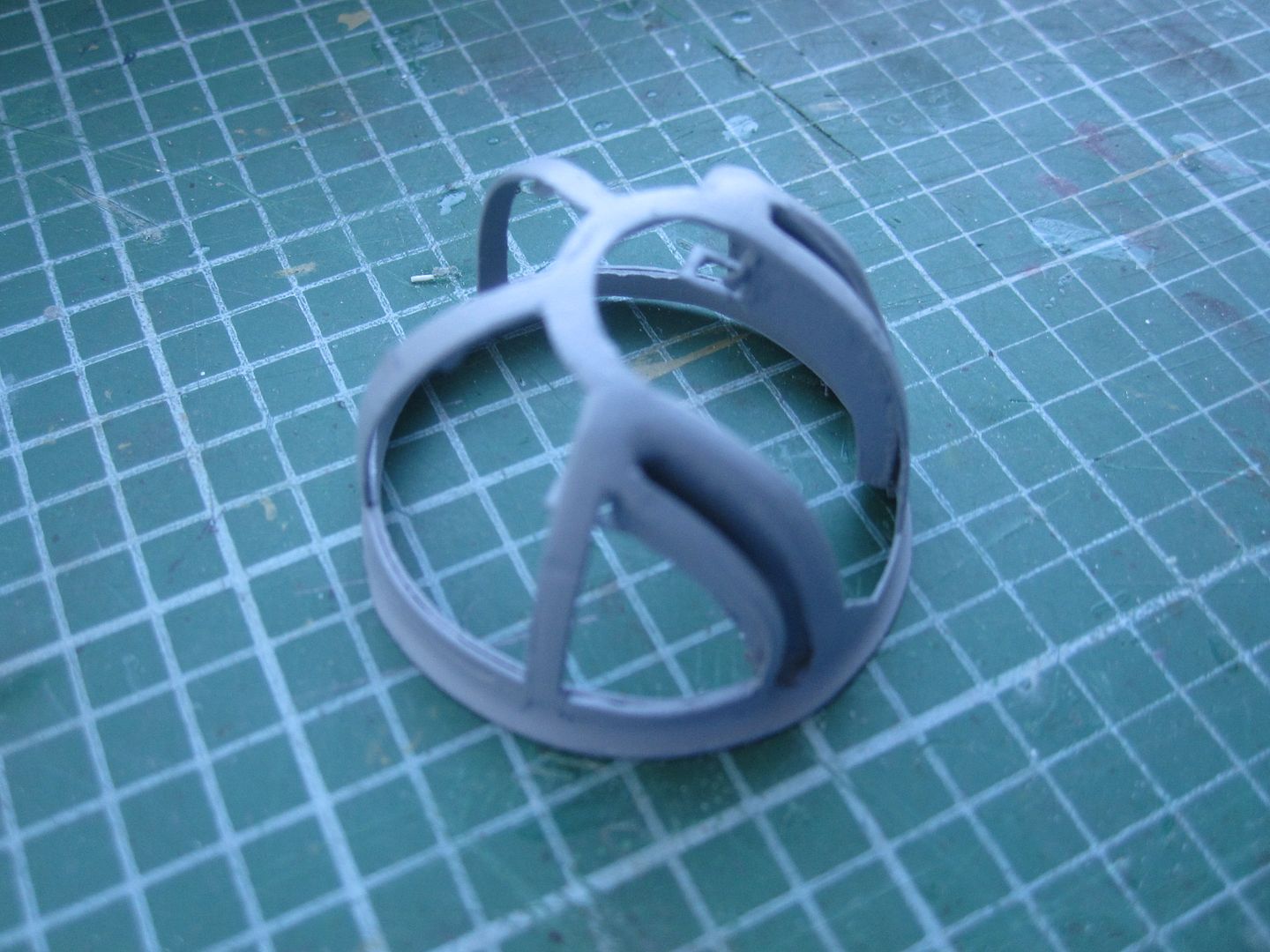

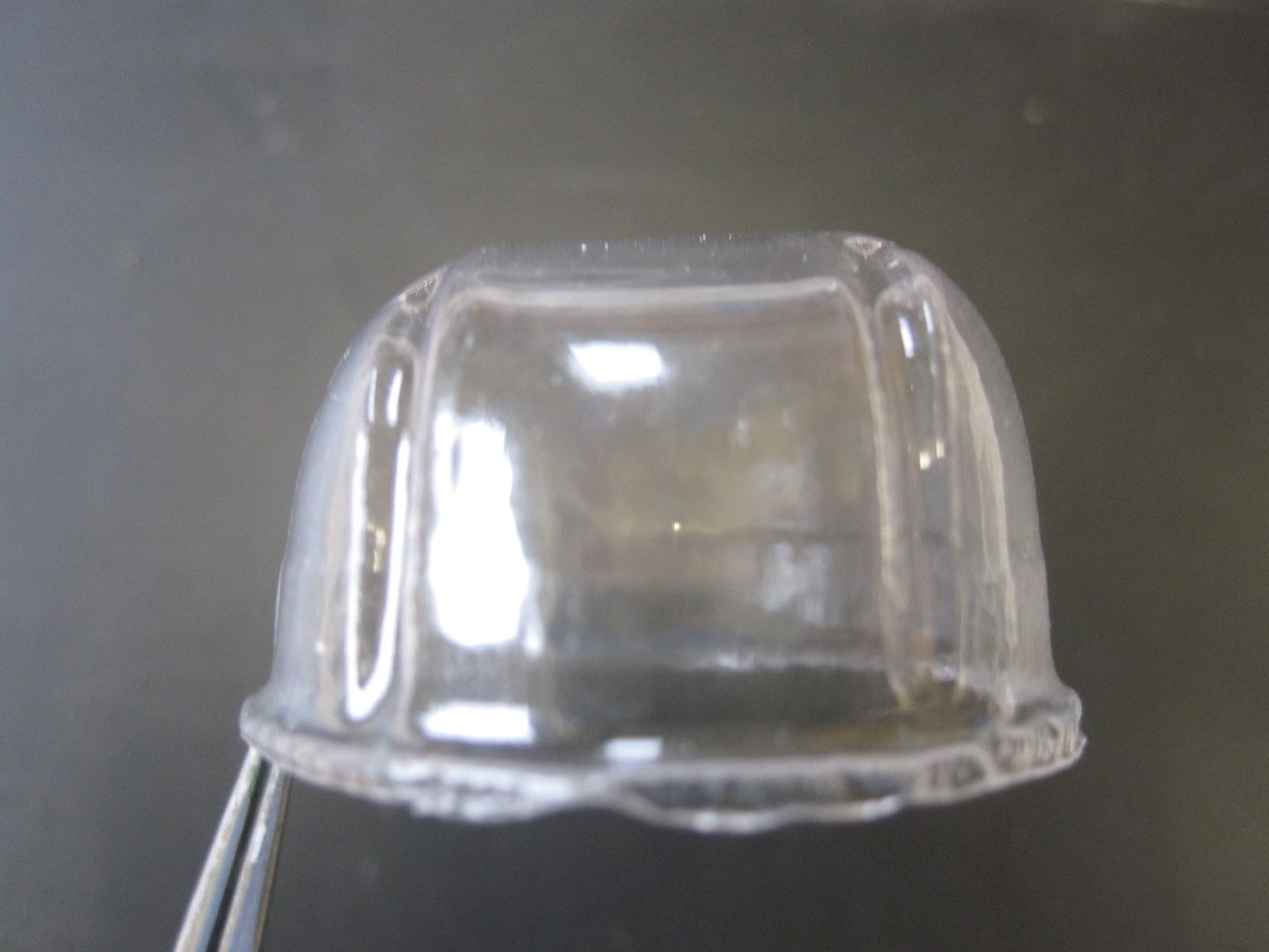

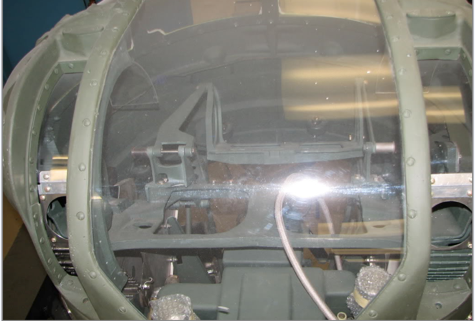

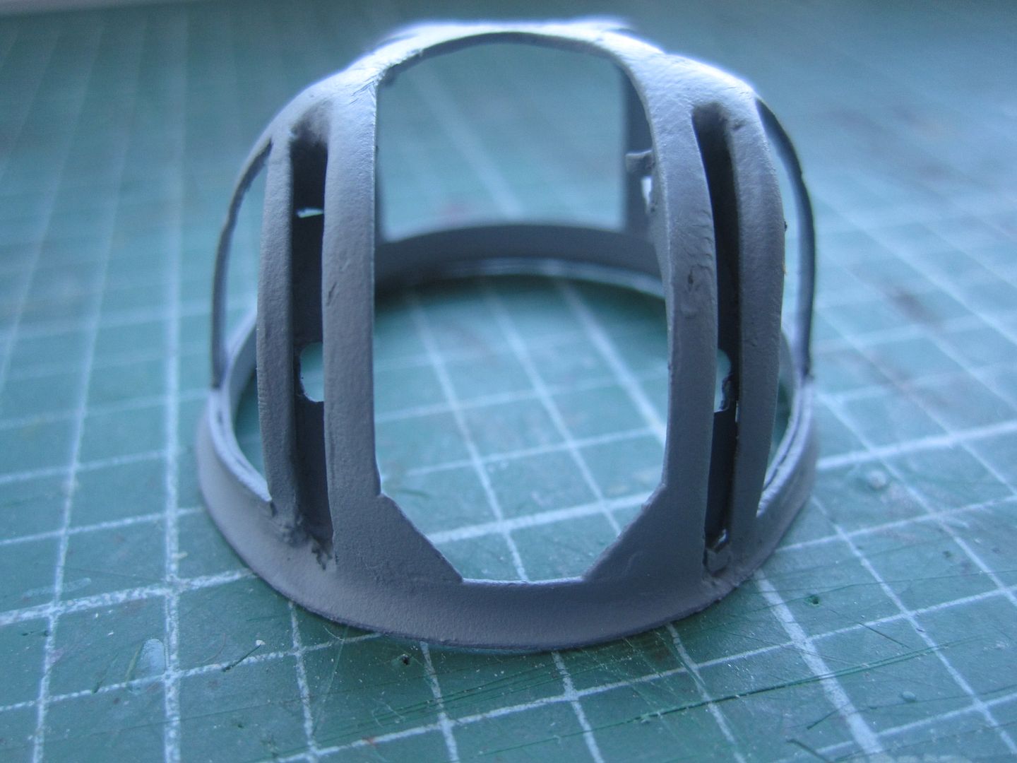

richdlc Posted June 4, 2012 Author Share Posted June 4, 2012 (edited) *update 4th June 2012* thanks for the kind words gents! Hello everyone - I've been working on the next part of the build, the upper turret. The vacform kit provides a one piece transparent moulding of dubious quality. It's not terrible, but there are lots of little trapped air bubbles and the moulded on framework is speculative at best, being offcentre in more than one case. I had a spare turret as a backup, so I decided to try and remove the 'clear' bits & leave an accurate skeleton framework. I could then detail that & attempt to make each window individually from thin, clear sheet plastic. I experimented beforehand & discovered that the sheet is quite flexible and (to an extent) can be rolled-up, bent and curved without it distorting. Of course attaching it will be another matter, and TBH if it doesn't work I'll have to abandon the idea....but I'm hoping it will be OK. Back to the framework: Here's some images from the net of a turret under restoration, showing the shape of the frame and the interior detail (the mountings for the guns and the gun troughs) Here's what you get in the kit - unfortunately virtually unusable - distorted and off-centered Using a new scalpel blade I removed the windows. Then using plastic card I built up the internal detail. I left the backing plastic on whilst I was working otherwise it would have been extremely difficult to keep everything from flexing and warping all over the place as I filed & sanded it down. Where necessary I lengthened, shortened, replaced & re-positioned the various bits of the frame: It's hard to see the details without a coat of paint so here's what it looks like with a coat of primer. It still needs tweaking - a few gaps here and there need filling. But essentially this is the finished frame - I now need to measure & cut out the windows from thin clear sheet & attach them. I will probably use formula 500 canopy glue, wish me luck! More updates as and when Rich Edited June 4, 2012 by richdlc Link to comment Share on other sites More sharing options...

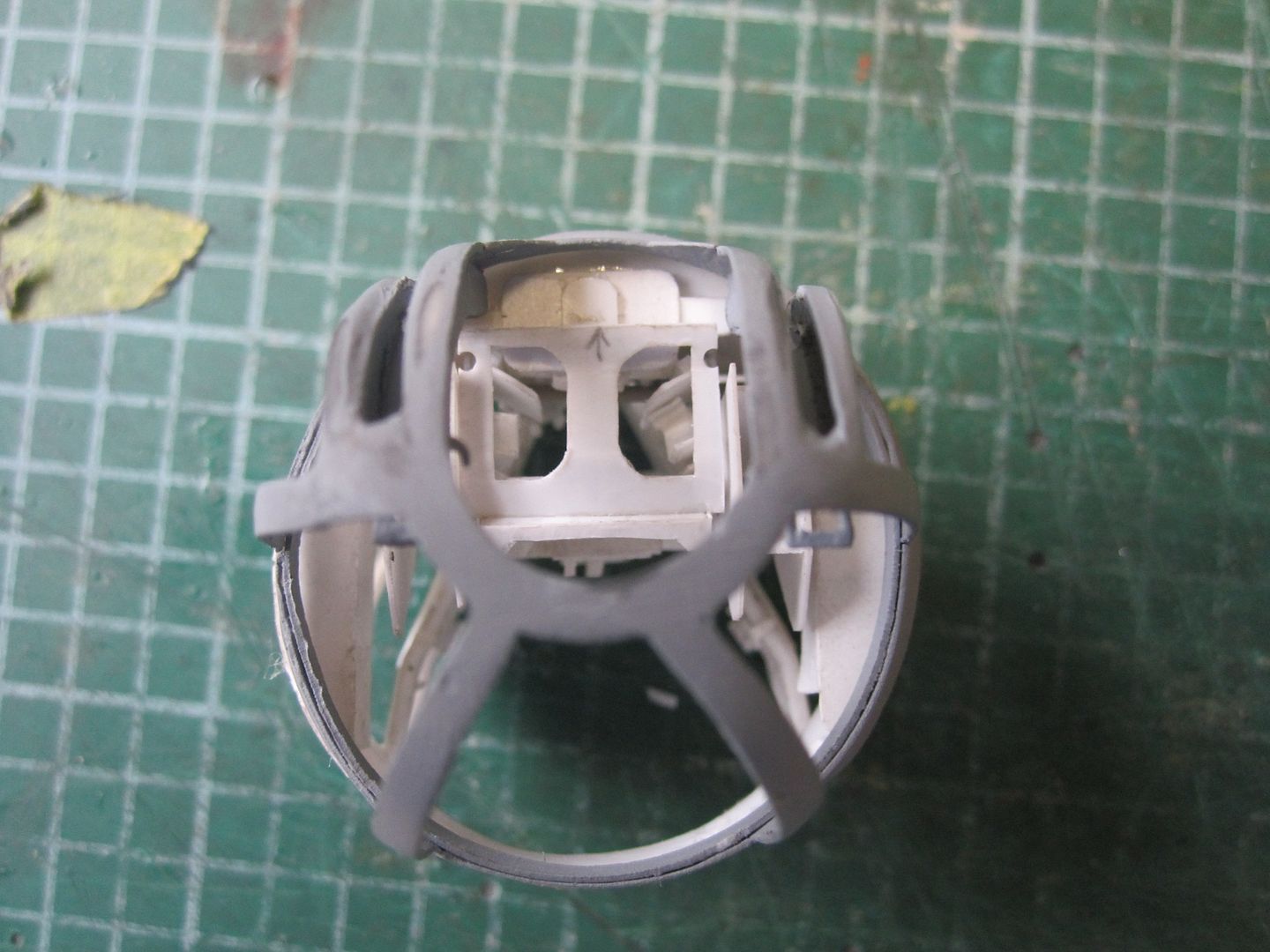

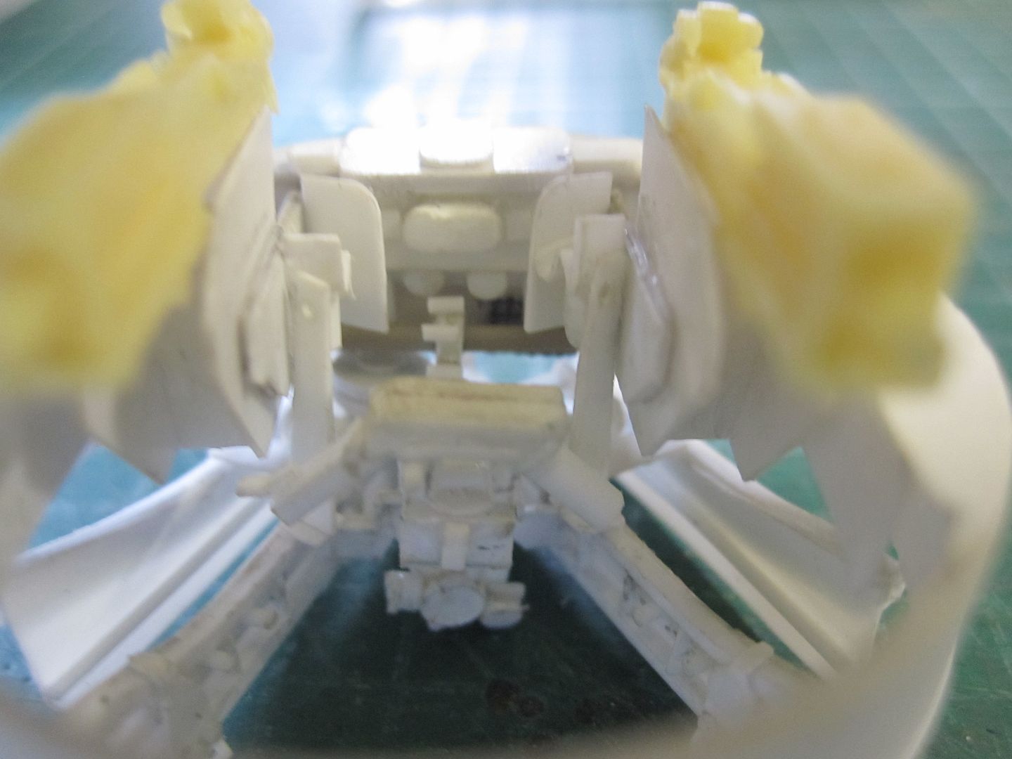

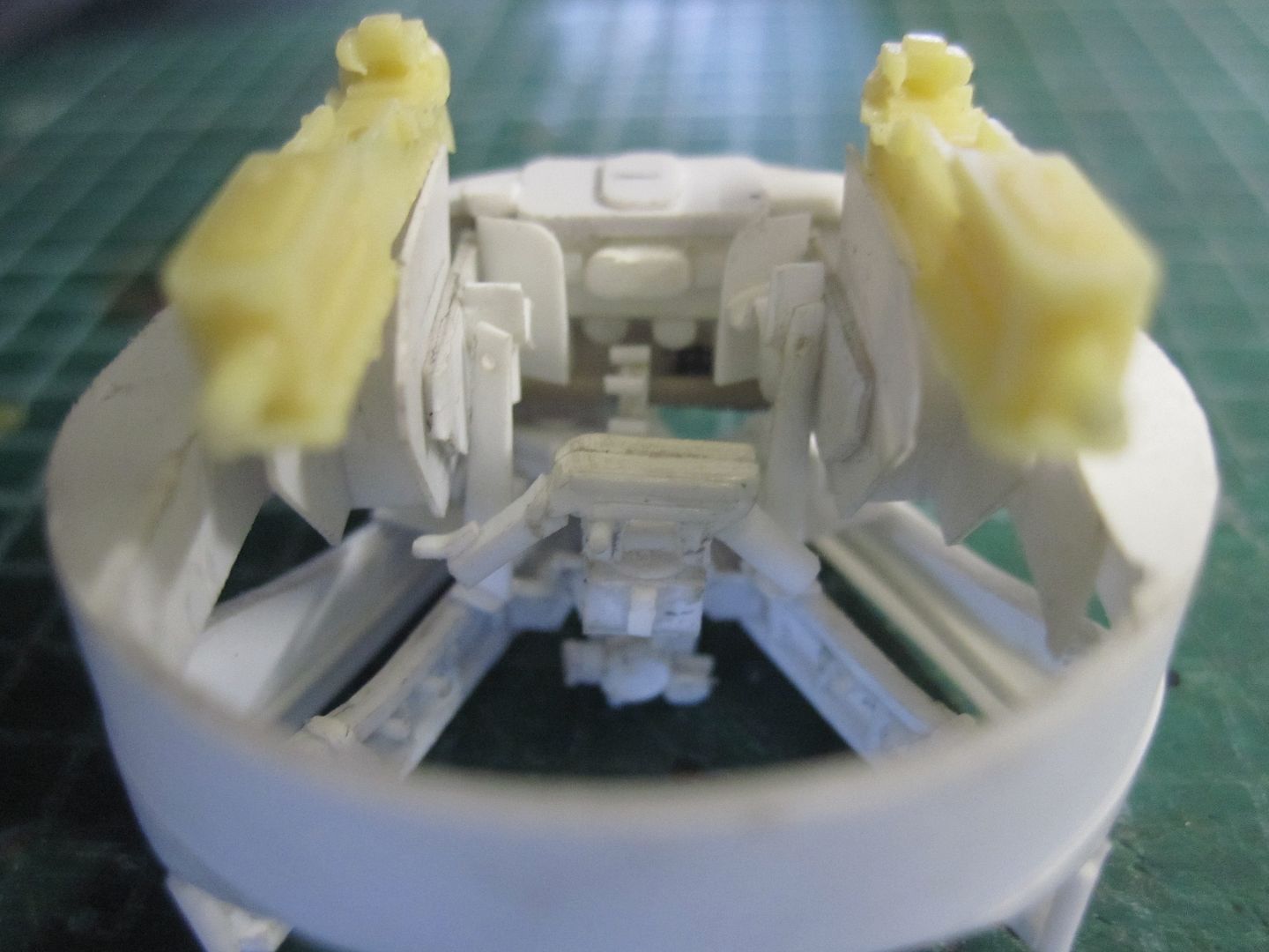

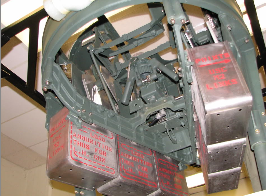

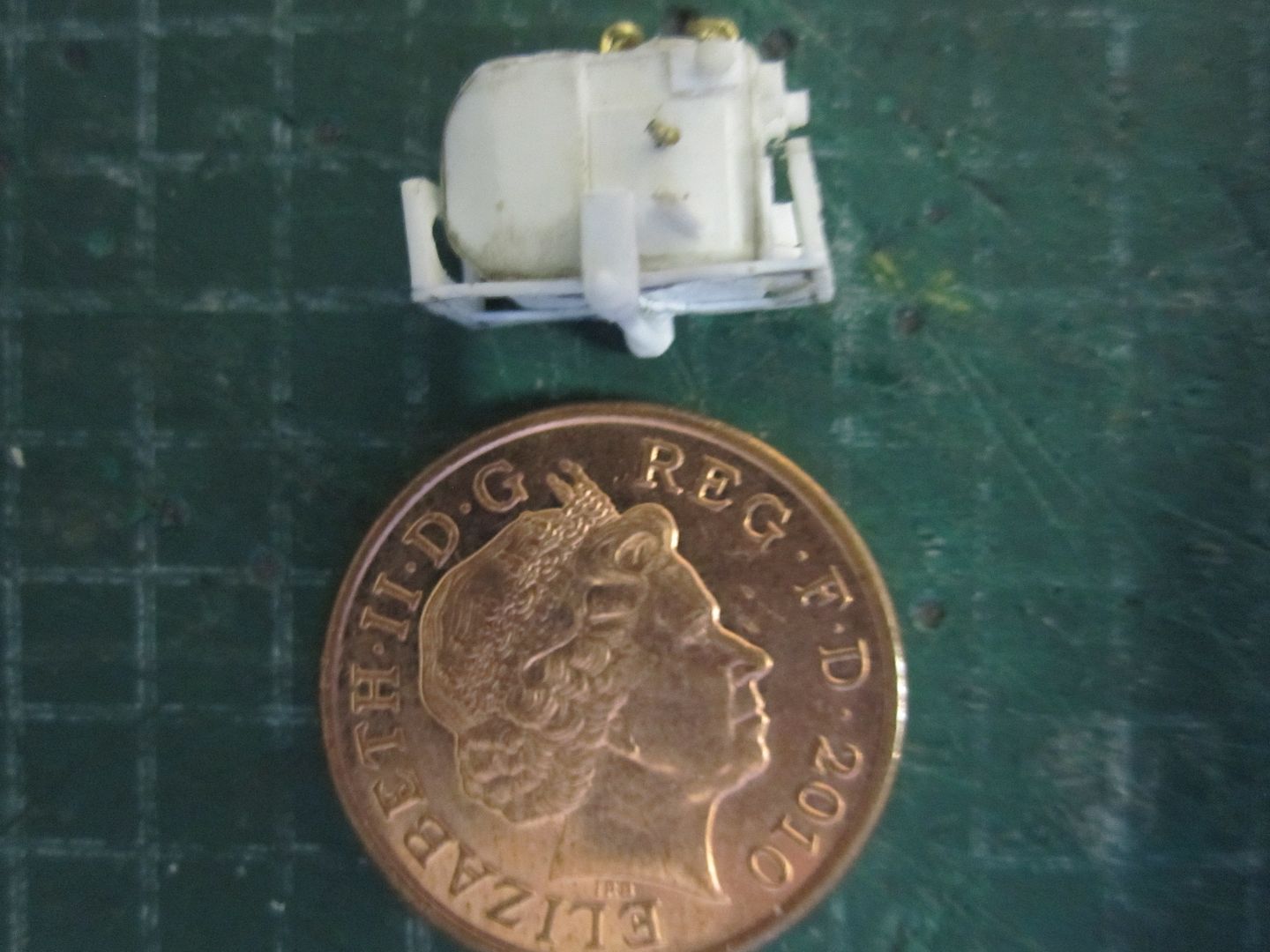

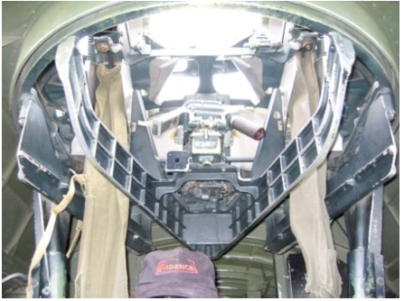

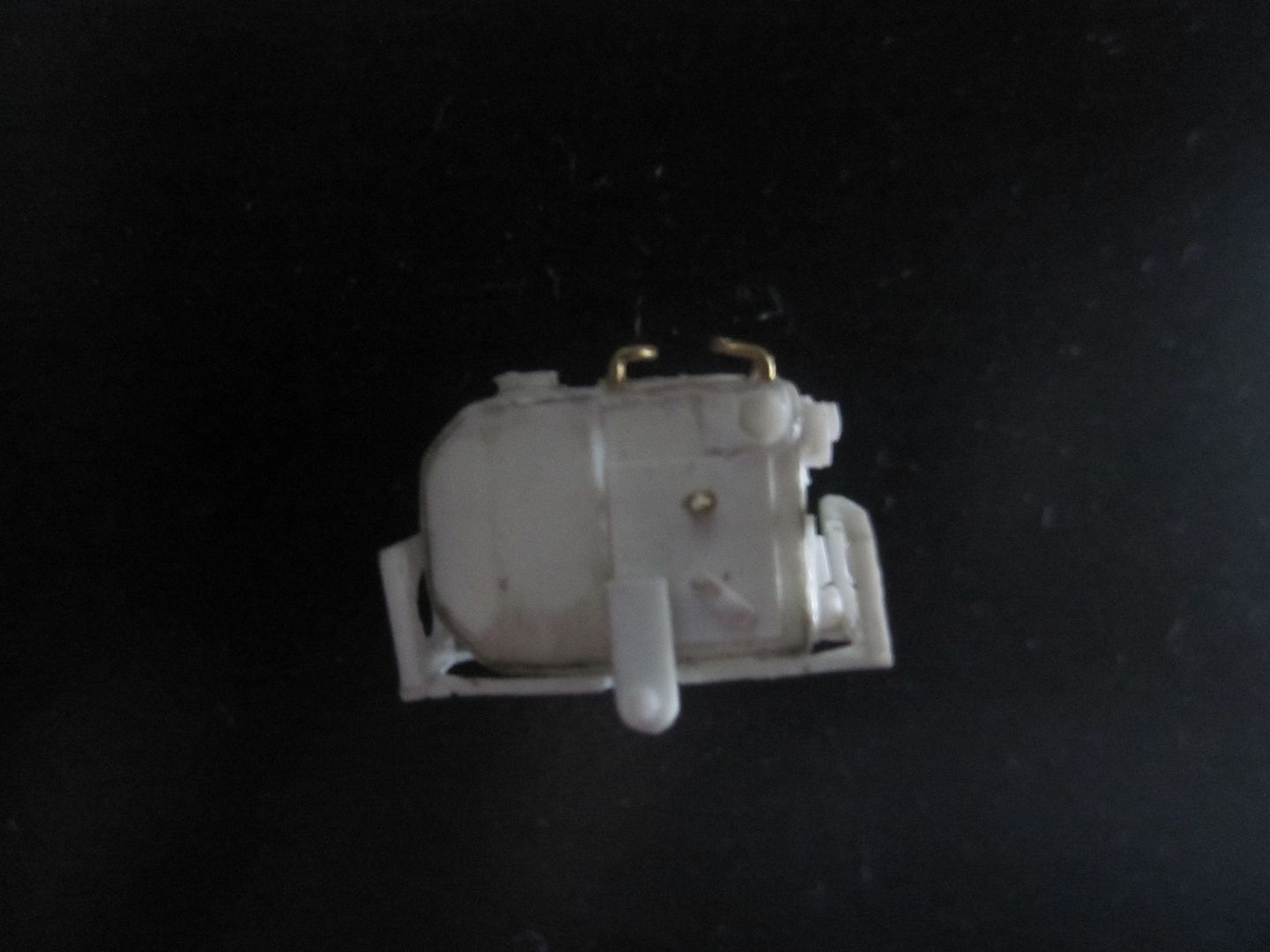

richdlc Posted June 17, 2012 Author Share Posted June 17, 2012 (edited) Hi everyone I've been cracking on with the top turret interior - there's a hell of a lot of stuff crammed in there. Here are some images of the real thing - as always these are strictly for illustrative purposes only. Here's the rear of the inside of the turret, looking towards the nose of the plane - the 'V' shaped part is the rail that holds the ammo cans (3 on each side) - they slide on between the inner & outer rails. On either side of the outer rails are the supporting arms that connect to the baseplate. The bags hanging down come from the shell ejection ports of the .50 cals & are used to catch spent shell casings. In the centre of the pic are the hand controls. Above the hand controls is the mounting plate for the gunsight. The navigator/gunner would stand on the base plate with his head poking up into the turret - the entire turret moves around as he manipulates the hand controls. A different turret (with ammo boxes): Hand controls - below them is the oxygen regulator & hose: Here's the hand controls under construction: and the inner rails for the ammo boxes: the turret was powered by a 2 V motor. There's a load of stuff directly behind the hand controls - I replicated what I could see & made an educated guess at the rest....at least it looks' busy' back there & will no doubt all be hidden haha: The view directly in front of the gunner (you can see the feet of the photographer in this shot as he stands inside the turret) Here's where I'm up to so far. The yellow things are Aires resin .50 cals which I bought in bulk ( I'll need 13 eventually !!! ) close up: also started on the gunsight. Identical to the one I made for the ball turret (seen in this pic) except it is mounted the other (right) way up: The gunsight sits on a complicated hinged platform affair. Here's a view of a turret from head on. You can see the platform clearly. The part in the foreground is a mounting piece for the part in the background. It has holes in it through which the belted .50 cal ammo passes. The part in the background has the gunsight attached to it. Here's my turret from above (turret is facing forward). I have dry fitted the rear platform. I will build the attaching arms & then attach the gunsight: Edited June 17, 2012 by richdlc Link to comment Share on other sites More sharing options...
