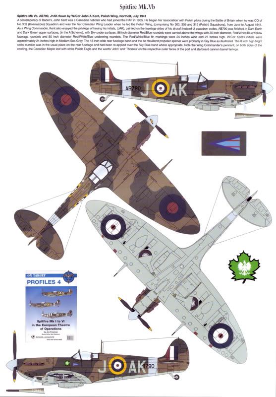

There's a 5-view colour drawing of Vb AB790 J.AK used by J.Kent when Wing Leader at Northolt in the old Profile (no.166) but no photo to back it up,

Here is another profile of this plane:
Better than nothing - I hope.

Thanks for all answers. It's strange that there's no photo. The profiles shown by Rudolph I've already seen (Rudolph thank you). I hope one day someone finds the photo.
So I have to build the plane basing on profiles.

I discovered this by accident while searching for related material. On the grounds of better late than never, if you are still there then I will explain the actual facts about Kent's Spitfires in the summer of 1941.
There is no photograph. The reason is that AB790 is a fiction, a fantasy, a fraud, an invention, call it what you like. It is an early example of making things up and presenting them as fact. It is the imaginings someone that new nothing.
Any serious historian will tell you that it is impossible for Kent to have flown this Spitfire in June 1941, it did not exist at that time. The Northolt wing was equipped with Spitfire Mk IIs in the summer of 1941 and did not receive its first Mk V until September, well after Kent left. Kent did not use his initials at Northolt, he used RF*J as his personal code, and for two weeks after he moved to Kenley.
When Kent took over the Polish Wing at Northolt on 3rd June 1941 he was allocated Spitfire Mk IIb P8189. This was technically on charge with 303 Squadron and they maintained it. Instead of marking it with his initials he chose RF*J, his 'lucky' codes that he used when he was with 303 Squadron. He first flew P8189 on 1th June and on 21st June during Circus 16 he destroyed a Bf 109 with it. That was the only time he flew P8189 on operations. On 22nd June, as part of Circus 18, it was being flown by Sgt Szlagowski when it was involved in a mid-air collision with Mk IIb P8334 RF*E flown by Maciej Lipiński. Both made it back to base and were sent for repair and later served with 306 Squadron. P8189 as UZ*G with which Sgt Wawrzyyniec Jasiński claimed a BF 109 destroyed on 16th August. P8334 was transferred to 306 Squadron on 13 July coded UZ*E. On 23rd July it and F/O Janusz Kosmowski failed to return from Circus 59.
For a week Kent flew a number of 303 Squadron Spitfires before adopting newly arrived Mk IIb P8518 also coded RF*J. Kent scored two victories at Northolt with P8518, Bf 109 destroyed Circus 31 3rd July and Bf 109 destroyed Circus 53 20th July. In July 303 Squadron left Northolt passing their aircraft to the incoming 308 squadron who took over responsibility for P8518.
On 2nd August Kent was posted to the Kenley Wing taking P8518 with him and flew it there still with the RF*J codes and scoring a Bf 109 destroyed with it on 7th August. On 16th August it was flown by Sgt Archibald Stuart of 452 Squadron who scored a Bf 109 destroyed. However, P8518 remained the property of 308 Squadron and it had to go back. On 18th August Kent wrote in his log book: “Returning good old RF J to 308 Squadron at Northolt. Damn sorry to lose that aeroplane, it was a beauty”. On return it was recoded with 308 squadron ZF codes and flown by S/Ldr Marian Pisarek.
As for AB790. It was TOC (taken on charge) at 8 MU on the last day of July 1941. From there is was allocated to 452 Squadron at Kenley on 5th August, three days after Kent's transfer. On 16th August Kent scored a Bf 109 with it. Nothing is known of how it was coded. There is no evidence, documentary or photographic, of how it looked.

if there are no fotos, then there must be descriptions of the plane, or do we have a case that some producer of decals "invented" the plane, and was copied many times by other manufacturers?
Share this post
Link to post
The earliest appearance that I know of is in the Profile Publications series back in the sixties. If there is an earlier version I have never come across it. Since then it has been copied by people who do not question things. If there is a description of it then I have not come across that either. So unless we can find out who is the inventor, and ask them what it is based on, any explanation is speculation. My own feeling is that it might be derived from some private communication, verbal or written, that has been confused with AB790. Perhaps a Spitfire that Kent 'owned' later in his career when in a non-operational post, station commander or something like that. It is highly unlikely that Kent is the source as I don't see him being confused about what he flew at Northolt. One thing for certain, It would not have been very long before AB790 would have been repainted in the Day Fighter Scheme.

Combat Codes does list, in my copy anyway, JAK as used by Kent as OC Polish Wing, Northolt on Spitfire AB790 in 1941. Obviously impossible as AB790 was not around during the time that Kent was at Northolt.
The entries for the Typhoon and Tempest are also obvious errors as they have Kent as Wing Commander Flying 123 Wing, a position he never held. Kent returned to the UK from the Mediterranean in mid-1944 and then commanded No 3 (Pilots) Advanced Flying Unit. In 1945 he completed a RAF Staff College course and and then served at Headquarters British Air Forces of Occupation.
