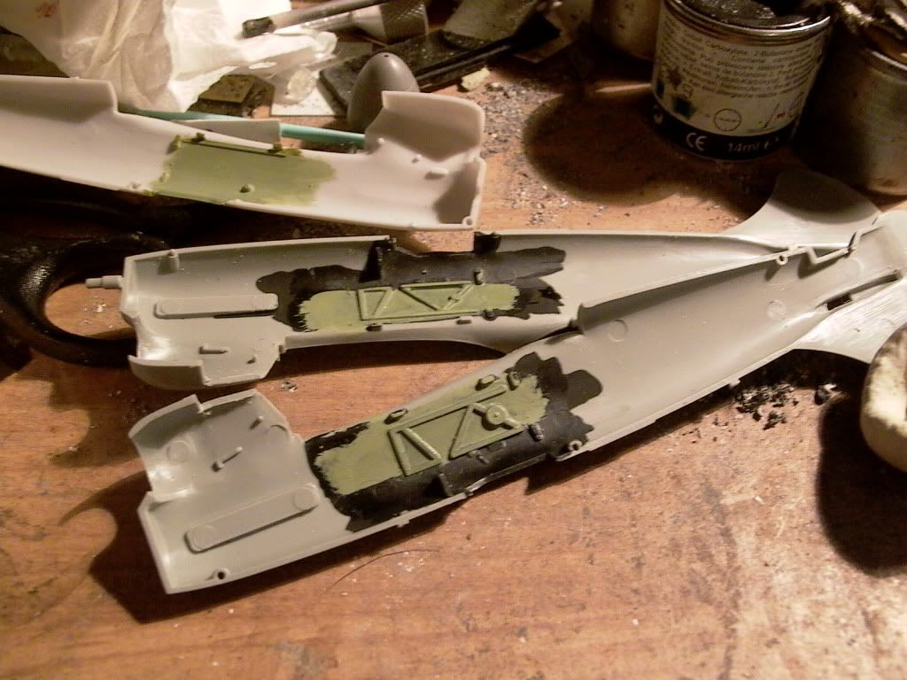

Severus Posted March 12, 2012 Share Posted March 12, 2012 (edited) Started the easiest way, painted cockpit, cut out the radiator flap... No miracles here, as I don't intend to put it under microscope to show it. Edited March 12, 2012 by Severus Link to comment Share on other sites More sharing options...

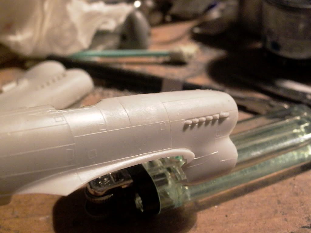

Severus Posted March 13, 2012 Author Share Posted March 13, 2012 (edited) Scratch - hafta somehow reduce my supplies of sheet styrene... Meanwhile I started on the worse one - Heller. Trying to rescribe whole thing using razor saw... Testing on tail... And on the cowling. Slow progress, but expected worse. Fortunately, heller plastic isn't the hardest one. Edited March 13, 2012 by Severus Link to comment Share on other sites More sharing options...

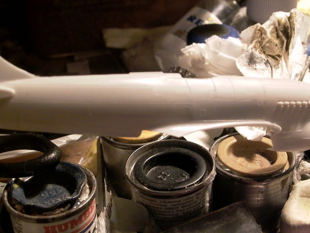

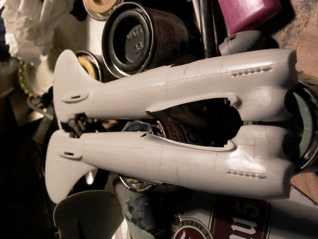

Severus Posted March 14, 2012 Author Share Posted March 14, 2012 (edited) Most of the fuselage rescribed, just radiator and a few lines on tail still to do. Covers and steps - though not according to reality - will be made from attached plastic strips, therefore positive - like acaddemy made on typhoon. Pics - as promissed: Many thanks to anonymous toolmakers of Heller!!! Though 30 years old, all substantional lines, though raised, are mostly in correct place. Maybe some lines should be half mm up or down etc., but substantially, all lines can be used as basis for drawing recessed ones, and, if you are as lazy as me, and can stand some half mm of inaccuracy, draw the recessed line using raised one as lead for knife, razor saw, nail or pickaxe Edited March 15, 2012 by Severus Link to comment Share on other sites More sharing options...

Severus Posted March 15, 2012 Author Share Posted March 15, 2012 That's so simply stupid method, not worth to mention, nevertheless, I will try to describe... I don't have special scribing tool, as I didn't ever dare to rescribe whole kit. There is possible to scribe using sharp edge of knife, but the axial grip is prone to twist, blade itself is too soft, and easily is possible to draw too deep line. Using razor saw (just the blade in hand), though it's much softer, there's much better control of pressure over excel knife, easily you can put the blade on the place of desired line to see, whether it's correct, put the ruler exactly to it and then draw the blade. In comparison to scribing tool, this is VERY primitive method. This method I use only on the kits, where I need just to repair some lines (after putty orgy), and for the first time I use this method on whole kit, that I learned has most of the lines in the right place, though raised. Yep, the result isn't 100% correct scriing around, depending on the width of the raised line, but with certain considerations it's worst inaccuracy is about half mm, that I find acceptable. For hamhanded ppl, like me, there's certain advantage in better aiming with no need to have ruler handy, actualy, it's possible to be happy with no ruler Link to comment Share on other sites More sharing options...
Severus Posted March 15, 2012 Author Share Posted March 15, 2012 Addendum to the above: With razor saw it's able to engrave even turned lines - if you keep in mention you shouldn't stress the blade beneath the flexible deformation. Be creative After you succesfully duplicated engraved line beside the raised one, don't forget to sand the raised line, and don't be afraid to sand it thoroghly. If you are satisfied with depth as width, clean the line of dust, moisten the brush in perchlorethylene, toluene, xylene or other solvent, and quickly draw the brush over new line. Quickly and by MOISTEN, not drooling brush! Link to comment Share on other sites More sharing options...

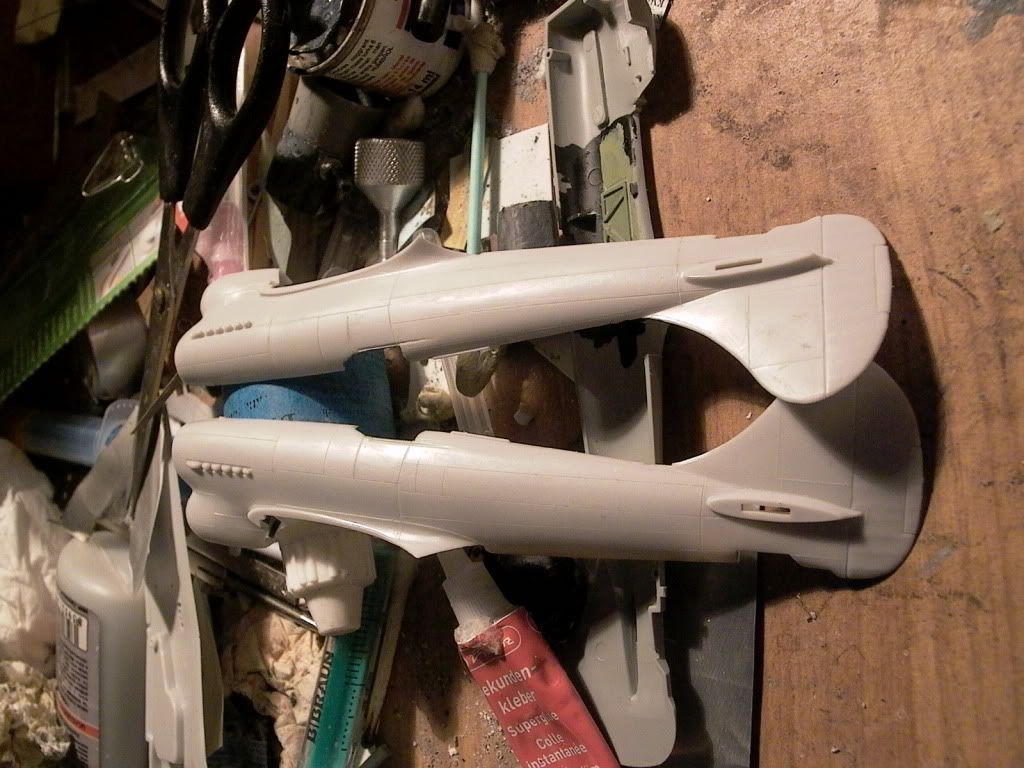

Severus Posted March 16, 2012 Author Share Posted March 16, 2012 Fuselage rescribed! Link to comment Share on other sites More sharing options...

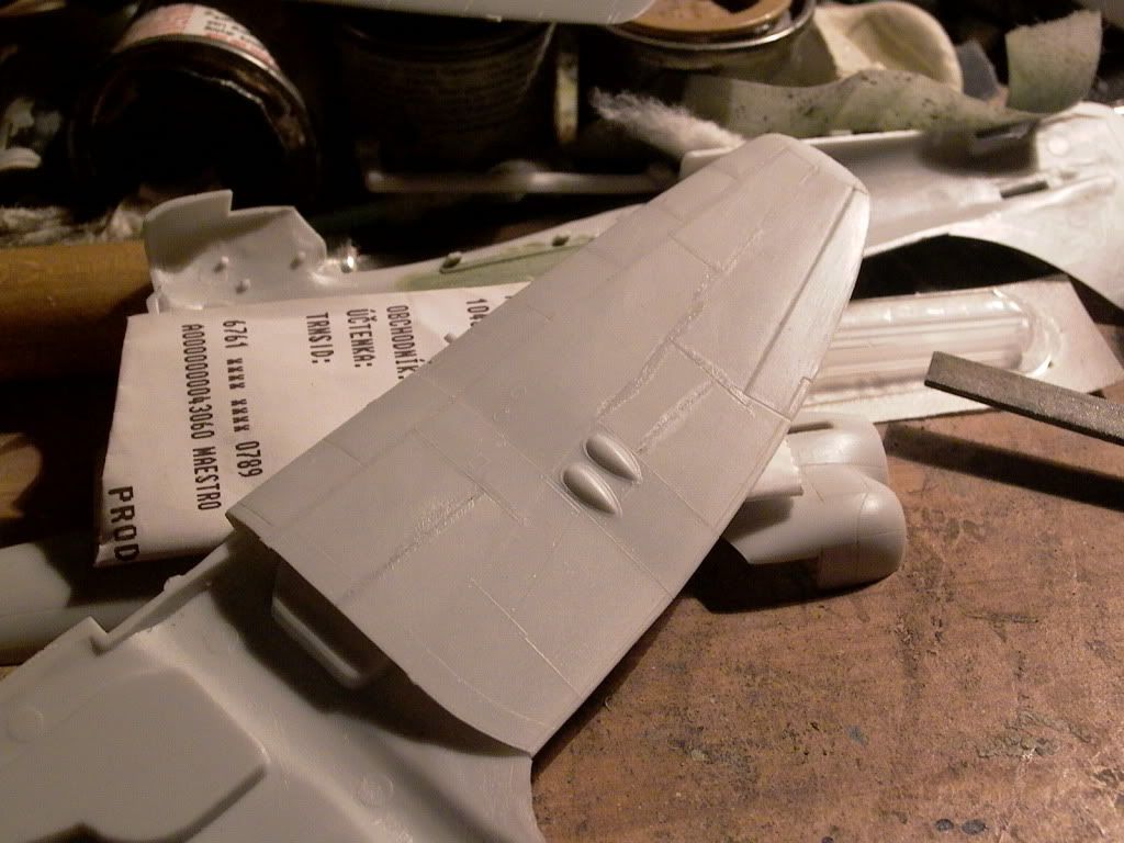

Severus Posted March 24, 2012 Author Share Posted March 24, 2012 (edited) Only slow updates, as been out of mood. My suspects had been verified, FIL. Though losing wt., patient still retaining his good mood. Okay, back to tempest Slowly rescribing the wing... Edited March 24, 2012 by Severus Link to comment Share on other sites More sharing options...
Severus Posted March 24, 2012 Author Share Posted March 24, 2012 From the progress of wing rescribing I must admit, it goes as not good as the fuselage. Though the same plastic, the wing seems to be a little bit harder, therefore tendency of saw to slip... Link to comment Share on other sites More sharing options...

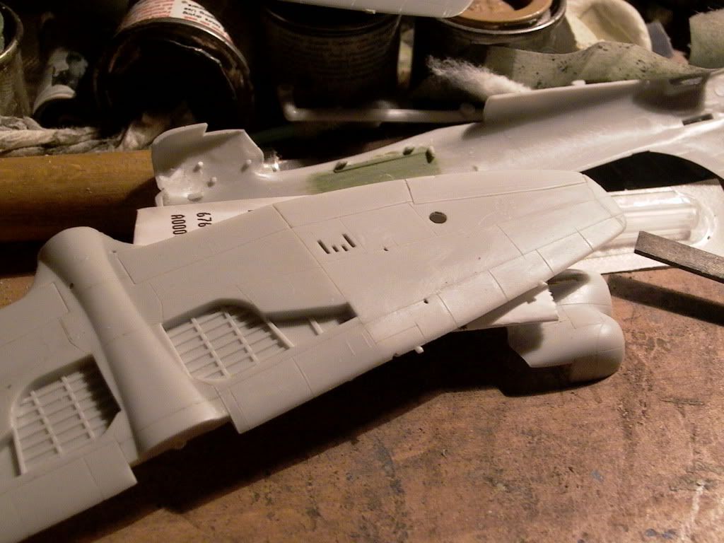

Severus Posted March 25, 2012 Author Share Posted March 25, 2012 I checked - too late - lines on bottom and upper wing, as well as left and right upper wing. I must admit, I was somehow disappointed, as it seems the lines are frequently off. I keep in mind, approx 1.5 inch from fuselage, where differed left and right panels. Still I have no idea how to proceed various caps, some of them missing, some of them I sanded off. Thinking about two possibilities: 1. decal with rings, rectangles or squares, 2. gluing piece of sheet styrene of desired diameter or size, might look like on certain caps on academy typhoon. Though not too correct, doesn't look too bad. Link to comment Share on other sites More sharing options...

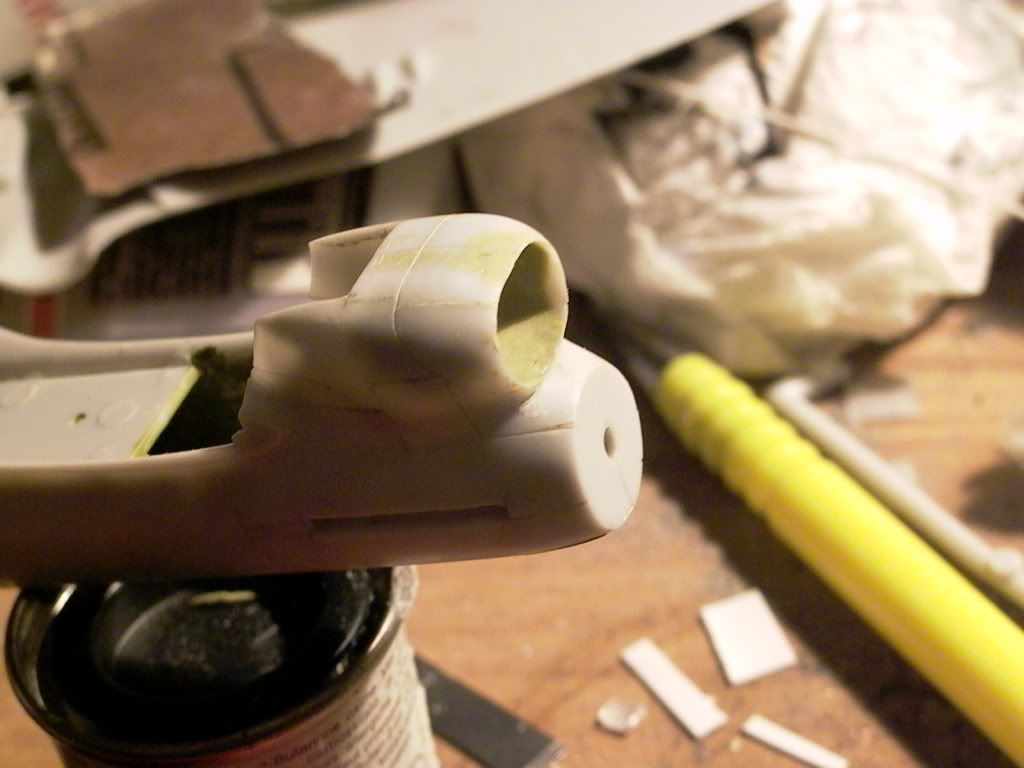

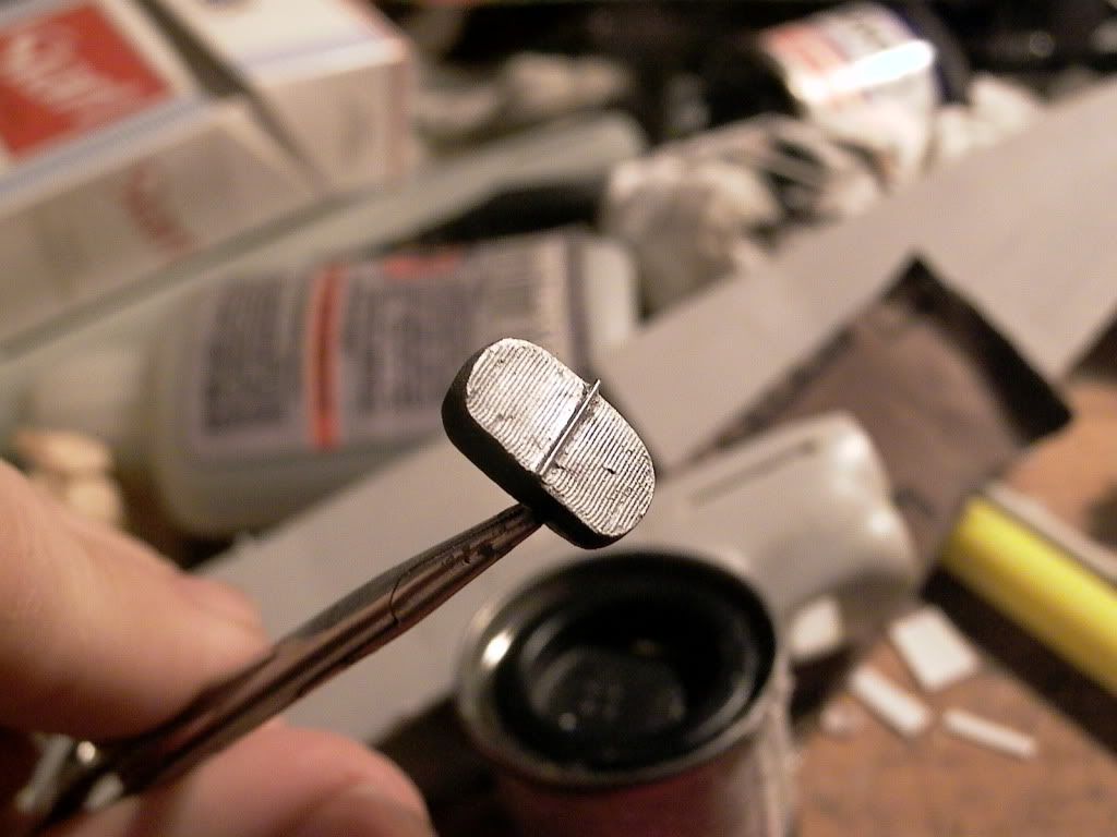

Severus Posted April 1, 2012 Author Share Posted April 1, 2012 Okay, very slow progress within last few weeks. Tried to rectify the radiator mouth; this is the ugliest part of Heller otherwise rather good tempest. Still has ertain flaws, I'm lazy to bother with it more. Other side... Radiator itself... Well, as I didn't have usable grill or mesh handy, decided to cut off the cylinder, put some thin layer of miliput, and draw the saw across it. Though not ideal, finished within 2 minutes Dry fitting of the wing... Link to comment Share on other sites More sharing options...
Killingholme Posted April 1, 2012 Share Posted April 1, 2012 Radiator itself... Well, as I didn't have usable grill or mesh handy, decided to cut off the cylinder, put some thin layer of miliput, and draw the saw across it. Though not ideal, finished within 2 minutes That is clever! Thanks for showing us the tip. Will Link to comment Share on other sites More sharing options...
