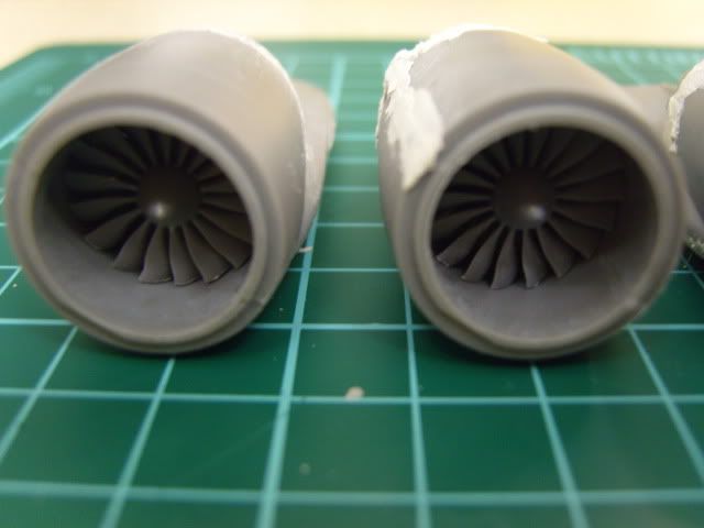

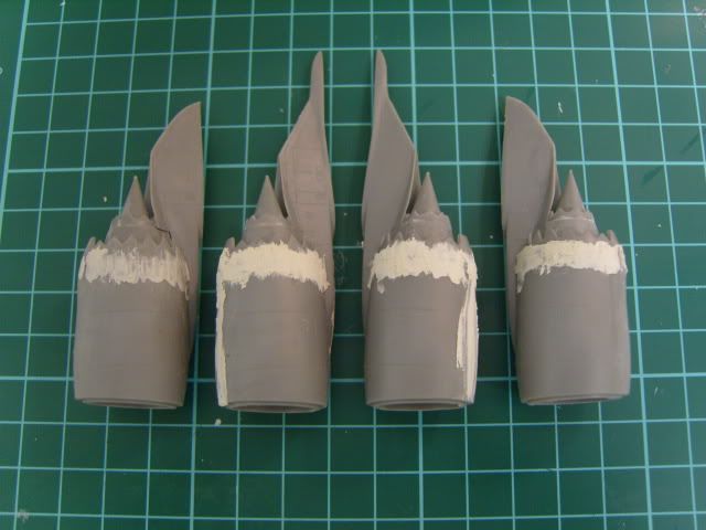

tomprobert Posted May 2, 2012 Author Share Posted May 2, 2012 I've done a little more the the 748 this evening - namely gettting the engines together. They are of a similar standard to Zvezda's 787 engines, and are molded beautifully. Here are some detail shots for those interested: I had to add a little filler where the rear part of the nacelle joins the main body of the engine as there was a join visible, but to be honest if I'd been a little more careful in the gluing process I probably could have avoided using filler at all. Next step will be getting them cleaned up and ready for some paint. Tom Link to comment Share on other sites More sharing options...
Pin Posted May 3, 2012 Share Posted May 3, 2012 (edited) So far so good. Why do you put so much putty on these seams? I would either - use superglue - dries fast, sands well, very little needed - use liquid putty, like Mr.Dissolved Putty - apply a little with cocktail stick, remove excess with cotton bud stick soaked in nail polish remover - very little sanding is needed, if needed at all. You may try this method (I mean nail polish remover) with your engines - the cheapest NPR costs about 90p in Boots. One of advantages is that the acetone in NPR is thinned to the proportion when it does not affect plastic but melts putty - all the panel lines remain intact. PS. I found where I first seen this: http://www.centennialipms.org/FillingWithoutSanding.pdf Edited May 3, 2012 by Pin Link to comment Share on other sites More sharing options...
tomprobert Posted May 3, 2012 Author Share Posted May 3, 2012 So far so good.Why do you put so much putty on these seams? I would either - use superglue - dries fast, sands well, very little needed - use liquid putty, like Mr.Dissolved Putty - apply a little with cocktail stick, remove excess with cotton bud stick soaked in nail polish remover - very little sanding is needed, if needed at all. You may try this method (I mean nail polish remover) with your engines - the cheapest NPR costs about 90p in Boots. One of advantages is that the acetone in NPR is thinned to the proportion when it does not affect plastic but melts putty - all the panel lines remain intact. PS. I found where I first seen this: http://www.centennialipms.org/FillingWithoutSanding.pdf It's Revell filler so sands very easily, which is a bonus. I do often use superglue but didn't have any to hand at the time. Thanks for the ideas though - I'll have a look and may invest! I'm stuck in the past... that's the problem!!! Link to comment Share on other sites More sharing options...
