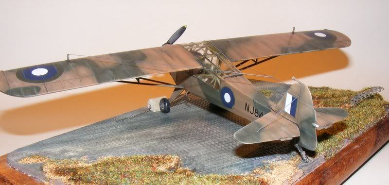

Graham T Posted February 23, 2012 Share Posted February 23, 2012 (edited) The problem with fishing line in my (limited) experience is that you really need to drill the holes at the correct angle otherwise you really have to pull the line tight - probably too tightly for comfort - to avoid a short "vertical" length as it exits the hole & a resulting unnatural look! I used it on my Woodcock & if you look in the area of the starboard main struts, you can see what I mean. I'm going to try eeze line on my Ninak! Edited February 23, 2012 by Graham T Link to comment Share on other sites More sharing options...

Abacus Posted February 23, 2012 Share Posted February 23, 2012 The problem with fishing line in my (limited) experience is that you really need to drill the holes at the correct angle otherwise you really have to pull the line tight - probably too tightly for comfort - to avoid a short "vertical" length as it exits the hole & a resulting unnatural look! I used it on my Woodcock & if you look in the area of the starboard main struts, you can see what I mean. I'm going to try eeze line on my Ninak! Exactly the same with me on a Gladiator build. So bought sowing elastic with the theory that it will avoid that "vertical" problem and provide a taut line. Also have some ca accelerator which should help. All this is theory at the moment of course! http://www.ebay.co.uk/itm/25-Metres-Clear-...a#ht_2477wt_952 Link to comment Share on other sites More sharing options...
