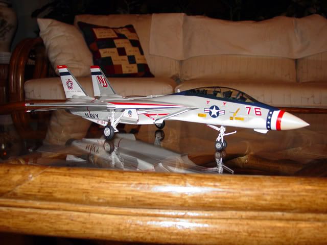

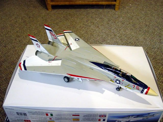

JMChladek Posted February 24, 2012 Share Posted February 24, 2012 (edited) The 1/48 Academy kit is mainly a recessed panel line copy of the Revell/Monogram kit. Its lower nose issue is the main reason modelers knock it, but if you back fill the nose with Milliput and grind down the bulge just in front of the nose gear bay flat and the corresponding nose (you'll wear through the plastic in the process, which is why Milliput is needed), the profile looks A LOT better. The kit surgery can be accomplished with a Dremel with a sanding drum and some finer grits of sandpaper to clean up in less than 20 minutes or with a coarse sanding stick in a little longer time. And for the record, except for that lower bulging, the Academy nose is NOT hideously inaccurate. The upper nose profile looks maybe slightly off from Monogram's up top but once the lower nose is improved, the looks are much better. Fujimi's kit nose is MUCH worse by comparison as it is very bloated vertically. Other issues it has include a nose that has to be rescribed due to inaccurate panel lines and some very slight shape issues on the aft spine (it seems to flatten out a little too quick). But, IMHO it builds into a very nice Tomcat for the price (and a resin cockpit or resin parts designed to fit a Revell/Monogram kit will fit it just fine without many problems). The Bombcat issue is the one to get as it has both two grill and NACA gun vents and a full set of air to air (Phoenix, Sidewinder, Sparrow) and air to ground options in the kit. So you can practically do any era of Tomcat from the kit, with the possible exception of the earliest jets with the original wide beaver tail (Hasegawa is the only company to offer a Tomcat with that option). Only thing you would need to do for the pre-1980 Tomcats (or Iranian ones) is to remove the reinforcement plates from the tail fins. The original issue kit with the air to air option only doesn't have those plates. The intake trunks can also be a pain to clean up (the Monogram intakes have exactly the same problem) but a set of Steel Beach vinyl intake covers from Sprue Brothers will solve that. I built one of these and have two half built. They look great when done and even my first one (built before I knew about the lower nose issue) looks like a Tomcat to me. Only mod I did to my first model was the nose rescribing and alter the contour of the forward windscreen's lower frame to make it a little more accurate (again, Monogram's windscreen has the same problem): Edited February 24, 2012 by JMChladek Link to comment Share on other sites More sharing options...
