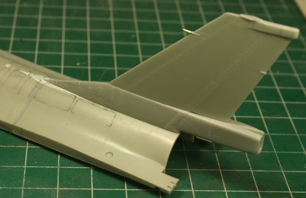

Stephen Posted November 19, 2011 Share Posted November 19, 2011 You would indeed need to start with the Blk 25/32 kit, I would recommend using the tail from the Hasegawa kit. The recess for the C tail should be filled in using plasticard as it is easier to rescribe panel lines (Thanks Jens for the suggestion).the panel lines are slightly different around the vertical stabiliser and the DACO book on the F-16 has very good plans.In addition the wheels would need to be changed as would the instrument panel I think.I suspect Mike V will be able to enlarge on the exact requirements. HTH Stephen Link to comment Share on other sites More sharing options...
