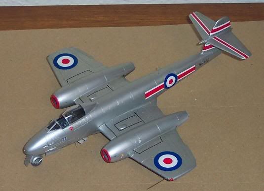

AnonymousAA72 1,211 Posted August 10, 2008 Share Posted August 10, 2008 Halford's Aluminium is a good representation - and can be toned down if necessary with matt or satin varnish. One thing to bear in mind is HSS faded to a metalic or even slightly metalic grey Not a great photo..but my CA Meteor F8 in 1/48th scale was painted in Halford's..... Link to post Share on other sites

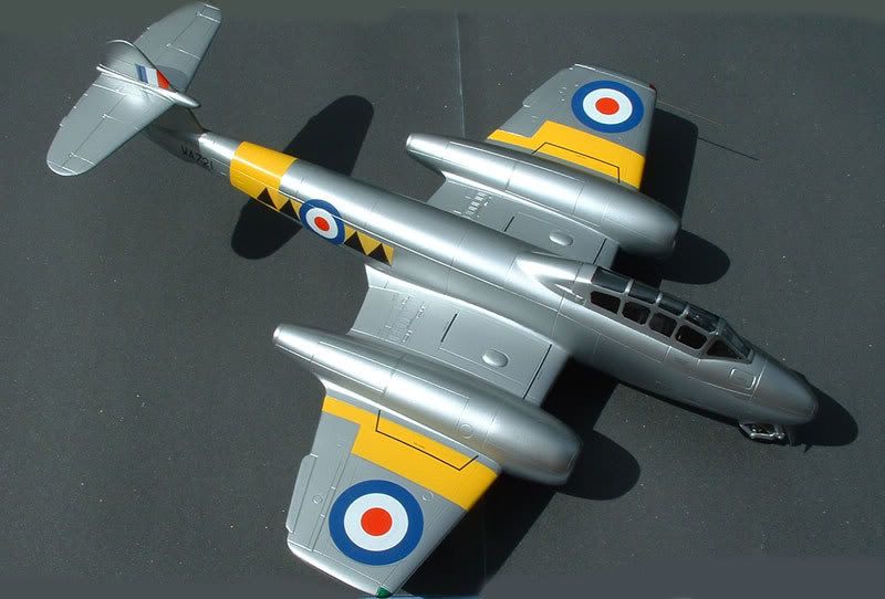

Deanflyer 2,338 Posted August 10, 2008 Share Posted August 10, 2008 Either a straight coat of ALCLAD 2 Aluminum or Model Master Metaliser Aluminum with a satin coat over the top does a great job. But the ALCLAD is definitely the preferred option though.Cheers I'd have to go with this one too. I did my Meteor T7 in Alclad Aluminium over a grey Halford's primer base, and it turned out just the same as HSS: Cheers, Dean Link to post Share on other sites

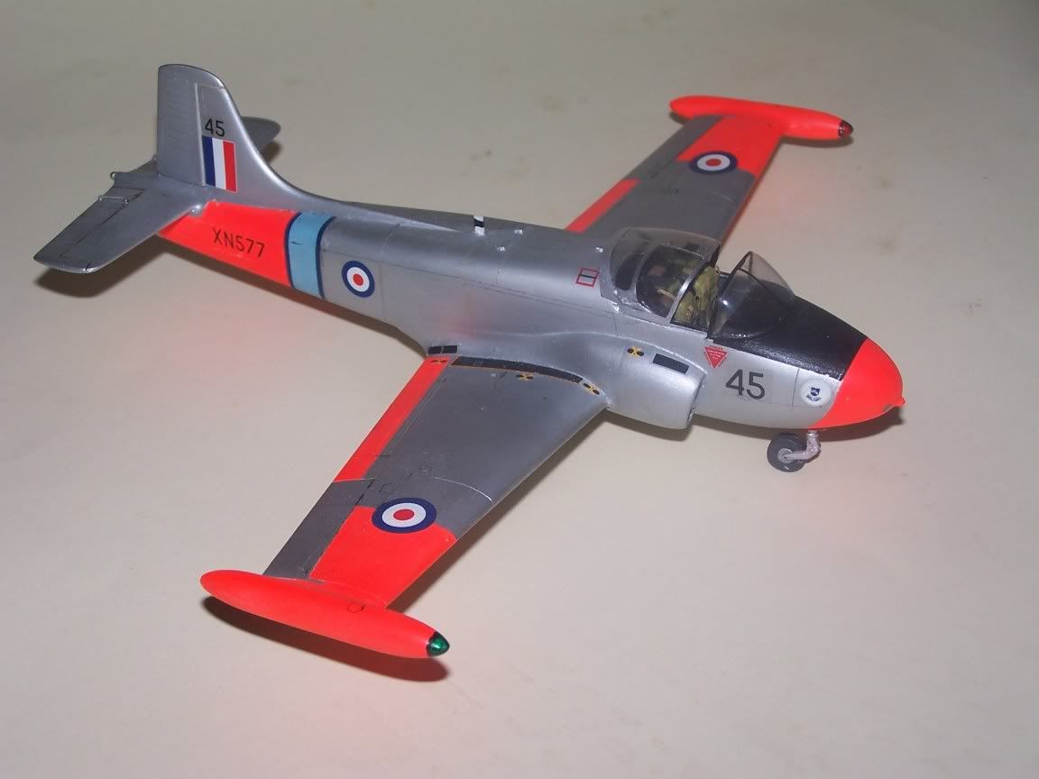

AnonymousAA72 1,211 Posted August 11, 2008 Share Posted August 11, 2008 Here's another of mine painted in Halford's Aluminium - over their White primer (as a base for the Dayglo) Link to post Share on other sites
