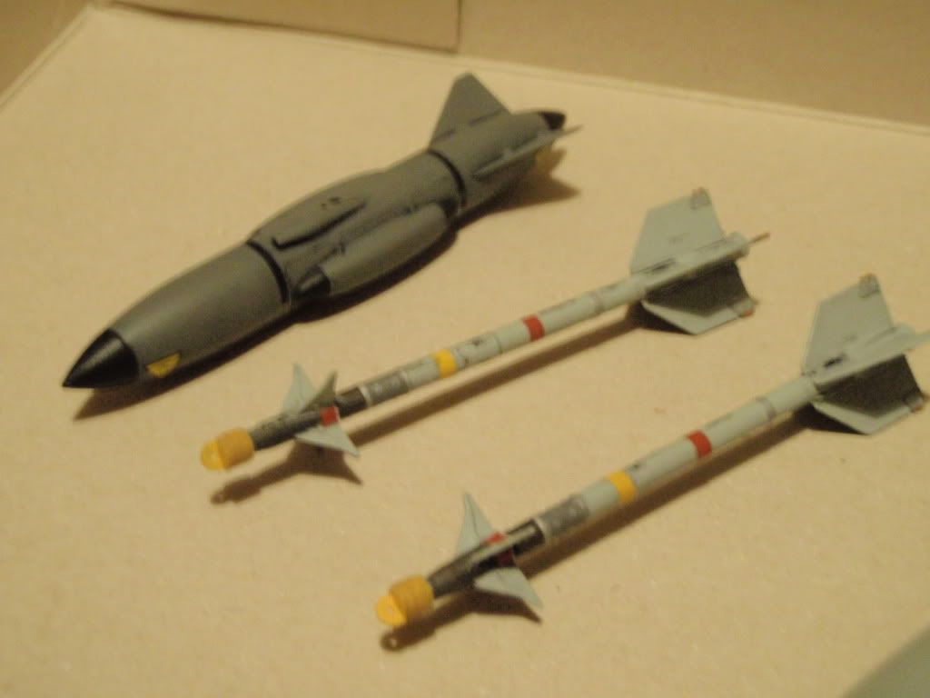

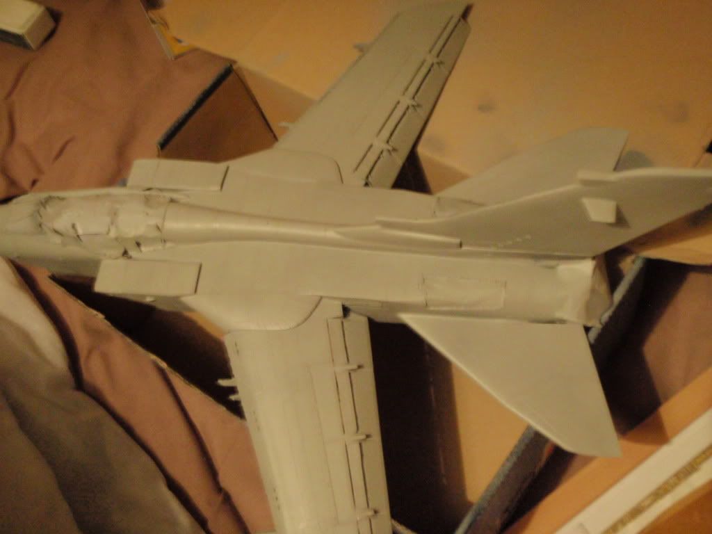

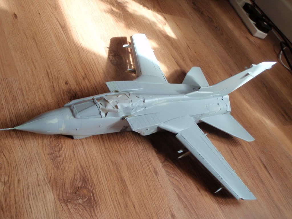

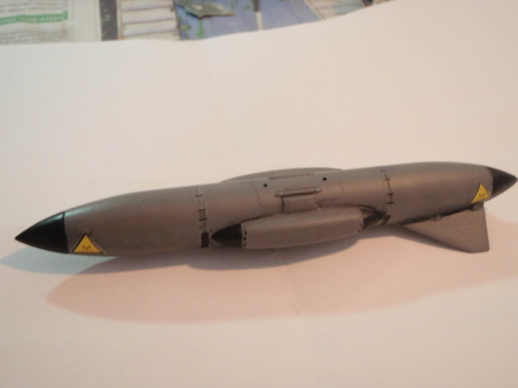

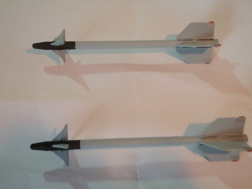

James G Posted July 18, 2010 Author Share Posted July 18, 2010 Hey guys, A quick update, as promised. The primer is on the main airframe and I'm still on the boring process of micro-meshing surface irregularities, re-scribing panel lines, etc. As a more interesting diversion I have worked on some of the stores, and I'm pleased to say that the first small part of this build (namely the Sky Shadow ECM pod) is finished! I've also started painting the Sidewinders but they aren't done yet. As for the other weaponry, I hope to make a start on the Storm Shadows soon. I'm not too far away from the main stage of painting either, hopefully I can snatch some more time in the next couple of months.... All the best! James Link to comment Share on other sites More sharing options...

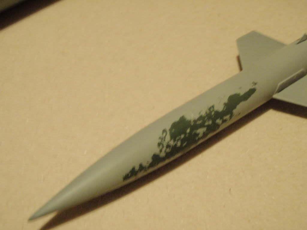

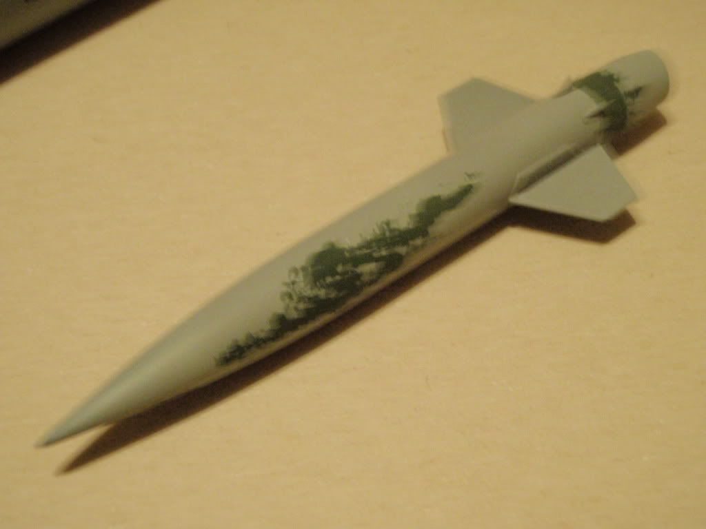

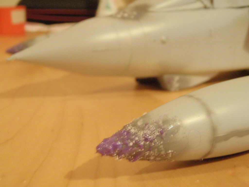

James G Posted July 21, 2010 Author Share Posted July 21, 2010 That's some fantastic work, James!If it's of use to you for adding visual intrest to the paint scheme, here's a pic I took a few years ago of a GR.4 sporting a drop tank with the remnants of a temporary winter finish over the old green/grey camo: Hello mate, Thanks for the interest + kind praise - just to reassure you, my Tornado will have an extensively weathered finish - I am in the precess of undercoating patches of the tanks in dark camouflage grey (overall 'normal' GR4 colour), and then masking with Maskol and wetted salt, to wear off patches, as would be seen on the real thing. The BOZ-101 pod I have painted in the normal dark green, and this will be finished with a very scuffed ARTF coat. I have kept the Sky Shadow pod relatively pristine as it seems to be much cleaner in all the photos, and having it a darker grey adds visual interest I think. Updates to come as I get the many paint layers on! Cheers James Link to comment Share on other sites More sharing options...

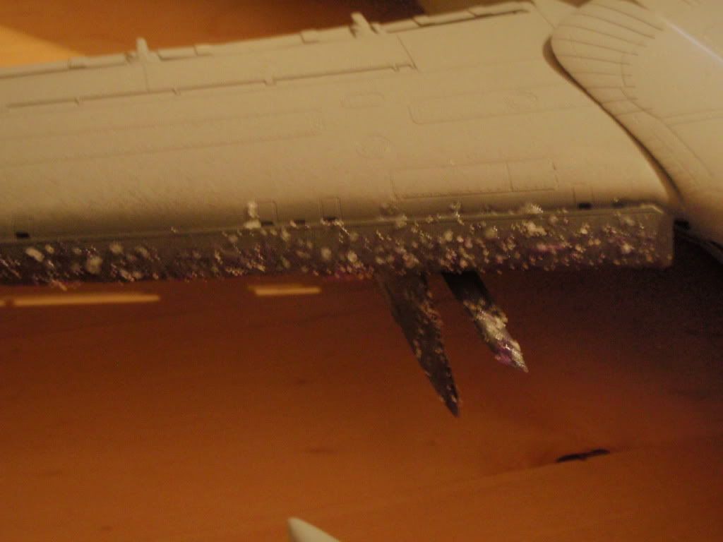

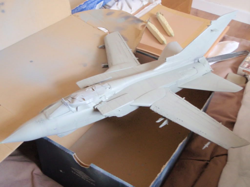

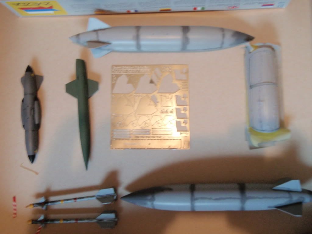

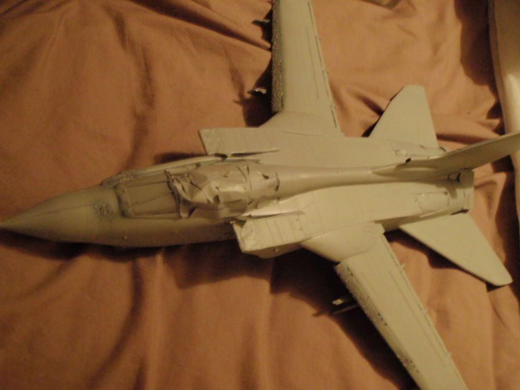

James G Posted August 1, 2010 Author Share Posted August 1, 2010 Hi Guys, A quick update. I've just about managed to get the basecoat of WEM Barley Grey on the aircraft, ancillary parts and some of the stores. I'm adding the Sidewinders to the (virtually) finished list along with the Sky Shadow pod. I've made a start on the Storm Sadows, and the BOZ pod has been undercoated with green and then haphazardly masked with stippled patches of maskol. I also used the same appraoch with the front edges of the pylons and slat leading edges (having undercoated them in dark camouflage grey beforehand), and I used wetted table salt for additional masking - the result as you can see from the photos looks like some sort of bizarre candy! After the enamel Barley Grey basecoat is dry I will pre-shade with acrylic ocean grey, then finish with Vallejo Barley Grey, and hopefully the shading will look right.... Any comments welcome, hope you all like the progress. I hope to have this done before too long.....(!) Cheers James Link to comment Share on other sites More sharing options...
Harvard Posted August 2, 2010 Share Posted August 2, 2010 I can't wait to see how that works! The sidewinders look spot-on! Keep up the great work! Cheers Harvards Link to comment Share on other sites More sharing options...

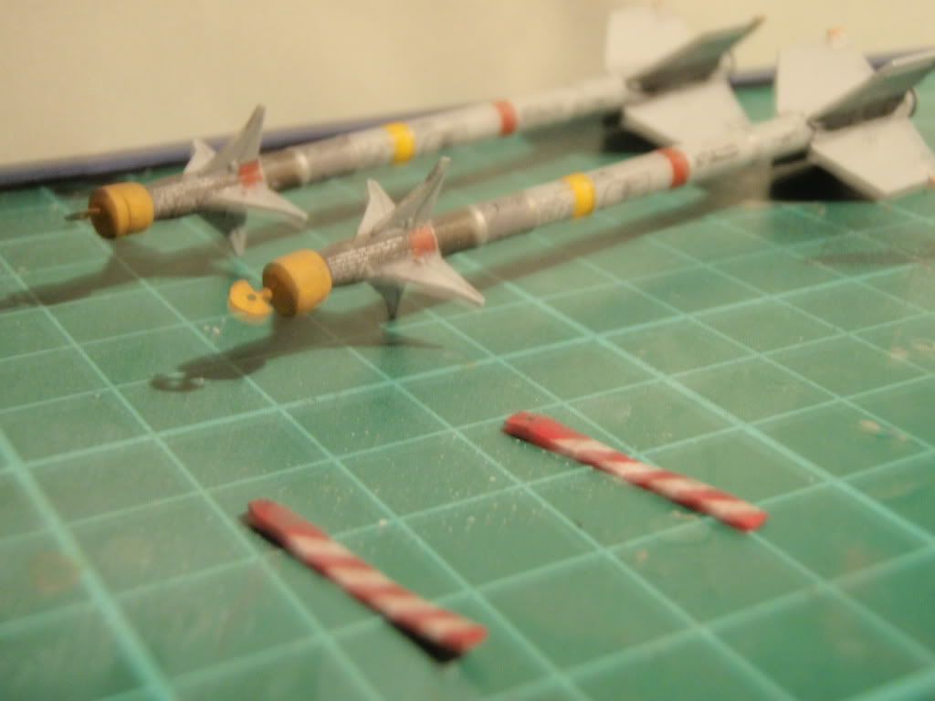

spike7451 Posted August 4, 2010 Share Posted August 4, 2010 (edited) I can't wait to see how that works!The sidewinders look spot-on! Keep up the great work! Cheers Harvards Noddy caps on the winders are the wrong shape.They should look like this: (ps,I mean the yellow caps on the ends...) Edited August 4, 2010 by spike7451 Link to comment Share on other sites More sharing options...
Dads203 Posted August 4, 2010 Share Posted August 4, 2010 masking with Maskol and wetted salt, A well seasoned build..."would Sir like Salt and pepper with his Tornado " Fantastic build btw Dan Link to comment Share on other sites More sharing options...
James G Posted August 5, 2010 Author Share Posted August 5, 2010 Noddy caps on the winders are the wrong shape.They should look like this: (ps,I mean the yellow caps on the ends...) Doh! I didn't have any good pics of those, thanks Spike they will be corrected..... James Link to comment Share on other sites More sharing options...

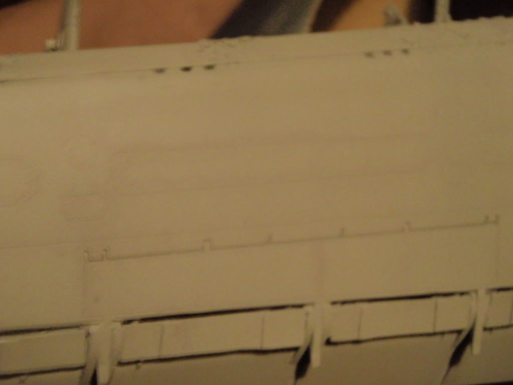

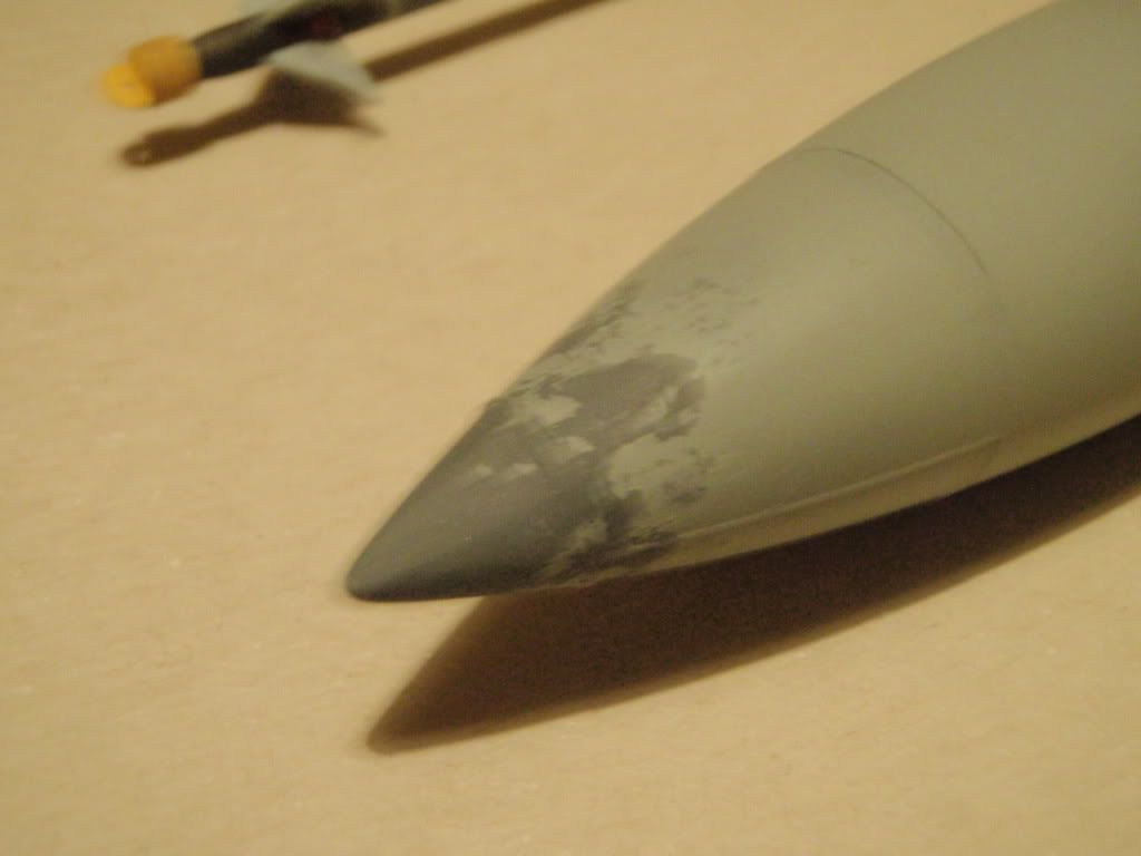

James G Posted August 15, 2010 Author Share Posted August 15, 2010 Hello again, Another update, I've snatched a bit of time to work on painting. I've done all the preshading, (over the WEM Barley Grey) layer, then blended everything in with a thin coat of Vallejo model air Barley Grey. The 2 tones are complementary and give the finish a bit of depth. The preshading is VERY subtle (perhaps too much?) so the close-up of the wing hopefully shows it better. I think I will go over some panels with the WEM Barley Grey again, and maybe post-shade some lines....then I reckon the painting will be done! I'm quite pleased with how the 'chipped' areas on the tanks and BOZ pod came out - I'll let the photos do the talking (Spike please note I have fixed the yellow caps on the AIM9Ls!) Cheers James 1 Link to comment Share on other sites More sharing options...

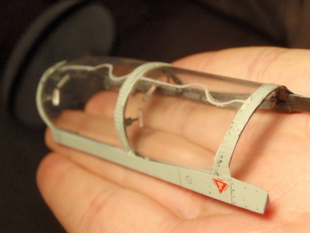

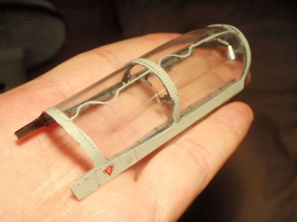

James G Posted October 13, 2010 Author Share Posted October 13, 2010 (edited) Hi All, A little progress, it's been a while.... As you can see I am re-doing the preshading on the Barley Grey, I know, its a pain - but it wasn't showing properly the first time! All the stores are nearly done and just need decals and a little weathering. I'm pleased how the main canopy came out, I'm just tidying/polishing up a little. I'm very close now - frustrating as I have loads of work to do, and I want to have this ready for SMW....BM collective please cross your fingers to me! Cheers James Edited October 13, 2010 by James G Link to comment Share on other sites More sharing options...
