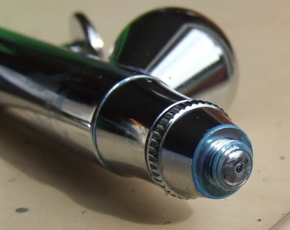

Ant Posted June 30, 2008 Share Posted June 30, 2008 (edited) Hmm, I've used the revolution CR for all my airbrushing up until recently. Not had this problem with it though. It sounds to be like either the needle or the nozzle are not seated properly. Are you instantly getting paint as soon as you press the trigger down? That would indicate that the needle is not far enough forward in the nozzle. Any chance of some pictures of the nozzle with needle inserted, but with the nozzle cap removed? And ditto what peebeep said. You have to clean it out very thoroughly or it will quickly and easily go wrong. This isn't the chore people make it out to be. However, I do remove the needle from mine and clean it after every session. Edited June 30, 2008 by Ant Link to comment Share on other sites More sharing options...

Nev Posted July 1, 2008 Author Share Posted July 1, 2008 Hmm, I've used the revolution CR for all my airbrushing up until recently. Not had this problem with it though.It sounds to be like either the needle or the nozzle are not seated properly. Are you instantly getting paint as soon as you press the trigger down? That would indicate that the needle is not far enough forward in the nozzle. Any chance of some pictures of the nozzle with needle inserted, but with the nozzle cap removed? And ditto what peebeep said. You have to clean it out very thoroughly or it will quickly and easily go wrong. This isn't the chore people make it out to be. However, I do remove the needle from mine and clean it after every session. Yes. I'll post some pictures tonight for you. Thanks for the replies so far guys. Link to comment Share on other sites More sharing options...

Nev Posted July 1, 2008 Author Share Posted July 1, 2008 Heres the pics I must confess, I never realised how much gunge was in there till I took the nozzle cap off (there was a little fibre of paint sticking out of the needle tip). I do flush it through with solvent after every session - looks like I might have to take the nozzle off as well. Link to comment Share on other sites More sharing options...
Ant Posted July 1, 2008 Share Posted July 1, 2008 (edited) OK, well, it's clearly full of old paint that needs to be cleaned out. Also, the end of the needle should be poking out of the nozzle when fitted properly. That's why you've turned it into a single action brush. As mentioned before, you need to take out the needle, remove the nozzle guard and remove the nozzle carefully with the supplied spanner. Clean all of those with something nasty that will dissolve anything (cellulose thinner) or liquid reamer by premi-air is good (similar to badger airbrush cleaner). Considering the mess yours is in, I'd also consider buying some pipe cleaners and taking out all the innards (trigger and needle chuck etc) and give the whole inside a clean out in case there's paint back there. The front of your brush should look more like this ... And the nozzle you want to reveal, remove and clean is this ... Edited July 1, 2008 by Ant Link to comment Share on other sites More sharing options...
