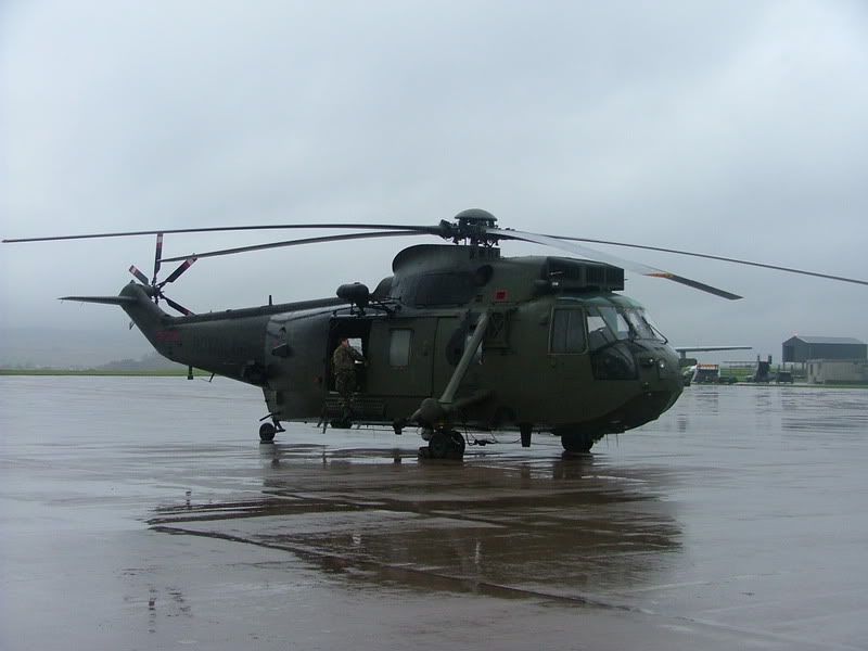

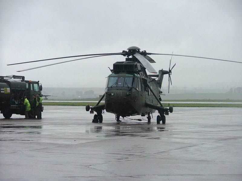

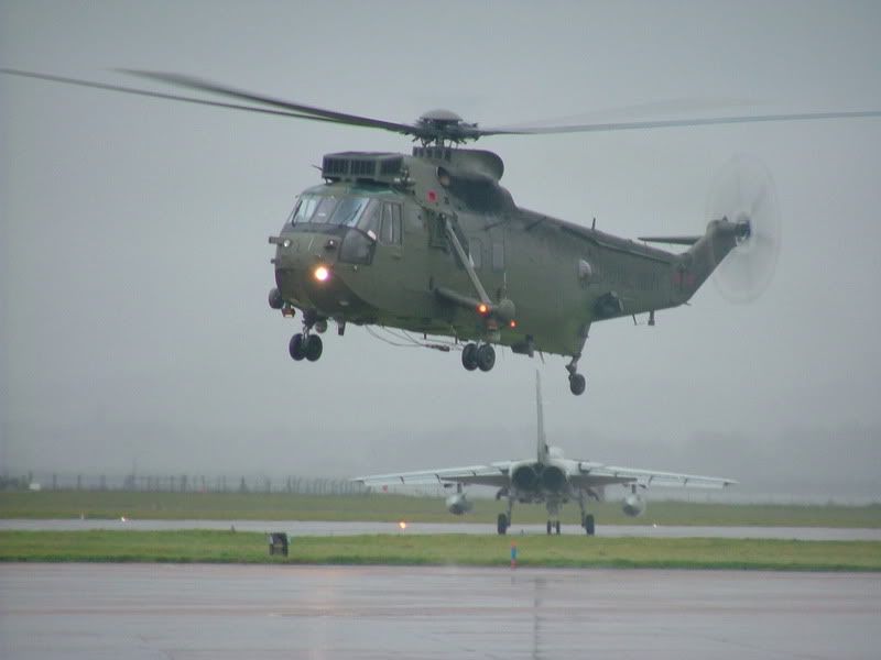

sniperUK Posted June 22, 2008 Share Posted June 22, 2008 A few pics,I thought I had better ones but after my hard drive died I lost a lot of pics these are the best I have left. This one is no good for referance but it's one of my favourite photos . Link to comment Share on other sites More sharing options...
desmojen Posted June 22, 2008 Author Share Posted June 22, 2008 (edited) Ooooooh, I HEART that last shot! Proper English weather eh Jen. Edited June 22, 2008 by desmojen Link to comment Share on other sites More sharing options...
sniperUK Posted June 22, 2008 Share Posted June 22, 2008 Ooooooh, I HEART that last shot! Proper English weather eh Jen. Not English,Scottish taken on the pan at Leuchars . Link to comment Share on other sites More sharing options...
desmojen Posted June 22, 2008 Author Share Posted June 22, 2008 My humble aologies to Scottish rain. Either way, it is now my desktop image I have got all the resin bumps fitted now, it wasn't as bad as it looked in the end. I still have the DIRCM units and the flare pods to do which both have etched brass frameworks to fold up. I'll go up and do that after the racing Jen. Link to comment Share on other sites More sharing options...

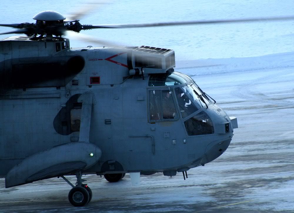

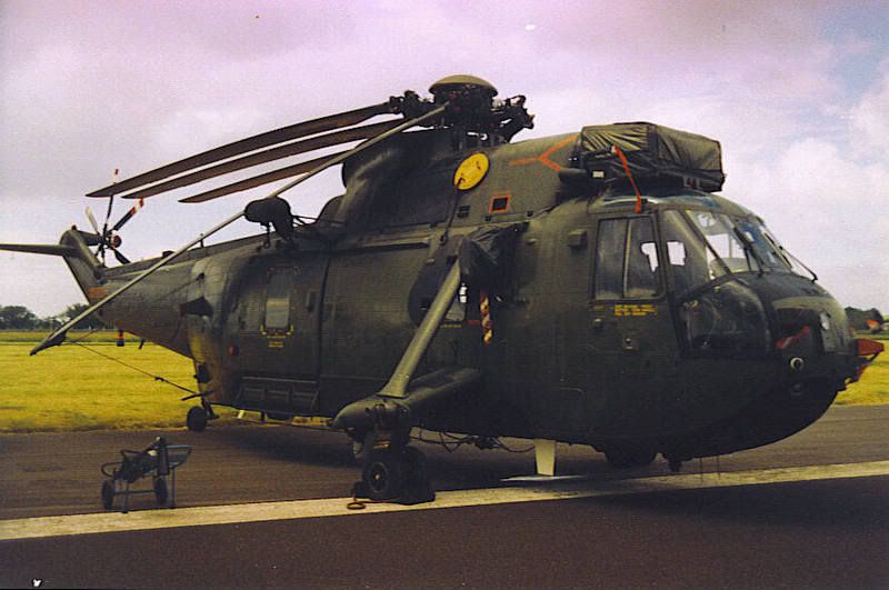

Kyrre Posted June 23, 2008 Share Posted June 23, 2008 (edited) Prolly not much help but here's what I've got of green Seakings. Model is looking good btw (edit: Did I say green Seakings?) Edited June 23, 2008 by Kyrre Link to comment Share on other sites More sharing options...

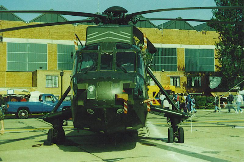

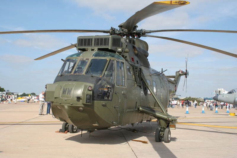

Kyrre Posted June 23, 2008 Share Posted June 23, 2008 And these aren't green either, but they've got lumps and bumps. And they're Seakings. :-) Link to comment Share on other sites More sharing options...
entlim Posted June 23, 2008 Share Posted June 23, 2008 That's an HAR5.................... Link to comment Share on other sites More sharing options...
Kyrre Posted June 23, 2008 Share Posted June 23, 2008 That's an HAR5.................... Indeed. I just noticed that some of the bumps look quite similar. Army/Navy choppers really aren't my forte. Link to comment Share on other sites More sharing options...
entlim Posted June 23, 2008 Share Posted June 23, 2008 Nice shots as usual Kyrre................ Link to comment Share on other sites More sharing options...

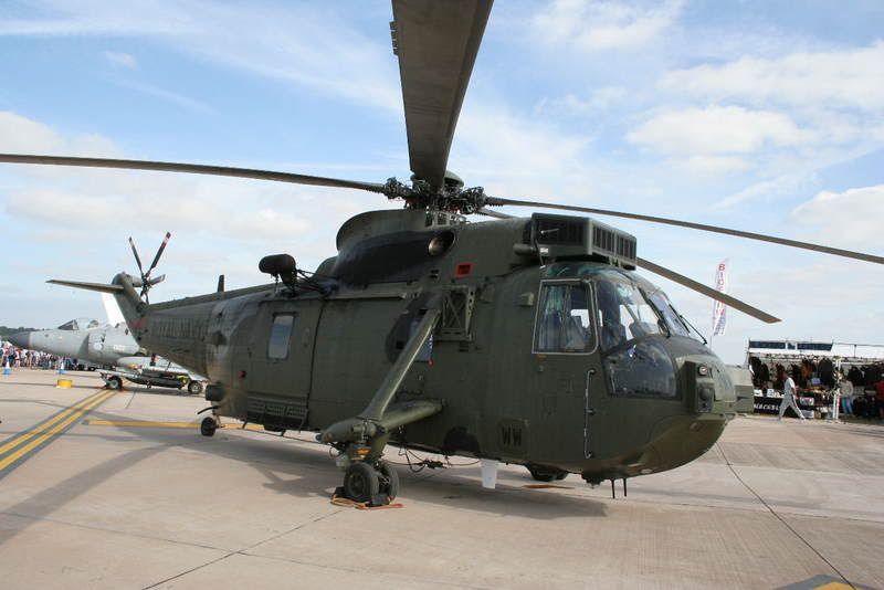

Neil Posted June 25, 2008 Share Posted June 25, 2008 Took these at Marham a while back if they are any use. Have not got a clue as to which flavour of Sea King it is, but hey ho .... Link to comment Share on other sites More sharing options...
Giorgio N Posted June 25, 2008 Share Posted June 25, 2008 That's a HC.4, and those are brilliant pictures ! I'm saving all of those in this thread, they are making me want to do one of these ! Did one years ago modifying the airfix and have always had the feeling i wanted to do one with a proper conversion.. Giorgio Link to comment Share on other sites More sharing options...
