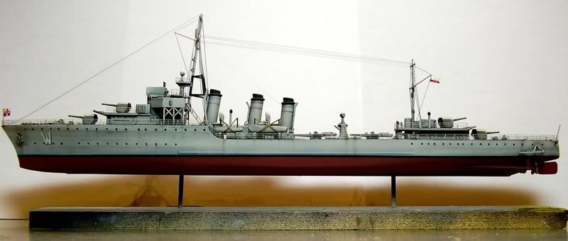

LotusArenco Posted June 15, 2008 Author Share Posted June 15, 2008 Oh, don't worry Phil. I've had my feet wet in the past. 1/400 Mirage ORP Wicher. Made last year. Care to share your Citadel mixes? Or do you just do it by eye? Mart Link to comment Share on other sites More sharing options...
Phil Reeder Posted June 15, 2008 Share Posted June 15, 2008 What a lovely neat job on the ORP Wicher,Mart,it looks good. Regarding Citadel paints,I generally mix from eye,they have tendency to dry much darker than when first applied,but I really like them.The nearest paint to them ,in quality was the Aeromaster range,now,sadly no longer available. Keep us posted on your progess,I`m following this with interest Cheers Phil Link to comment Share on other sites More sharing options...

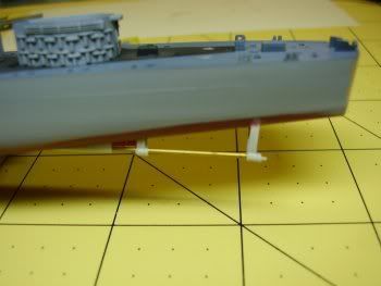

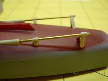

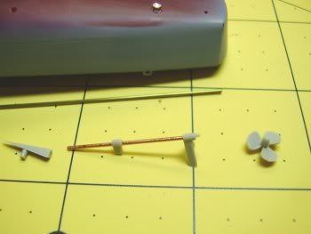

LotusArenco Posted June 17, 2008 Author Share Posted June 17, 2008 Well the brass tubes are on and look a bit better than the plastic propeller shafts. Just dry fitted the superstructure in readiness for masking off the camouflage. For some unknown reason I've forgotten to prime the hull, so I'd better get that done next. If I'm going to get serious about ship modelling, I'll have to pick up some more WEM paints and make my own charts to match the acrylics I prefer to use. I've already got some Kriegsmarine WEM colours and have started to make an 'acrylic cross-reference' chart. Progress would probably go a lot quicker if I hadn't picked up the Sharpe DVD boxset! Mart Link to comment Share on other sites More sharing options...
Phil Reeder Posted June 18, 2008 Share Posted June 18, 2008 I`ll be interested in your X-referance chart,I seem to lack a scentific approach to paint mixing.The DE is coming along nicely,keep up the good work young fella,Bye Phil Link to comment Share on other sites More sharing options...

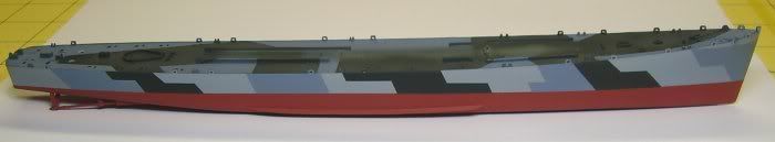

LotusArenco Posted June 19, 2008 Author Share Posted June 19, 2008 Bottom of hull sprayed with Revell AquaColor 36137 'Reddish Brown'. Started attaching bits of tiny 'itsy etch to the guns. Not for the feint hearted. Top tip for the day - Boots 'Nail Polish Remover' is great for removing stubborn dried on acrylic paint, that you forgot to clean out last time you used your airbrush! Mart Link to comment Share on other sites More sharing options...

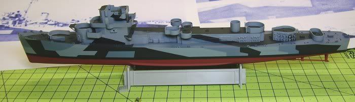

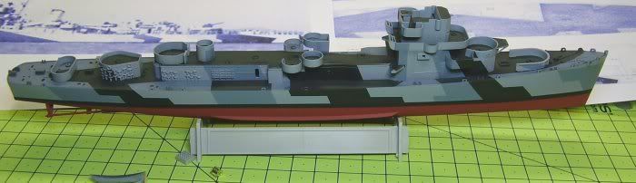

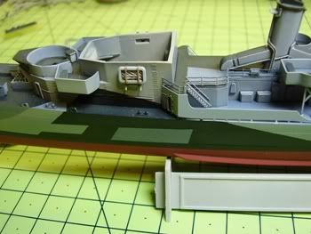

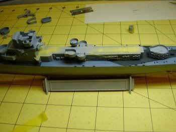

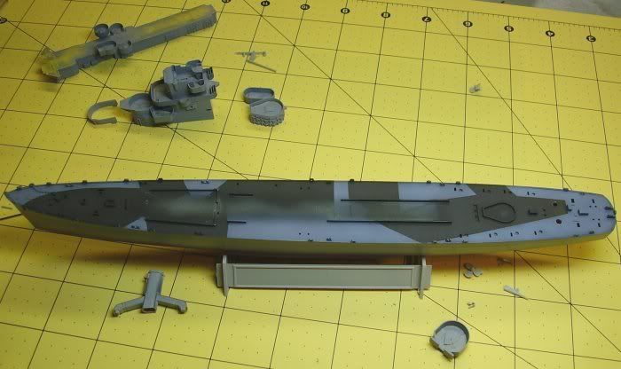

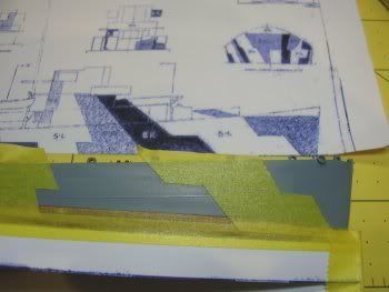

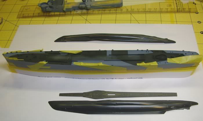

LotusArenco Posted June 22, 2008 Author Share Posted June 22, 2008 (edited) As I mentioned earlier, I seem to go into 'slow mode' when ship modelling. Carrying on with the masking of the camouflage. I've enlarged and printed out the side view plan of the camouflage the same size as the model. Lay a piece of clear plastic over the plan, and stick a piece of Tamiya tape over the plastic. The good thing about Tamiya tape is that it is quite translucent, and you can see the lines of the camouflage through the tape. Trace the camouflage pattern onto the tape, remove from the clear plastic and carefully cut out. I've put little reference marks on the waterline of the model so I can accurately(?) lay the cut out tape masks onto the hull. Remember that the ship hull curves whereas the plans don't (obviously), so there is a small margin of error. As well as the reference marks, I'm also dry fitting the superstructure and making sure the tape matches the plans as best I can. I'm using the old adage of 'light to dark' when it comes to spraying the camouflage, so the initial overall coat of 5-L is the first to be masked off. I'll have to go easy on the spraying, as I don't want to end up with too much paint build up along the tape edges. As a side note, I picked up a 1/350 U-Boat VIIc yesterday. A fitting companion to a Destroyer Escort! Interesting to note the size of the sub in comparison. Mart Edited June 22, 2008 by LotusArenco Link to comment Share on other sites More sharing options...
LotusArenco Posted June 22, 2008 Author Share Posted June 22, 2008 Ended up using Xtracrylix XA1121 Gloss Sea Blue for the black parts of the camouflage, which is a very dark black/blue. Still got the boot topping to mask and spray. Mart Link to comment Share on other sites More sharing options...
Phil Reeder Posted June 22, 2008 Share Posted June 22, 2008 (edited) Very neat paint-job Mart,that Ms 32 camo pattern is enough to give you headache if you look at it too long! Bye Phil Edited June 22, 2008 by Phil Reeder Link to comment Share on other sites More sharing options...

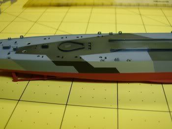

LotusArenco Posted June 23, 2008 Author Share Posted June 23, 2008 that Ms 32 camo pattern is enough to give you headache if you look at it too long!You're not kidding! Minor cock-up on the deck camouflage. I didn't realise that the hull and the deck camouflage was supposed to be matched up in places. So much for being careful with the masking, and following the plans! Oh well, a bit of masking and a respray, and Shhh no-one will ever know. Mart Link to comment Share on other sites More sharing options...

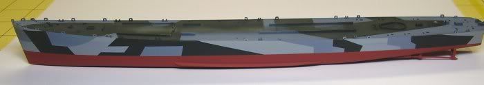

LotusArenco Posted June 28, 2008 Author Share Posted June 28, 2008 Getting there.....Slowly. Main camouflage is finished. Must have used half a roll of Tamiya tape to do all that! Started finishing off the little fiddly bits, lockers, guns and all the deck gubbins. All I have to do now is enter a trance like relaxing meditation, in preparation for adding the photo-etch (or at least lay off the coffee for a bit!). I think the next ship I build will be in a nice easy colour scheme. This one is way too much like hard work.... Mart Link to comment Share on other sites More sharing options...

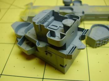

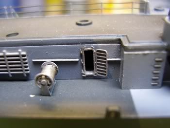

LotusArenco Posted July 11, 2008 Author Share Posted July 11, 2008 Now hurry up! Yea, right! Unfortunately a lot of ‘real world’ stuff and other nonsense have seriously cut into my modelling time. Main one being me finally getting a new funky computer. Hey... I can finally play games again! (I wouldn’t recommend it though, it don’t arf cut into the ‘ol modelling time.) Picking up where we left off. Added a lot of the deck furniture, lockers, cable reels and whatnot, and started on the etch. (Blimey, look at the dust!) Still plenty to do, but getting there.................eventually! Mart Link to comment Share on other sites More sharing options...

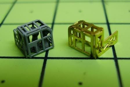

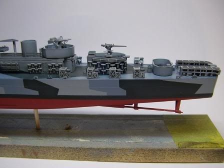

LotusArenco Posted July 19, 2008 Author Share Posted July 19, 2008 Really trying to get this finished now. I cocked up on the rear racks and was unable to use the GMM ones. I forgot to fill the holes in the deck where the plastic racks go, and ended up having to use the kit racks and etch. Here’s a comparison between the Gold Medal Models and the kit supplied etch, for the depth charge racks. The Trumpeter ones aren’t that bad, but don’t really compare in terms of detail to the GMM set. A word of warning for those who want to use the GMM. The racks don’t want to fit over the plastic depth charges, so you will have to sand a little plastic off the bottom/front/back to get a good fit. Another word of warning if you are slightly on the cack handed side. When fitting etch to your ships, don’t be tempted to jump around adding it willy nilly. Work on a section of the kit at a time. I seem to be constantly having to re-attach parts that I’m knocking off by not paying attention! Another handy tip. If you intend adding your ship to a base, it’s in your best interest to drill the holes in the flipping hull before you start adding delicate tiny bits of etch that are easily knocked off. Ask me how I know! Once all the etch is on, I’ll give it a quick once over with some matt varnish to get rid of any ‘glossy bits’ created by using superglue. Then a bit of weathering to grubby it up a little. If I crack on, hopefully I’ll get this finished within a week…hopefully…… Mart Link to comment Share on other sites More sharing options...
