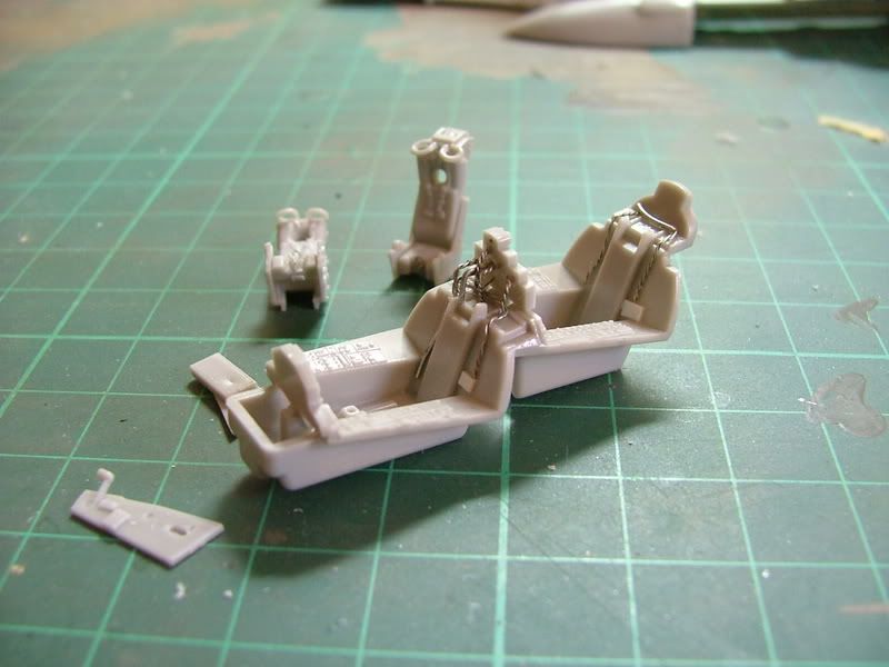

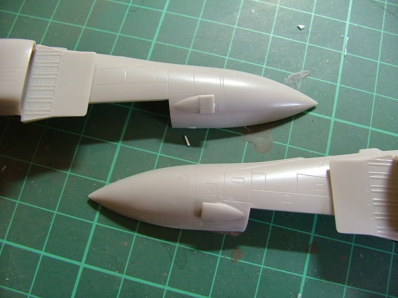

Phil @ Flory Models Posted May 13, 2007 Posted May 13, 2007 Well I have made it to the office and made a start on my Phantom. I was going to do the Yellow Bird markings But a few of you had already mentioned doing it so I've gone for the only operational Phantom unit 892 SQN. It was originally intended that two operational Naval squadrons should be equipped, one each for HMS Ark Royal and HMS Eagle. However, for political reasons, the refitting of Eagle was cancelled so 892 Sqn was the only operational one formed, and operated these Phantoms from March 1969 to December 1978. Here's the kit I have added some fuse wire to liven things up a bit Next I have put the intakes on but the cooler intakes on the nose needed to be shaped in as you can see in the next pic Now I'm of to make the HUD and liven up the area after being inspired by Gary's great work on his.

Bennygman Posted May 13, 2007 Posted May 13, 2007 Nice one Phil - I know what you mean about those nose intakes, those and the main intakes are the only dubious parts of the whole kit fit-wise. Nice to know it wasn't just me. Steve.

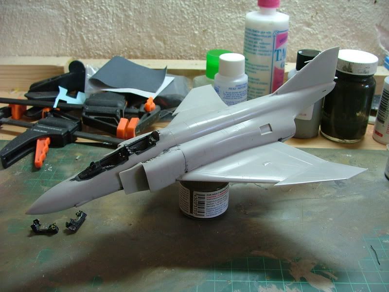

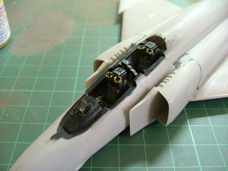

Phil @ Flory Models Posted May 14, 2007 Author Posted May 14, 2007 Just a small update. The cockpit done and the HUD seeing as the kit doesnt have one.
AnonymousAA72 Posted May 15, 2007 Posted May 15, 2007 Just a small update. The cockpit done and the HUD seeing as the kit doesnt have one. Phantastique workmanship as ever Phil.....however (ain't there always a smartarsed "however"..) There were no F4K/FG1 "Twin-stickers", these were restricted to some FGR2's in the XTxxx range of serials, and it looks like you have the rear tub, thus equipped. ALSO the rear right hand consul was more or less non existant. The side wall was flush (the FGR2 did have a small consul). But..its your model... :whistling: 1
Phil @ Flory Models Posted May 15, 2007 Author Posted May 15, 2007 Bill you shout away, there's no such thing as a smart bottom. I'm flying blind on this one so please shout out when I'm going off track. Twin stick will be removed thanks the side console is covered by the side wall, the starboard panel and the breakers on the port side just I got carried away on the painting The other thing is did it Carry the 600 gallon wing tanks at sea, as I'm missing one? Next the colour The kit calls for gunship gray, I don't think so! Ask me any thing of a Hornet, Eagle and the US grays and I'm there

Phil @ Flory Models Posted May 15, 2007 Author Posted May 15, 2007 OK I pulled the rear stick and check the joins ( if you don't no, I just brush on a coat of acrylic black, let it dry for 5 Min's and sand it off. works very well on small cracks and imperfections) A little bit of re scribing......Dam, run out of Dino tape..... and ready to attach the canopies.

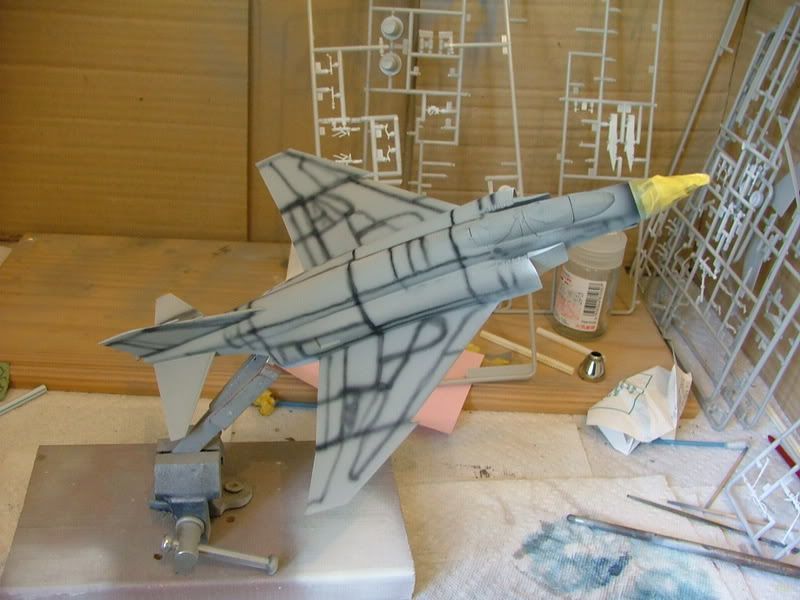

Phil @ Flory Models Posted May 18, 2007 Author Posted May 18, 2007 Small update I have masked up the canopies and put then on I use Tacky glue it's a PVA very grippy and drys completely clear. Here's the pre shading. and here's the main paint done. It's the Vallajo 053 Dark Sea green but is the match for 36118 Gunship grey I like it because it's more blue then gray and that's the look I'm after. I then added a few drops of white to the paint and thinned it a bit more and went round all the panels with it to give some tonal variation. The light was bad so I had to use the flash. Oh and I have found out were my missing parts have been ending up The little sod has been in the office and helped his self 1
