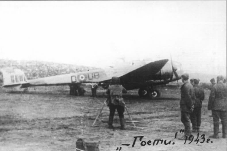

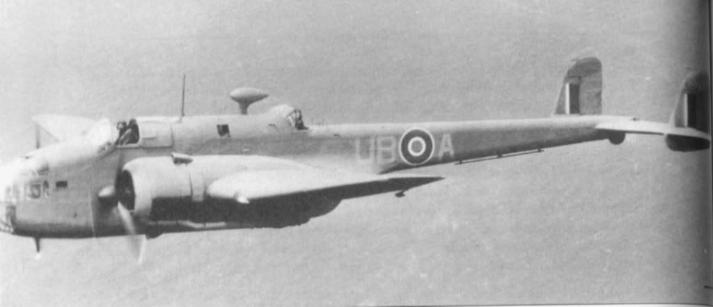

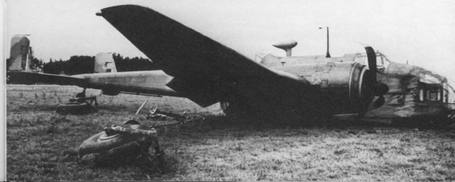

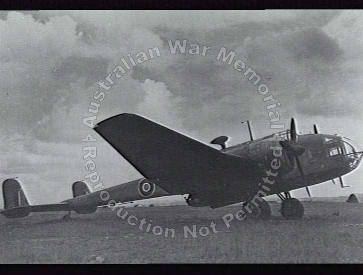

Kyrre Posted March 24, 2008 Share Posted March 24, 2008 (edited) As others I doubt any scheme but a ) Bomber command Brown/Green B ) TSS C ) After summer '43, EDSG/Sky c ) Late war stuff for the odd plane out. Some pics Edited March 24, 2008 by Kyrre Link to comment Share on other sites More sharing options...

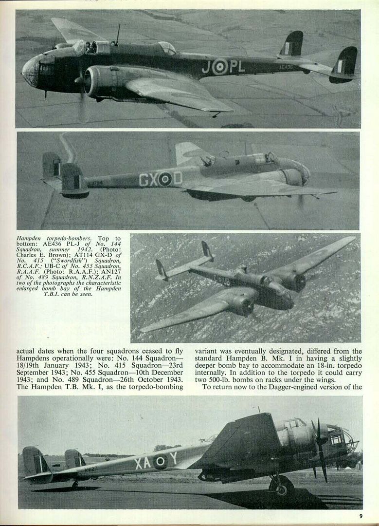

Richard M Posted March 24, 2008 Share Posted March 24, 2008 Here's a scan of Warpaint No58 HP Hampden, page 9, which mentions the torpedo Hampden's, the scheme in the photo's does seem light. You can just make out the altered bombay, the text also states there were additional hardpoints on the wings for 500lb'ers. Warpaint No.58 page 9. Best Rich Link to comment Share on other sites More sharing options...
Test Graham Posted March 24, 2008 Share Posted March 24, 2008 (edited) As above, what you can see is the altered gun position. The bottom of the bombbay doors remain parallel to the upper fuselage, as on all Hampdens. I've never seen any Hampden photo showing EDSG over Sky: in comparison the Coastal white scheme is well documented, although not on operational aircraft. Edited March 24, 2008 by Graham Boak Link to comment Share on other sites More sharing options...
