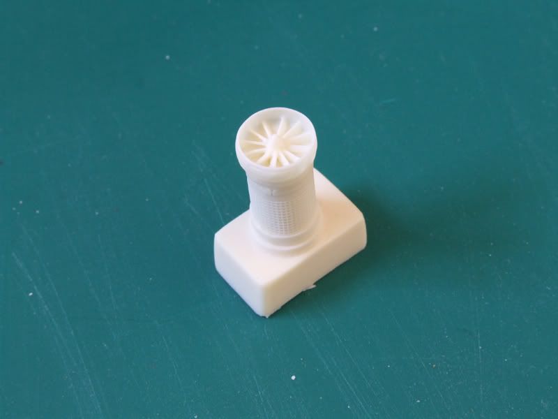

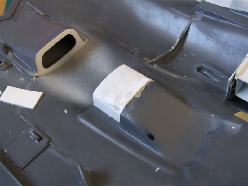

Skii Posted October 11, 2008 Author Share Posted October 11, 2008 cheers Melchy , its certainly an inspiration to work to, and I've been chatting to a certain Mr Vojtech via email, he's been most helpful in assisting me with images from his build and reference pics for the engine intake assembly, hes certainly a very nice and helpful chap Talking of helpful chaps a certain Mr Neil Burkill has been helping me out again with my engine, he very kindly has cast me some perfect copies of the engine and treaded wheel as I didn't fancy the prospect of attempting to make 3 more identical copies !!! So I've been working on the engine intakes and exhausts, firstly the kit exhaust plate which fits into the rear of the upper wing was drilled out, more on these later Next the air intakes, I dremelled them back in order to accomodate the resin engines, this necessitated building a u-shaped channel from styrene card and mounting it in place with copious amounts of CA, once secure the upper side was smoothed in place with milliput and sanded / primed until a seamless channel was created on both port and starboard sides. now with the lower intake assembly done I turned my attention to the upper intake assemblies, here is the part before The auxiliary doors were cut open and styrene card strips inserted around the door holes, these were drilled and provide a base for the auxiliary doors to sit on, a central splitter plate has also been added to the upper intake mouth. Whilst figuring out how to mount the engines into the finished channel I decided to try to use the casting blocks whilst still attached to the engine, 2 of these separated by a thin sheet of styrene card holds the engines together perfectly and can be fixed in place to the fuselage - hey...it works !!! Now with the engines in place the upper intake assembly in place shows a glimpse of the engines through the auxiliary intake doors From the front more to come Link to comment Share on other sites More sharing options...

Neil Posted October 11, 2008 Share Posted October 11, 2008 Talking of helpful chaps a certain Mr Neil Burkill has been helping me out again with my engine, he very kindly has cast me some perfect copies of the engine and treaded wheel as I didn't fancy the prospect of attempting to make 3 more identical copies !!!Whilst figuring out how to mount the engines into the finished channel I decided to try to use the casting blocks whilst still attached to the engine, 2 of these separated by a thin sheet of styrene card holds the engines together perfectly and can be fixed in place to the fuselage - hey...it works !!! more to come Blimey, the postman must of been wearing a personal jet-pack, I only posted them late yesterday afternoon Coming along nicely John. Link to comment Share on other sites More sharing options...
