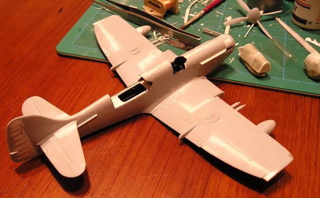

Col. Posted May 5, 2007 Share Posted May 5, 2007 Thought it high time I posted something to prove I do build models as well. This one's been going for nigh on a year now, although there has been several art projects broken into it's progress as enthusiasm waned with alarming regularity. Here's most of the work done on the 'pits. Then with some black splashed on and a little dry-brushing. Next up was the undercarriage bays. With the main airframe components together it was time to get the filler out. Link to comment Share on other sites More sharing options...

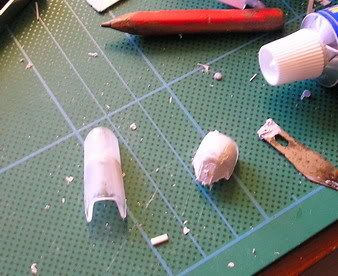

Col. Posted May 5, 2007 Author Share Posted May 5, 2007 Lots of filler! This is it's current status. I'm not going to list the number of corrections and additions made but lets just say the Airfix kit has only a passing resemblance to the real thing There has been several occasions I've come close to making a test flight to the bin with this thing and buying the Special Hobby kit. Latest problem is getting decent canopies moulded. I've re-shaped the inaccurate and overly thick kit parts but just can't seem to get the hand of crash-moulding replacements. Oh well, keep practicing and hope for the best Link to comment Share on other sites More sharing options...
Dave Posted May 5, 2007 Share Posted May 5, 2007 Keep with it it's coming along nicely. I especially like the detailing you've done to the cockpit, I couldn't do anything like that in 1/72! Link to comment Share on other sites More sharing options...
Mike Posted May 5, 2007 Share Posted May 5, 2007 I watched this take shape over "there", and provided some encouragement when needed.... here I go again... Come on my son!!!!! Home straits! btw - How're you doing the crashforming? Some of the chaps might be able to provide some assistance, so you can get it to work? Link to comment Share on other sites More sharing options...
Col. Posted May 5, 2007 Author Share Posted May 5, 2007 Cheers for the encouragement chaps, really want to get this one finished so I can get stuck into other projects. Mike, I've been using the oven to heat clear sheet fixed onto a piece of plywood with a hole slightly larger than the parent part until soft then pulling it over the part, which is fixed slightly above another piece of plywood with several small holes drilled through it to allow a vacuum effect provided by the wife's Dyson. (BTW, if Fiona ever reads this or catches me I'm soooo dead!) At the moment I'm getting the shapes formed better as I perfect the set-up and timing but the plastic keeps getting a brown tint, almost as if it's heated too much and starting to burn. Was wondering if anyone can recommend an alternative heat source, say a hairdryer or perhaps the toaster? Link to comment Share on other sites More sharing options...
Mike Posted May 5, 2007 Share Posted May 5, 2007 So it's the plastic, rather than the technique then? A lot of people swear by the acrylic stuff you get a lot of xmas card packs in. You know, that annoying, clear, stiff stuff? Some people use coke bottle material too. I've not perfected my vacforming technique with clear yet, as I was tending to use too thin a sheet. I gave up building the 1:48 Stirling before I needed the glazing, so it never came to fruition. Link to comment Share on other sites More sharing options...
Mike Posted May 5, 2007 Share Posted May 5, 2007 Oh, and I've used a paint stripping gun from 12" before now to re-heat the plastic after the initial vacforming... seemed to work without any browning. Here's my setup... The other end of the box has a hole that my cheapo Tesco vac fits snugly into: Link to comment Share on other sites More sharing options...

Mike Posted May 7, 2007 Share Posted May 7, 2007 Now that's a nice set-up Mike! Time I had a rummage in the shed for some spare bits of wood and associated tools methinks.Don't skimp on the holes if you decide to build one Col... I could have done with more, if I'm honest. Now if you'll excuse me I'm off to burn my fingers and destroy various household items in a continued attempt to produce a usable set of canopies. If someone would be so kind as to notify the Fire Brigade... Link to comment Share on other sites More sharing options...
Col. Posted July 2, 2007 Author Share Posted July 2, 2007 After taking Mike's advice and turning the heat gun on some thin clear sheet I've finally got a usable rear canopy With any luck the same method will produce a front canopy tomorrow I'm also toying with the idea of finishing her as the RN Historic Flight's preserved example as opposed to the service machine. This means I can avoid scratch-building the remaining radio gear for the rear 'pit and the gun-sight for the front, although I will have to do some repainting of small cockpit details and make various extra parts such as aerials, the radio that sits where the gun-sight would have gone and a more complicated seat harness. Link to comment Share on other sites More sharing options...

Col. Posted July 5, 2007 Author Share Posted July 5, 2007 A quick update on this one for you Oliver, got a couple of usable transperancies for each canopy moulded today so if I get some time to myself tomorrow I'll have a crack at test-fitting them. This might encourage me to get the seats finished and make the radio unit for the front office. Link to comment Share on other sites More sharing options...

Mike Posted July 6, 2007 Share Posted July 6, 2007 Cheers mate, if you have that would be great. I was considering making the windscreen from thicker plastic to ensure a scale effect but that would save me a lot of work.Let me know what you want for it if you do have a spare. I'd use something thicker, as the thin stuff just picks up EVERY imperfection in the master. I had that trouble on my Stirling, just never got around to getting any thicker stock. Link to comment Share on other sites More sharing options...
