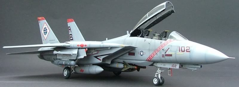

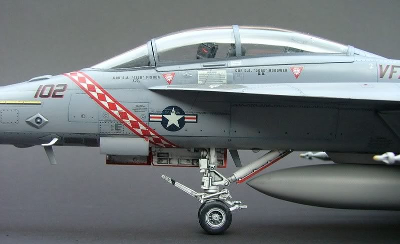

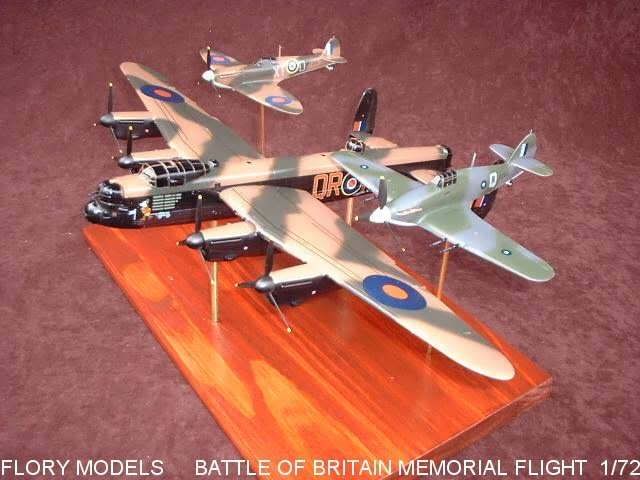

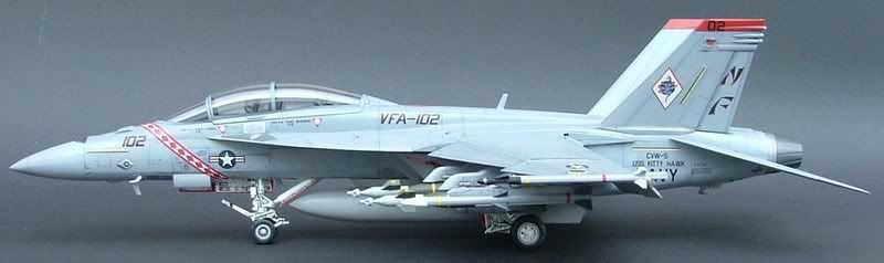

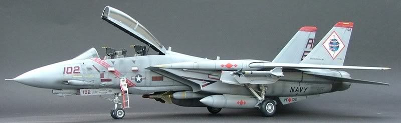

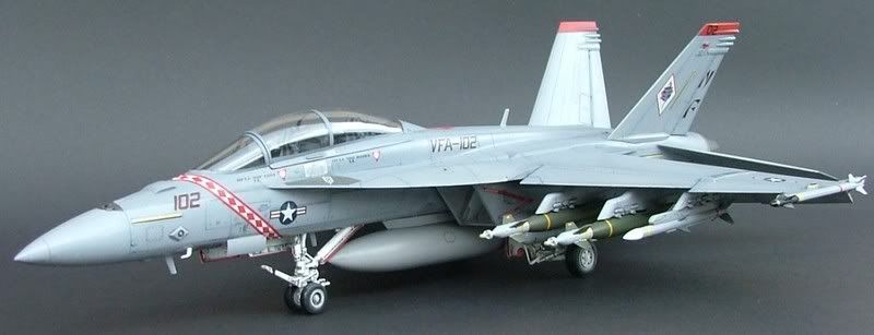

A bit of a collection done for VFA-102 Diamondbacks last year.
The VFA-102 Diamondbacks - 50th Anniversary DVD can be see here in two parts.
for part 1for part 2 -

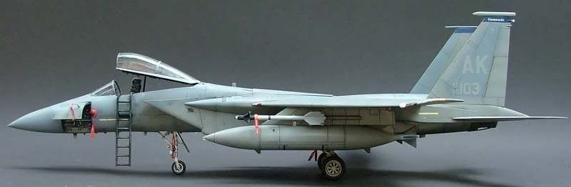

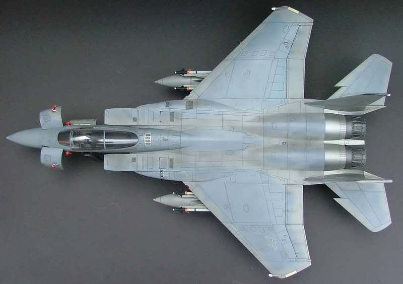

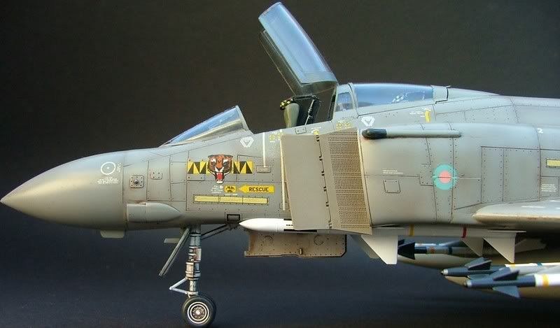

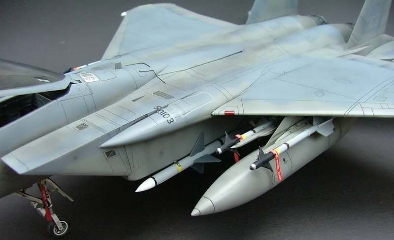

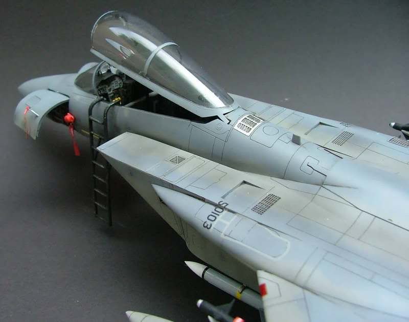

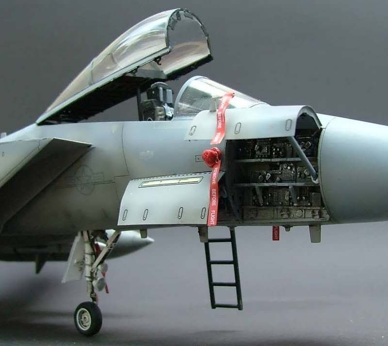

This is a f-15C Eagle I did a few years ago. As far as I know it was donated the fighter museum in Elmendorf, Alaska.
Sorry it's gray, but I thought it needed a airing

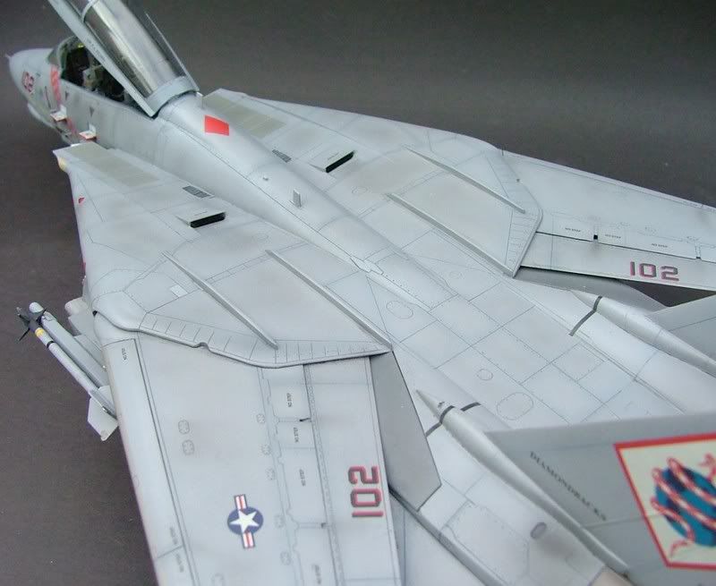

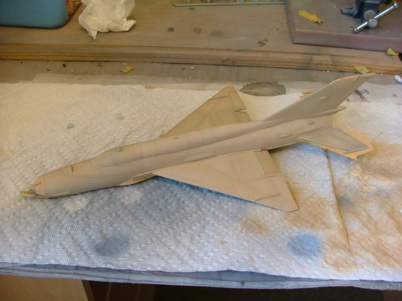

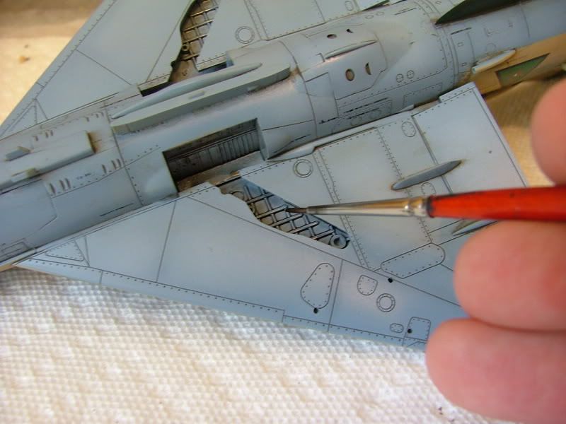

OK panel lines, I think most modelers make to much out of a simple processes. It seems to cause no end of problems to the beginner. I think this is because people over complicate the process, this is how I have been doing it for the last ten years and never had a problem.
This is my own mix that has taken some time to get right. It's a clay mixed with a few other things pixie dust etc.
Firstly make sure the model is completely dry, this is a must or the mix will weld itself on. It doesn't have to be a gloss Finnish in fact this works just as well on a mat finish.
Then using a soft brush slap it all over the model.
It will dry in about half to an hour, if you get areas that don't dry, a blast from the airbrush speeds things up
When dry it can be removed, don't worry about leaving this stuff on as I have left it on for three weeks to see if would come off OK which it did.
Next it's time to remove the clay. Using some good quality kitchen roll, which I cut into small squares, I lick to moisten, just a little a wipe off, that simple.
If needed use circular motions to remove the clay.
Use a cotton bud to get into the corners and tricky areas, then go over the model again to make sure you got it all off. If you do take it out of the panel line just re apply again.
Then the same thing for the rest of the model.
Remember to get it off any areas were you don't want it as when the model is given the required finished coat (Matt, satin or gloss) the clay will darken making it stand out a lot more.

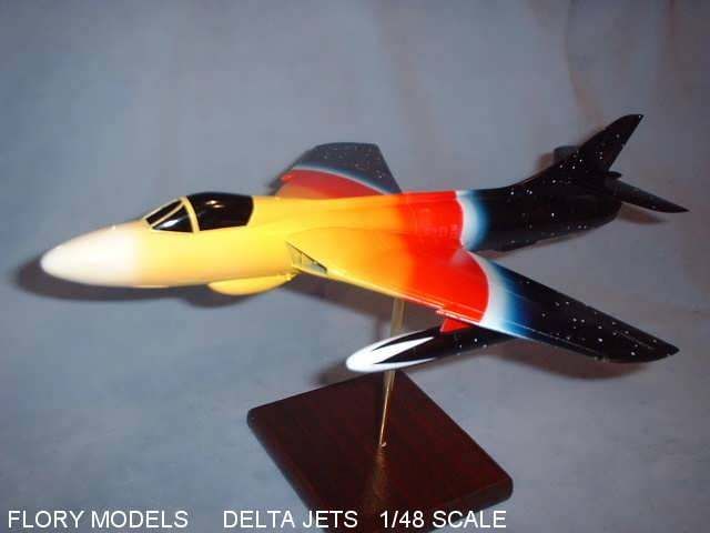

Ooh! I do like the Lightning, the grey Phantoms, and the Halifax, in particular. And I know someone who would like to know how you did the Hunter - he's trying to do it in 1/144 would you believe!
Cheers,
Chris.

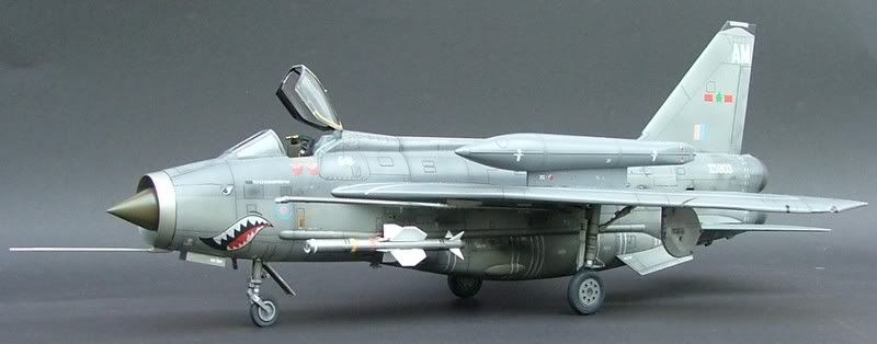

The hunter is done free hand apart from the red to white. White on the nose then yellow, orange, red, white, then the black which comes though as blueover white. The stars were done with a cocktail stick.

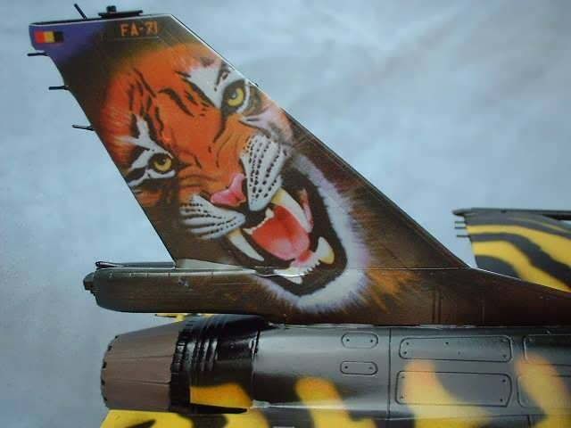

Then this morning started decaling it. I use pain warm water to soak the decal and brush the area with the same water. I slide the decal of of it's paper with a brush and place it on the model, I only use the brush to move the decal adding more water to help it move, when i'm happy with it's position I roll a cotton bud over the decal to remove the water. Strait after that I brush on Tamiya X-20A acrylic thinners and let it dry, I have found the thinners the best way to stop silvering and sofen the decals.
Heres a few more.
Next is a further two caots of future and left overnight. Then the fun part the sludge wash.
This tail is of a f-16 the first time I tride the thinners and I was amazed how well it worked. To date I havent found anything better.

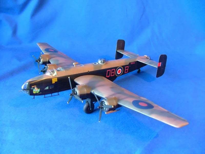

I had planed to do the lightning in metal Finnish but I ordered then from hannants
So after a week I gave up waiting, so I went for the two tone scheme

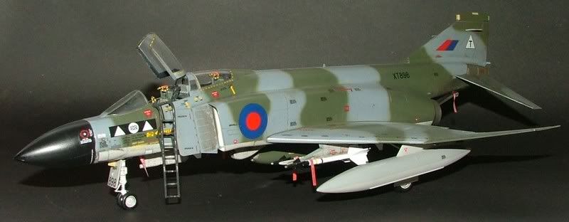

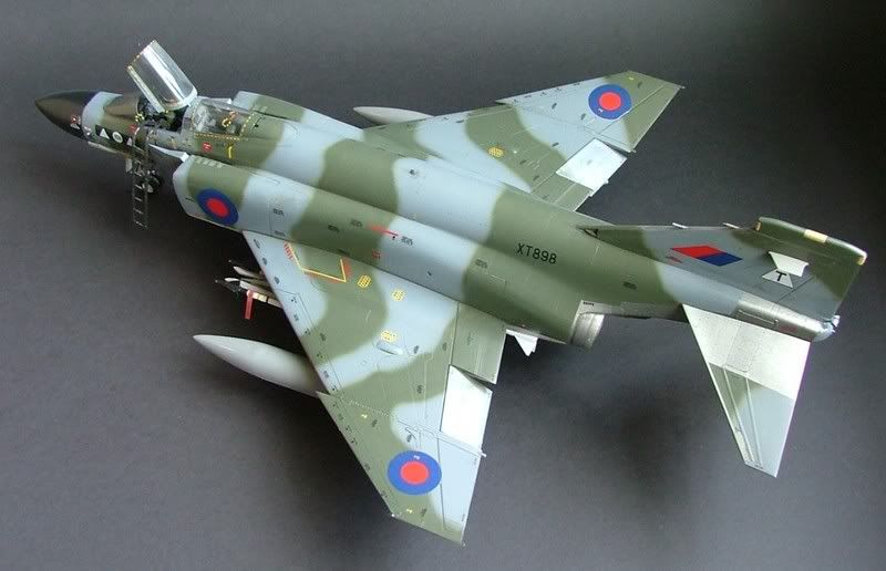

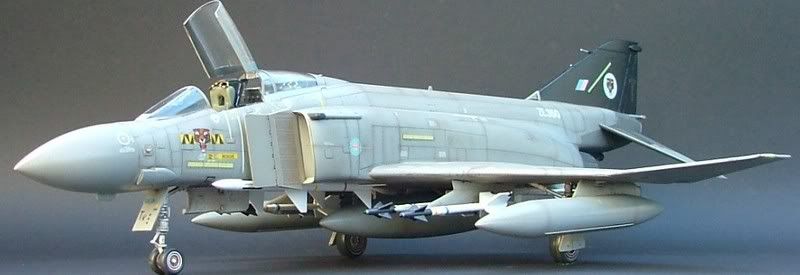

Haven't done to many British aircraft but here some

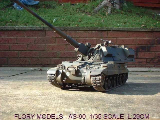

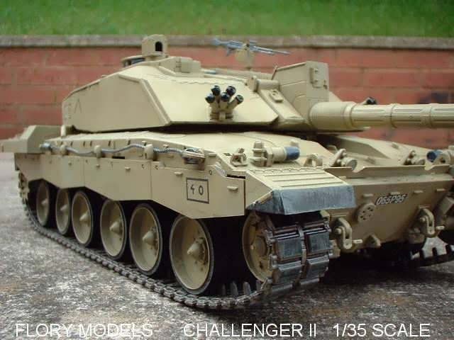

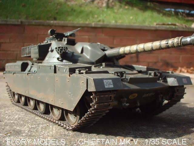

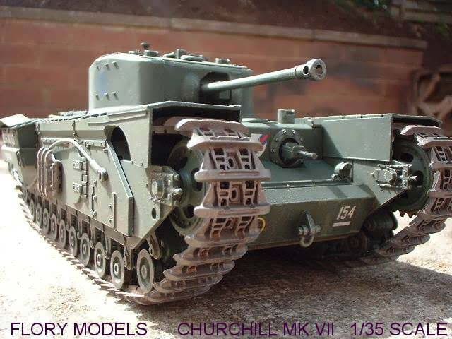

and ive found a few tanks from waaaaaaaaay back.
So what should be next?

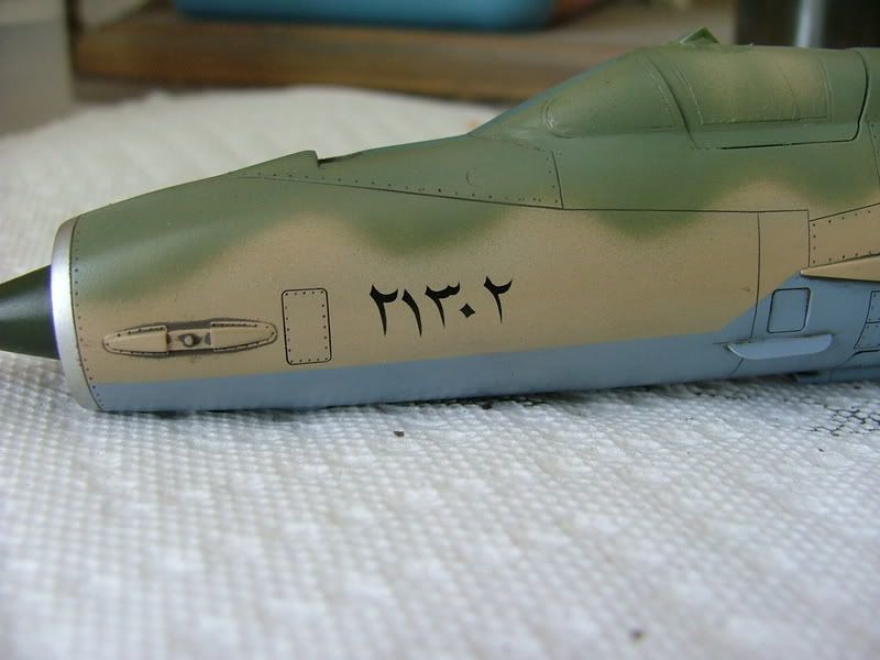

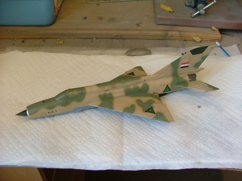

Hers the top sand colour done just the same as the underside:
Next the green thinned down a lot and air pressure to about 5 to 10 PSI. All free hand I have never got on with masking, it never looks right on worn paint. I added more white to the green for a little sun bleaching.

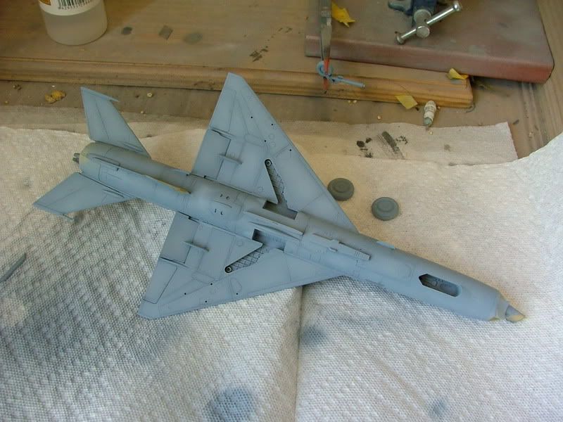

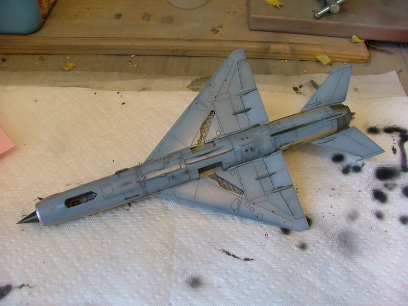

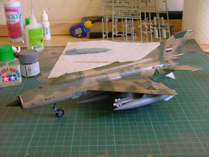

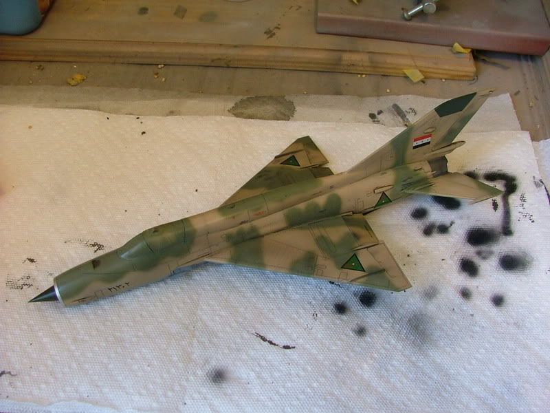

OK, so a quite heavily thinned first coat of blue/gray went on first, and then next a heaver coat.
Being acrylic it dry almost strait away. The second coat went fine so with what was left in the airbrush I added about a third more flat white and thinned heavily.
I then went around the centre of all the panels with the mix to add some tonal variation to the colour. At this point the pre shaded areas really come to life. I will leave it for a hour then mask up for the sand top colour.
This one is a sod to get going, I'm running out of fingers

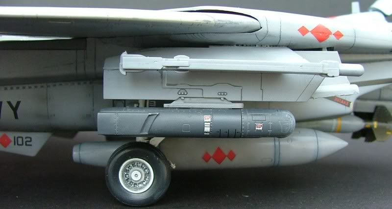

I use thinned down Tamiya smoke X-19 for wheel well, undercarriage etc,
Then it's out with the airbrush and free hand spray the weathering all over the model, lots around the belly and rear.

Just all the photo etched parts to go on.

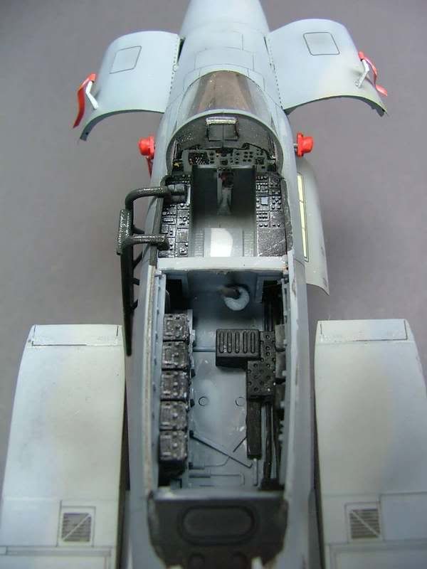

A look in the cockpit, de-mask and install the seat and stick.
Just a few more things to do but almost done.
