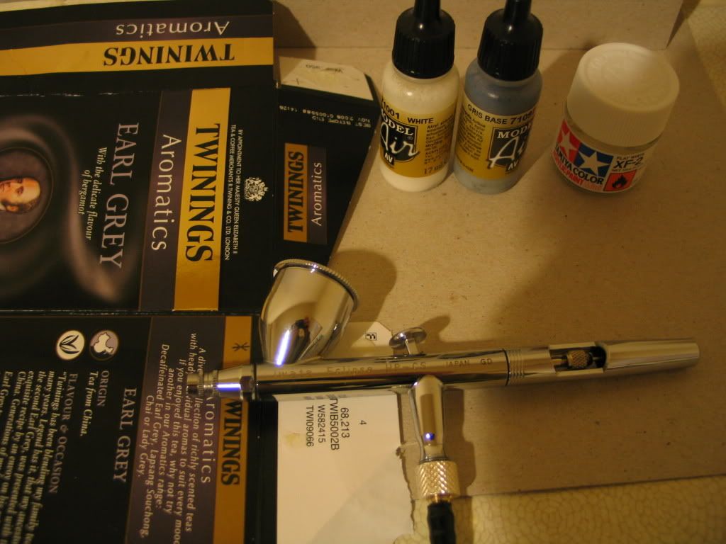

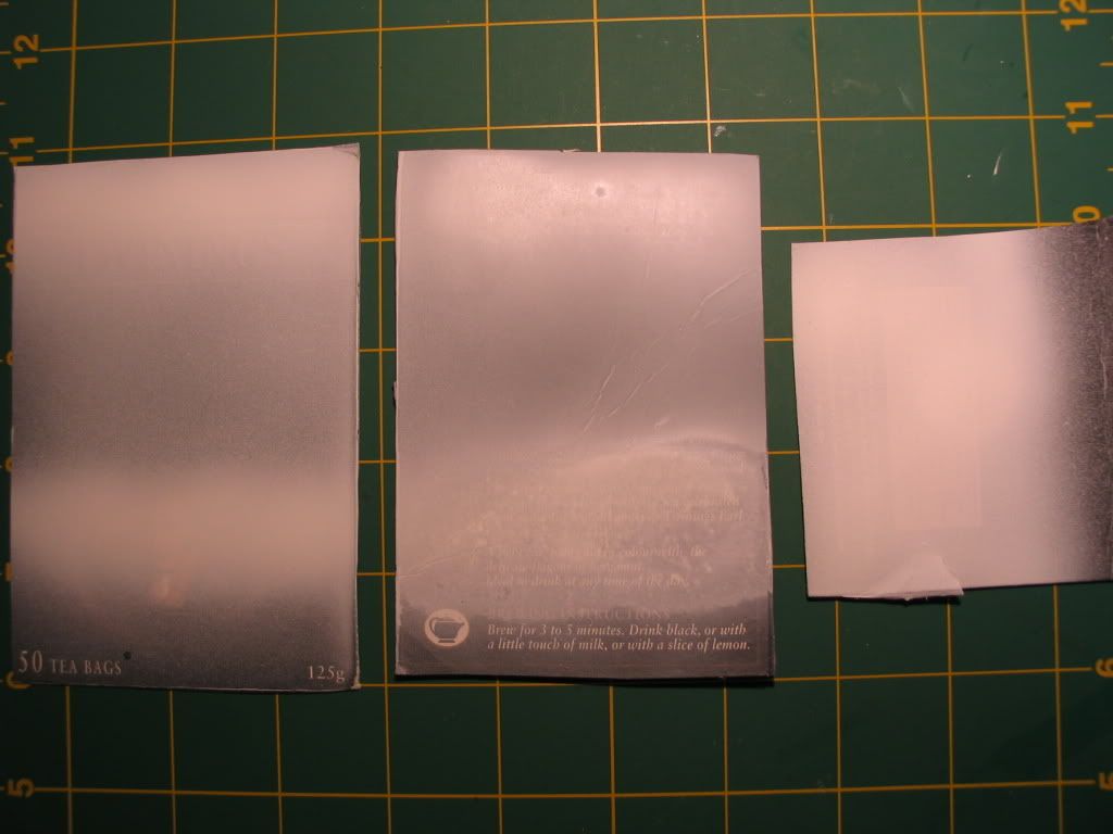

I have been fiddling....I decided to do a bit of a test with white...(in no way scientific and not on plastic)
I used a Tea box as it was dark and has a design on it (and was at lying about at the time). It has a silk sheen to it.
From Left to Right, the first card has the top half sprayed with Vallejo Gray primer, it's similar to Halfords grey
primer but doesn't stink my flat out and i can spray it through my airbrush. I then sprayed one coat of Vallejo 71001
Model air white over the whole card. then another coat 1/4 up the card and another at the top...you get the idea??
good!
I then did the same with the next card but used Tamiya Flat white XF-2 mixed about 50-50 with Tamiya acrylic thinners.
The first 2 cards were both sprayed at 15 PSI
The final card is 1 coat of 100% Tamiya XF-2 Flat white sprayed at 25 PSI.
My Iwata has a 0.35 needle.
Conclusion:
The Vallejo went on well straight outa the bottle on both primed and unprimed surfaces, about 3 coats would acheive
good results here i think.
The Tamiya didn't go on as well on the unprimed surface. This may be fixable by mixing more paint in and with a bit of
experimenting i'm sure you could get similar results to Vallejo.
Tamiya Flat white 100% went on quite well(my 0.35 needle probably helped here), a bit speckled and dried as soon as it
hit the surface, maybe before? but this kinda proves Phil right (I do not in any way shape or form work for Pro Modeller)
So there you have it... If in doubt, Fiddle!

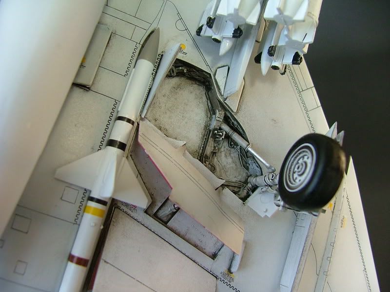

But the obvious giveaway is that he left out the Aries F-4 wheel bays, you know , the sort of installation job that only true modelling gods like us can aahive
I've use them lots of times before, but to be honest the kit parts aren't that bad.
This is the aires ones on Show time 100
And this are the standard kit parts.
So there's not alot in it.
