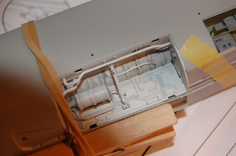

The wheelbays are a mix of interior green and matt yellow and although darker than the chromate yellow Visually I didnt think it was far off BUT my phots arnt the best and appear to be highlighting a few "issues" with my build, although Im happy to share.
On reflection perhaps a few more pipes and wires would be in order. Ive yet to wash a second time and do a little highlighting.

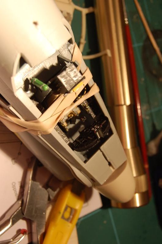

Ok here's an update and tale of slight disaster.
Wheel wells were put together and lightly washed, Equipment cabs likewise. Gun constructed and painted steel and intake further sanded to smooth the line between converter and intake.

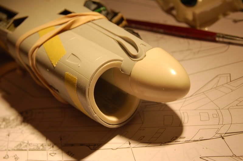

Now the disaster, despite numerous dry runs and test fittings, I came to the point of joining the body halves. Intake was placed into the body along with the cockpit and gun. Then I went for it! Starting at the business end I glued the body halves and worked my way to the rear. THEN in went the nose with cryo glue and BUGGER it set slightly skew which in turn threw the cockpit combing out along with the Zacto screen framing.
:shithappens: But then we are modellers not just assemblers right?
Anyhow desperation and alterations brought the following results.
This is the result with the outer ring in place
Hands up all those who think this looks like the gob of a basking shark?
smoothing the body joints and wing areas next.

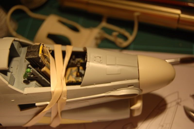

The first part of the surgery has finished and my Sluf is well and truly in recovery!

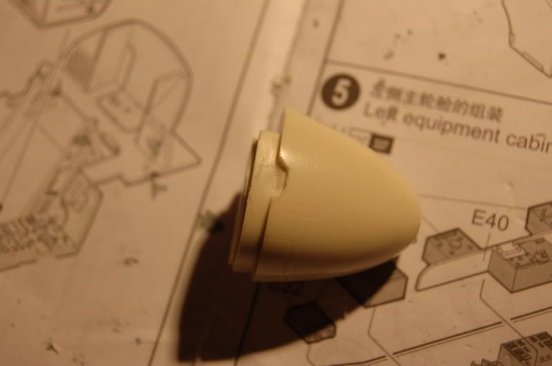

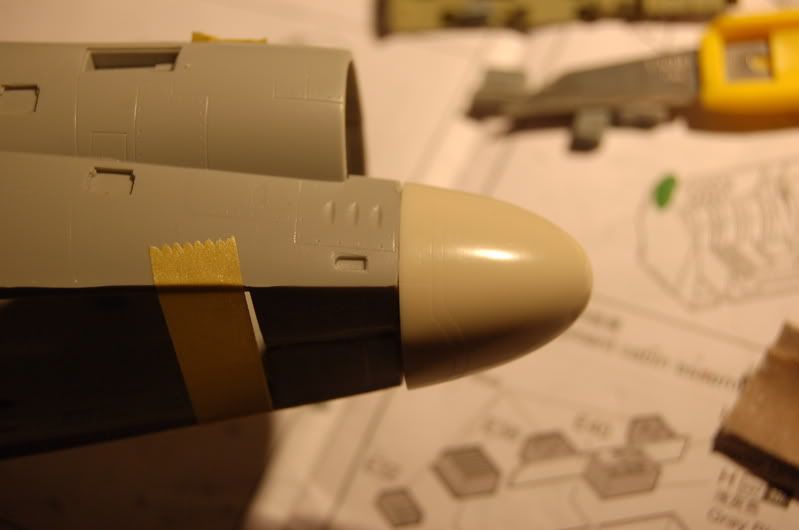

First the nose came off!
Then got replaced by the Zacto nose (dry fitted many times)

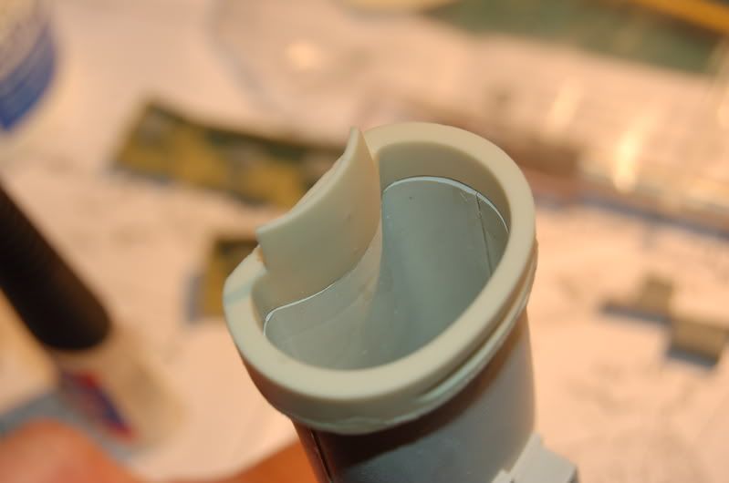

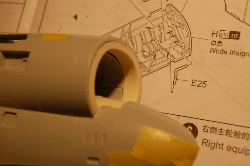

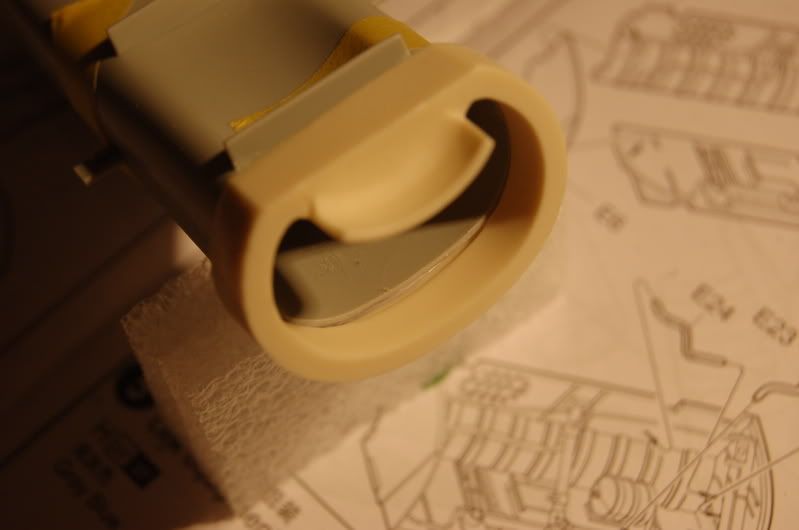

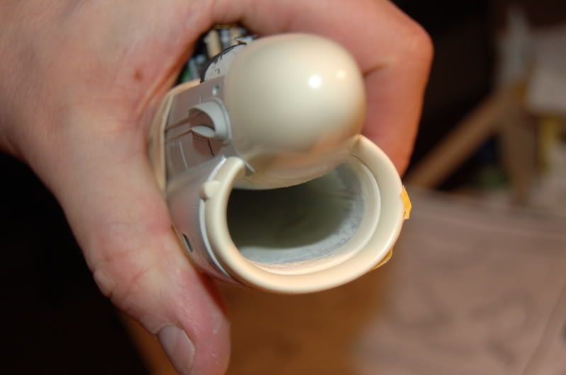

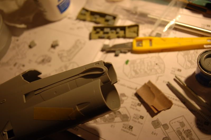

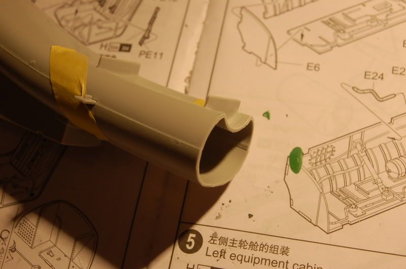

Then a coup with the intake. Having sprayed the inside white, I got to thinking how to avoid all the filling and sanding to get rid of the gap between the profiles of the converter ring and the intake.
I tacked the top of the converter ring onto the intake with superglue and then by gently squeezing the sides of the intake, the plastic filled the profile of the converter ring. Still pressing the intake, I heated it gently with a hairdryer and hey presto it stayed in place. I then plastered the outside of the ring with superglue and set aside for more work tomorrow.
The remaining tiny gap will be filled with either pva or superglue, I havnt decided yet, and then painted again.
These are the results.
Think iive saved myself a good few hours here!

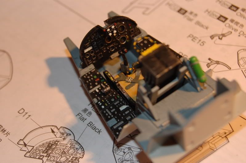

Dont do what i did and forget completely to paint the interior of the cockpit framing!
And that was simply beacuse I was so eager to finish it. DOH!.

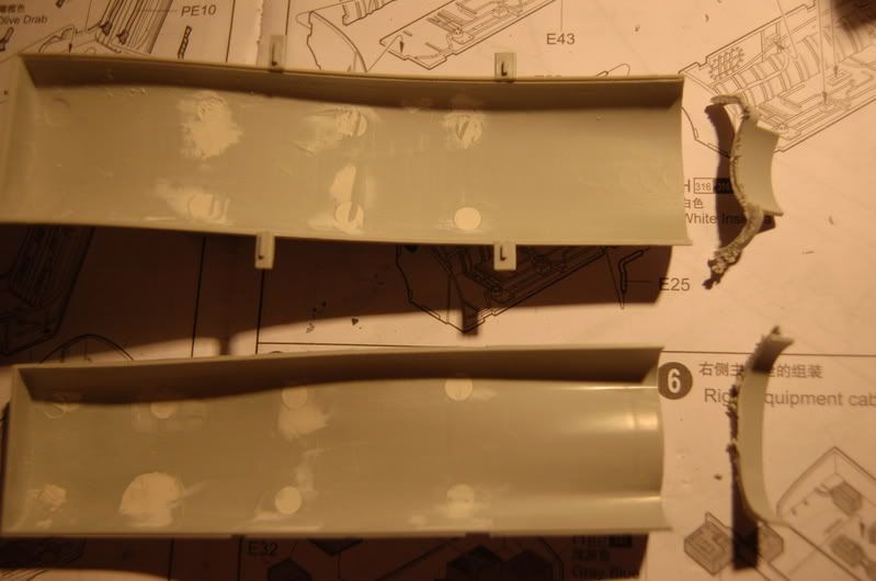

I stuffed together the wheel bays and filled and sanded the injector pin holes in the intake. No dramas there then.

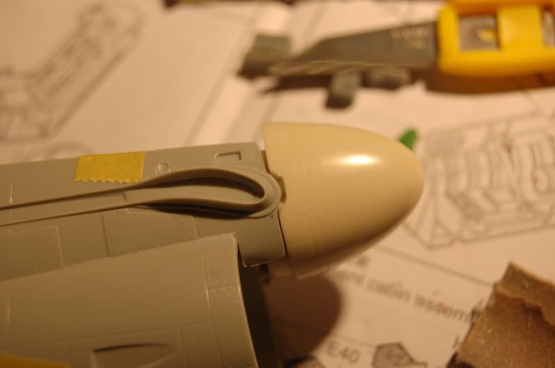

I couldnt resist getting into the Zacto stuff so it was on with the air intake.
I have to say, I am amazed at the difference in the profile of the Kit intake and Chris's resin converter piece. Its attention to detail that makes the difference and Chris has even made the recess for the kit locator pins to sit within the ring. Zacto I salute you!

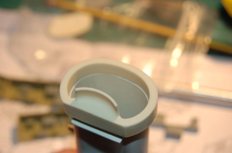

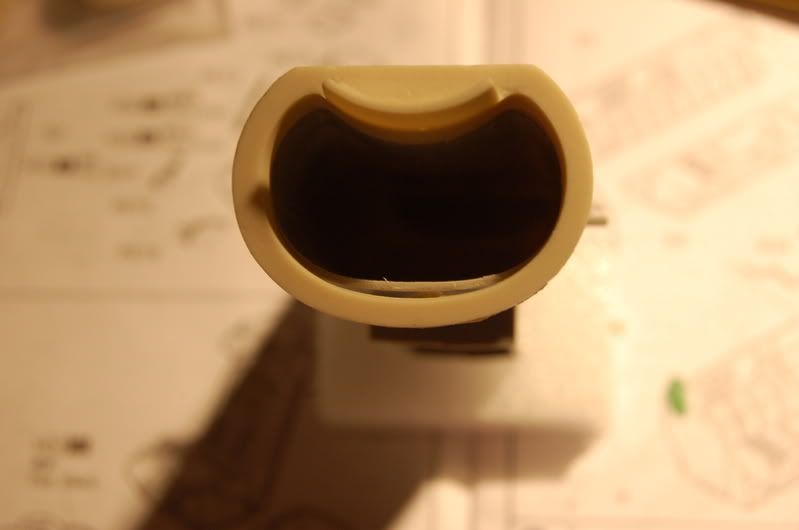

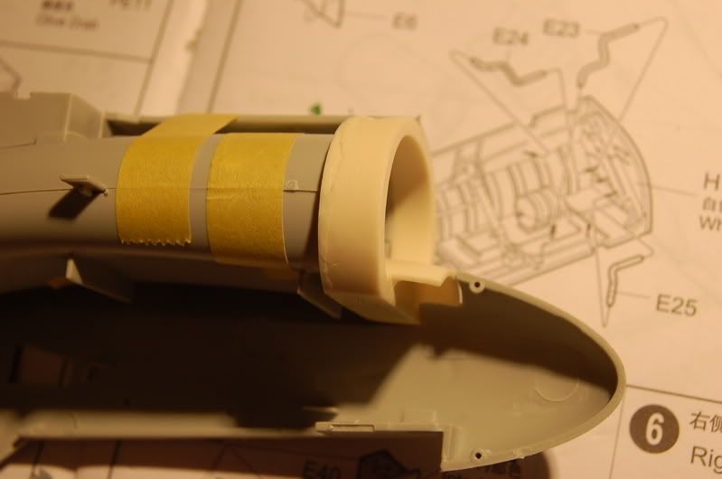

Then it was surgery time. As per the clear instructions I started cutting the intake about removing this amount of plastic for the converter ring
.Word of advice, cut smaller than the dimensions in the instructions, then sand sand sand, regularly setting the intake and converter into the body.
You should end up with this
See the difference in profile? a serious gap to be sorted!
End result
how flush is that?

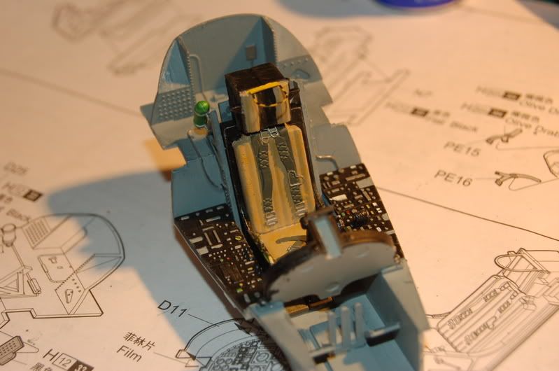

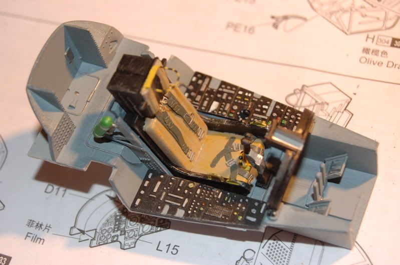

Yes the bang seat does indeed look a little strange probably beacuse there is no representation for the chute pack which I think is on the top of the seat although If anyone has a clear picture of an E model seat I would be obliged.
The kit itself was a 2006 Christmas pressy and the Zacto Kit a Birthday pressie. I would have liked the Aires pit but ive run out of pressie celebrations, that and were saving for our Kids big family hols......
I do have a spare Aires seat which is from an F 18, however this ,I think is too modern a seat for the A7. Can anyone give any guidance?

The cockpit

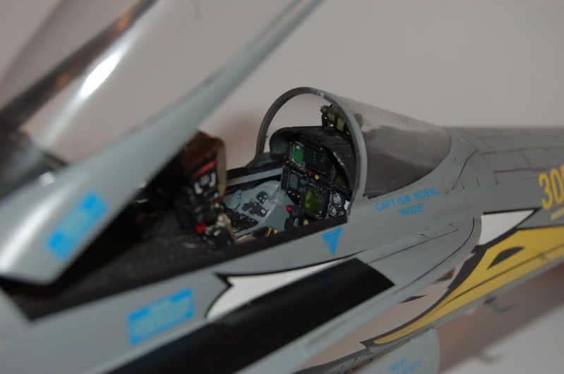

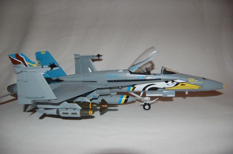

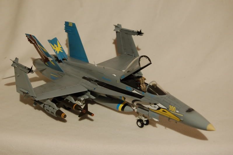

Heres a couple of my previous builds from last year all 1 32
Hope you like

Have a look earlier in this thread. Periklis kindly pointed me in the direction of a couple of sites re this very subject.
My understanding of what I have read is that the Stencel seat was designed specifically for the A7E no mention of the D.
Its adoption was not apparently accross the board so it appears the D was fitted with Escapac and the e had the option of the Stencel in replacement so some e's did some e's didnt.
