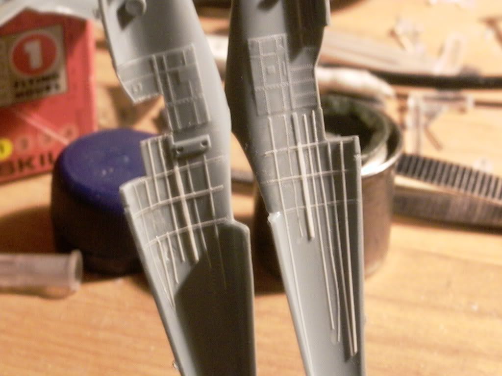

Not bad Sev - some of those longerons are a little wobbly though :sour grapes:
The same worried me at first, therefore I glued using CA in the first two attempts (XII #1 and V.c). As I got assured, there's not too much to see and compare straight lines with, I switched over to raw perchlorethylene or xylene.

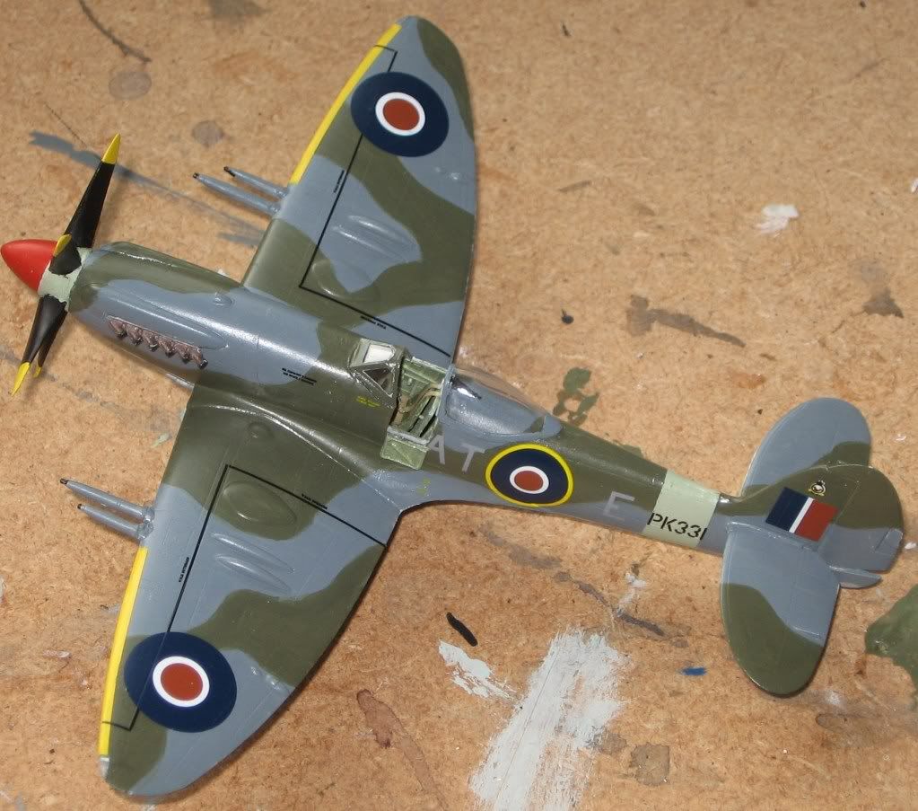

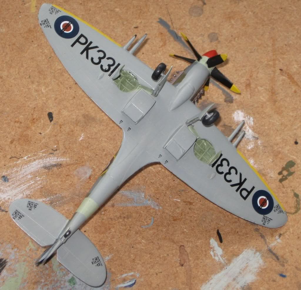

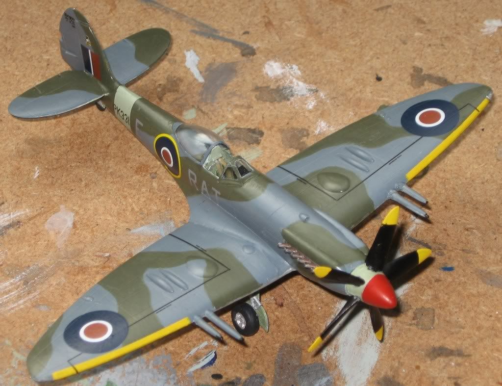

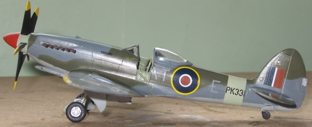

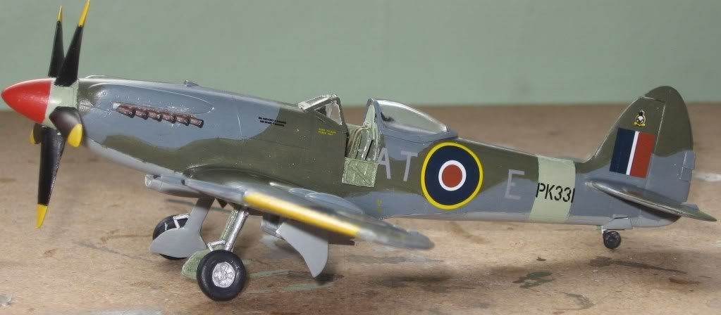

So, finished...
Not one of my best - the undercarriage doesn't look quite the thing - but all in all I'm happy enough with it.
Looks quite good! What a pity you didn't took your time on wheels and UC. Could possibly look better. BTW... Have you seen my XII's dashboard?

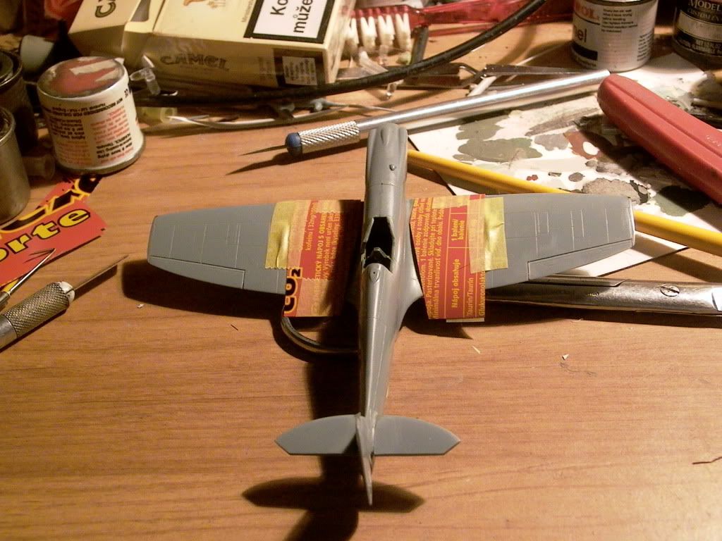

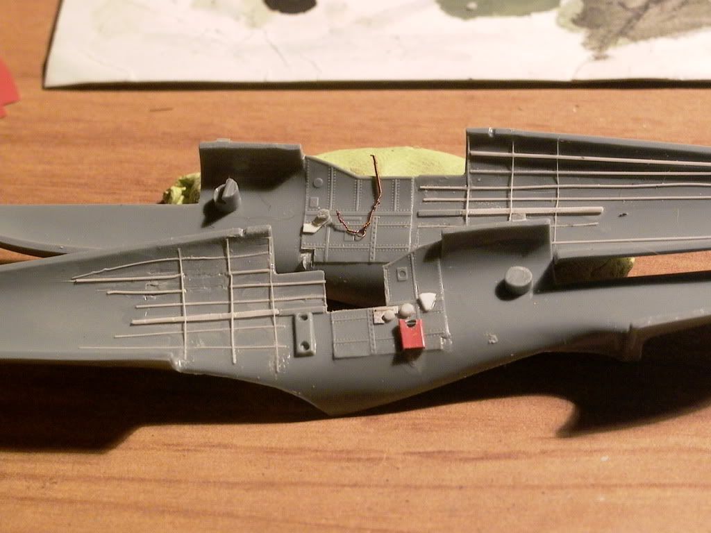

Raw result - will be puttied and sanded. And, yes, I omitted stiffeners.

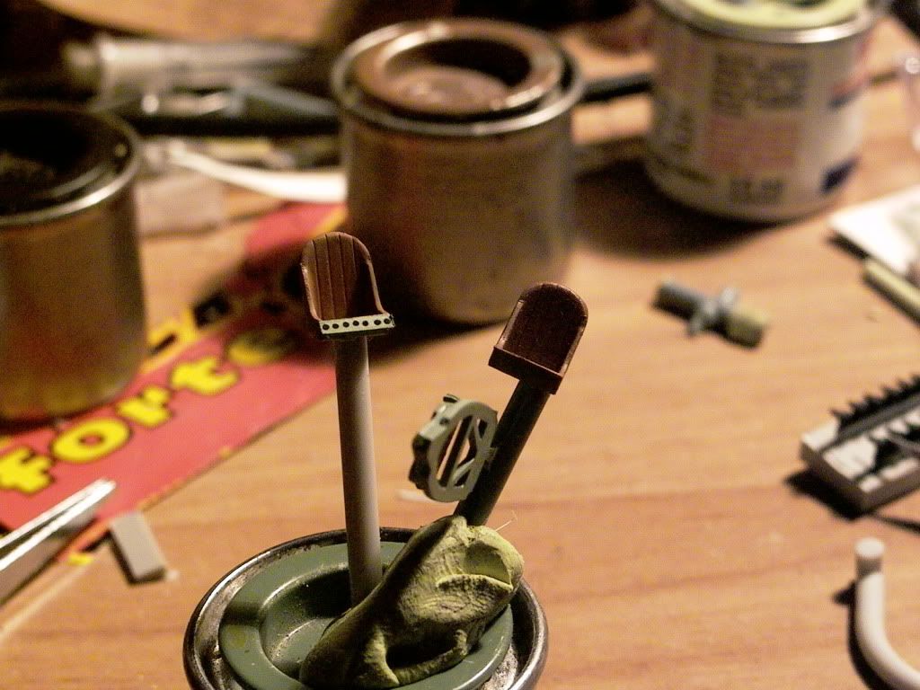

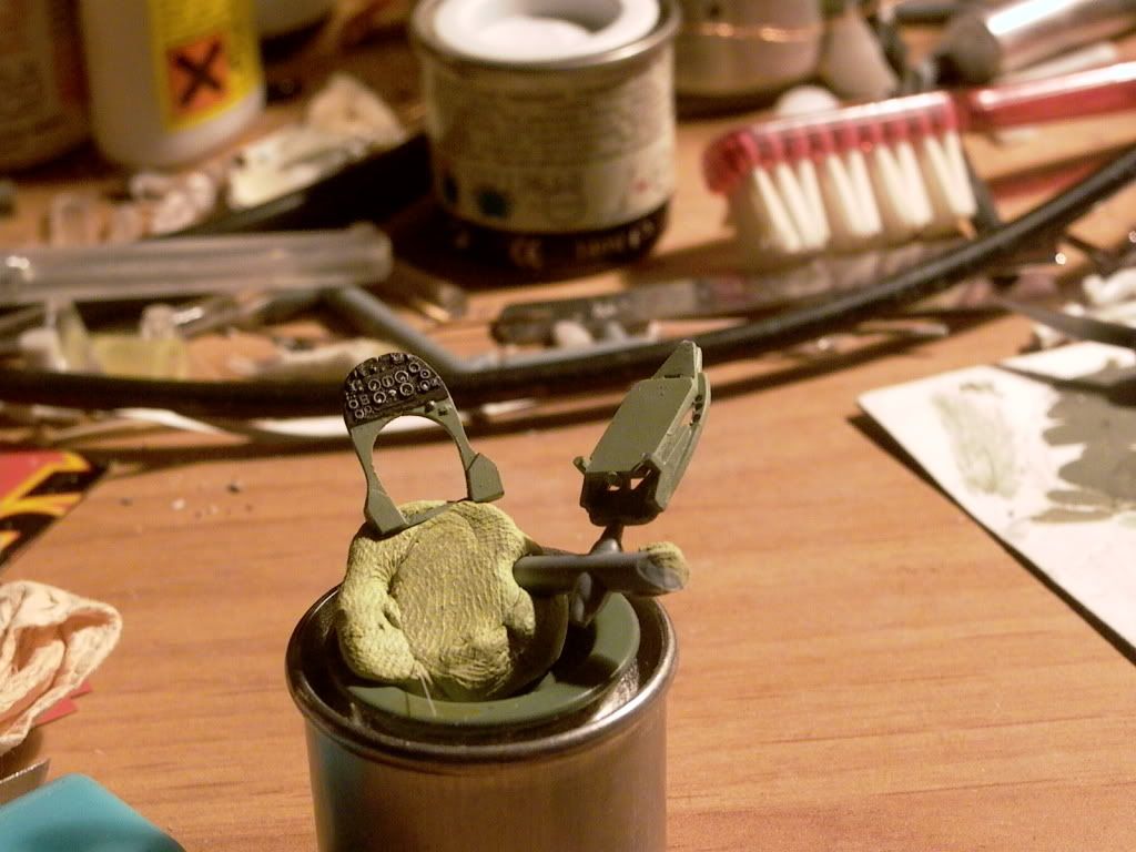

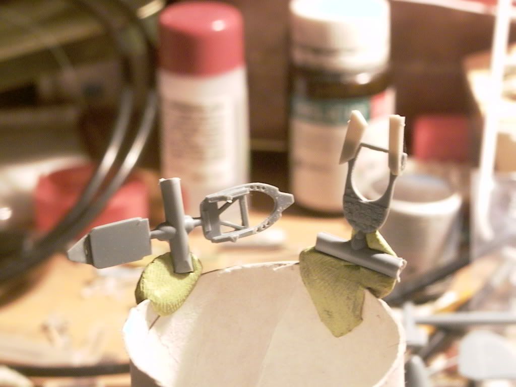

Some progress on seats...
Throttle quadrant (piece of sprue, wire etc.)
Oxygen hose...

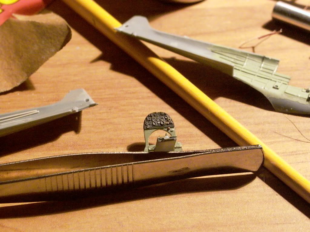

Dashoboard... Not convincing, but in such scale I don't think it's worth to spend more time on it.

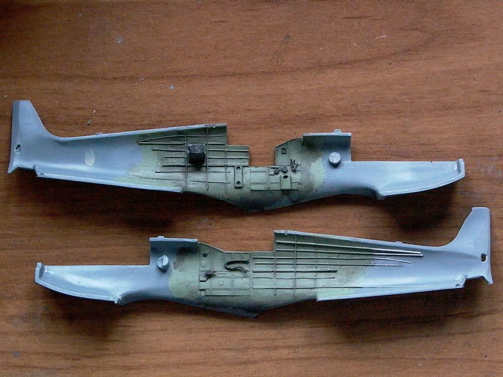

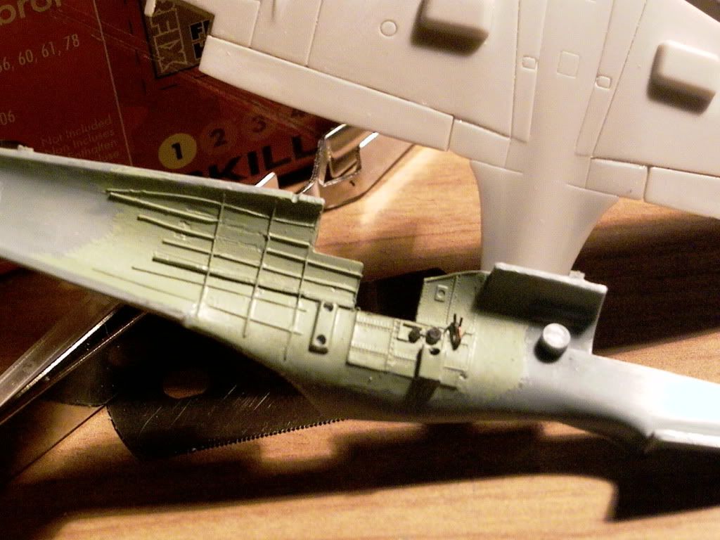

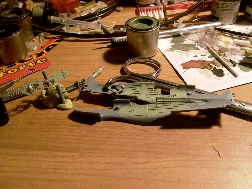

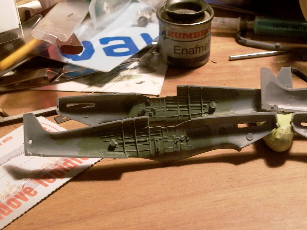

Some little progress:
Painting cokpit greygreen. Mixed from some Hu:95 and 78, as Hu:78 looked too dark.
And, because of this...:
...I made some masks for rationalising putty work:

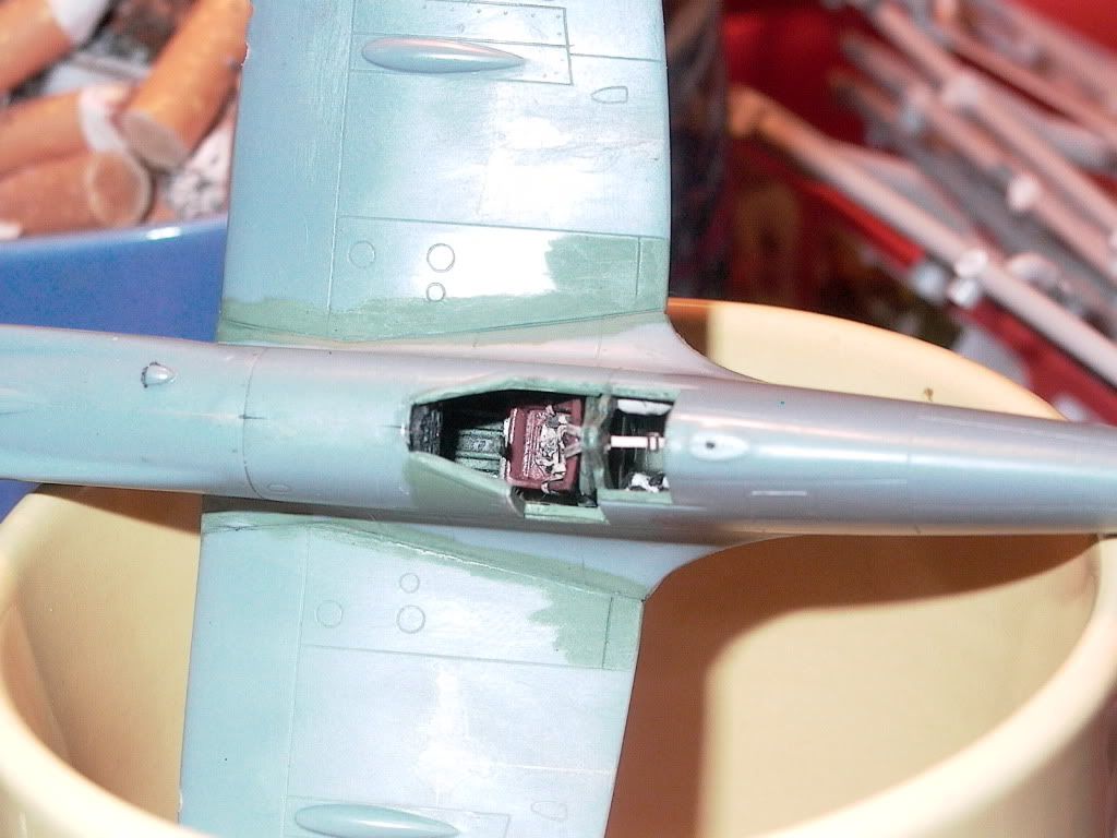

Furnishing cockpit a little from household items.
And cleaned instrument panel bulkhead, and gave the IP matt black coat.

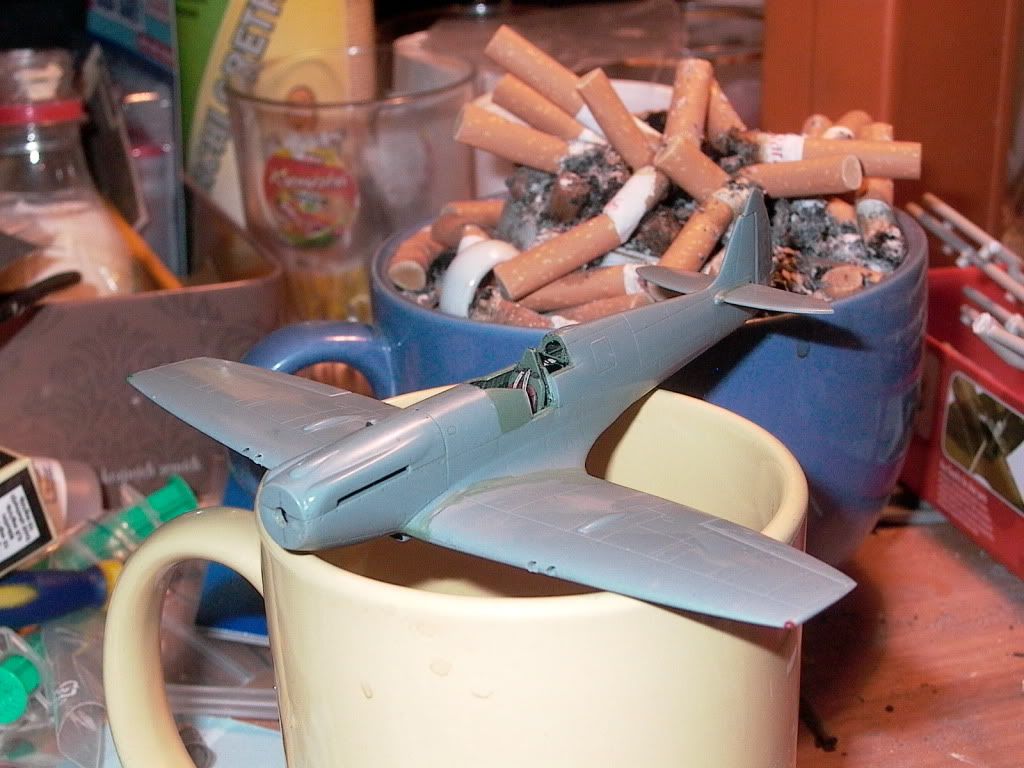

Smoke much?
It's just week collection...
Kidding... I collected it during months in basement, as we had certain difficulties with boiler's gas ignition. (Flame outs, combustion passing thru collector into mixer... Terrible), until I've been able to collect spare parts and repair it. So, just yesterday I took it upstairs, in the intention to really _dig_ out the content.

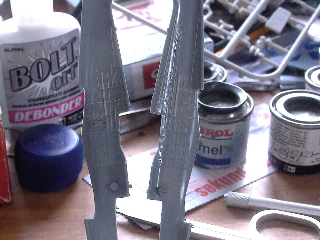

I've used two methods with variable success - one is to glue lengths of sprue round the inside of the well, then when the wings are joined, pack milliput into the gap to make the well. The other is to glue a piece of plastic cars over the well, then drill out the opening - this has ther advantage of letting you do differenmt levels of depth by onlu drilling out the 'round' portion, leaving the 'leg' area with a shallow well.
What do others do?

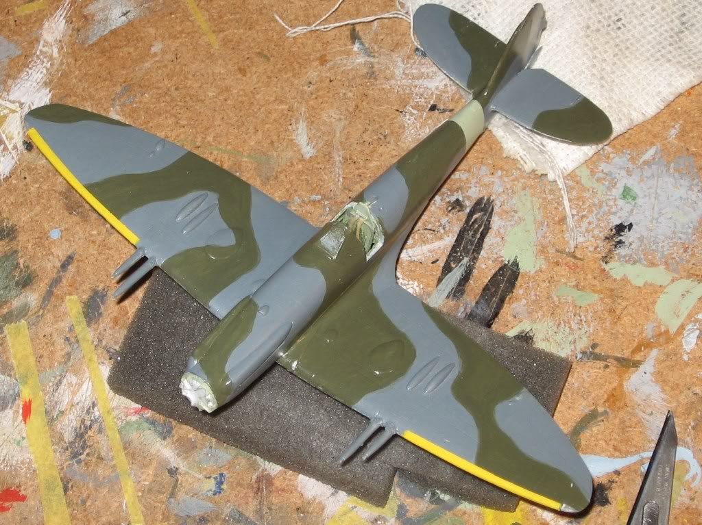

Out of curiosity I painted my Spitfire in a shade of blue lighter than the as then shortly to be standardised PRU blue. (I used WEM enamels as the starting point)
I'm not sure this looks light enough for K9791 in the above photo, but when I put it next to the squadron codes that are known to be medium sea grey the level of contrast actually seems to be about right. I notice a lot of other photos of aircraft painted PRU blue (after it became an official colour) appear suprisingly light, so maybe the camera/film of the time didn't pick up the shade well for some reason? Either way, whilst every fibre of my being says this is too dark, the logic kind of dictates I might have it about right!
