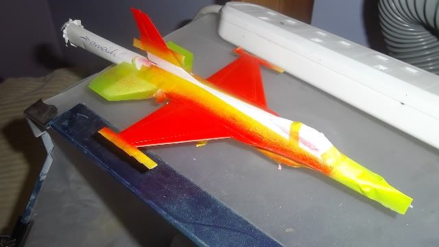

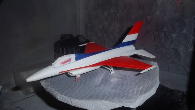

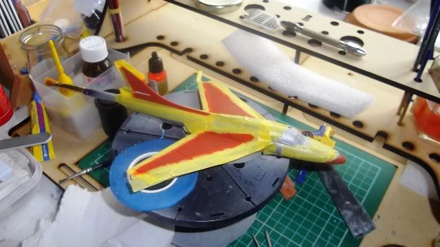

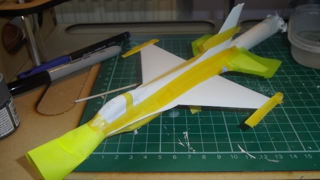

Made some progress over the weekend, with a marathon masking and paint session.
The result when the tape came off. Still some overspray to be dealt with, bleed through to tidy up and the black anti glare panel to finish. My airbrush / masking skills still need a lot of work.

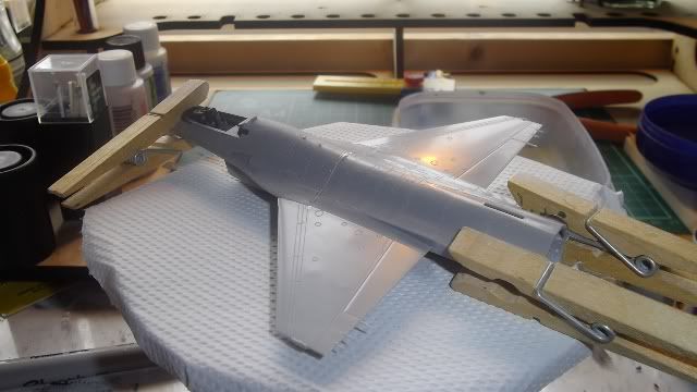

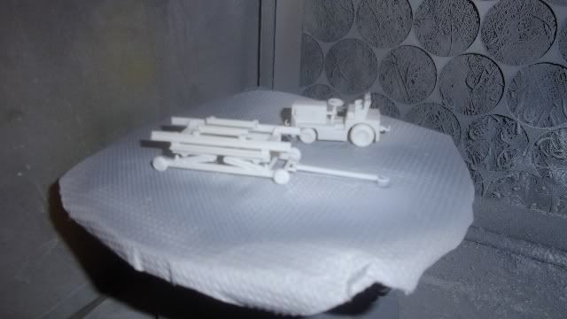

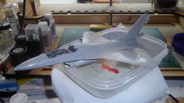

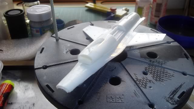

Major construction complete. Given a blast of Halfords White Plastic Primer.
Also made a start on the ground equipment.

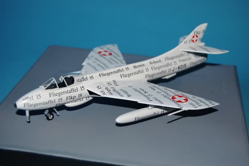

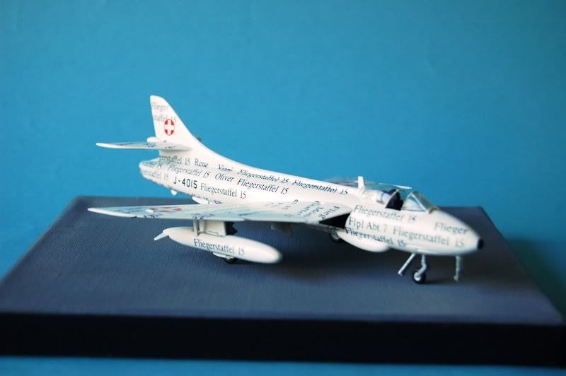

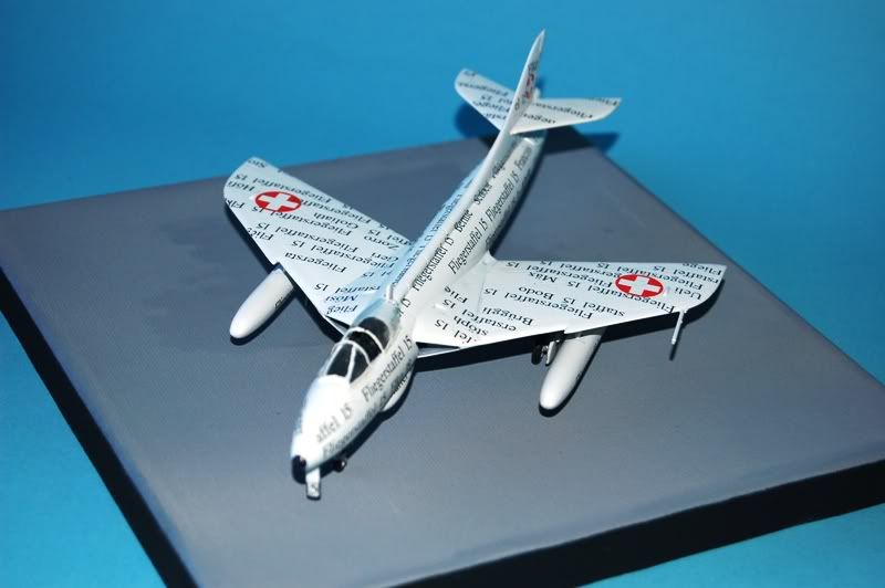

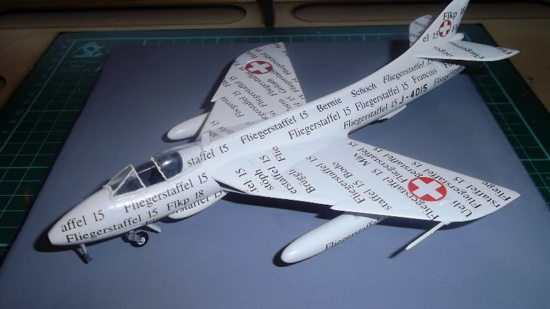

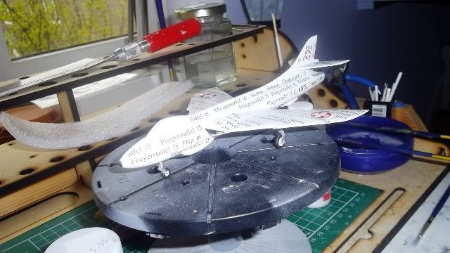

Hunter F.Mk.58 'J-4040' 'Papyrus Hunter' of Fliegerstaffel 15, November 1993
1/72 Plastyk Hunter F.Mk.58 / OH Models Decals
1
Nice work! I gotta love the Papyrus job, it is just so unusual. Forgive me for my lack of knowledge, but what was the occasion for that paint scheme?
Cheers,
Bill
Bill.
I believe the occasion was the drawing to the end of active service of the Hunter with Fliegerstaffels 15. The idea for this paint scheme comming from the squadron badge that shows a paper folded plane.
jb

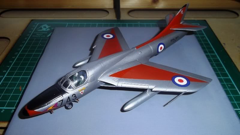

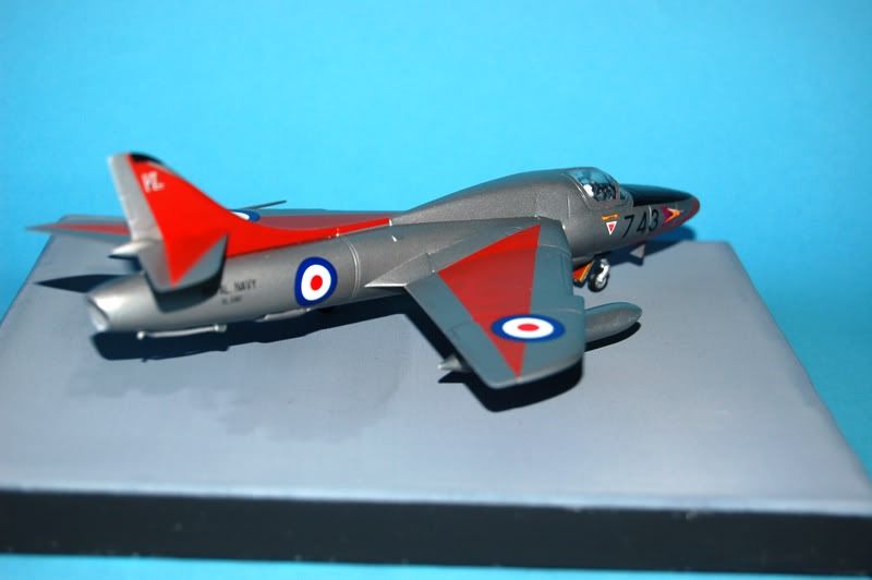

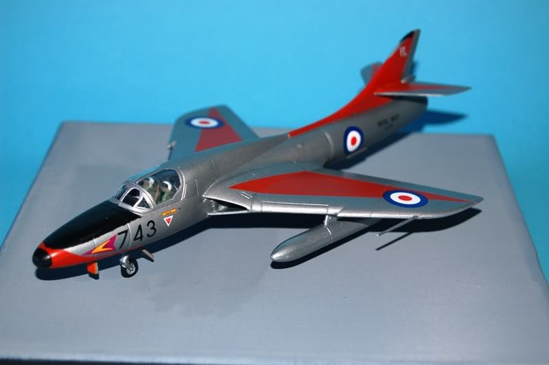

Hawker Hunter T.Mk.8c. XL580. Airwork ADTU – RNAS Yeovilton Sept 1970
1/72 Matchbox / Model Alliance Decals
Made a start on this
Note to self - read the instructions. Only after gluing the fusalage did I realise that I had used the wrong control panel. Doh!
Calling these finished.
Will take some better photos later in the week.

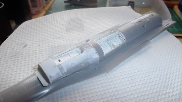

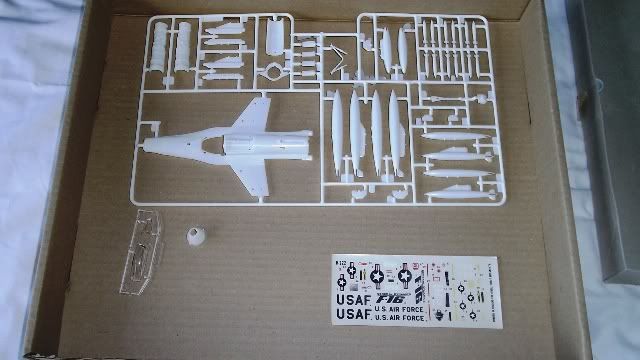

A change of plan.
Having read the various threads it seems the the Revel boxing I have is a better representation of one of the Full Scale Development aircraft.
The plan is now to finish it as F-16A FSD #1 75-0745. Means I still can keep the Red / White / Blue scheme. Just need to find some decals.
Have made a start, quite a bit of flash and the plastic is quite brittle.

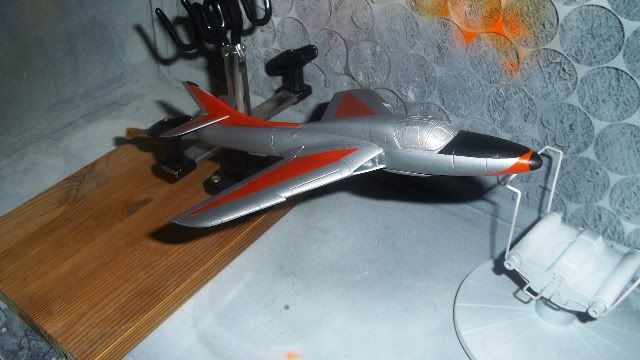

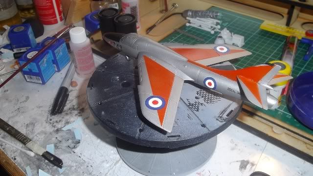

Having finished the majority of decals on the Papyrus Hunter, decided to put is aside for a rest and work on the T Bird.

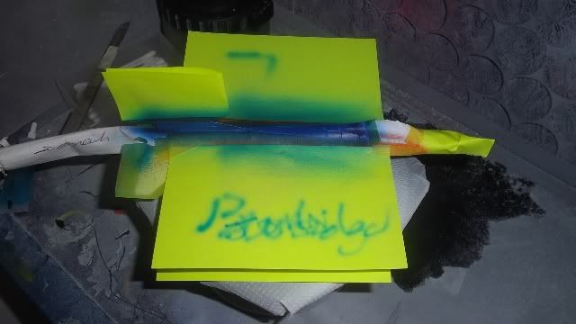

Was planning to use Model Air Fluorescent Orange for the DayGlo panels but it wouldn't spray well and kept blocking the airbrush.
In the end tried a thinly sprayed orange over a red base. I think it looks ok.
Decaling took a couple of evenings.

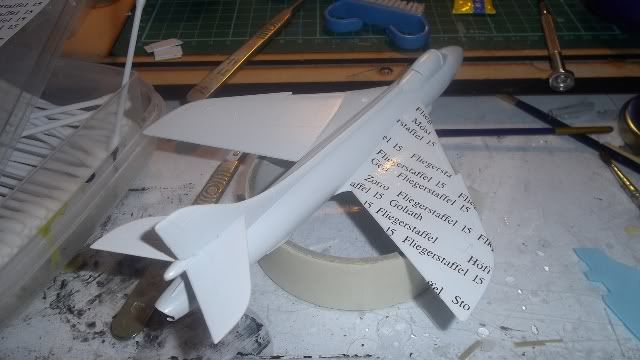

A bit of progress over the weekend.
Halfords white plastic primer followed by appliance white.
Started with the decals. I think they are going to take a while.

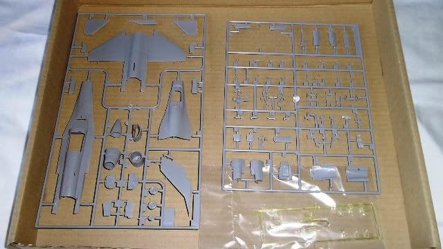

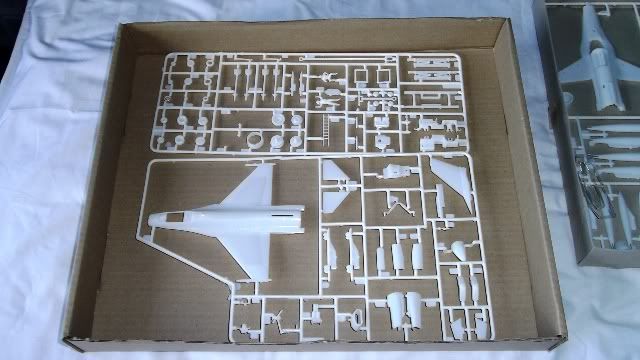

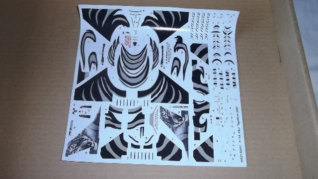

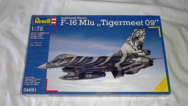

Second entry is the 2009 Tigermeet F-16MLu. (Revell 1/72)
Again planning to build OOB.
and finally the cracking decal sheet.

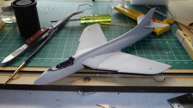

Thanks for the tips on the decals, will come in useful I am currently building the 1/72 version for Hunter GB.

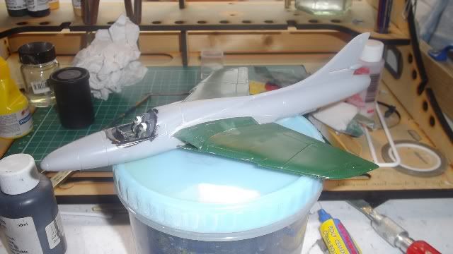

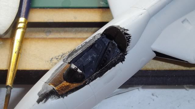

The plastyk hunter is a bit basic.
I replaced the cockpit with a resin aftermarket version, need a lot of sanding to get it to fit. Not convinced I have actually improved things.
Also had to remove the lip around the rear nozzle outherwise the fuselage halves would close. Needed to use quite a bit of filler on the wing roots. The nose also needed a lot of filling as the left and right halves had different profiles especially when viewed from the front.

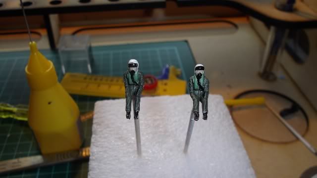

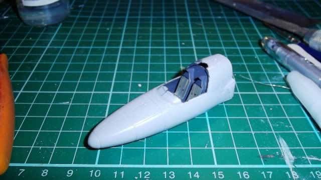

Also made a start of the two seater.
Yes I know the seats have belts, but only decided to use the "twins" after taking the cockpit photo.

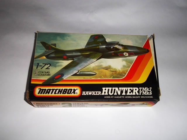

Second Hunter will be the Matchbox T-bird.
Bought of Ebay, the two fuselage halves had already been glue together. This will be built OOB with aftermarket decals. Will be finish as in Royal Navy markings.
The T-bird will be a navy machine.

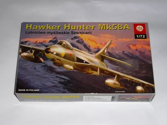

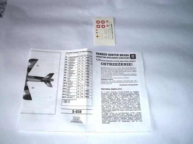

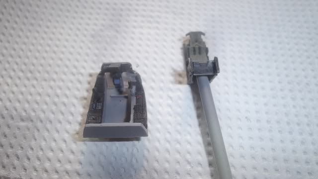

First up is the Plastyk Mk.58
From reading around the web, I believe this is the old FROG boxing.

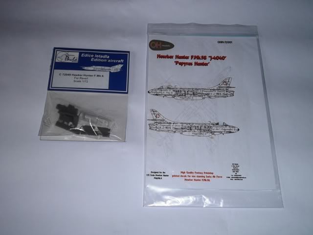

Not much cockpit detail. I decided to add the Pavla Cockpit. I know it is for the Mk6, don't know what the differences are but it should fill the void nicely.
Also comes with a vacform canopy, to replace the original thickly moulded canopy.

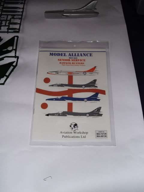

The second is the Matchbox T.Mk.7. Going to use decals from the Model Alliance Senior Service Hunters sheet. Still to decide which one, tempted by a High Speed Silver finish.

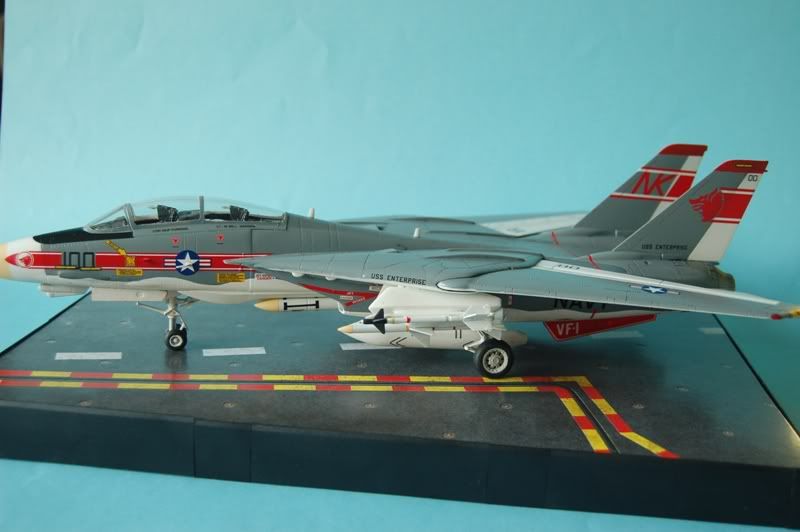

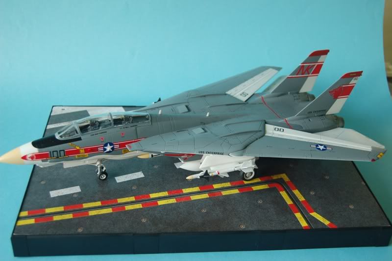

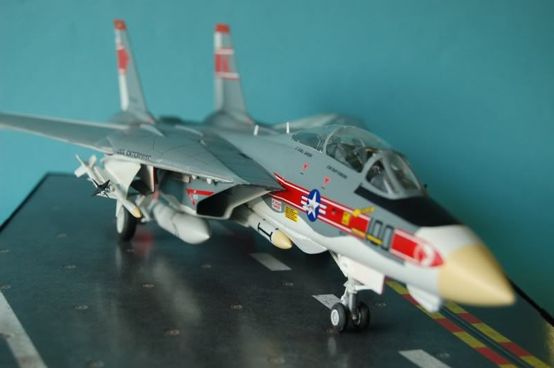

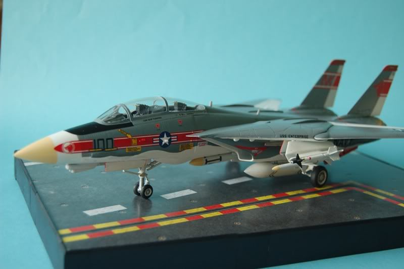

Italeri 1/48 F-14A Tomcat
VF-1 Woolpack
Mainly built OOB but with replacement seats.
