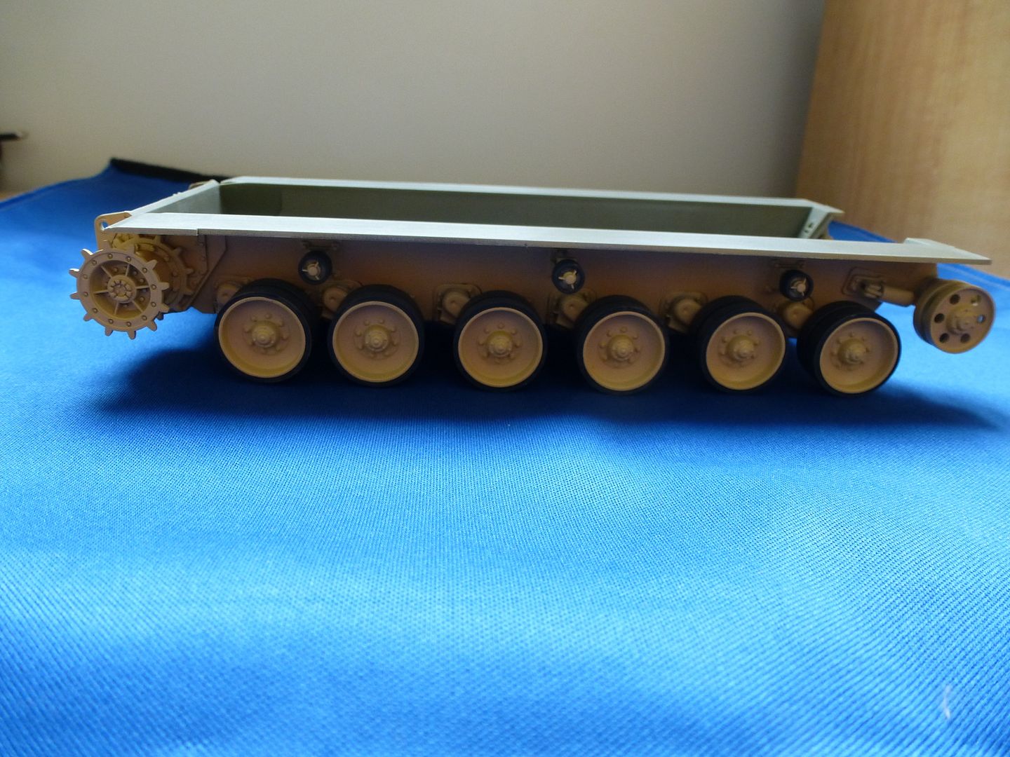

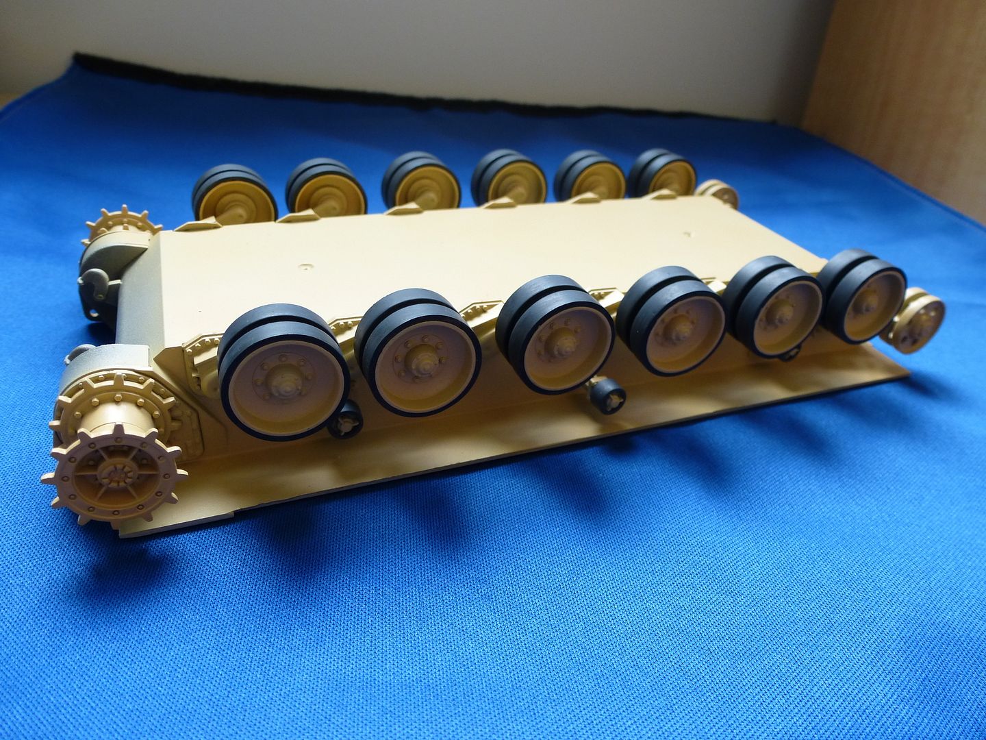

I decided to paint the lower hull and tracks with the base colour, as I thought this might be easier now rather than later.
I have fitted the tracks too but neglected to take a picture! The sand colour is the Mig British desert sand as per the link in the first post. I think the colour is pretty close and it sprayed ok. I only say ok as my AB was playing up, I think I have a split nozzle!
I have since fitted the tracks as well. I painted them first with black primer, Mig again, then with a mix of tamiya metalics to give a steel colour, I will paint the rubber pads later (I'm lazy and will have to paint fewer when the tracks are fitted!).
When I test fitted the tracks the lugs perfectly fitted into the holes, so I thought joining the tracks would be simple...now the paint has closed the holes up they no longer fit!! In the end I cut off the lugs and glued the tracks with rapid Araldite, the only glue I've found that will stick the vynil tracks.

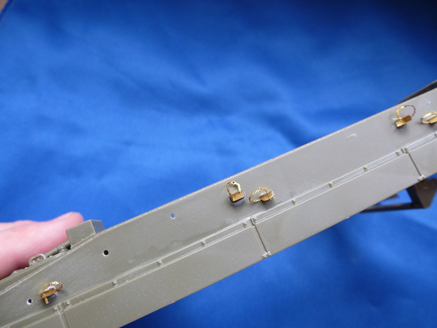

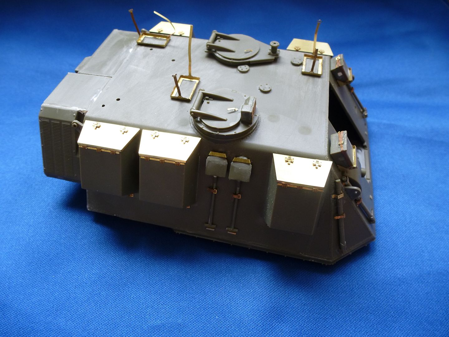

In between painting it has been a mammoth etch session.
I do like the detail you get with etch but it's a pain to fit sometimes, plus I really don't like superglue!!
What you see I'd most of the first Eduard set, I still have the second set of grills and the mesh storage rack for the top of the turret to go!

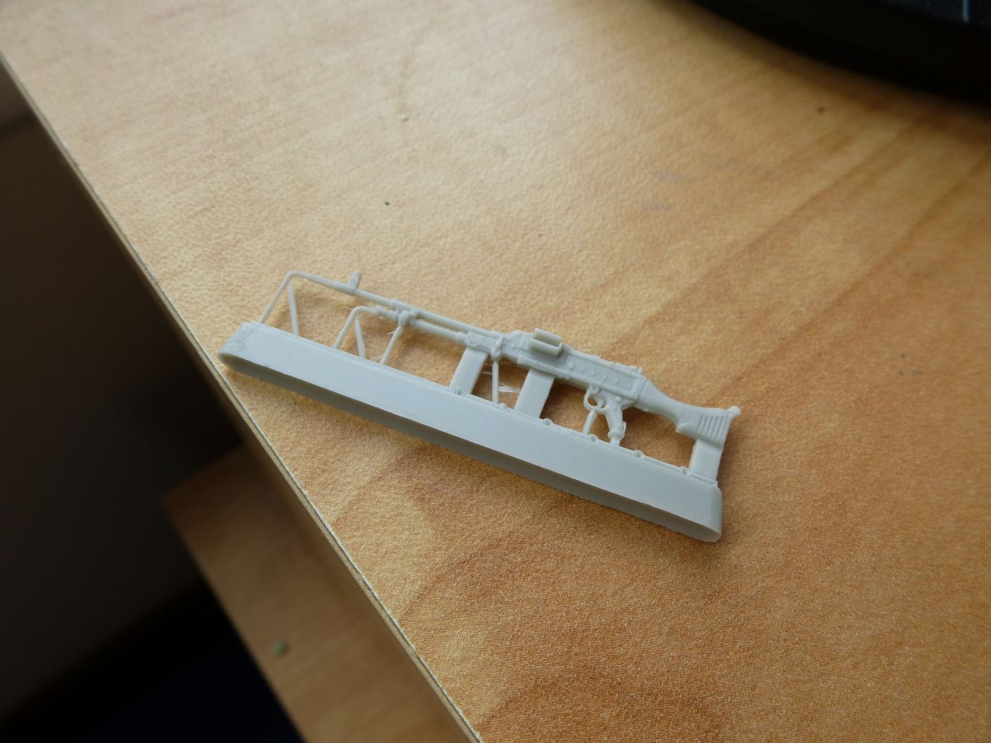

To balance the PE I have some resin to use! My Accurate Armour order arrived Saturday, but I'm yet to fully look over it all so I'll save that for the next update. One other part that did arrive was the Live-Resin GPMG.
It's a real beaut, better than my camera skills show it off!! I ordered direct from russian and got 3 off guns for just over £10 posted, they arrived in just over a week. Impressive service!

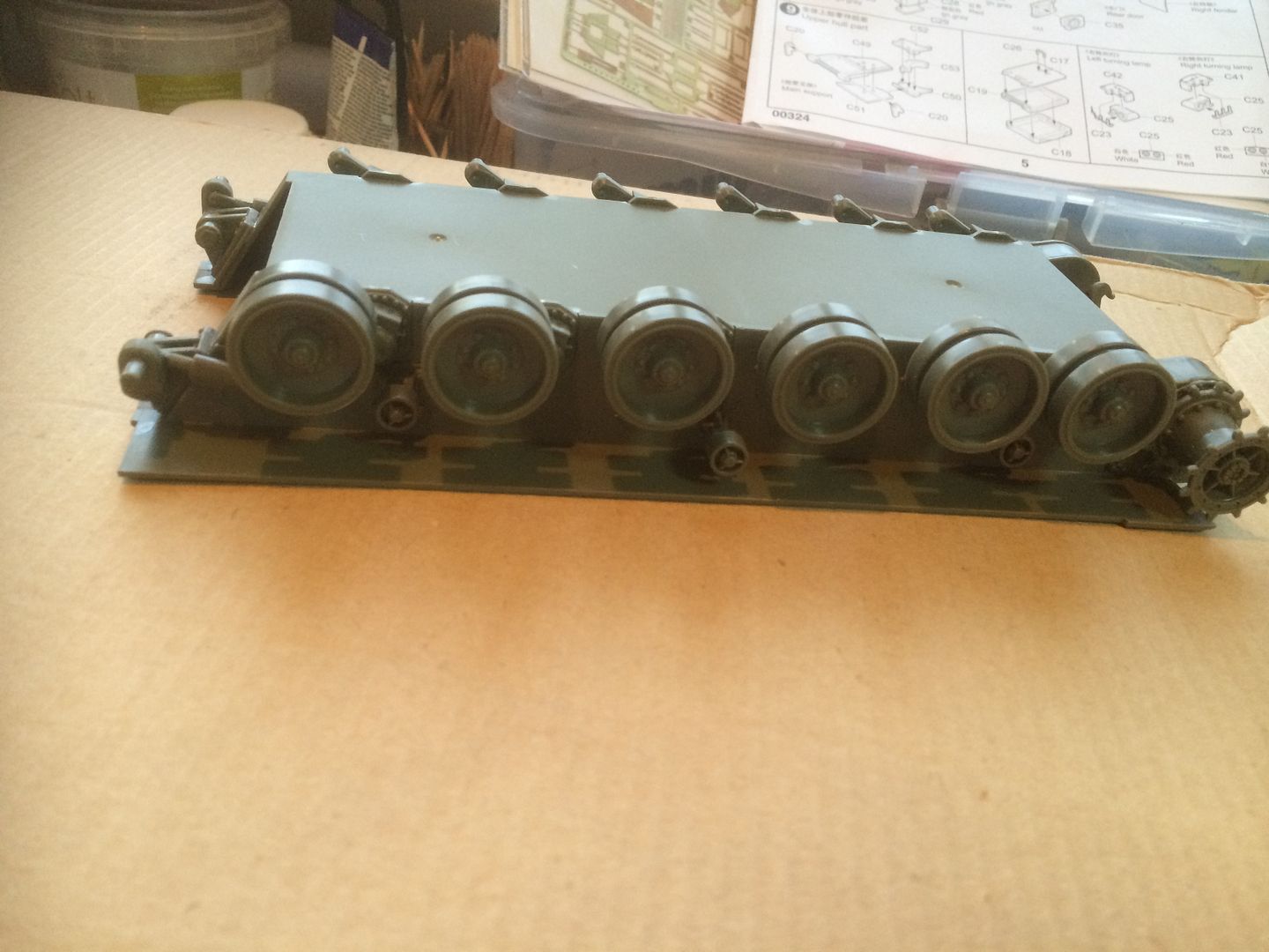

Right then! Got a bit of an update, the mother in law is staying which meant I got a few hours at the bench over the weekend, I should be finishing some half built projects but.....
80 mins of work on Saturday afternoon got me this far (very precise timing as it was completed during the Tigers vs Wasps game, which sadly tigers managed to win!).
The wheels are test fitted only, the joys of poly caps. I had read on line that the fit of the tracks can be a touch loose. There is adjustment provided for in the kit via the 'float' in the idler wheel mount and the 2 part shock absorber on the mount, meaning you can set the angle of the idler mount to get the correct track fit.
Once happy with the fit I committed to glue with the idler mount, roughly right angles to the hull seemed to give a decent track fit. I had looked at the bronco tracks for this, but Trumpeter have done a decent job with the rubber band ones.
Not the best pictures as I was lazy and used my phone. I will break out the camera for the next round!!
Now the glue is cured I have primed the lower hull and wheels plus the tracks ready to paint them.
I have also started on the top half of the hull, mainly removing detail to make way for PE.
