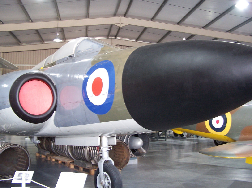

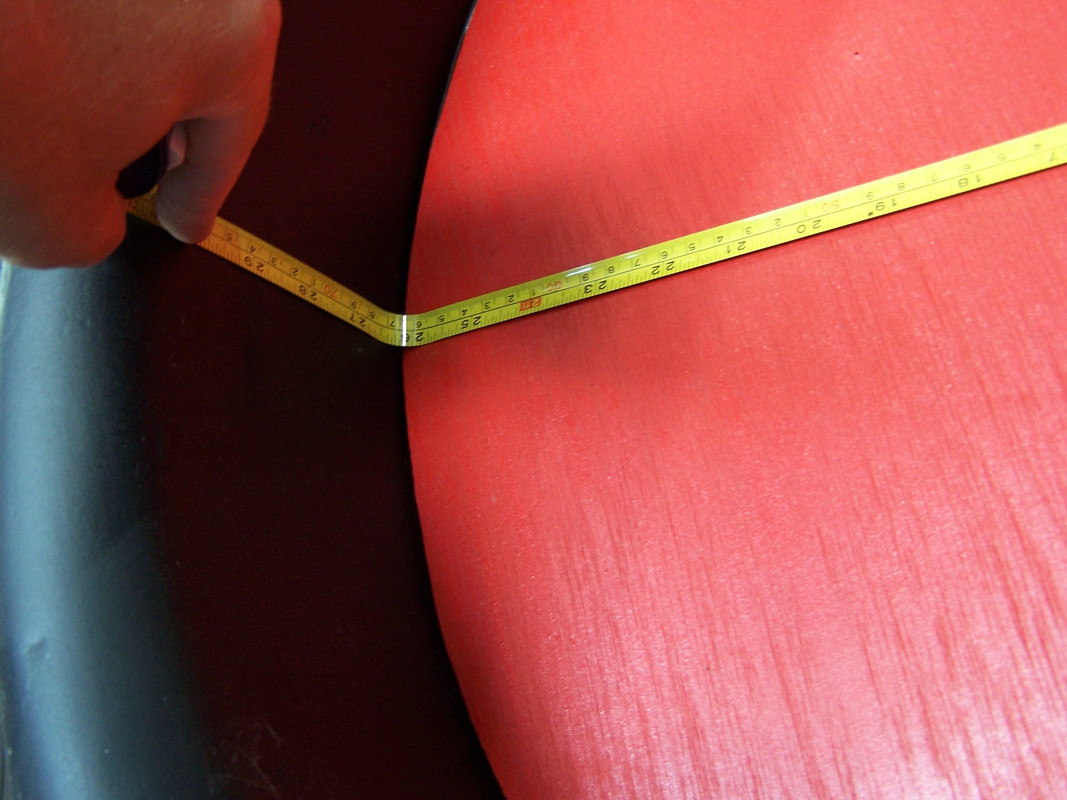

  9. 29 minutes ago, theplasticsurgeon said:
    I have measured the intakes today.
    Here's the FAW4, not on public display.
    Intake diameter 22.5 inches.
    And the FAW9
    Intake diameter 26 inches.
    So 3 1/2" inch wider, that's quite  an increase in airflow!  Strange that it hasn't been really noticed before, especially if you look closely at the differences on the intake lip profile.
    That works out to 7.94mm dia for FAW1 to 6 in 1/72
    9,2 mm for FAW 7 to 9.
    the 1/72 Airfix kit intakes are measured at  8.35 and 8.5mm  the Frog at  9.6 /9.8m (both are slightly oval in the kit!)
    Selwyn

  14. 1 hour ago, TeeELL said:
    My suspicion is that the Airfix 1/72 model has the ‘small intakes’ of the T3 Heller original.  It does look as though there is enough plastic to be open them out though.  Unless anyone does so in the mean time, I will add that to the measurements I need to take when I meet with ‘theplasticsurgeon’ at Jet Age Museum.  If any one has easy access to an earlier mark somewhere ……?
    Doesn't the Jet age museum have a FAW9 and a FAW4  (Ex leeming gate guard ) now?
    https://jetagemuseum.org/faw-4/
    Selwyn
