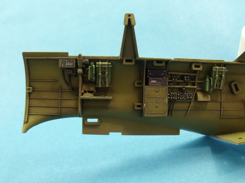

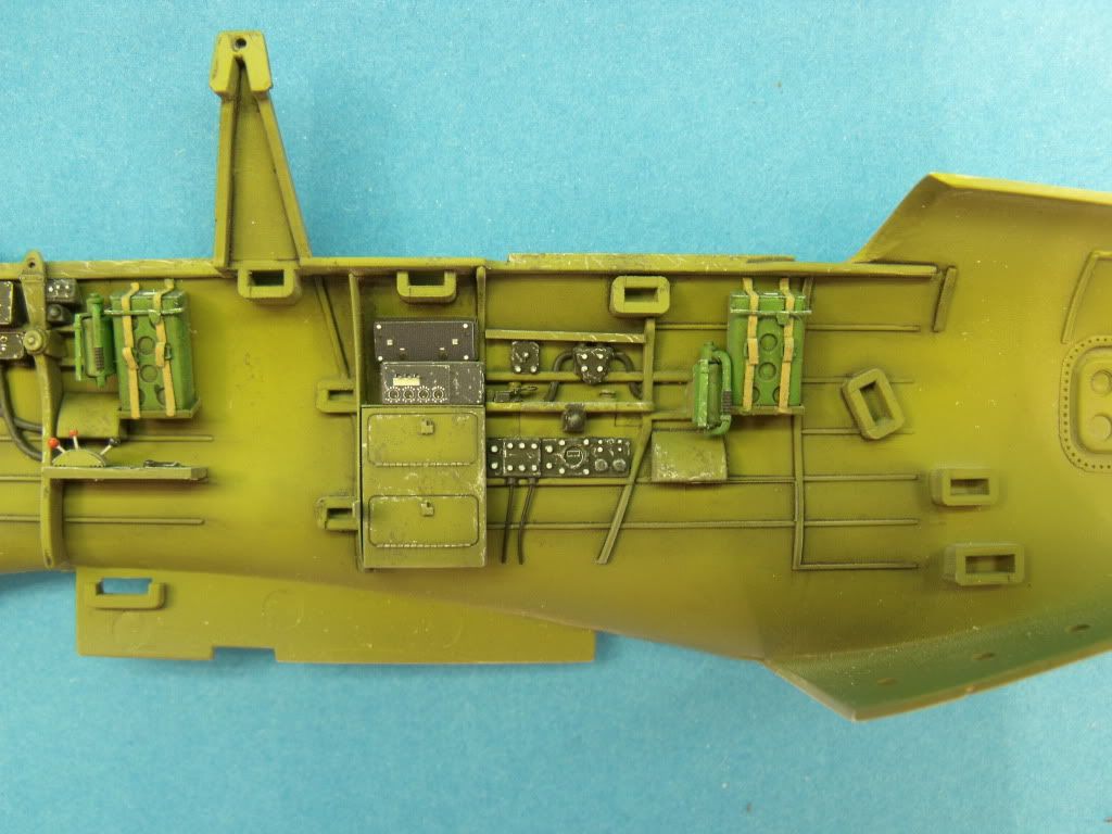

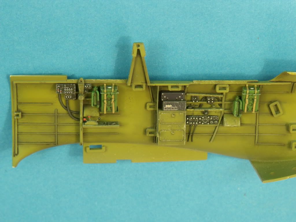

Just a few photos before I close up the fuselage
Hi Mike,
Inspirational stuff there, just been checking out your previous build as well!
Can I ask what you use for the instrument face's on the IP? Is it acetate or a clear varnish of some kind?
Cheers,
Sean
Hi Sean
Its Tamiya clear sprayed on first before putting the front part on

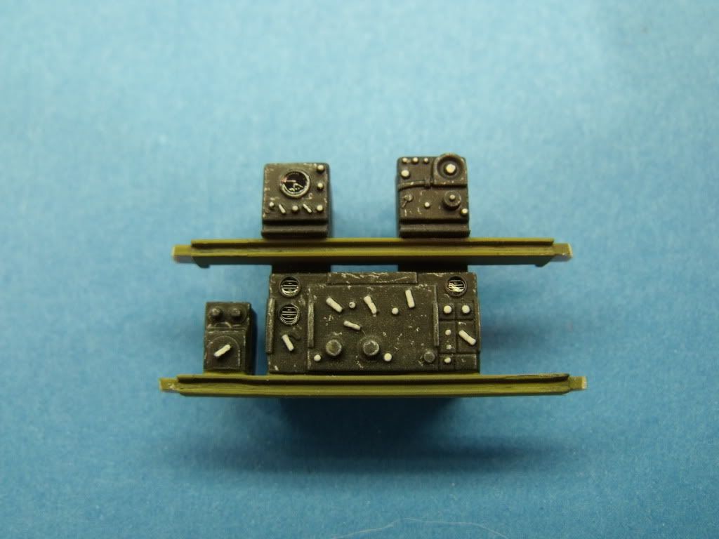

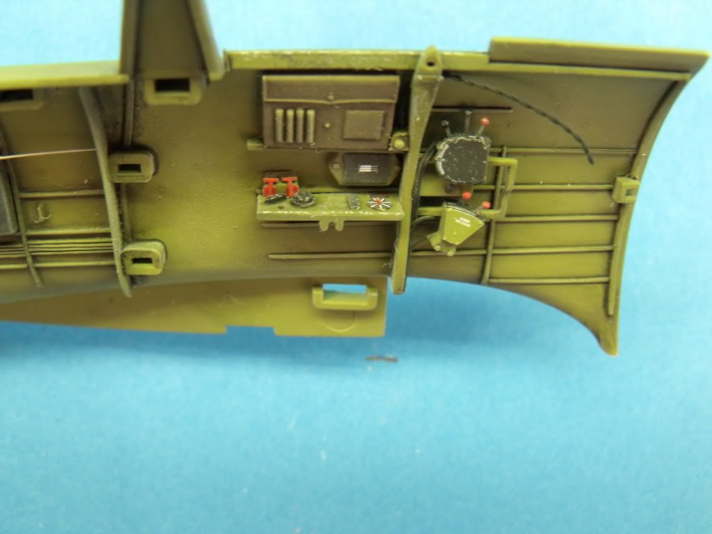

Those switch boxes, with the numbers around the rheostats, how did you do that? It's amazing!
Hi Don
Eduard PE, using the Big Ed set on this one

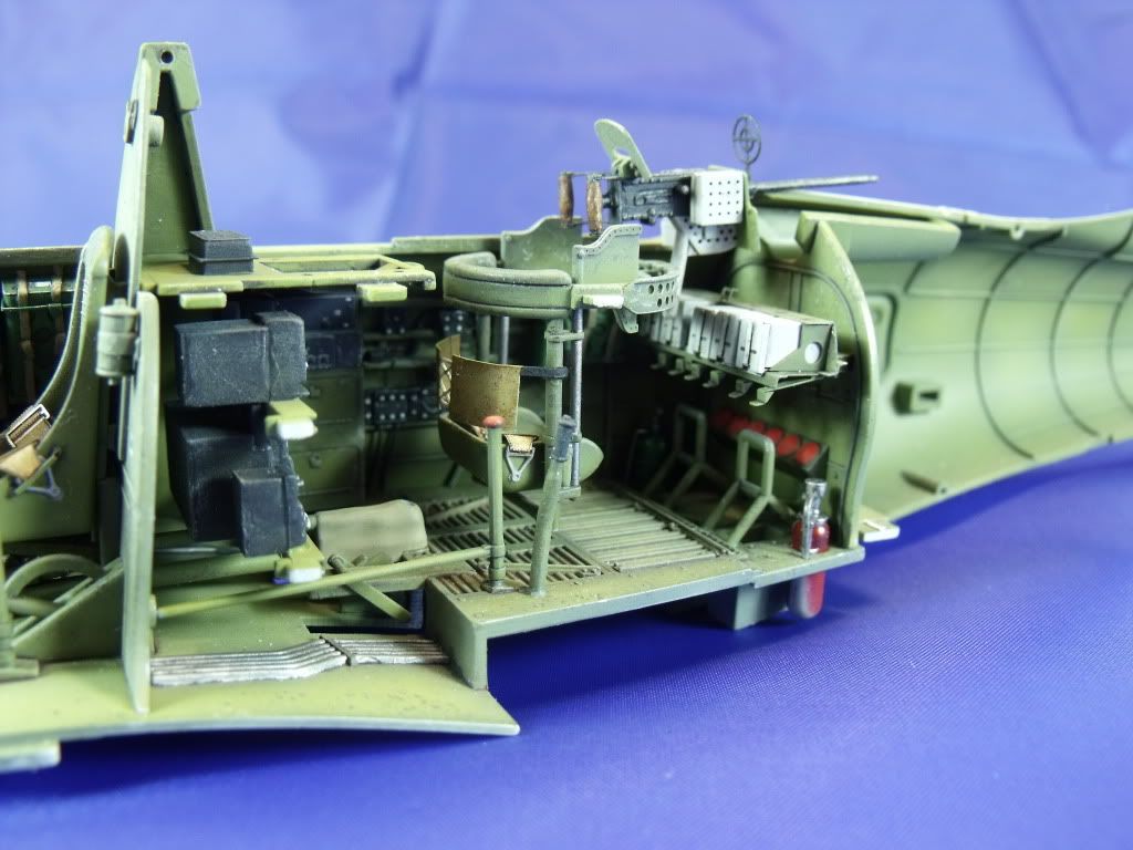

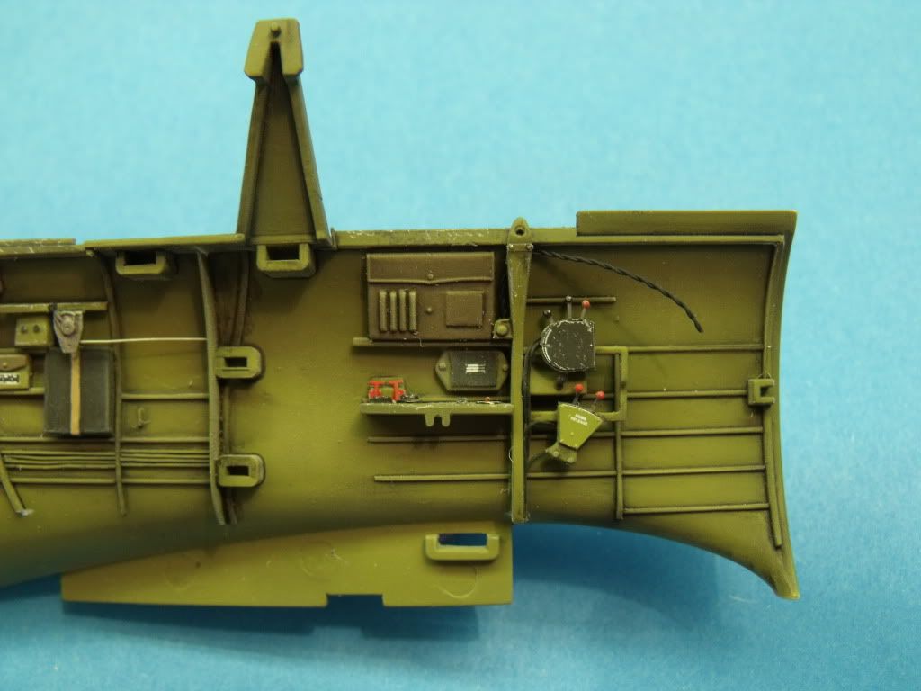

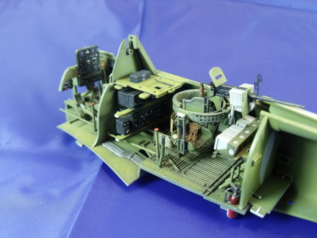

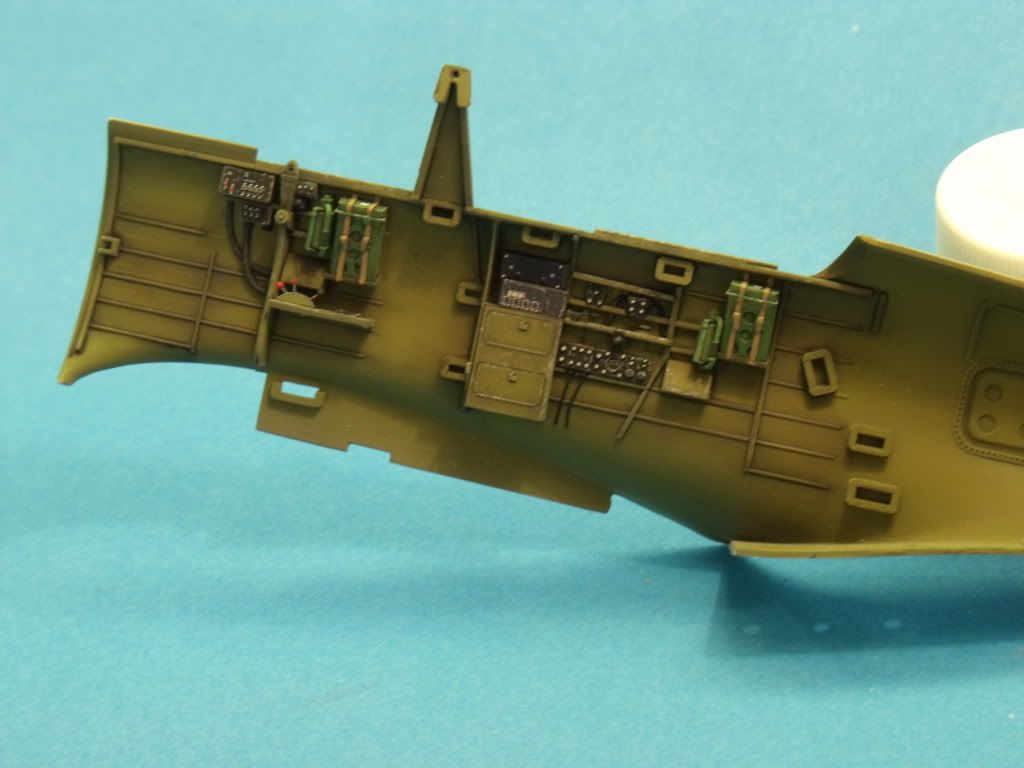

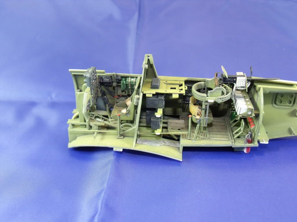

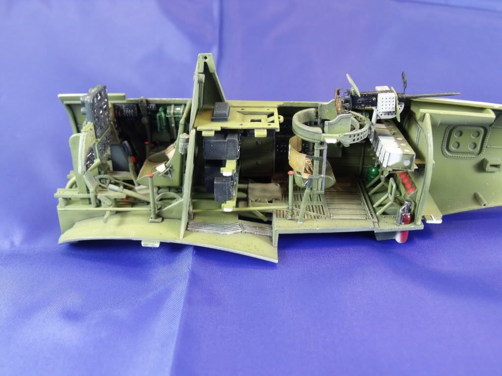

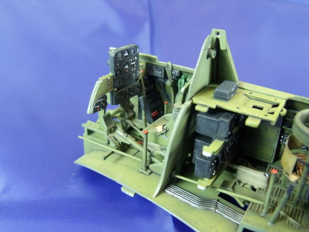

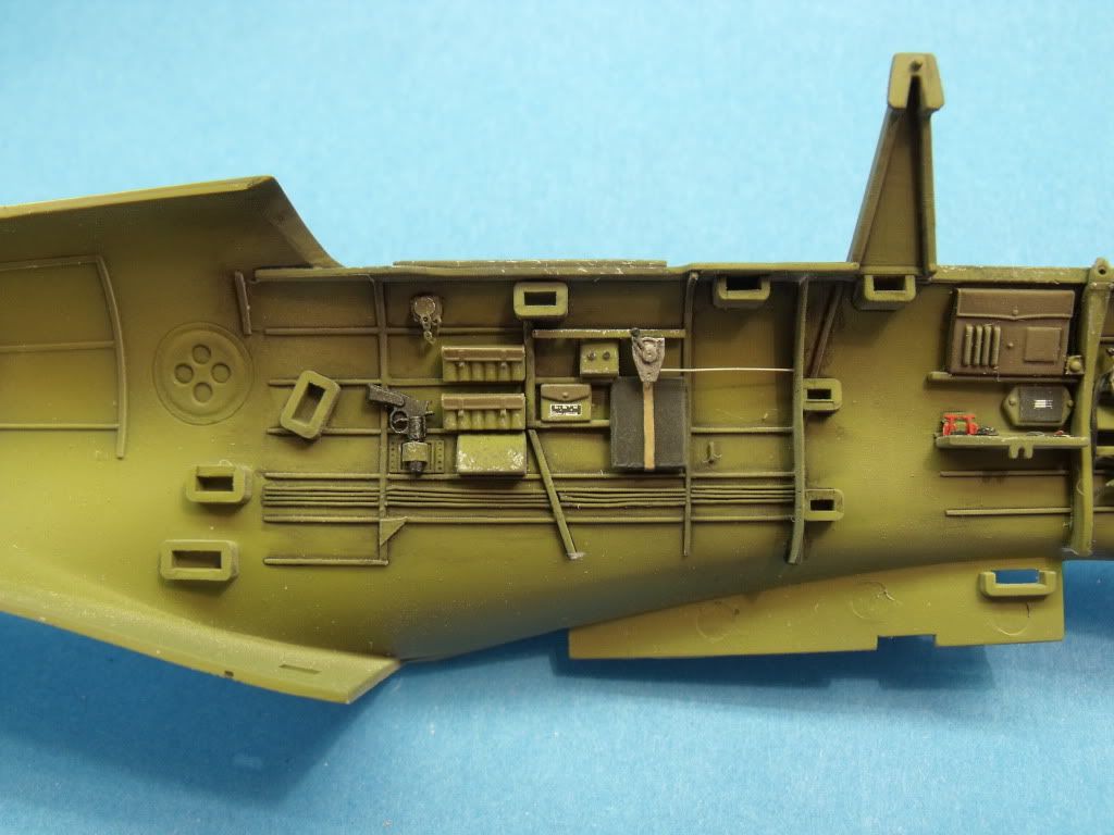

The both of the side interiors are now almost completed, just got a few more control wires to add before I close it up.

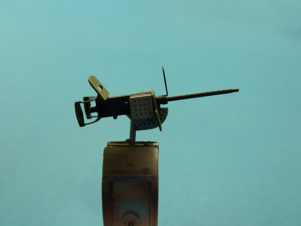

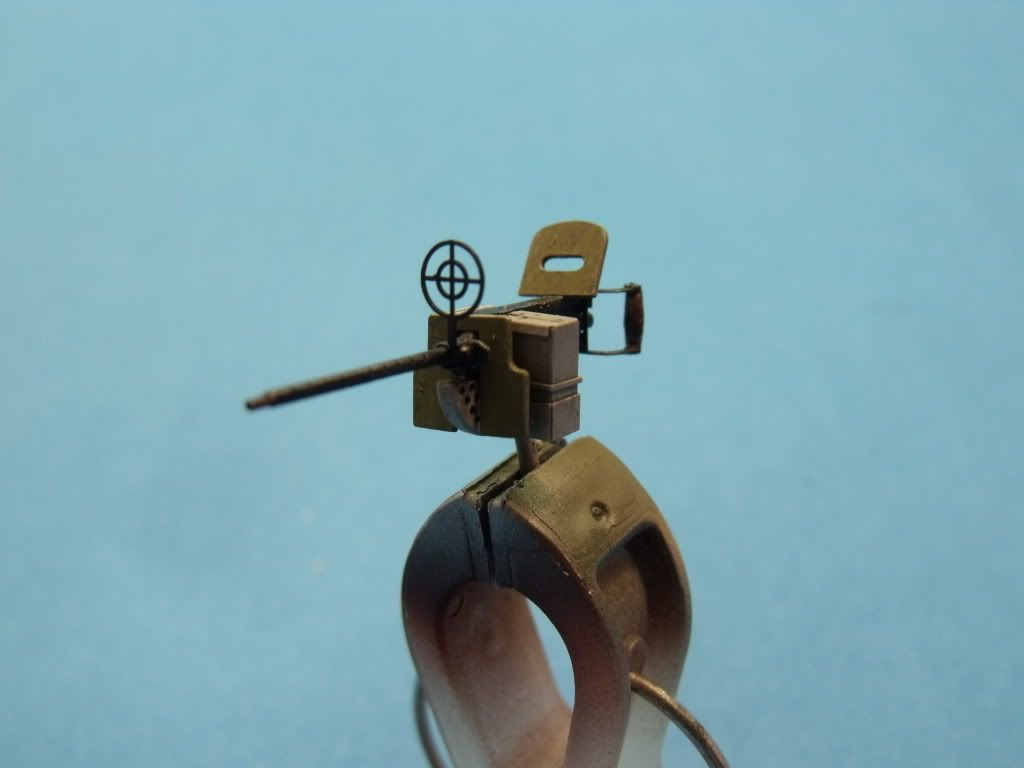

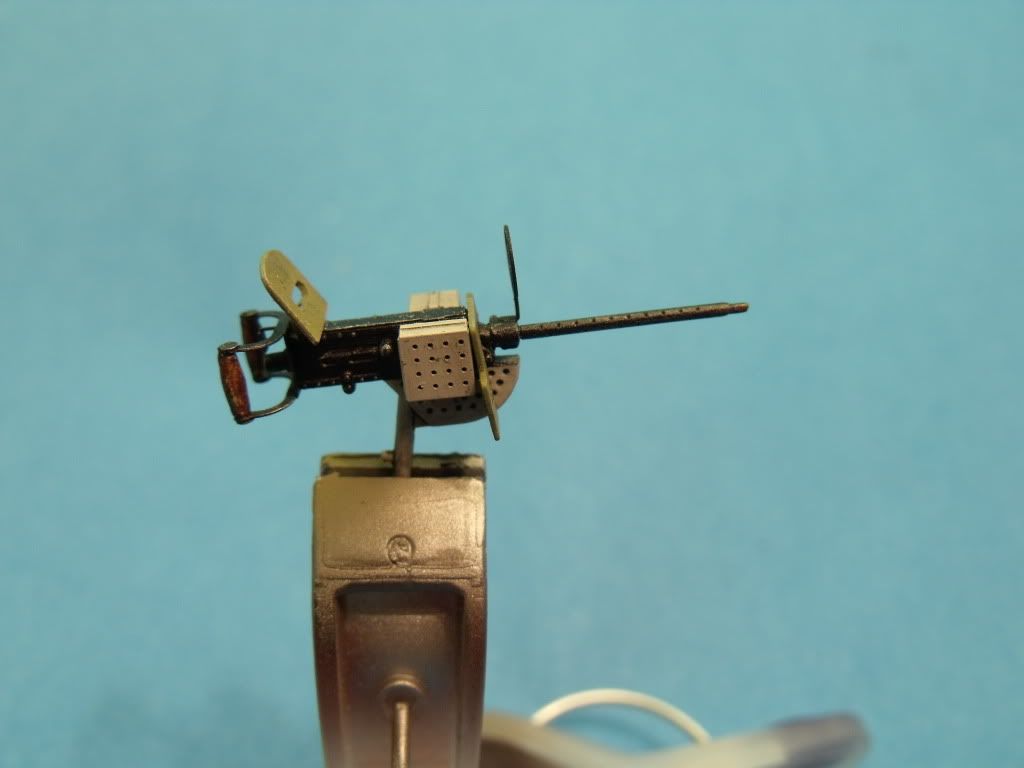

.30cal is completed and the gunners position is painted but still needs the seat, seat belts an gunners rear support belt added.
Radio painted and finished
After that going to try and make up the ammo rack out of PE plus the spare ammo cans.

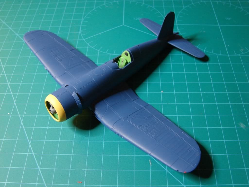

Some progress on this, it's finally looking like a Corsair now that the paint is on. I always think painting the airframe is when the kit takes proper shape. Next steps will be the gloss coat and the decals, as well as working on the external stuff ( wheels / rockets etc. ).
J.
