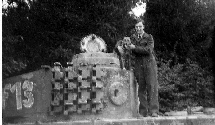

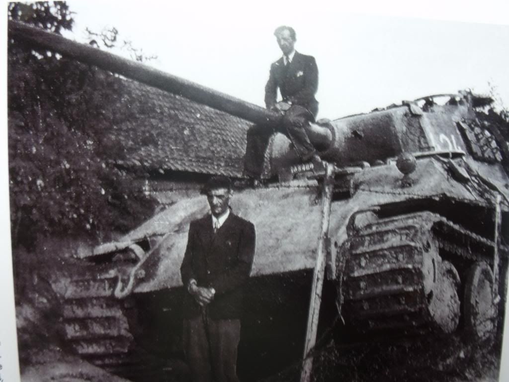

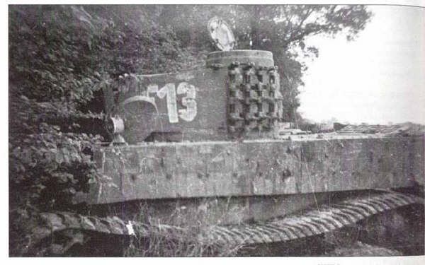

After looking at the link posted by AngloSaxon I would say there is conclusive evidence that F-13 had Zimmerit at least on the turret
These two photos show Zimmerit on the turret, with the very strong possibility of it being on the hull as well

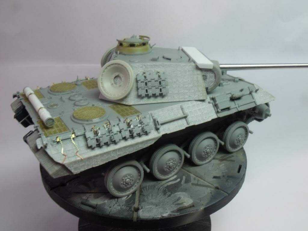

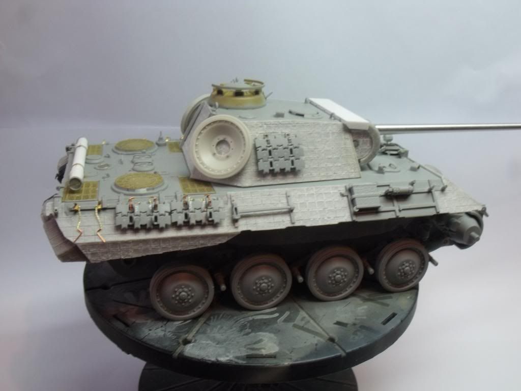

This will be the last update before the tank hits the paint shop
The spare wheels and track links on the turret, Jerry Cans on the rear are only just held on with white tack at the moment, these will be painted of the vehicle to give a bit of color variation.
Ray, even with the mishap that's some nice work you have done there

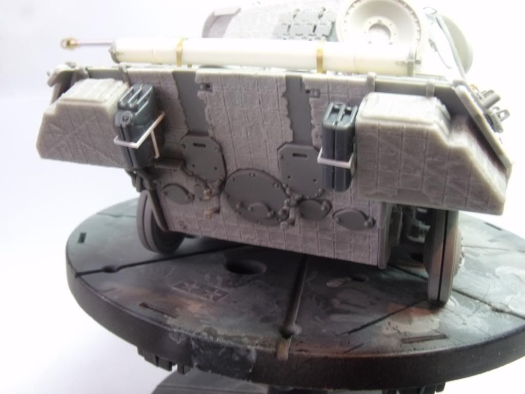

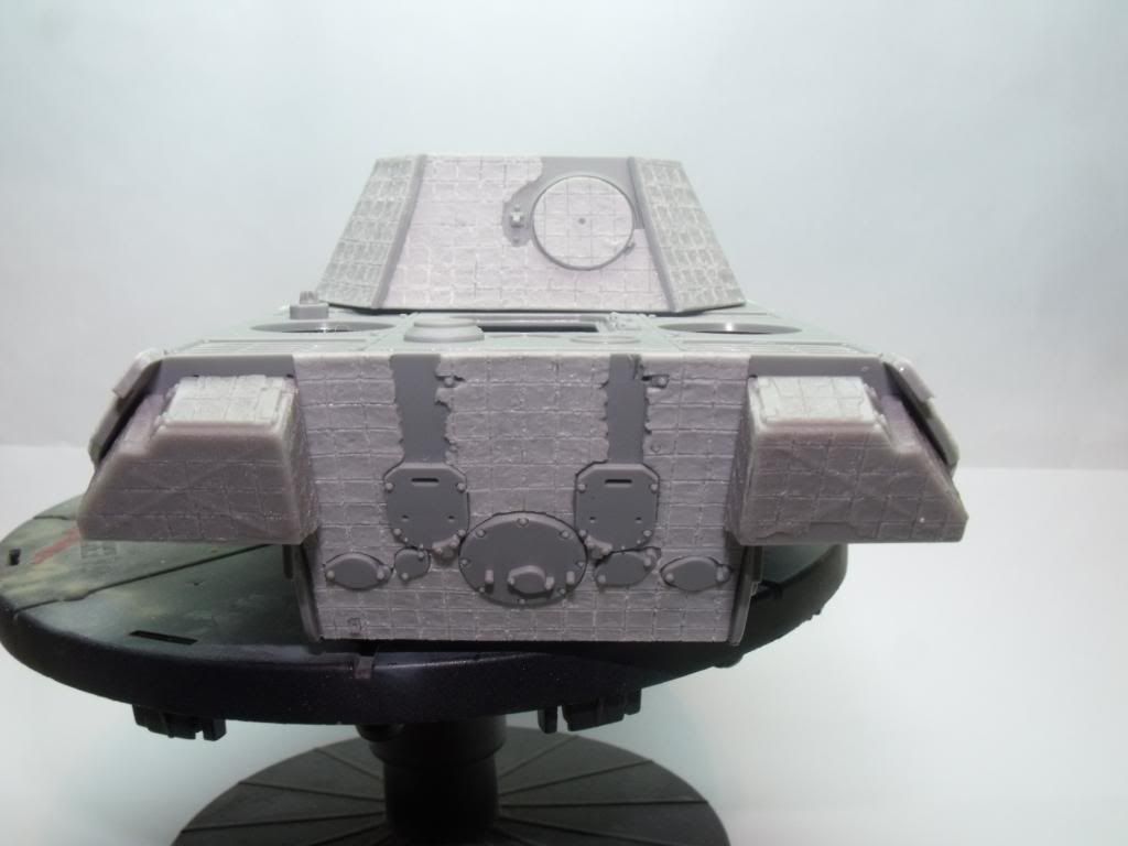

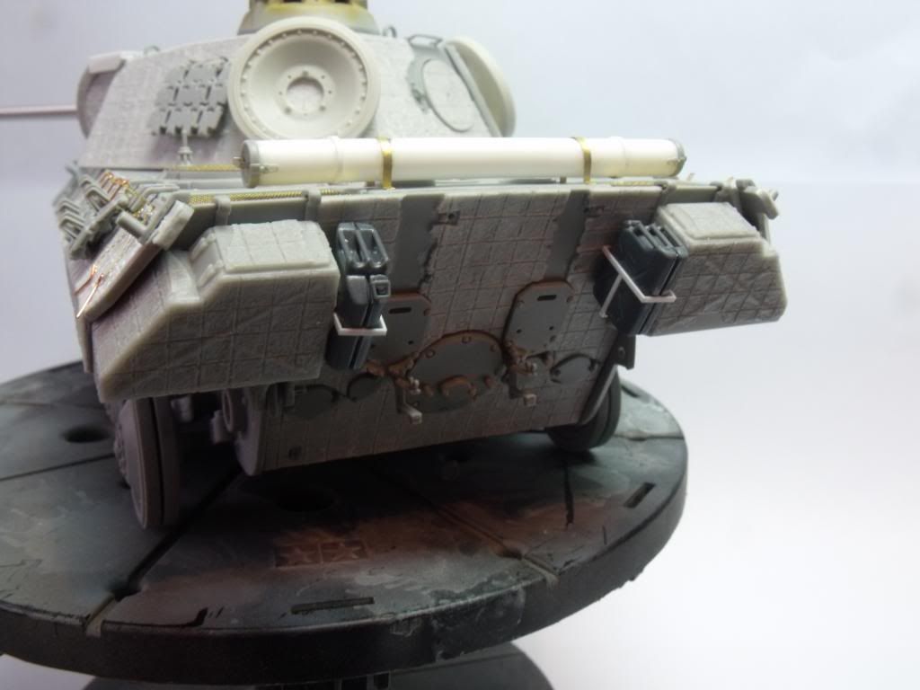

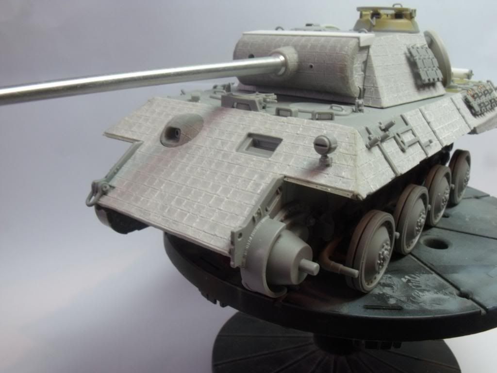

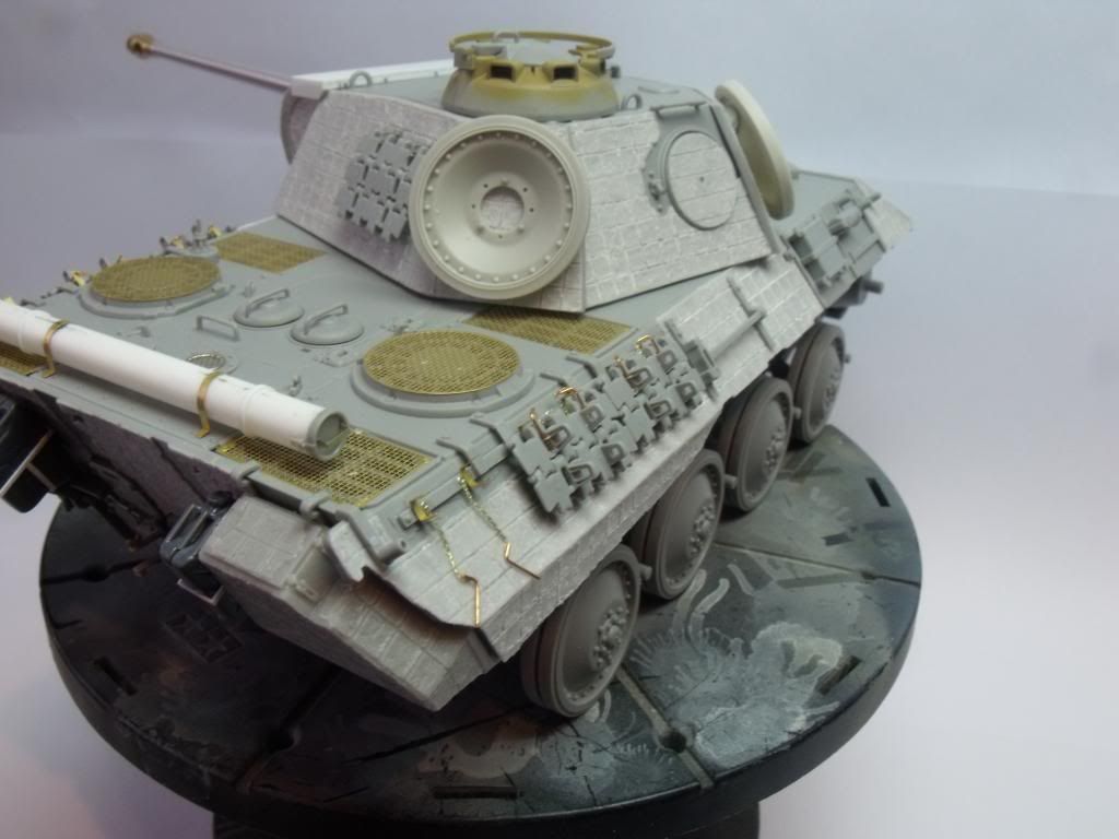

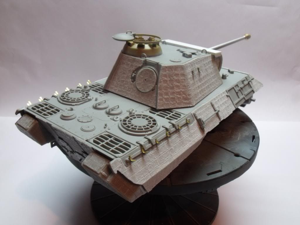

Well its almost there now, just a few more bits left to put on before the primer coat which should be this weekend

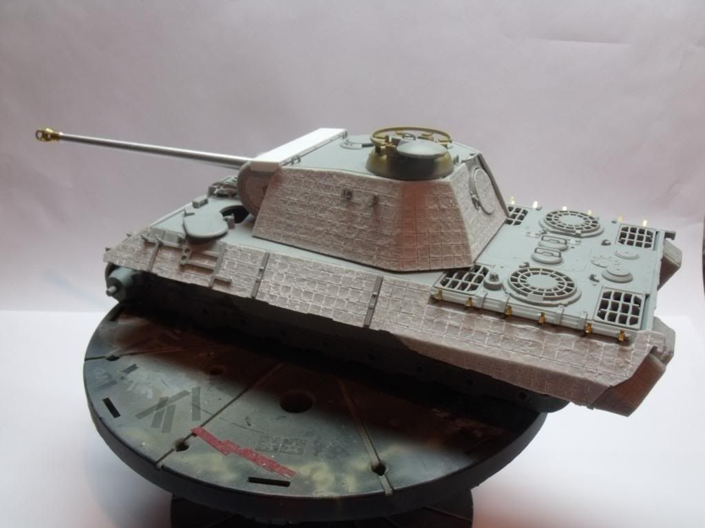

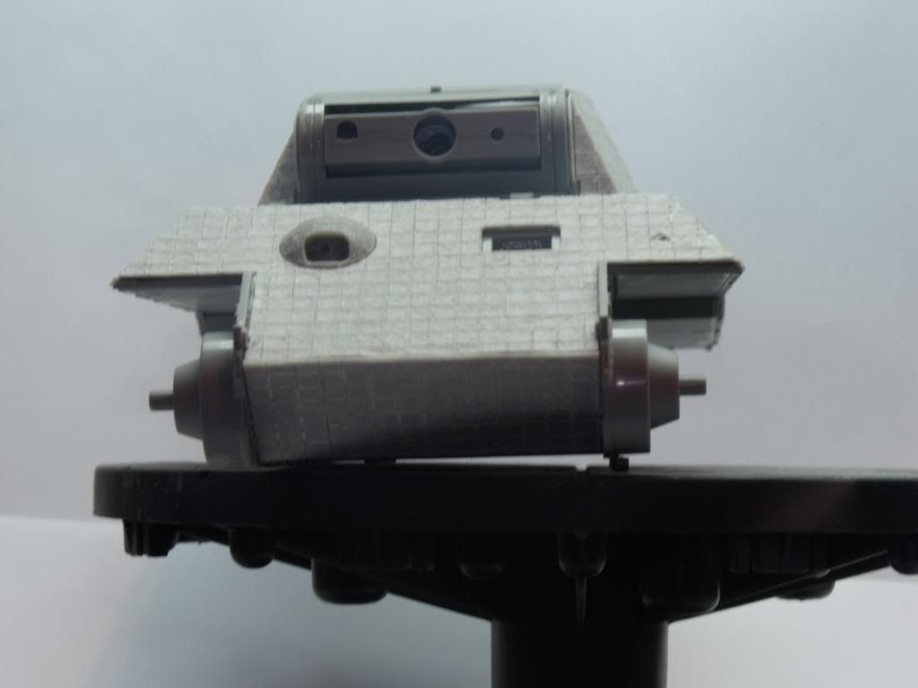

Right got all of the Zimmerit on, just a few problems with the backing sheet separating and having to piece together the resin squares
The worst being the rear plate that's it about 15 pieces
All I have to do now is go round, sand back the resin where its overlapped fill the joints where the plates meet and make them look like the Zimmerit

The resin Zimmerit so far is nice to work with, will let you know when the project is complete if i still think so
I would say the hardest part is getting it of the resin backing sheet, this is where you need to sand it, and make sure it stays in one piece
Once that is done, its just fixing it to the model with PVA glue, with a touch of super glue around the edges

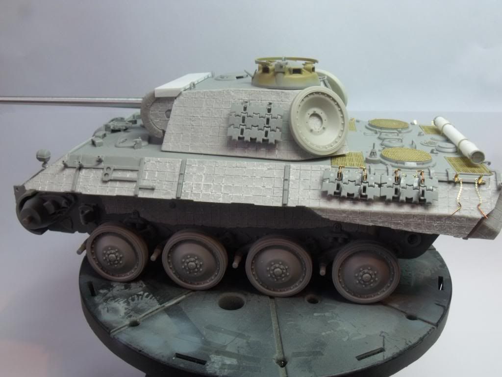

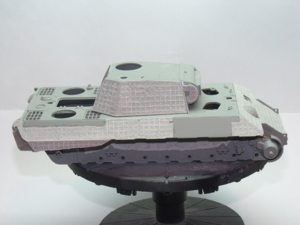

Ok first up date

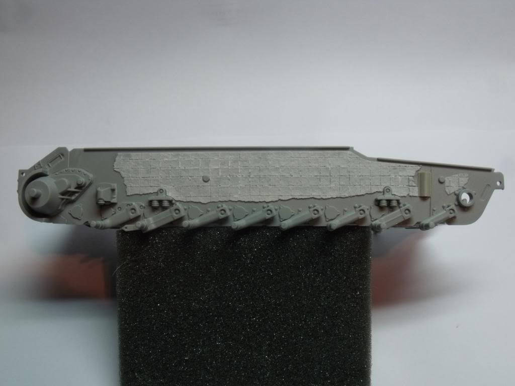

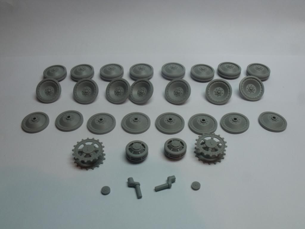

All of the wheels removed and cleaned up

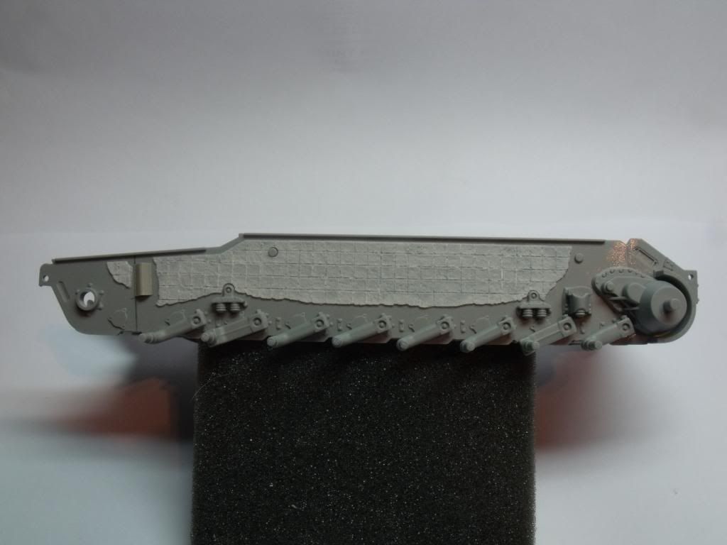

The hull cleaned up, suspension arms removed , cleaned and dry fitted, also Zimmerit added to the sides

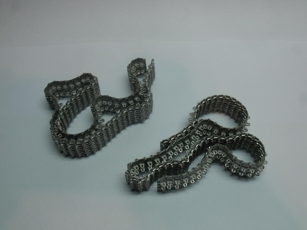

I decided to go with the metal track rather than the resin ones, less clean up on the metal ones and they went together great

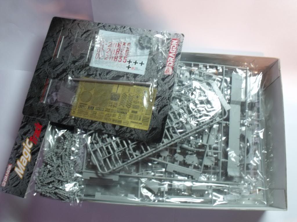

Well being inspired by Peter's build of a Panther from I./Pz.Rgt.24, and after looking at the reference site he linked to I did a little digging around in the stash and found the following
Dragons Panther A
WW II Production Resin tracks
Fruimetal Tracks
Aber upgrade set for the Panther
Eureka tow cables

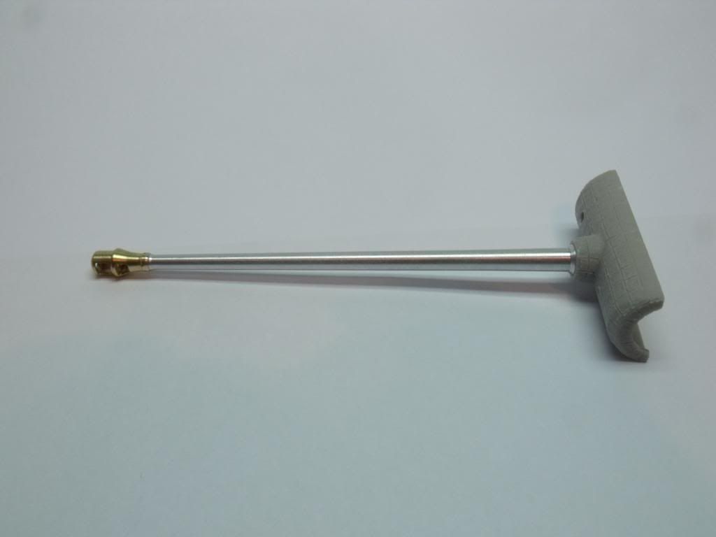

7.5cm L/70 metal gun barrel
Atak Zimmerit

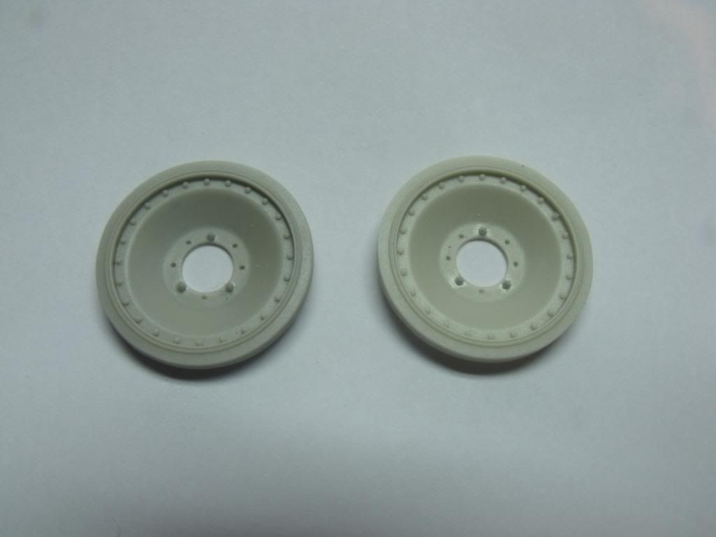

1. Spare road wheels mounted conical side out, one either side of the turret towards the rear, held in place with three bolts

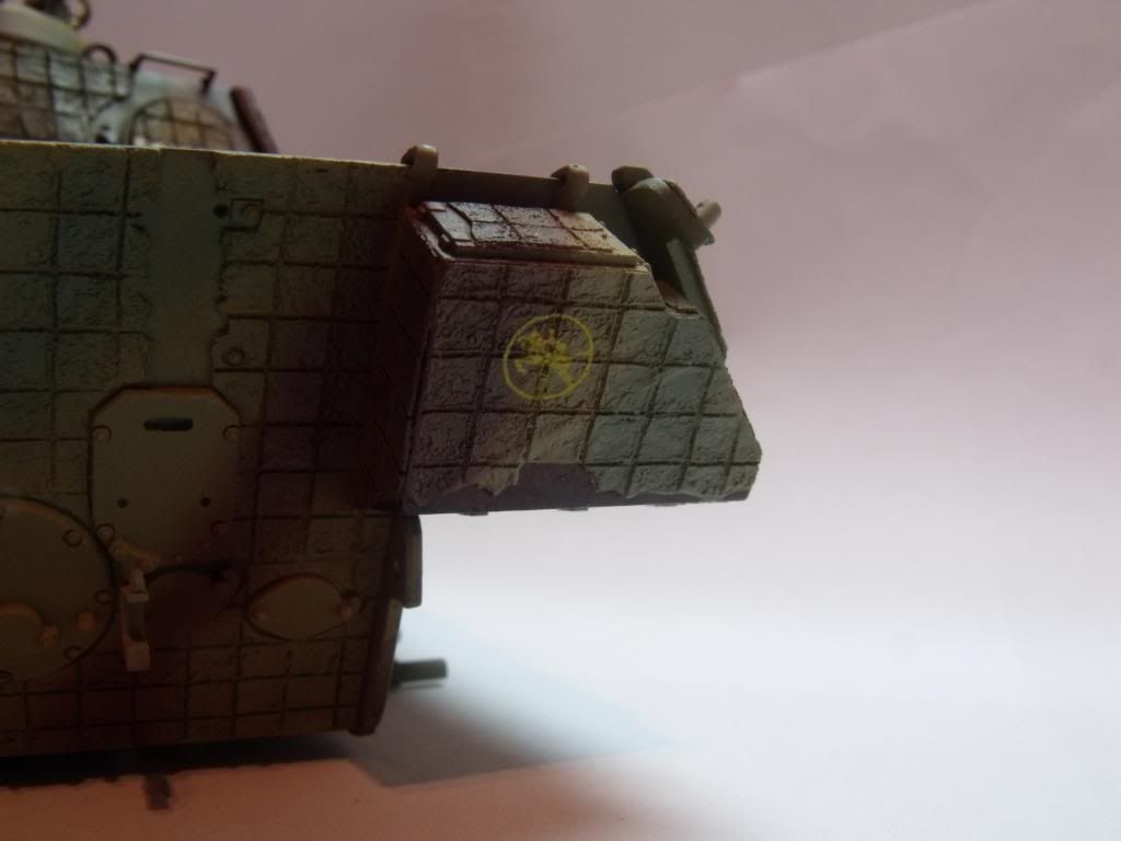

Turret rear hatch showing the ID mark for the 4th Company

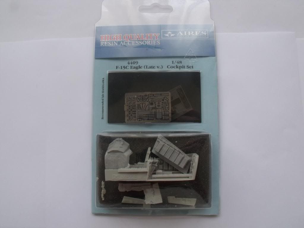

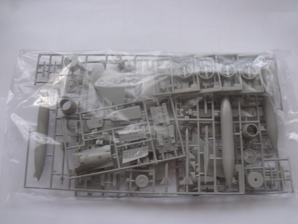

2. When I opened it found I had the following
Cockpit and burner cans from Aries
A mask set from Steel Beach
Wolfpack Agressor updat set
Paint masks from Eduard
Resin FOD covers from Two mikes

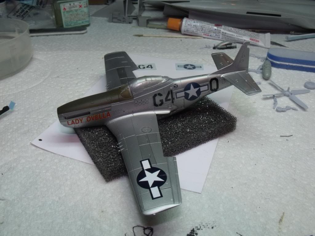

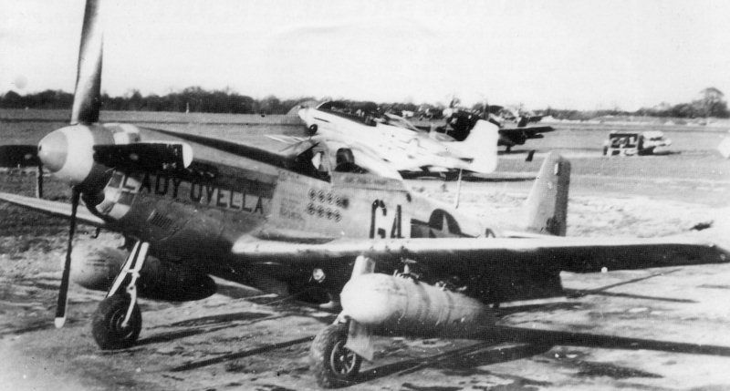

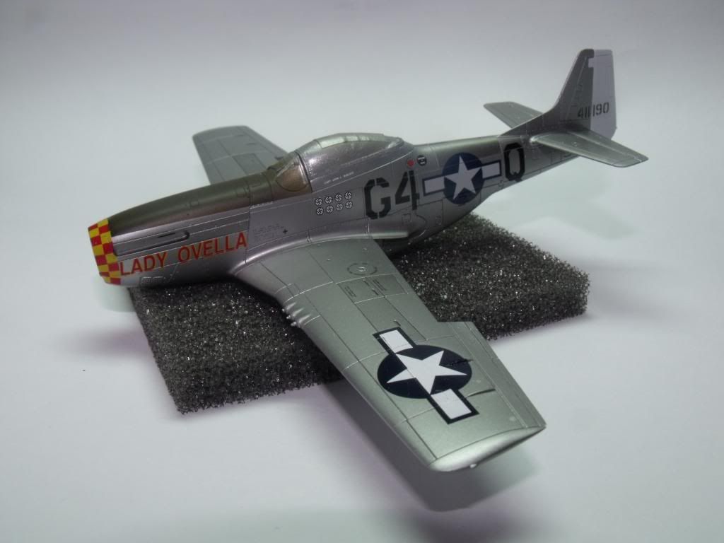

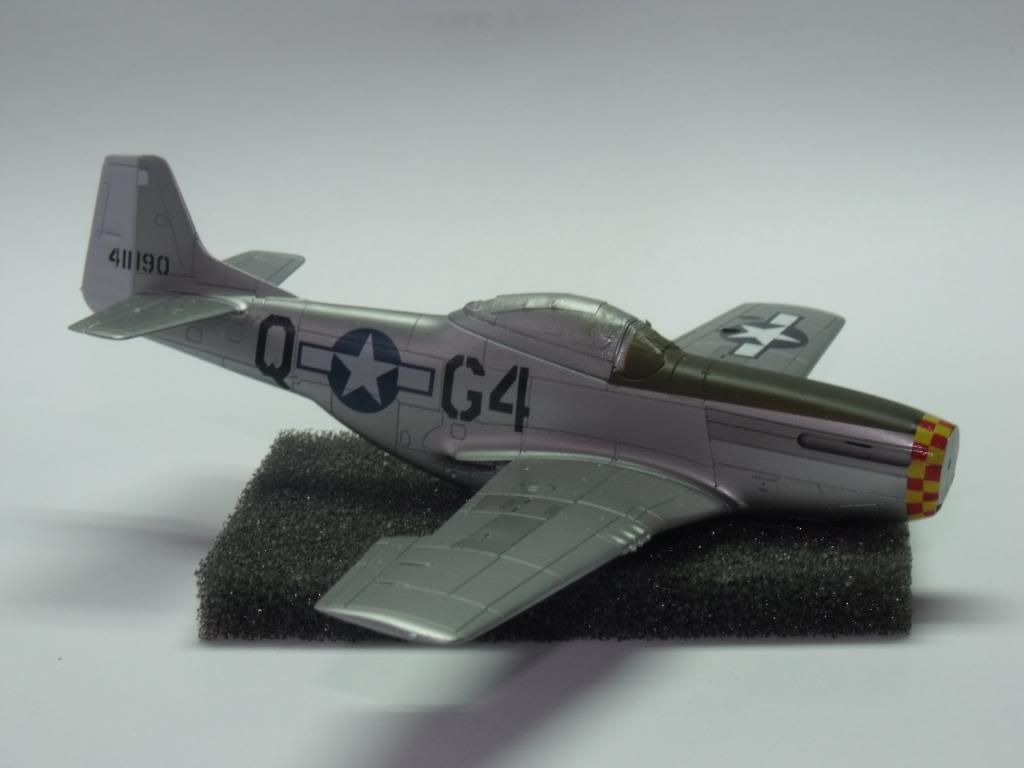

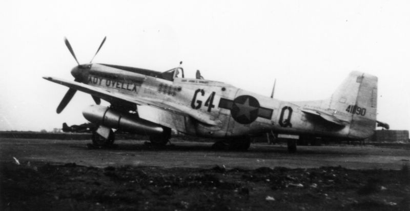

Have been able to move on with the NMF P-51 I have decided to finish her as Lady Ovella from the 362nd FS
The model was primed with FS 36270, the base color is Duraluminum, with the different color panels done by mixing
Jet Exhaust with the base color
All of the decals are now on, not bad for decals that are 20 year old, only had one break up that was upper wing insignia
that had to be removed and replaced
Just need to let all the decals dry, then future the model, weather, future then seal and it done
The next update now will be when the model is completed
One thing I did find out about the 362nd FS, it would seem from September 44 onward the NMF aircraft did not have the black ID strips
on the wings or tail planes, they also had the rudder painted white (363rd was Red, 364th was Yellow) I noticed this in the few color photos I have plus in the black and white one you can notice the "different color" to the tail

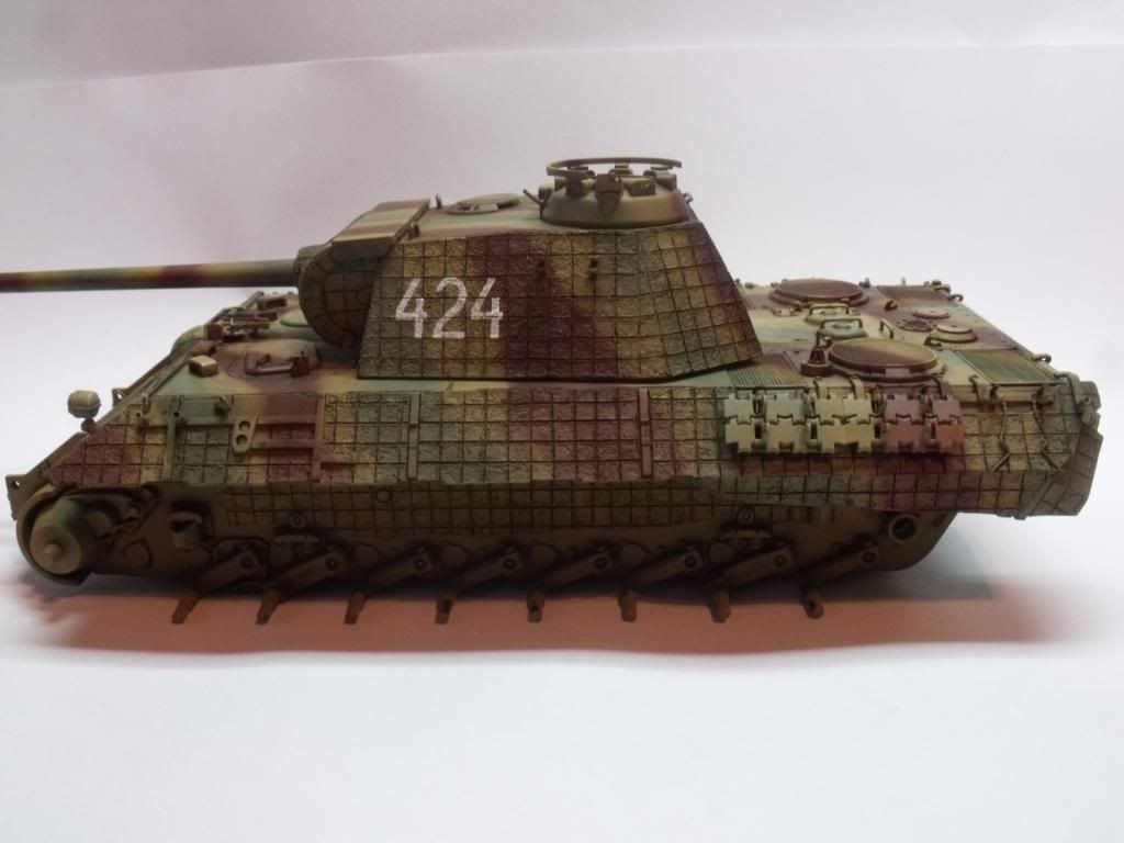

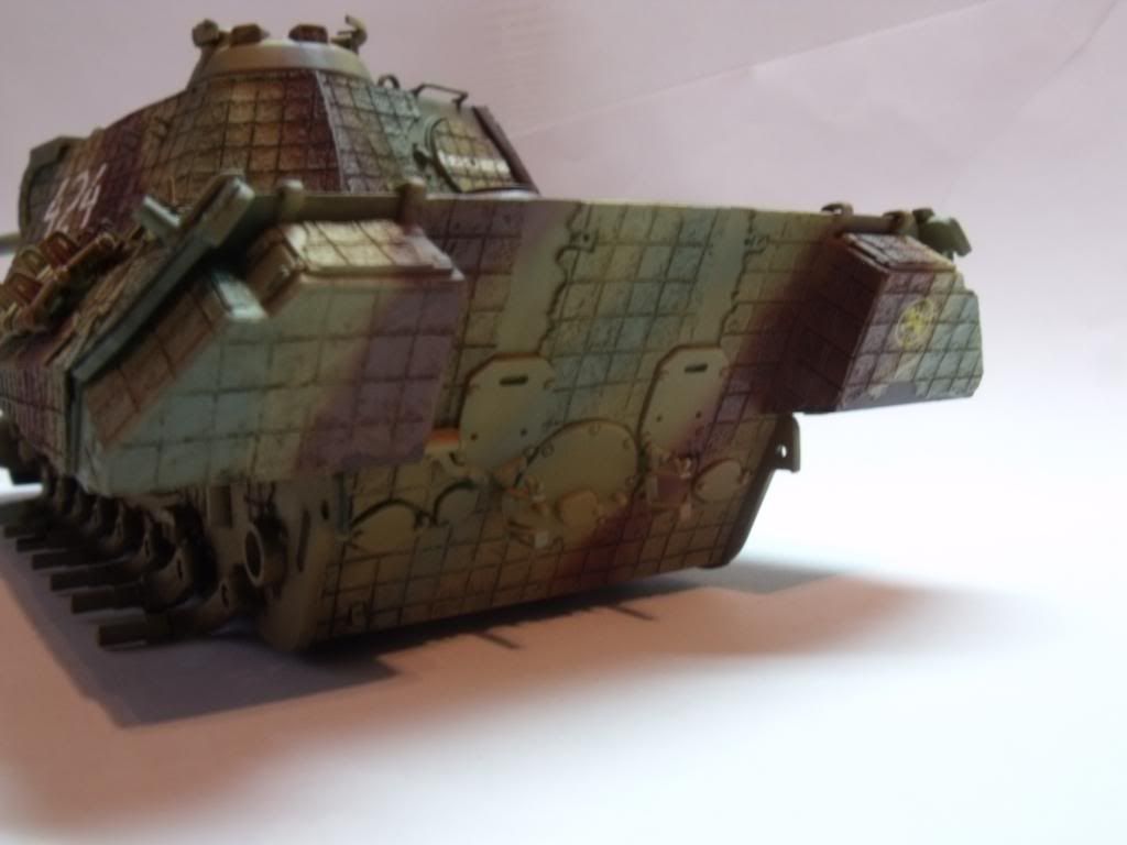

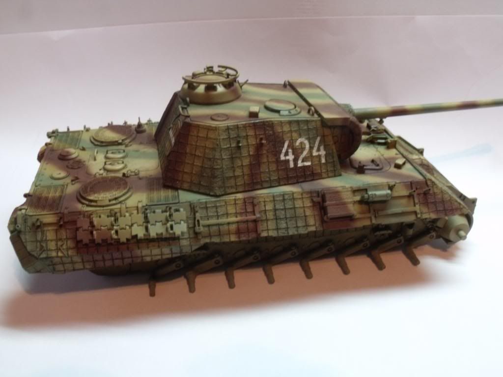

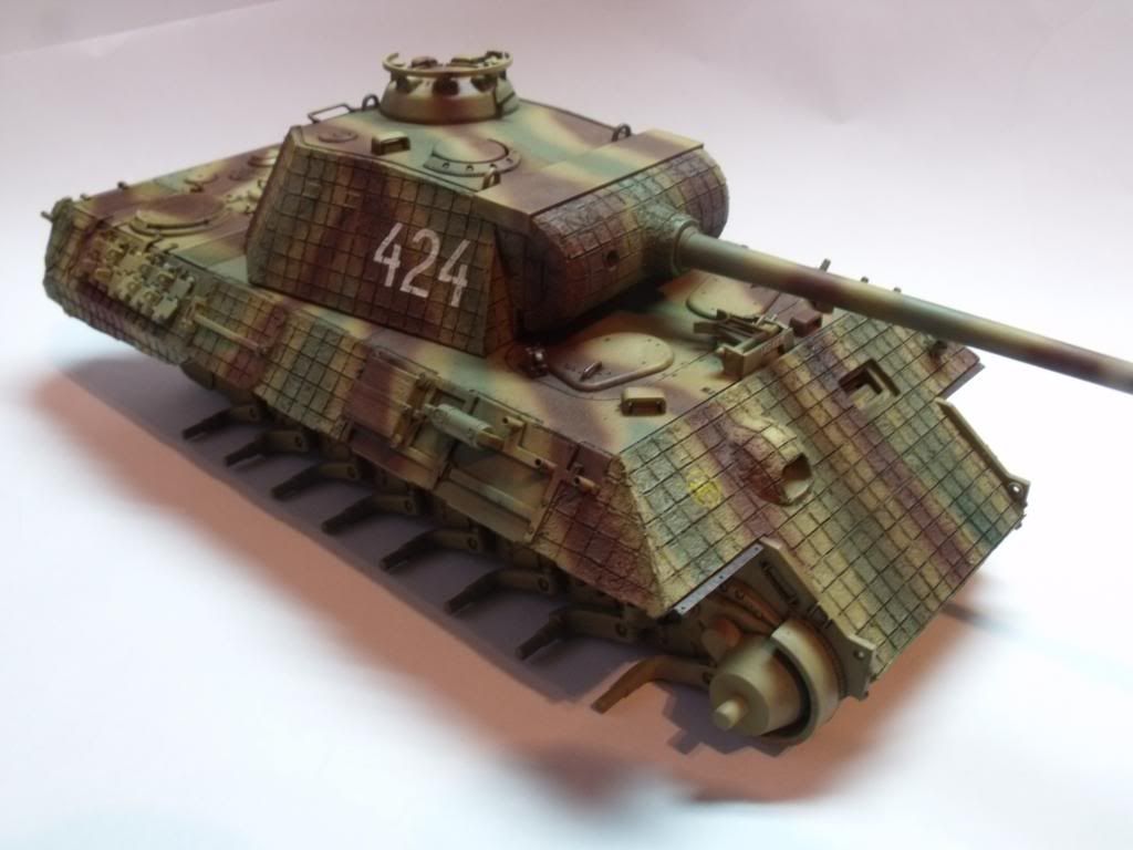

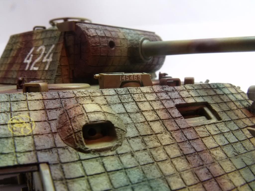

Pz.Kpfw.V Panther Ausf. A.Tank 424,4th Company of I./Pz.Rgt.24
in The Battle for the Third Reich Group Build
I am now calling this one finished
The rest of the photos are in the gallery
