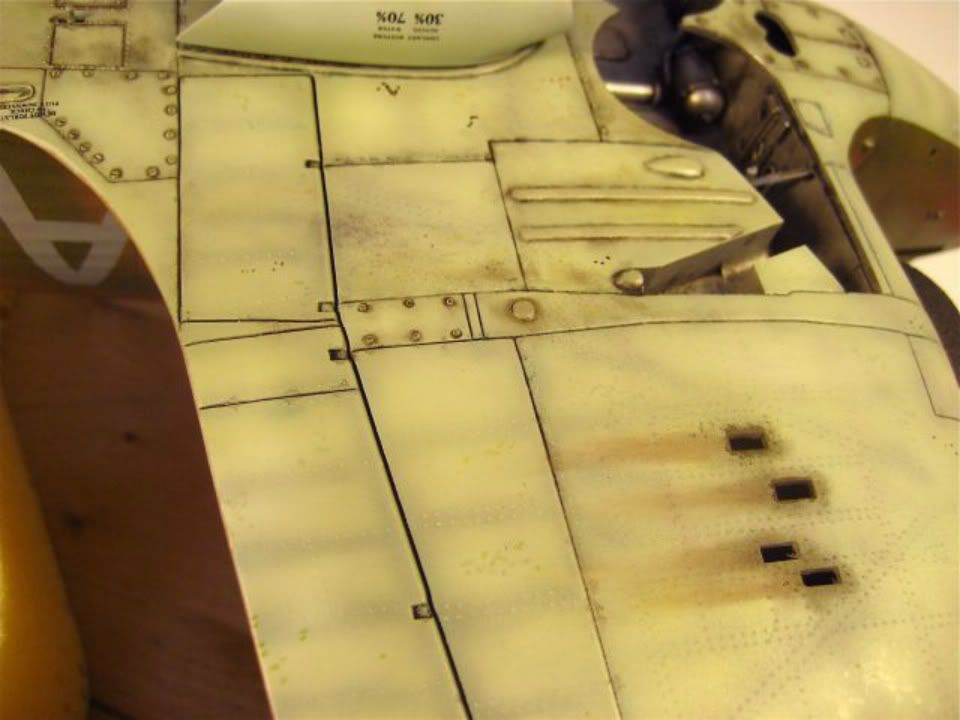

    Made a misstook. Should have put the four holes on the bottom of the exhaust shroud... Got a bit muddled.

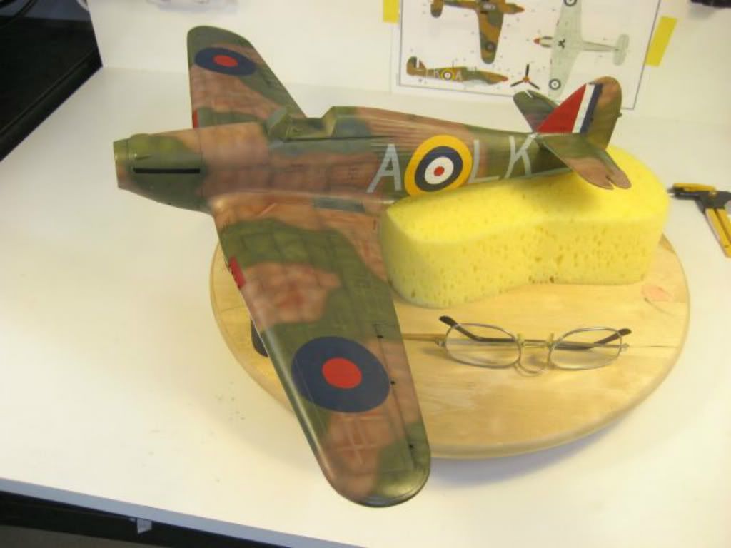

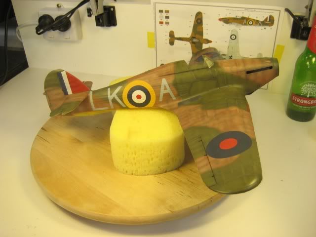

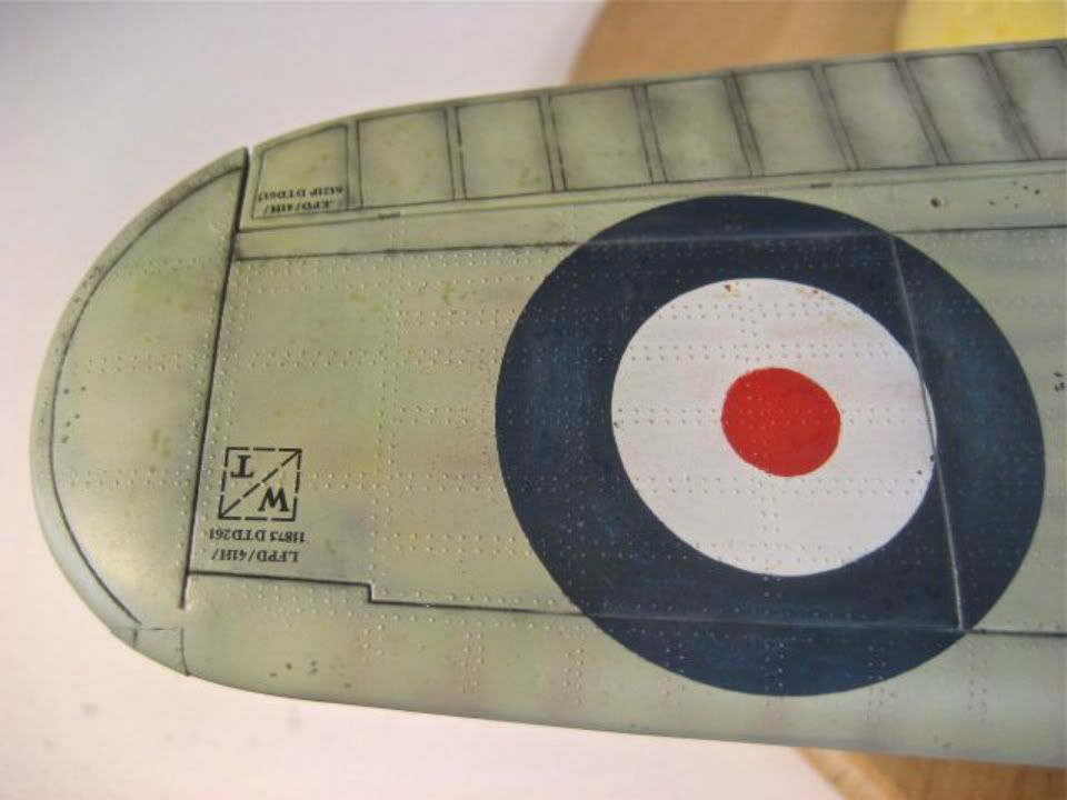

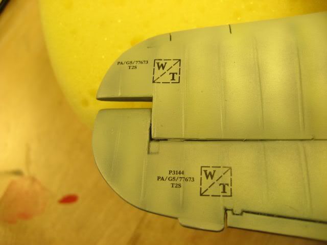

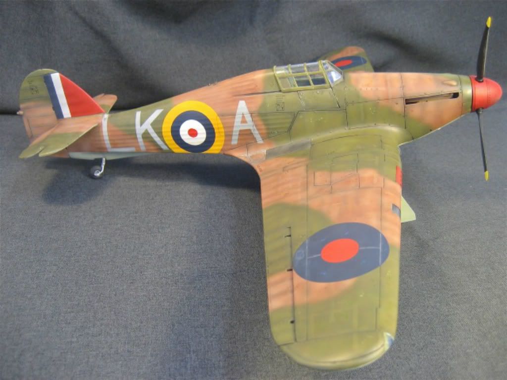

  10. Progress;
    Other side serials done.
    Real bugger getting that K in there without a ton of overspray. Looks as if they had to squeeze it in full size as well.
    Received HobbyDecal dry transfers on Friday( Love the post!) Started applying them.
    I have much better luck with dry transfers than waterside decals. A joy to use.
    Spent much of the morning grinding out the resin wheels I cast to fit the rims. I hadn't thought that the rubber tires in the kit are stretchy and therefore slightly under size, hence the grinding.
    A bit of paint and they are on their way.
    Worked on the belly radiator and the main gear struts. Took off all the underside masking and had very little overspray to fix up. Need to mask off so I can spray the wheel wells( Silver or interior green?)
    Having a ball and nearing completion. Now I have to find a spot to put her as I've just noted that she doesn't fit in my Ikea Deltof cases!
    Thanks for looking in.
    Dan

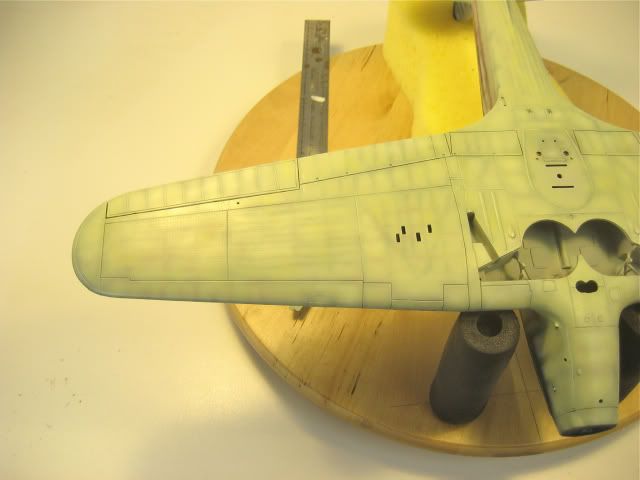

  12. What can be more fun than painting camo on a windy & rainy summer day in Melboourne ;)
    Now I just have to keep my mits off it for a day so that it will dry and then I can mask off the upper side roundels and markings. I've ordered the dry transfer stencils for her but they won't be in for a week or so, sigh.
    Mish--Thanks! Nice to know you like her.
    Mochealvk-- I paint most of my markings because I can't get decals to work for the life of me... I do like how the painted ones look even if it's a bit of work. The Airfix kit is pretty good for as old as it is. I'm never too fussed about detail as long as it looks the part. the kit builds well but I don't know how well the removable cowls would fit if you put the detailed engine on display. I used a heap of superglue and a bit of brute force to get them to fit closed. Good solid kit and a base for detailing.
    Smeds--Haven't seem the Trumpeter kit but one of Airfix best big kits along with the Stuka. In fact if you've built the Stuka then the detail and fit are very much the same.

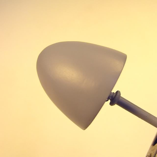

    I've spent much of the day scratching a replacement spinner. My kit was missing one when I opened it.
    I stuck lots of pie shaped profiles of the spinner onto a round baseplate. Then used two part epoxy putty to fill the gaps, after a rough sand to shape. I covered the lot in a thin layer of superglue and talcum power.
    Much sanding latter I have this;
    I've still to add the middle joint and some other details but It's looking a bit like a spinner.

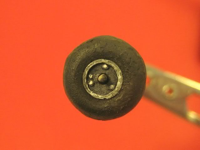

    Working on other bits too. Didn't like the rubber tires and so i cast a replacement tailwheel in superglue from a open face mould.

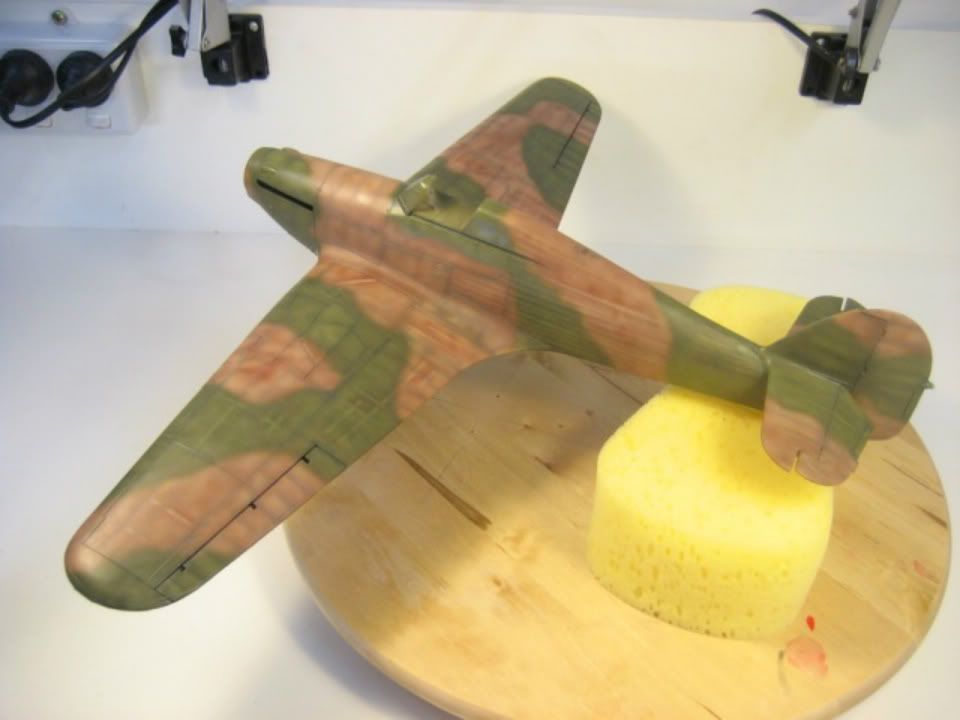

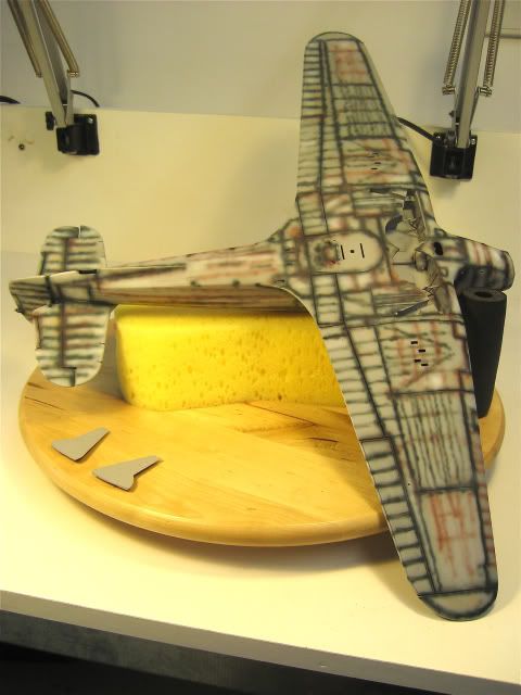

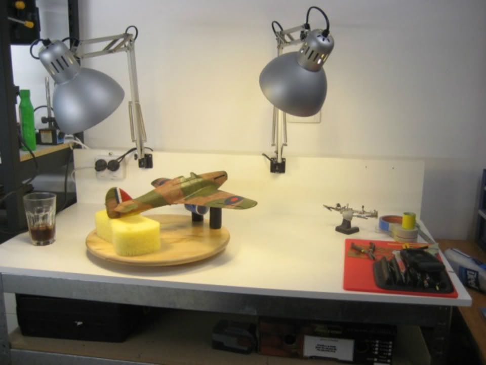

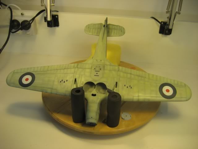

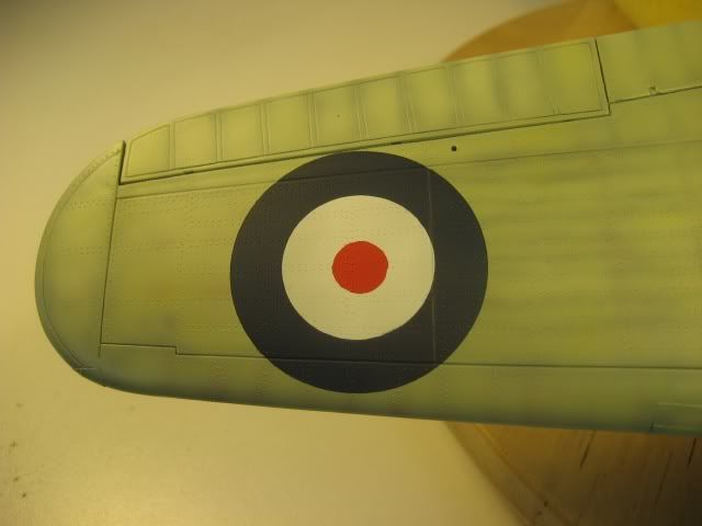

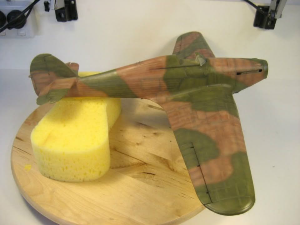

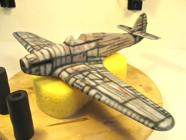

  14. I just wanted to play around with some paint so I broke out an old Airfix 1/24 Hurricane and put it together in about a week over the Christmas break. The kit went together very easily and primed up quiet nicely not too shabby for a kit that's as old as this one.
    Bit of pre shade.
    And then on to the sky undersides.
    Still a bit contrasty but it should weather down in the end. I've got to wait until the paint cures a bit more before I mask off for the roundels.
    All paints are Tamiya acrylics thinned with Tamiya lacquer thinners.
    Thanks for looking.
    Dan

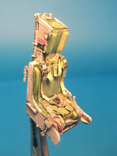

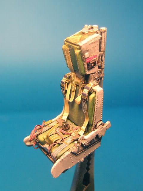

  15. Progress, Rear ejection seat belts finished;
    Slow going for me, about six hours with the Eduard PE set.

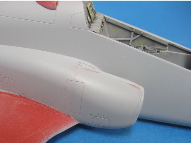

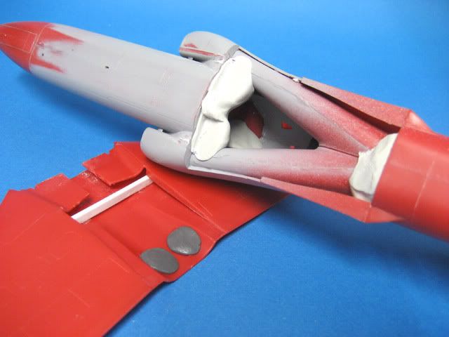

    More progress, wings on intakes sorted;
    Tried something new on this build. I have constant problems with cracking seams while I'm sanding out joints. I usually use super glue to both join major parts and as a filler. I must just be too ham fisted and in the process of sanding invariably crack at least one major joint. I thought if I could somehow reinforce the joints I'd have a better chance to not crack anything. I've been using 5 minute two part epoxy putty with some success on the hawk. Here is a pic of what I'm trying.
    The putty can be pressed into make a shelf for the wing to rest on. If you wet one part like the wing the parts can be pressed together and the wing then removed leaving the putty still stuck to the fuselage but perfectly shaped to support the wing once it's glued on. I also used putty to
    beef up the fuselage joint and to fix in the cockpit. So far so good.

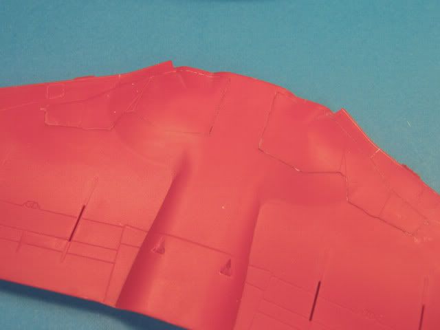

    Here's the belly seam after rough sanding and the first coat of primer.
    I spent a fair while trimming and sanding the parts until I had a good fit before grabbing the super glue. Lots of dry runs to get the best possible fit, though to be fair Revell have done a pretty good job on this kit.
    Here's the intake;
    Still working along. Hope to get the rest of the main parts together soon.

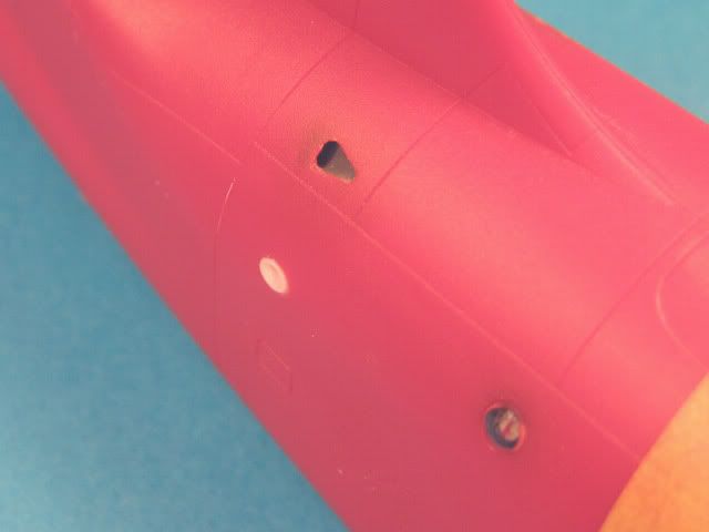

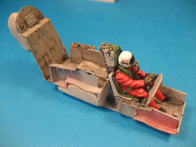

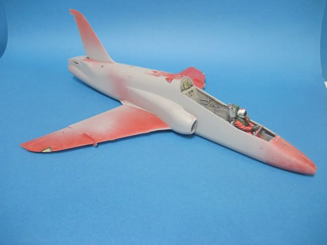

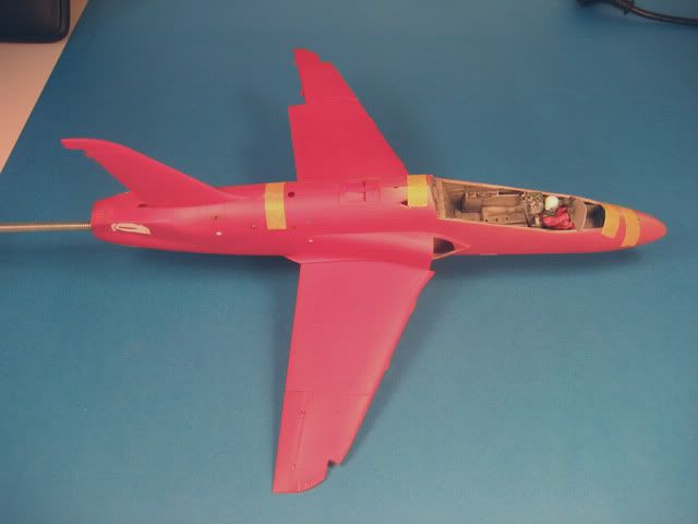

  16. I've been fussing around with my second Revell Hawk kit. I've really been inspired by Geedubelyers build and have shamelessly copied many of his modifications.
    As I wanted to make this one in flight the first order of business was to get a suitable pilot. Revell didn't provide any pilots, a real shame as they make it very easy to build this kit as if it's in flight, and so a Frankenstein like creature was hobbled together out of a Hasegawa Fw190 body and modified Revell X-1 Head and arms.
    He needed a lot of thinning down and chopping about to get him to fit in the tiny space of the cockpit.
    I also had to lop off a bit of the bottom of the ejection seat rail to get him to sit down far enough.
    Following along with Geebudelyer, I opened up the vents on the tail and then backed them with epoxy putty and used a toothpick to press in openings. For the gauges I scribed a line on the back of the glass then filled the line with red paint. Once dry I used a thin strip of white decal to make the gauge and then painted black over the whole back to seal it all in.
    I used the epoxy putty trick again for the dorsal vents as well.
    Have glued in the main landing gear covers and all went very well.
    The kit is going together quite well and I've managed to mount the aircraft on a bit of threaded rod.
    Such a nice easy kit to work with. Makes a nice change from struggling with older kits. I can't wait until Revell release a second run in grey plastic with different decals.
    Thanks for taking a look.

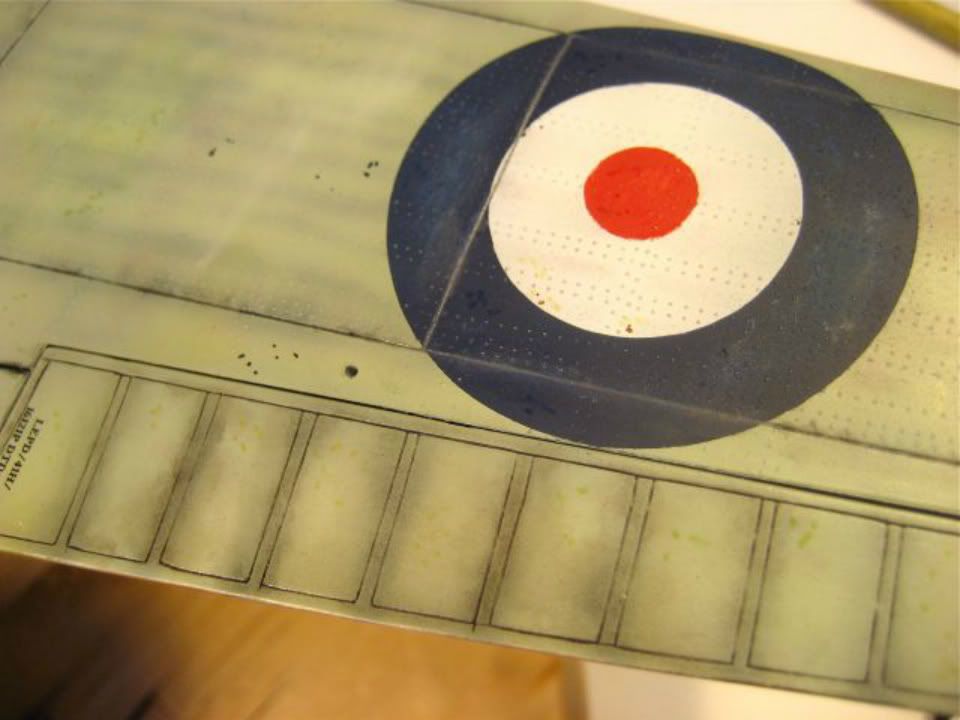

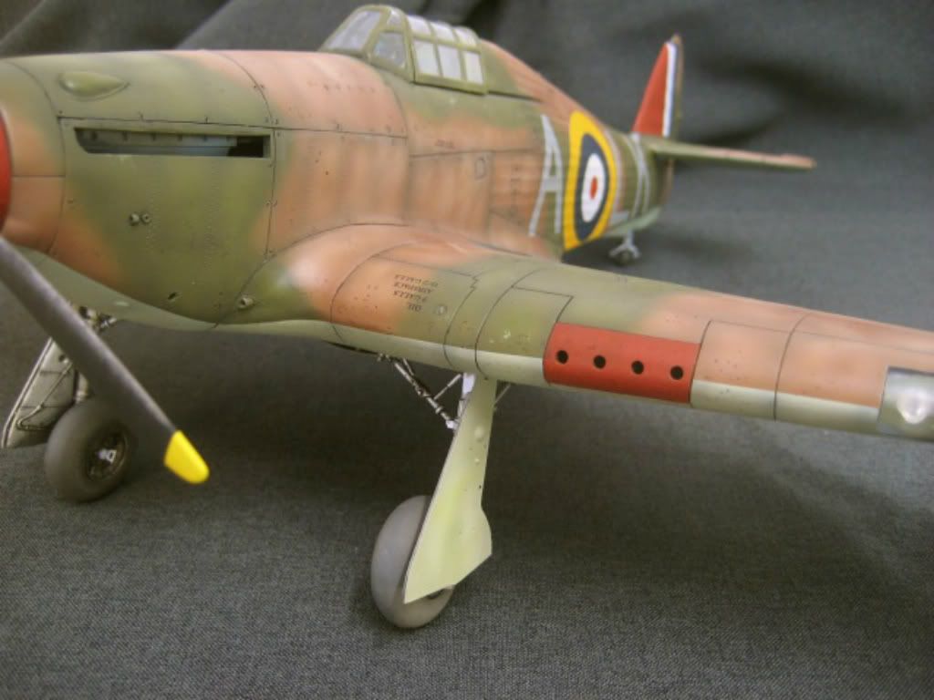

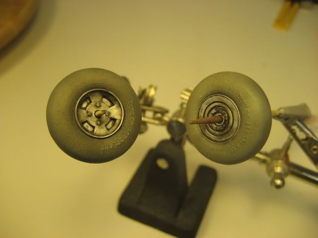

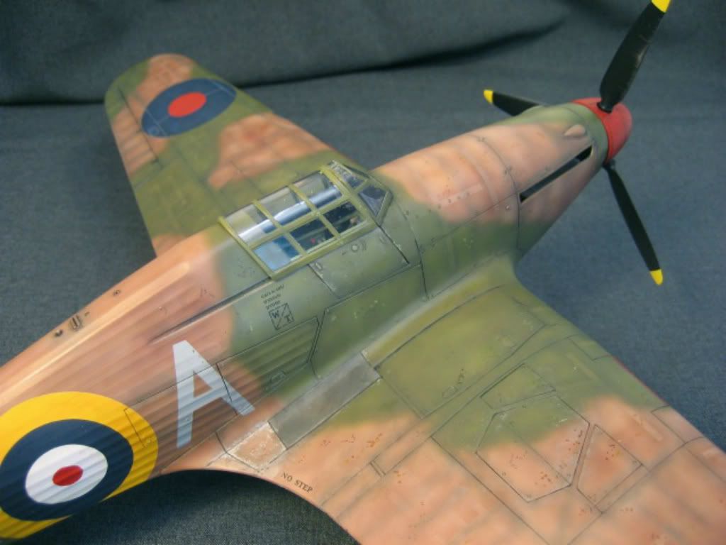

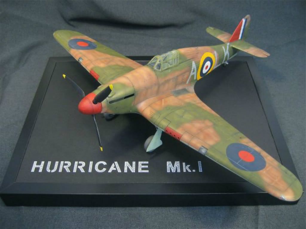

  17. Slow going but a little progress.
    Wheels got finished;
    Over cooked, and I was trying to be restrained :BANGHEAD2:

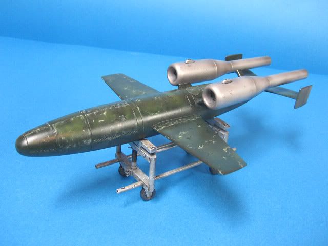

    A little detail painting but I tried real hard to stop myself from doing my usual over board chip and bang it to death finish.
    The mantra was KISS Keep it SUBTLE stupid.
    Last of the decals went on and a nice thin even coat of Testers Dull Coat to give a semi flat finish.
    topside.jpg]
    Just a very few additions to make before I make the display base. Might even, gasp, get her done by next weekend.
    Happy with the way the finish turned out but man am I itching to just add one more chip.....
    Maybe the next one can be ready for the scrapers torch.
