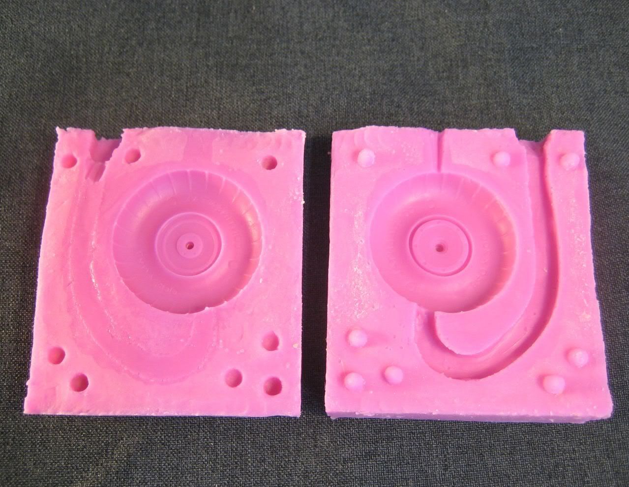

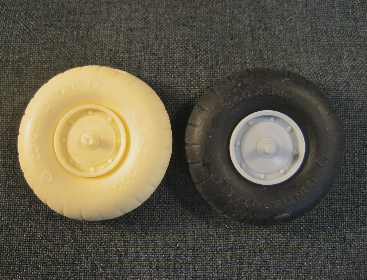

  1. Got the Stuka bug again.
    I wanted to replace those ucky rubber wheels. Went to the bungalow to get the moulding rubber and oh no! I'm out... Off to the shops and find that the kind I usually use isn't easily available but you might try this Sir.
    Okay it's a bit pink but who am I to judge...
    Followed the directions and got this.
    Which made this.
    I'm pretty stoked. This Pinkysil only takes about 40 minutes to set opposed to the 24 hours of my old casting silicone. and works a treat. Even with really old casting resin it produced excellent results.
    After a horrible week I get a win! I'm off to make a couple more. Only need to drill out the axle, I never expected that to cast well, to paint and then mount into the spat.
    Happy Dance....
    Dan

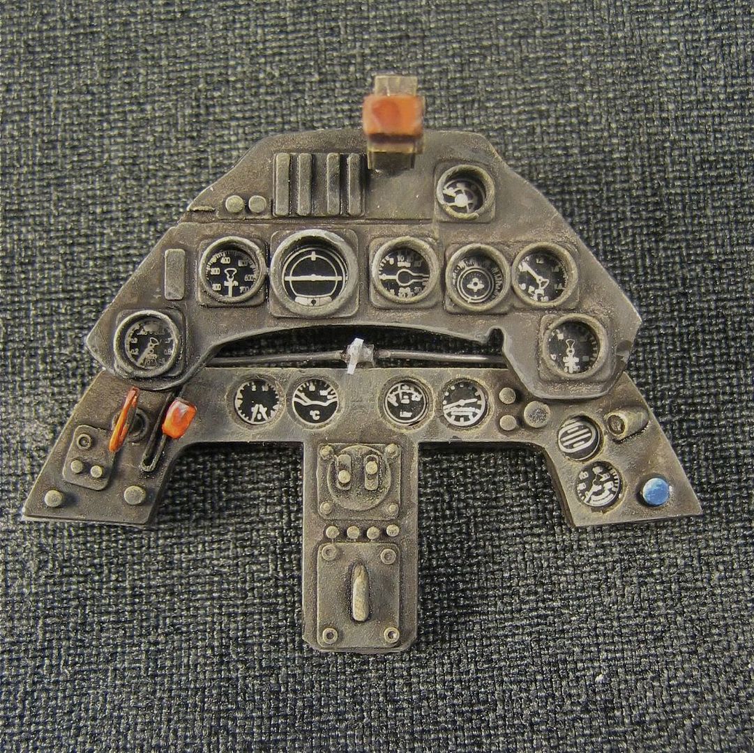

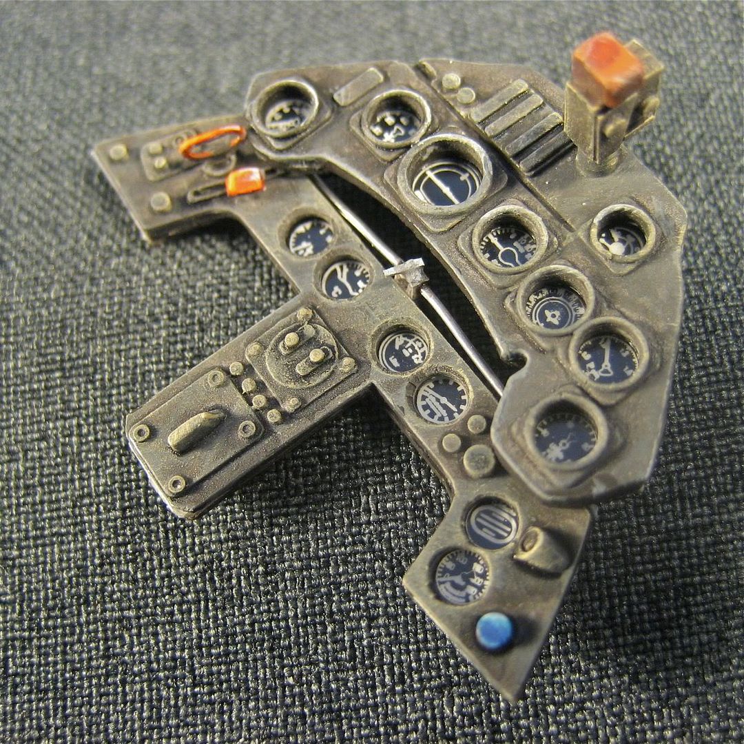

  3. Progress;
    All day to work this up. Scratched up a gun sight and had to cobble together the IP as it comes as two separate parts.
    More work to do on it and I have to try and shoehorn it into the fuselage. But that's a job for tomorrow.
    A big thanks to LSPKev for the Airscale IP decals, Thanks mate.
    Dan

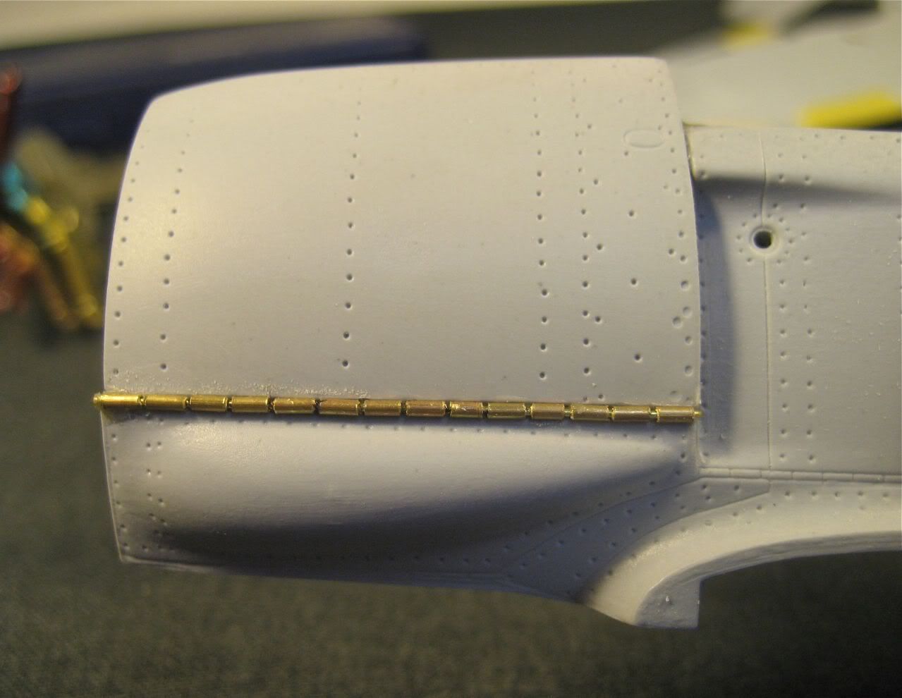

  6. Progress; (If you don't count going half blind cutting tiny bits of brass tube.)
    Just wanted to do some hinge detail as not much offered in the kit. Lots more done around the kit but nothing much to take pics of...
    Only two more hinges to go. 'Bout had it trying to cut all those 2.5mm bits of brass tube....

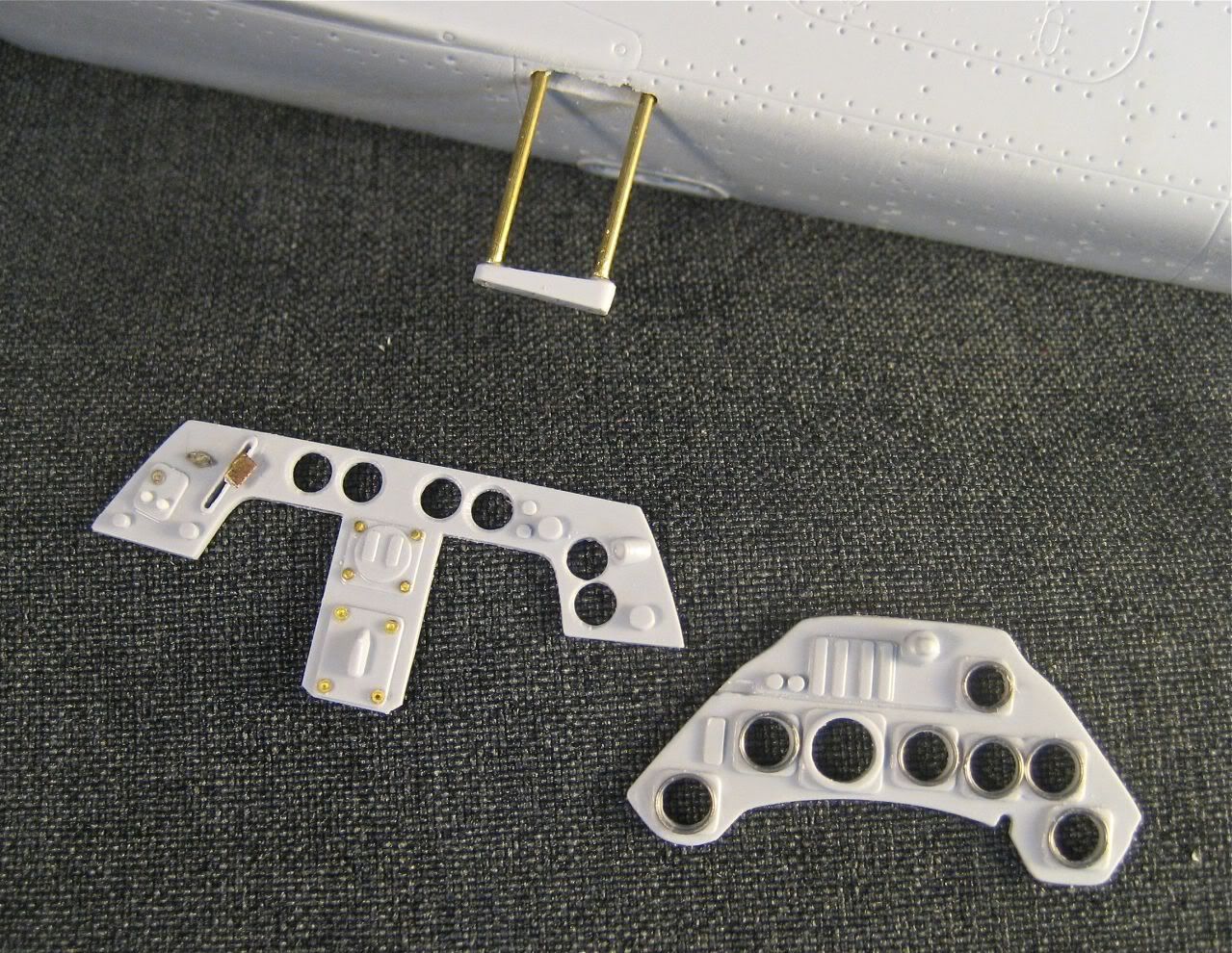

  7. Progress;
    Thinned the IP and added some bitza. Now I have to figure out what I'm going to use for instruments as the ones from Eduard aren't up to scratch. Might have to order the decal ones and go with them as I've wasted a fair bit of time today seeing if I could use the kit glass piece now that I've thinned the IP. Sigh, a bit more thought might have saved me some work. I'm also considering printing some onto clear acetate then flipping it around and painting the back white(old school). Fixed up the step with some pinned brass and the kit part. Doing a lot of cleaning up of parts and test fitting but not much else to show.
    Dan

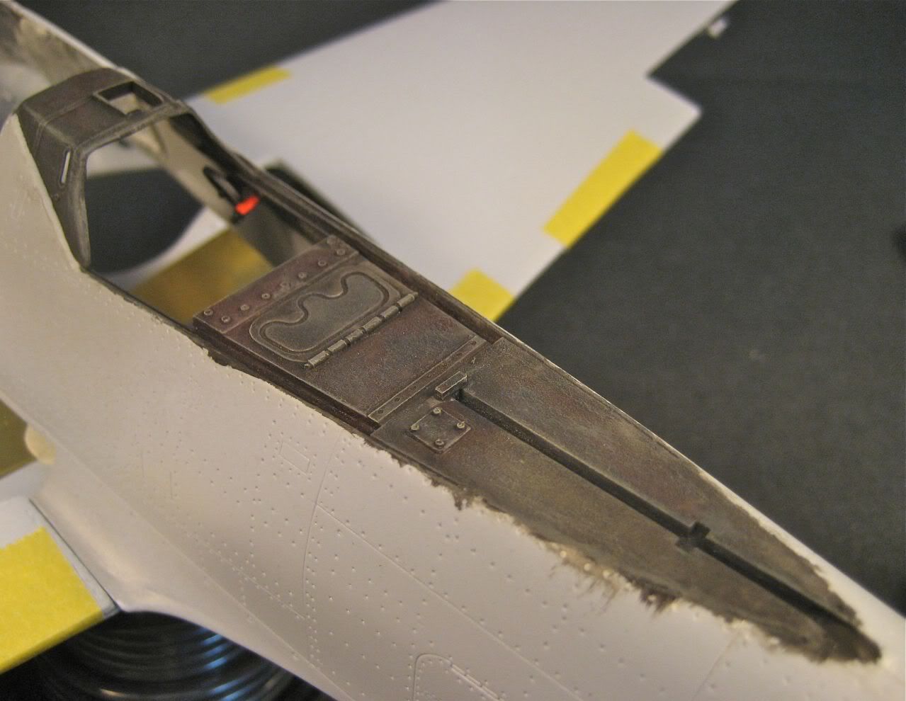

  9. Progress;
    Started work in the cockpit, filled those blinking sink holes in the prop and did the other side of the cowl flaps.
    Really thinned the canopy retract and added an emergency jettison lever.
    Started to add rivet detail to the underside of the fuselage with a tiny round Dremel ball cutter. ( The kits rivets get real soft on the top and bottom of the fuselage, molding limitations I think.)

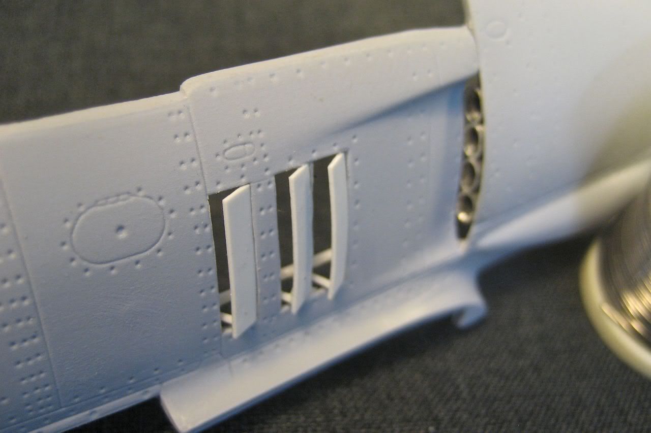

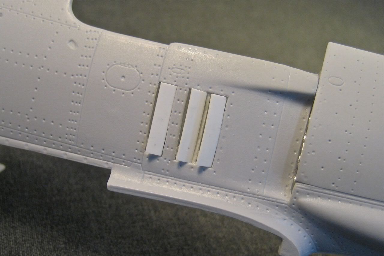

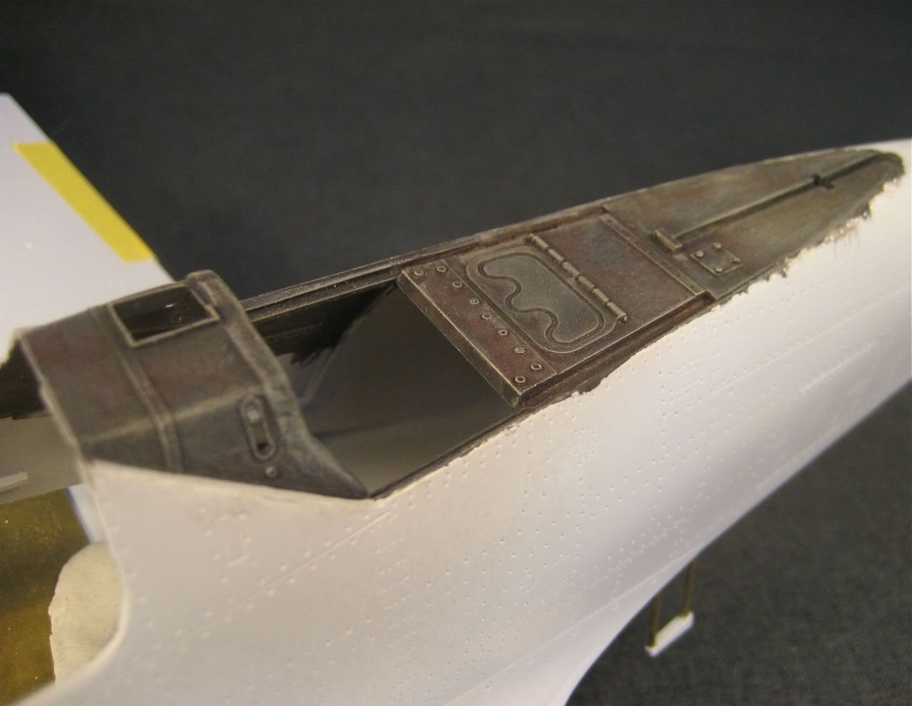

  11. Not much to report as I spent much of the weekend trying to etch bits of brass :(
    Also at SWMBO request(order) started to clean up the man cave.
    Got my old eMac up and running and working with the new laser printer so more etching awaits.
    Fw-190 got a new exhaust pipe, tricky sucker as lots had to be hacked out to make room for it.

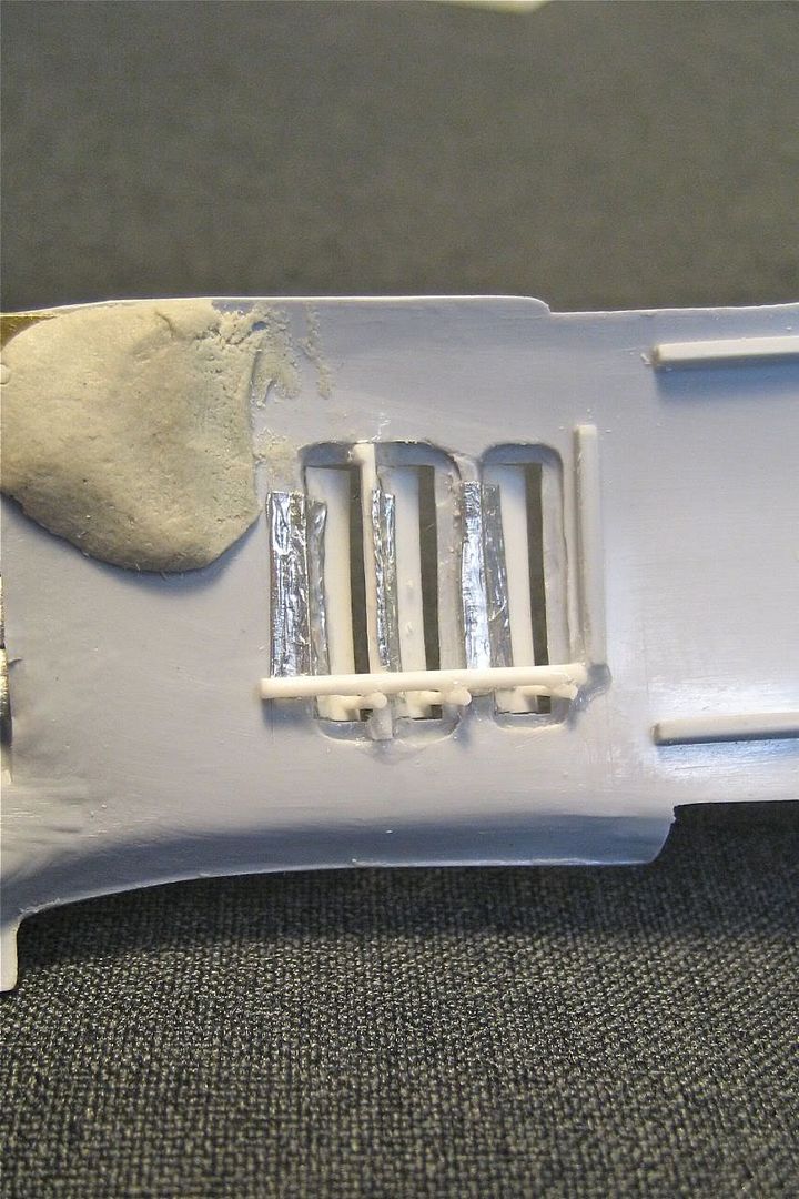

    Started work on the cowl flaps;
    But on looking at these pics I may just rip it all out and do it again. Concept worked but execution pretty poor :(
    Forgot to curve the lone flap and the others not too straight. Need to sleep on it before deciding.
    Heaps more to do but will have to wait.

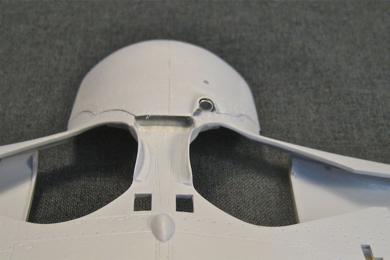

  15. Progress;
    Done a fair bit of fettling and dry fitting of the major parts. So far so good.
    Major problems in the front on top of the cowl just at the gun troughs( hope to fix it with some major shims). I'll need some shims at the front of the wing roots and on the belly at the back of the wing joint. Pretty good really for such an old kit. Cockpit fits in from the bottom but the wings needed a whopping great big brass spar to get some dihedral going. Shudder to think of how I'm going to get the landing gear to have that threefold angle right but I'll worry about that later.
    Most of the rest of my time is on thinning edges down and drilling out vents and the like.
    Starting to put the exhaust in from squished ali tube.

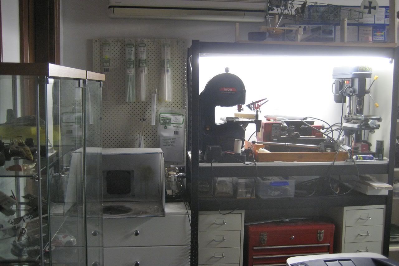

    More tiny bits o stuff.
    Got to fire up the lathe for the O2 bottle. Such fun.

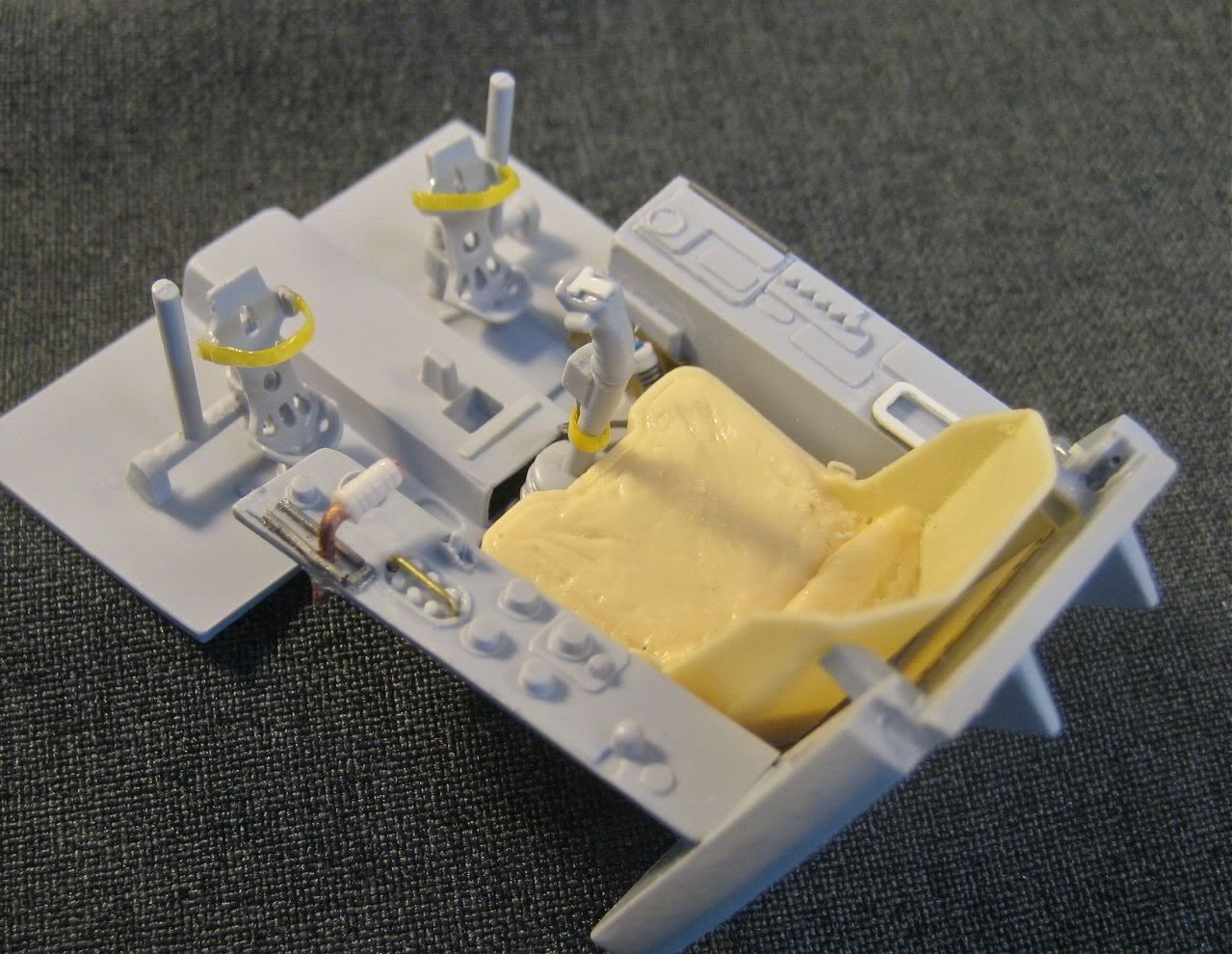

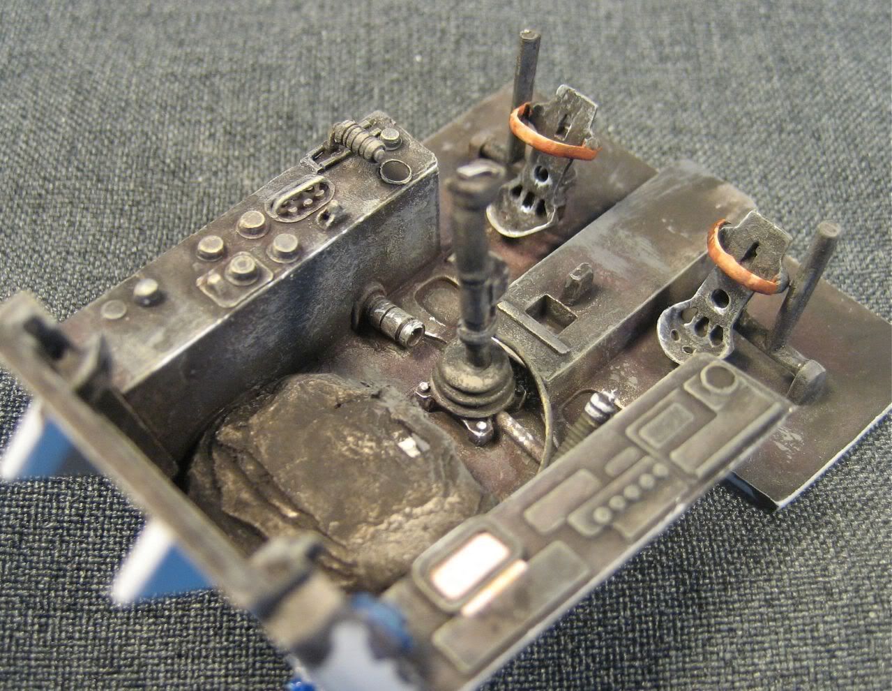

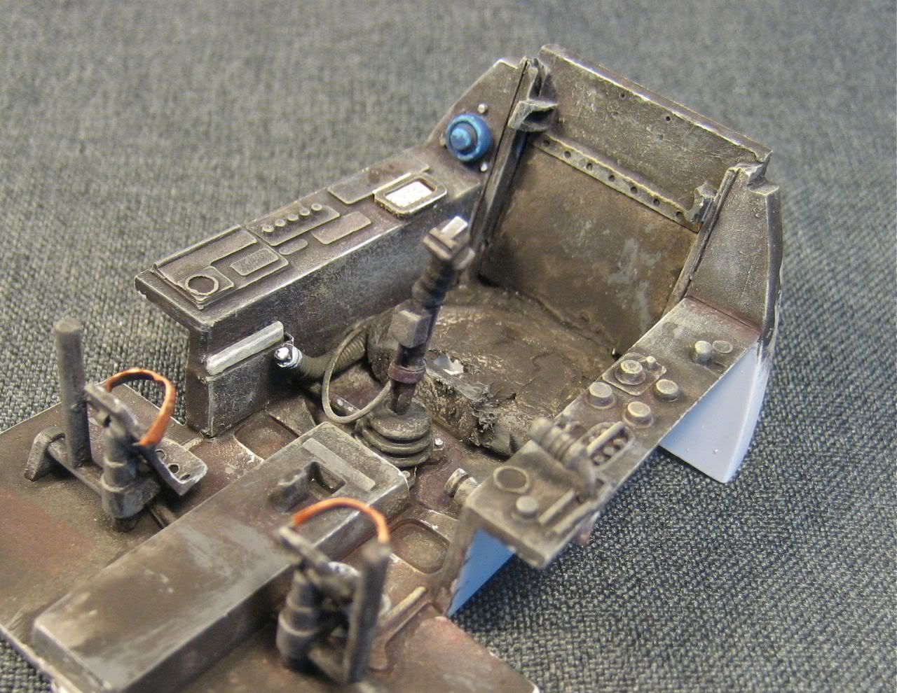

  18. Progress;
    Started working on the cockpit. Spurious floor detail and some wiring to the radios. Seat got its sides hacked off the thin 0.5 mm extensions and then capped with some thin styrene side plates. New seat pad from epoxy putty. Awaiting Eduard belts.( Anyone know where the shoulder belts attached to? Rollover bar?
    Expended ammo bag was just a slab sided styrene box and I wanted to make it look more like canvas over a metal frame. Broke out the Dremel and after a bit got this.
    A bit more texture and I think it will paint up okay.
    Thanks to all for the feedback.
    zimmermaniac--Thanks. Don't mind me I'm never fully happy with what I do. Always think that I could have improved it somehow. The MG15 look more bland than I had imagined it while I was painting. Doesn't pop. I'm also thinking of replacing the spent ammo bag/case with the bigger accordion shaped one. I've since been told that the one I have on it should be made of thither and not tinplate as I've shown it.
    Dan
