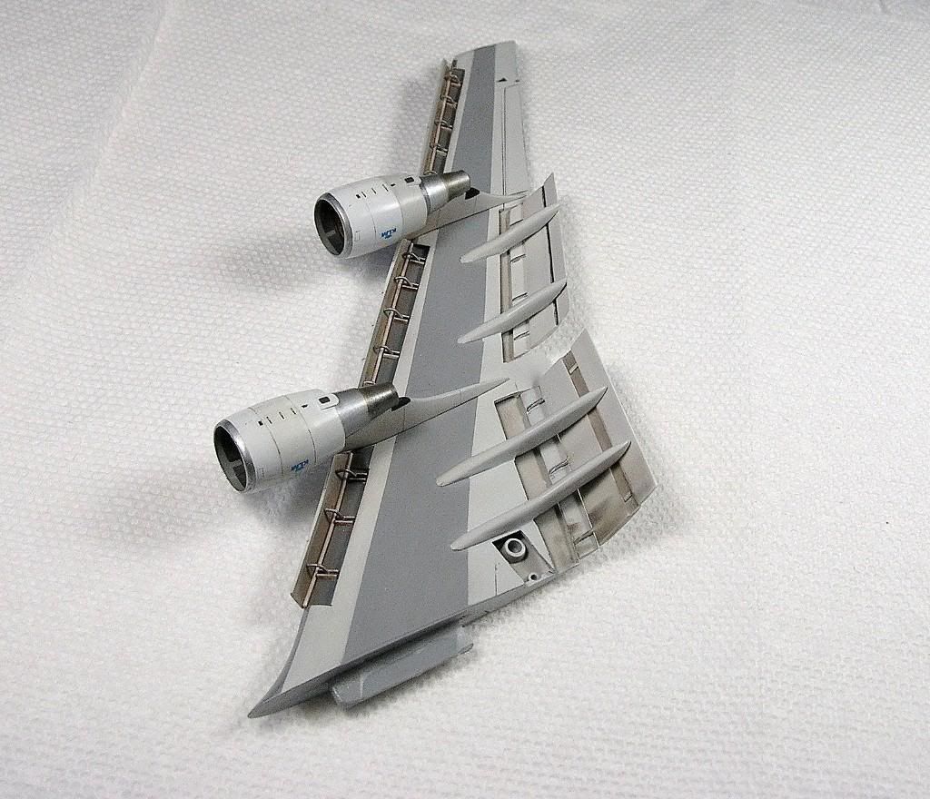

Cut the left wing. So off went the LE and TE flaps, as well as the fairings for the flaps extension mechanism. I didn’t realize what kind of trouble I am getting myself into with this take off configuration.
A good part of the wing is removed and lots of gaps need to be filled and sanded.I knew there is a flaps set for sale. However, the cost is many times the price I paid for this B747. Guess I will do my best to fabricate them. Again, another trouble I am getting myself into.
