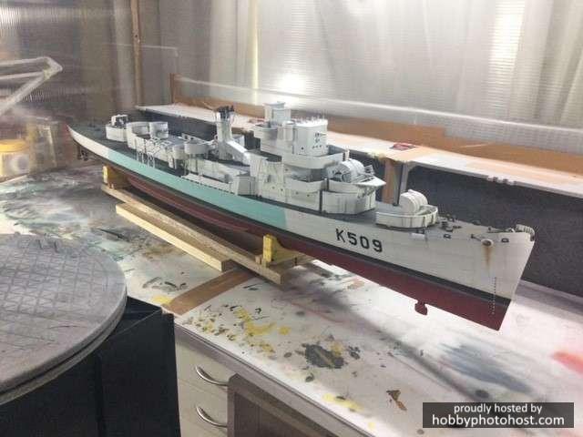

  20. Some time ago, in a discussion with other members of the board, I posted some photos of the Captains Class frigate I am building in 1/72 scale. At the time I said I would post some updates as the build moved along. It's now progressed to painting and fitting out, so its high time I shared some photos so those interested can see how things are coming along. This is a radio-controlled model and, as such, there needs to be provision for access into the hull for batteries and maintenance, but beyond this I am seeking to keep the build as close as I can manage to its likely appearance and configuration in April/May 1945.
    https://cdn01.hobbyphotohost.com/p?i=a247b899de80955e364e783094c46384
