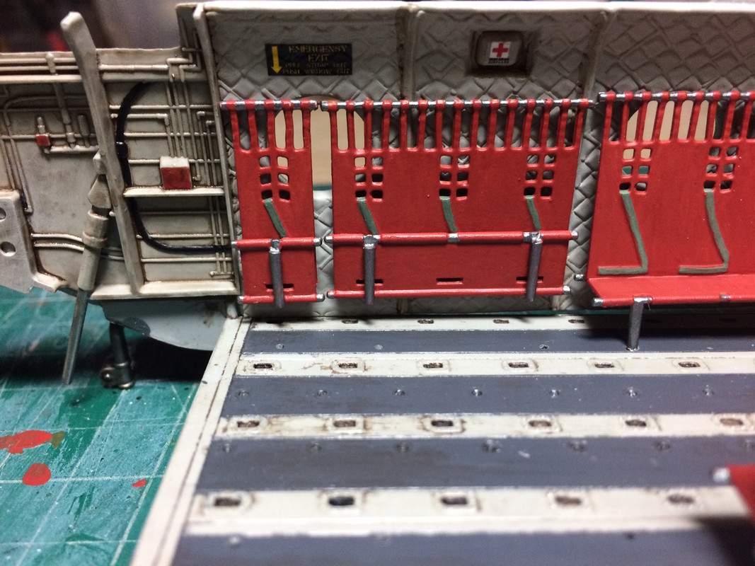

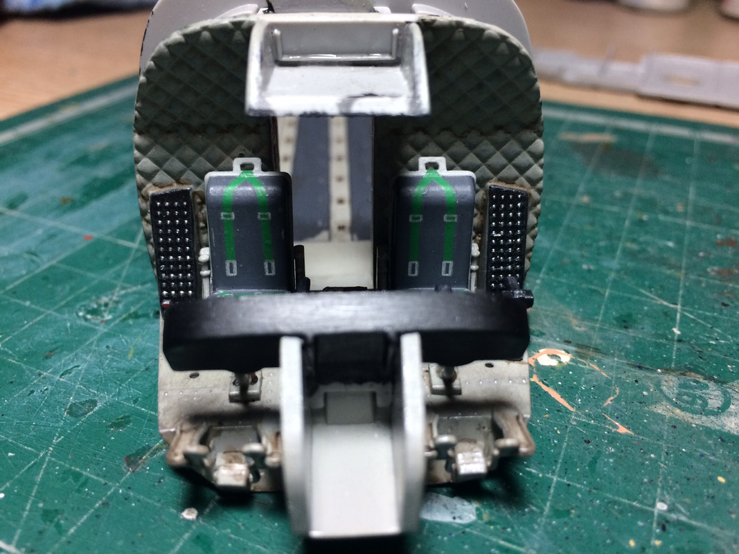

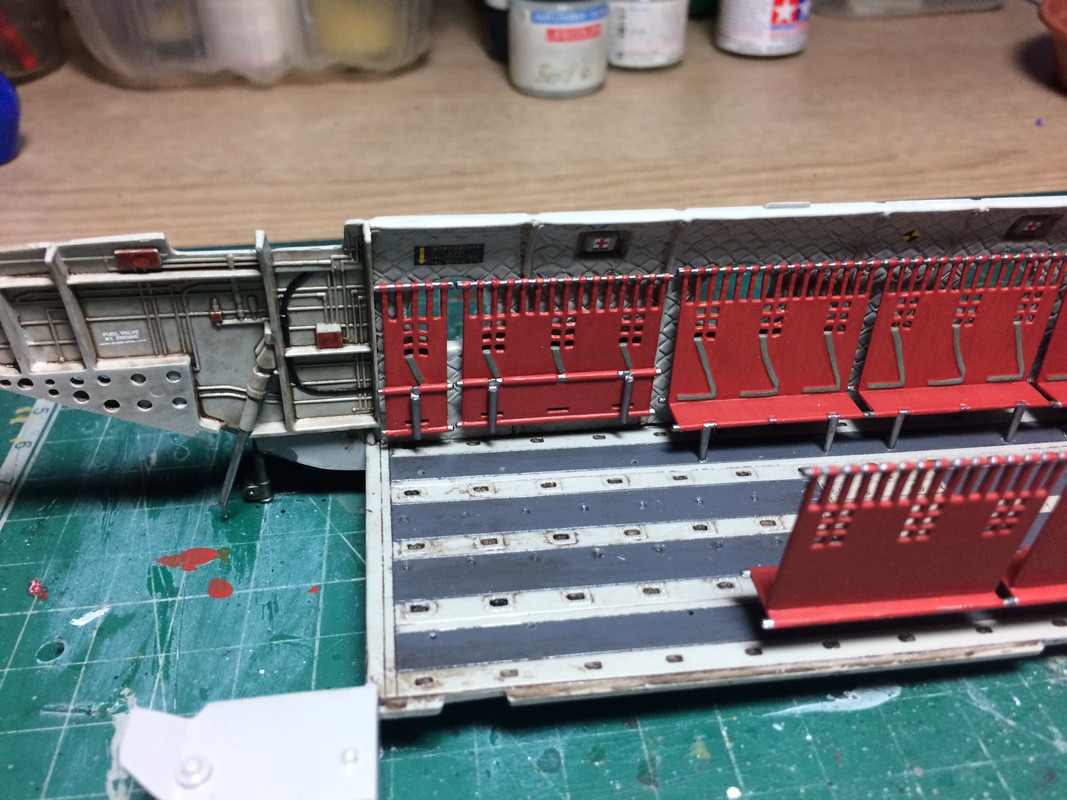

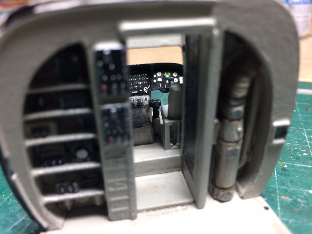

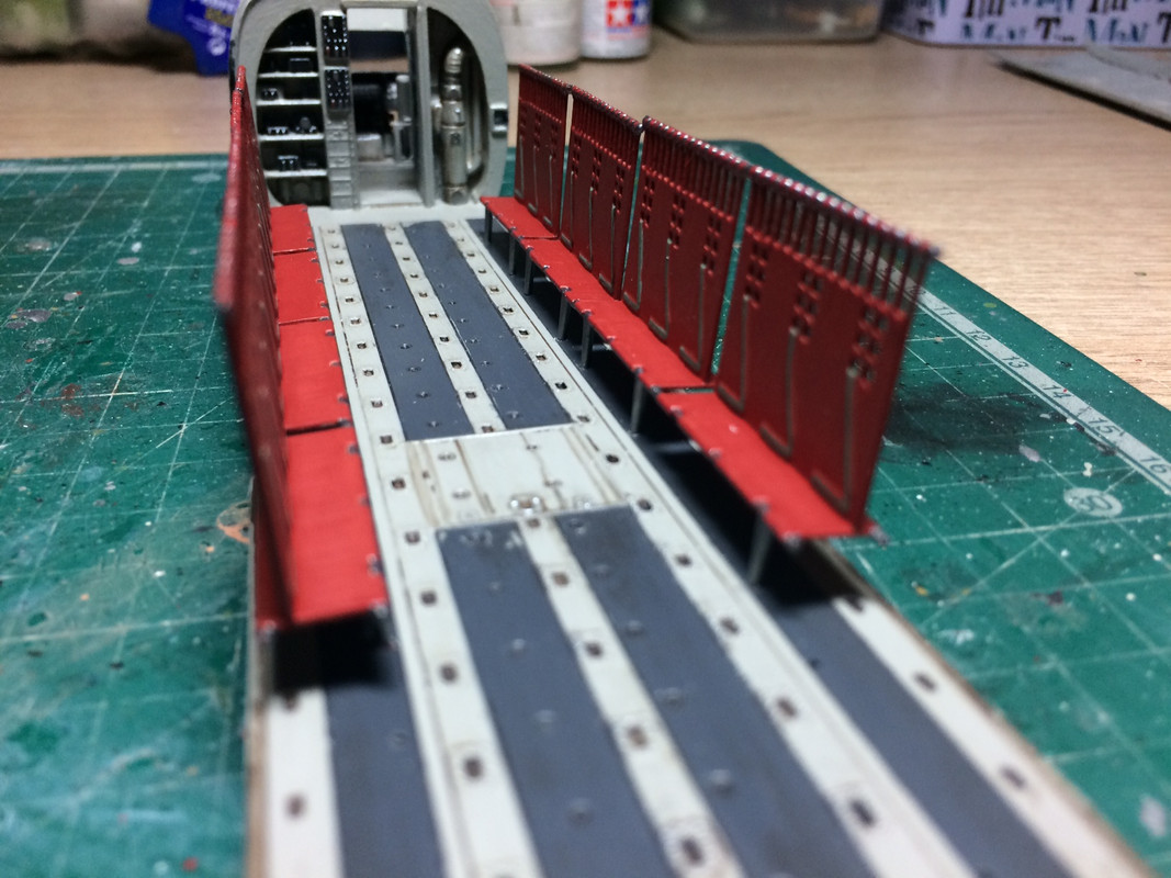

Hi all,
I started this build about Two weeks ago - I will jump straight to the present, I have assembled and painted/weathered the cockpit - main floor, fitted the main rows of bench seating and decided to convert the last Three seats (each side) at the rear into folded up seats, I have also detailed the rear bulkhead sections above the rear ramp, the other inner wall needs the same detail - then plenty more work before I can close up the fuselage.
Erk

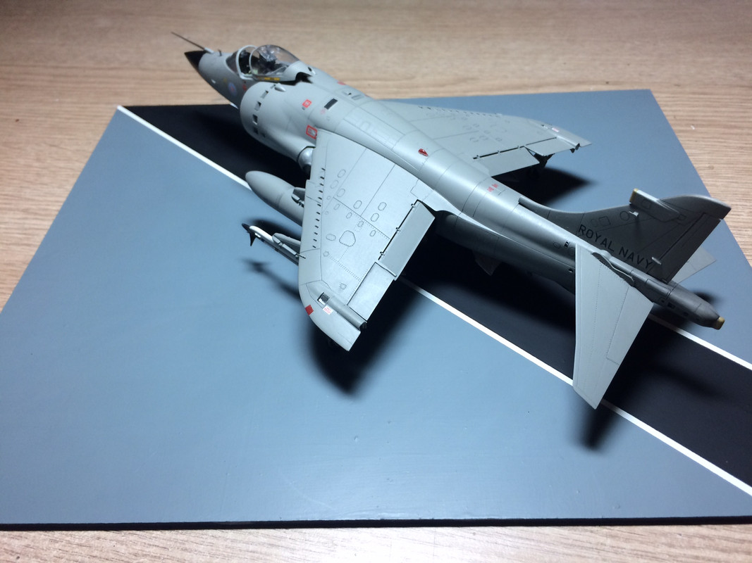

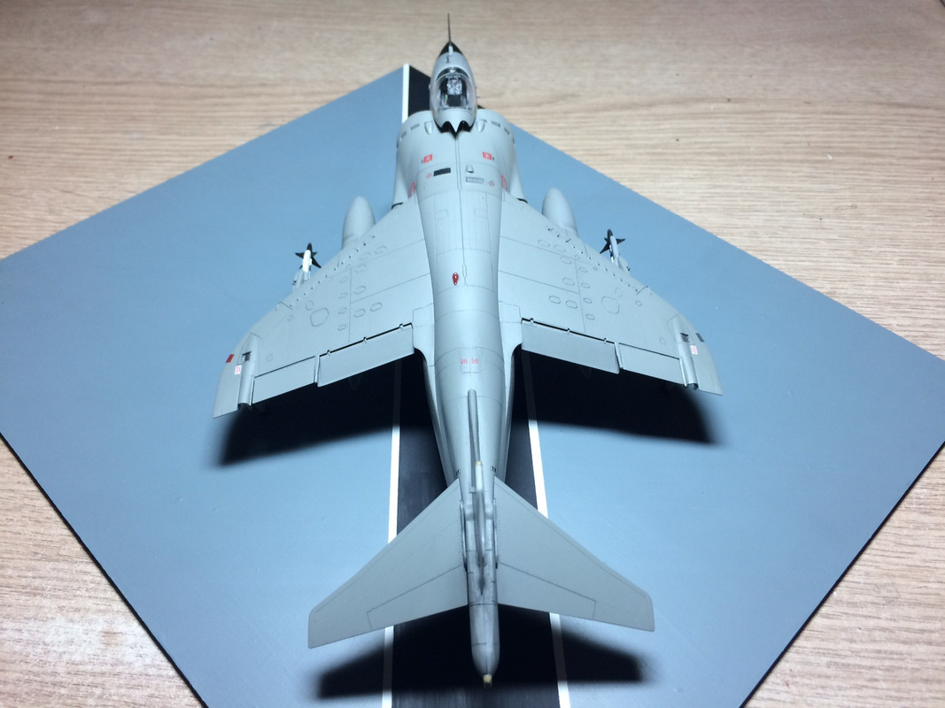

6 hours ago, exdraken said:
Very nice Harrier!
Rately seen in that plain scheme!
No roundels at all?
Yep, it was the stripped down finish out in the Atlantic - just an over paint in the light Grey scheme.
Erk.

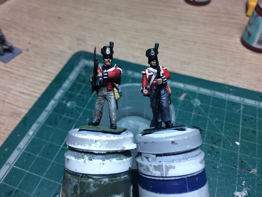

34 minutes ago, Matthew1974 said:
Are you thinning the Vallejo varnish with their airbrush thinner (71.161), maybe with a couple of drops of their flow improver (71.262) added as well? I use Vallejo polyurethane flat varnish (26.651) thinned to about 50:50 (they are thick) with their airbrush thinner and some flow improver and spray at a bout 12 psi. As long as I go in light misted coats, I achieve a dead flat finish. However, if the flat coat is not your final stage (for me it usually is), like all Vallejo products it can be delicate so weathering should be done patiently and not with too heavy or strong of a hand. Also, give it enough time to cure. I have not used the 100% acrylic resin varnishes, but I would have thought the same prep is involved, and they probably dry more resilient than the polyurethane stuff. Have you made sure the varnish is fully mixed? You can use pliers to gently pull the top of to allow for a complete mixing with a stirrer.
Be careful with the Mr. Color flat... It is too flat and too rough in my opinion. I agree Mr. Color sprays beautifully I have heard great things about their GX series clear flat (http://www.mr-hobby.com/en/itemDetail.php?iId=2580) which has a much finer grain.
I brush paint everything as I do not own a sprayer, also I have tried diluting but with boiled tap water after it has gone cold, also I shook the living daylights out of the bottle first before emtying half the bottle into a jar and then mixed in the water to 50/50 mix, then I thoroughly mixed and shook the jar for about ten minutes - I have been doing the stiring and shaking before every coat applied lightly with a brush about 5 times now but each coat is staying a satin finish.
Erk.

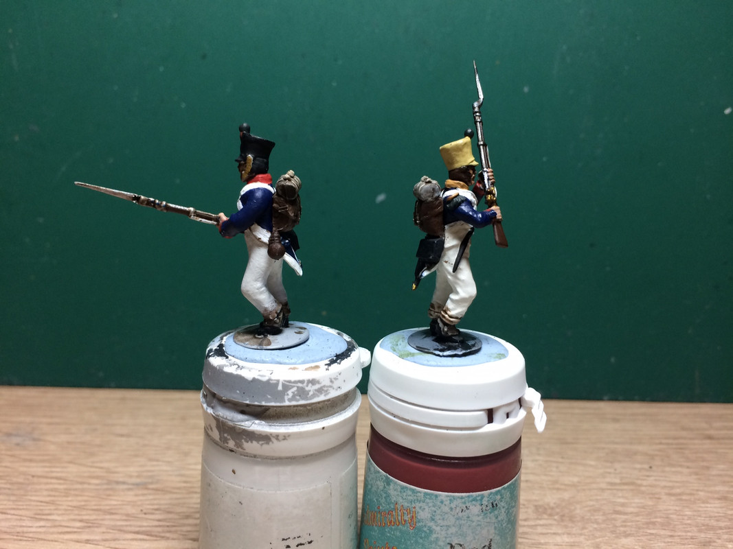

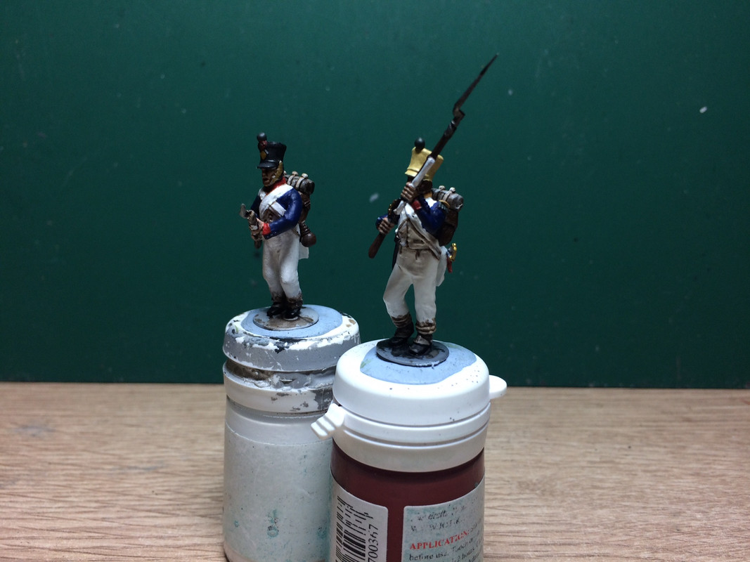

Hi all, more progress - so after talking with the shop where I got my paints from they decided to send me Two new bottles of Vallejo Flat Red and Dark Prussian Blue, but they also sent me a freeby of Vallejo Flat Medium, they told me by adding a bit of this to the paints it will help to dull them and achieve more of a flat finish.
Anyway on with the figures - more work on the 5th KGL.
Erk.

Only trouble I am having now after changing over from Tamiya Acrylics to Vallejo is - the Flat Red does not look very red in the pot - looks more like a salmon pinky colour, also despite giving the paints a thorough stir (till my hand hurt) they are not going very flat and are keeping a sheen to them.
I am applying the paint ontop of Vallejo Black Surface Primer thats had a couple of days to dry, so that should not be an issue.
Erk.
6 minutes ago, Jim Wasley said:
These figures look great,and the red on the right figure looks OK to me.
Jim.
Yeah its strange, in the pot it looks like a dark pinky salmon but after a few coats are on it dries red, shame about the shiny finish - only happens with the red and blue, the white and bauge are nice and flat, I read up on the net its down to the pigments not mixing aswel despite sriring the living daylights out of them.
Erk.
