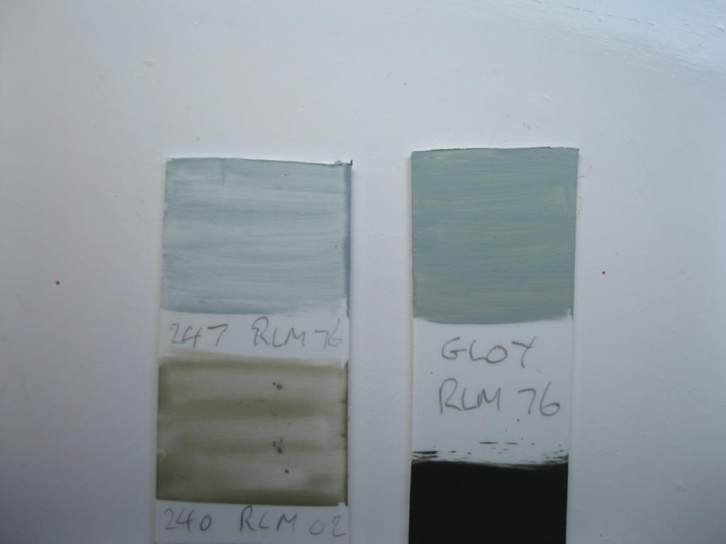

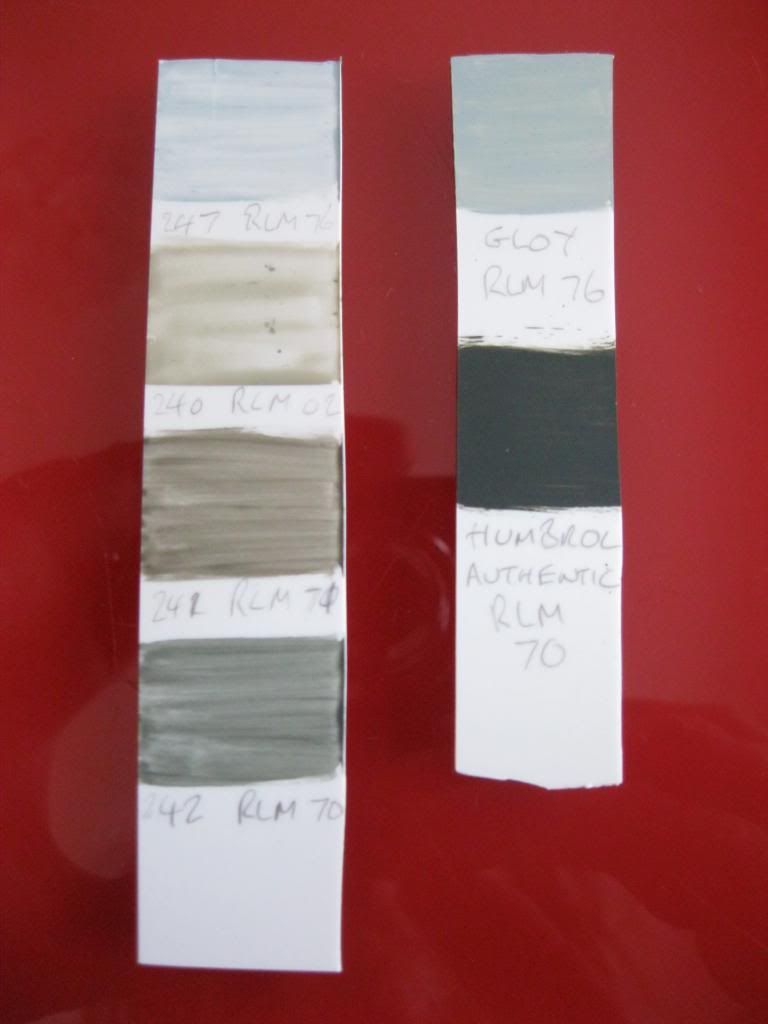

Ok Chaps;
Please excuse the total rubbish quality of my photo's, but hopefully they will illustrate the point. All samples except the Gloy RLM 76 were unthinned and brushed onto plastic card in one coat. The RLM 02 doesn't come out too well and is very translucent. Of note is the quality of the old Humbrol Authentic RLM 70 compared to it's newer equivalent...No contest methinks! The Gloy RLM 76 was pre-thinned some while ago, but it is still one coat. Anyway, let's see if this helps..
Regards;
Steve

Seahawk;
I absolutely agree. I'm just about to post up a couple of comparisons, but I'm just waiting for my camera to charge up. One of the colours I've compared is the old HG 1 Schwartzgrun and the new Humbrol equivalent. The contrast is quite amazing. The old HG 1 covered a piece of white plastic card in one coat and dried to a perfect and even finish. The new version came nowhere close!
Give me ten minutes and I'll post up the results..

I've managed to do some paint tests with the batch of Humbrol Luftwaffe paints I have, and compared them to some of the older paints I have. Results are quite stark! I need to photograph them, and I will post them up tomorrow.

I've fired off an email to Humbrol, so I will let you all know how I get on. I have tested all of the colours I bought now, which was RLM 02, 70, 71, 74, 75 and two tins of 76. The results were all the same with a brush. Good brushing qualities with a good drying time to a matt finish. The problem was with the colour. They all looked like clear varnish with a hint of streaky colour...very translucent. All colours were mixed thoroughly with an electric stirrer. I managed up to five unthinned coats of 76, and I still don't have a uniform colour. Surely a problem?

I have to say that the batch I just bought are pretty dire. Unbelievably transparent in their coverage. It would seriously take a lot of coats to get a uniform colour with the paints I have. Like you, I spent £12 and did a 40 mile round trip to pick them up, so a bit miffed too.
I'm a big Humbrol fan. I've always used their paints, but if this how the new formula is supposed to be, I'll have to look elsewhere. I will contact them though as the batch I have just doesn't seem right at all.

Just thoroughly stirred the RLM 76 and RLM 70 colours. Same issues. After brushing the paint out smoothly the colour was so transparent that it could be barely seen. Is there any pigment at all in these new paints?
