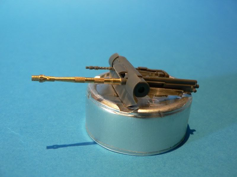

The replacement KwK 30 barrel comes from Lion Mark and is an absolute gem and is well worth the couple of dollars (6 I think) I paid for it on Hobbyeasy. Fitting consisted of simply snipping off the old barrel, drilling a hole and then attaching the replacement part with a drop of CA to fix it in place.
Here's a comparison between the original barrel and the replacement

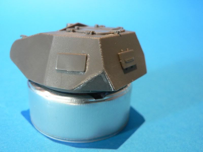

The turret presented no problems at all with only a couple of seams to be filled where the upper and lower halves joined and a missing weld seam added in the same location.

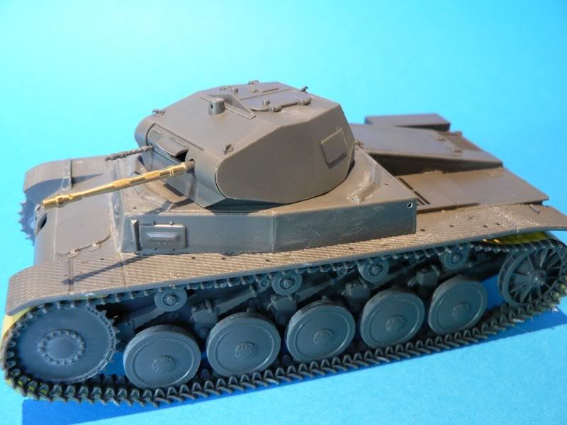

I know there are many methods used to attach link and length tracks but this is the one that works best for me. I start with temporarily attaching the wheels to the vehicle then simply glue a couple of pieces of track together and wait a couple of minutes for the glue to set (a bit). I repeat this procedure a few times till I have a number of track runs drying at which point I place them on the vehicle and tape the runs in place with Tamiya tape and wait for the whole lot to dry. I repeat this for the entire track length but do not glue the last two links together so they are easily removed for painting.
Well tacked together she's actually starting to look like a Pz II now

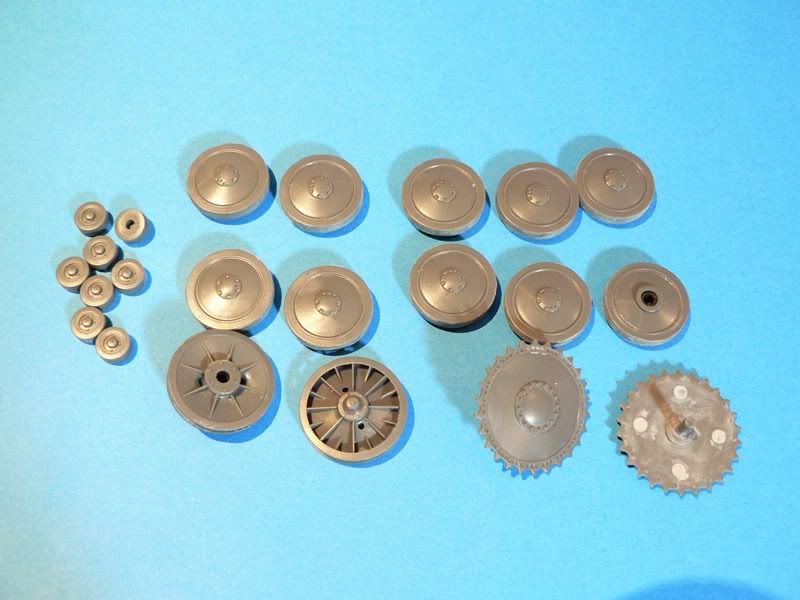

Ok first step in this little kit is the same as for all tanks, the road wheels idlers & drive sprockets along with their polly caps. No real problems to report here other than the four very nice ejector pin marks on each idler. I needed to remove these as the idler protrudes from the front of the vehicle and the ejector pin marks would be highly visible. Now normally this would be a piece of cake to fill and sand but as there is a row of very fine bolt heads that I didn't want to obliterate I had to be very careful.

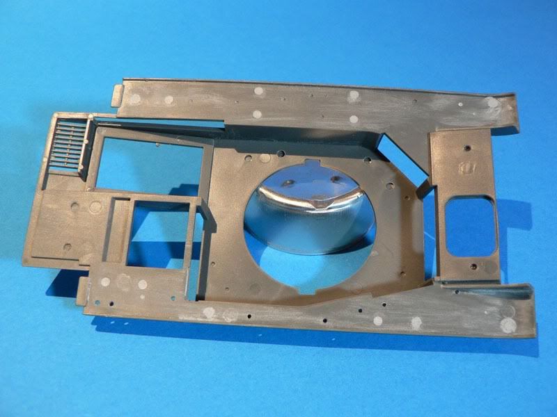

From here I was going to move straight on to the upper hull but after having a bit of a play I discovered that the ejector pin marks under the fenders are very easily seen so out came the trusty Gunze putty mixed with a bit of lacquer thinner into a slurry that is worked easily with a toothpick into small holes like this. I find this much easier to control (and clean up) than putty straight out of the tube which for me tends to go everywhere.
