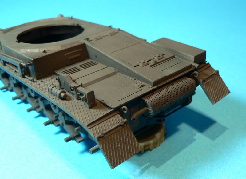

Well it's been a little while since I've done an update on this build so I thought I had better post something to show work is continuing on albeit at a slower pace than when I was on holidays.
Construction is now complete with the exception of the jack block and some wooden handled tools which I will add last.
The kit received a coat of Tamiya fine white surface primer particularly the metal muffler guard and the Kwk 30. As the white primer is lacquer based it gives subsequent coats of acrylic paint something to bite into.
The white primer was followed by a couple of thin coats of Tamiya NATO black which I use to create shadows in any places the main camo colors might not reach properly. The turret is mounted on an old bog role covered in plumbers tape by the way so the I can handle it and paint it without having to touch anything.
The only thing I've added to the hull is an antenna made from thin brass wire which sits in the antenna tray, you can sort of see in on the left side of the shot below
Sorry about the crap light with this last one but now it's off to the paint shop proper and correct the paint scheme that Tamiya recommends.
Cheers
