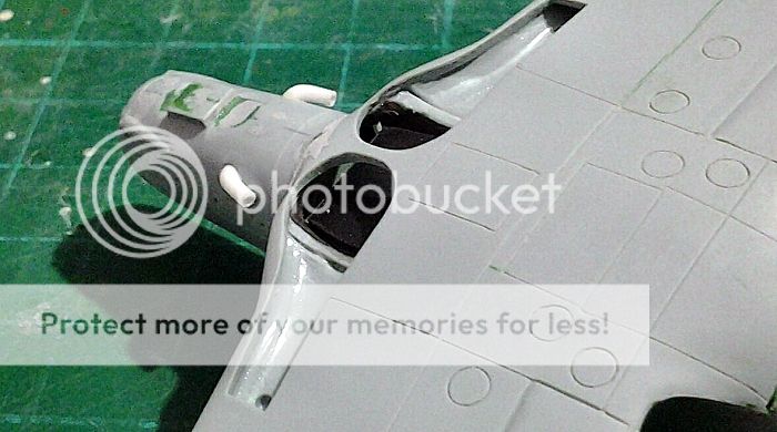

That's weird, it is true that they are a tight fit but I popped mine on and off a few times with no problems. Comparing the intakes and the fuselage halves, are there any noticeable differences? I'm just wondering if anything is slightly malformed.

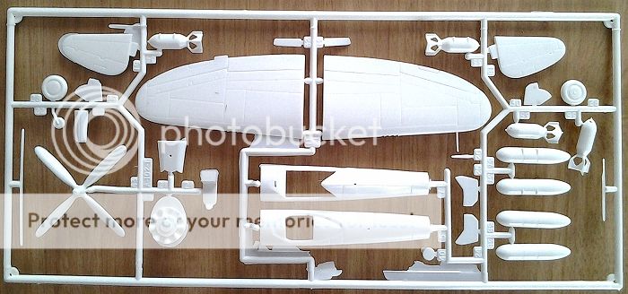

This poor kit has waited 30+ years for this, and It was really strange feeling cutting into the cellophane and opening the box for the first time
It's like being the Indiana Jones of plastic kits! I knew from some builds I'd found online that it had recessed panel lines, I was expecting troughs but surprisingly they are slightly finer than those found on the majority of Matchbox kits. After giving it a thorough inspection there are no sink marks and the only fault I've found is a small, very thin section of plastic from a short shot on the wing.

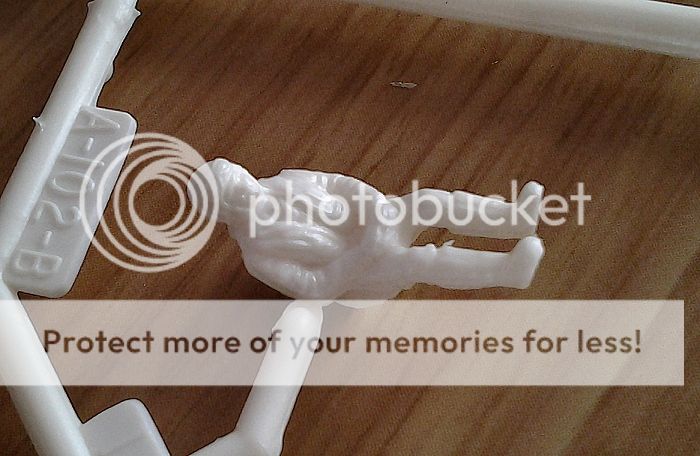

Two things I wasn't expecting, the canopies are two piece and the pilot isn't a blob!

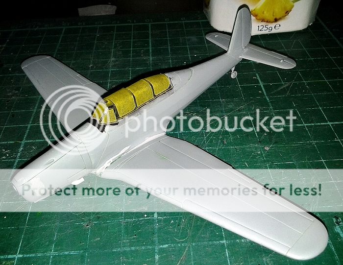

Unfortunately I've had to delay the priming of this one due to unforeseen stupidity... I forgot to attach the machine gun!!
All done now.
I've finished all the sanding tonight and I went over the scribing one last time. I made some new exhausts to replace the kit "stumps" and I've masked the canopy ready for some primer tomorrow. All other parts are cleaned up and ready so not a great deal left to do apart from paint and decals.
Had a busy evening with this one. Fuselage, tailplane, top of the nose and the cowl are all done and dusted. The wings are on and the wing roots have had some thin strip, some putty and a sanding session so far. I'll be going over them with some Mr. Surfacer tomorrow.

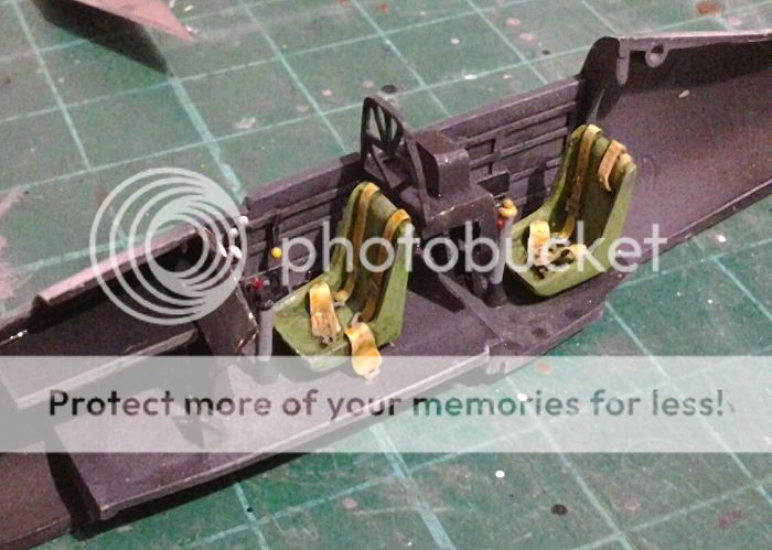

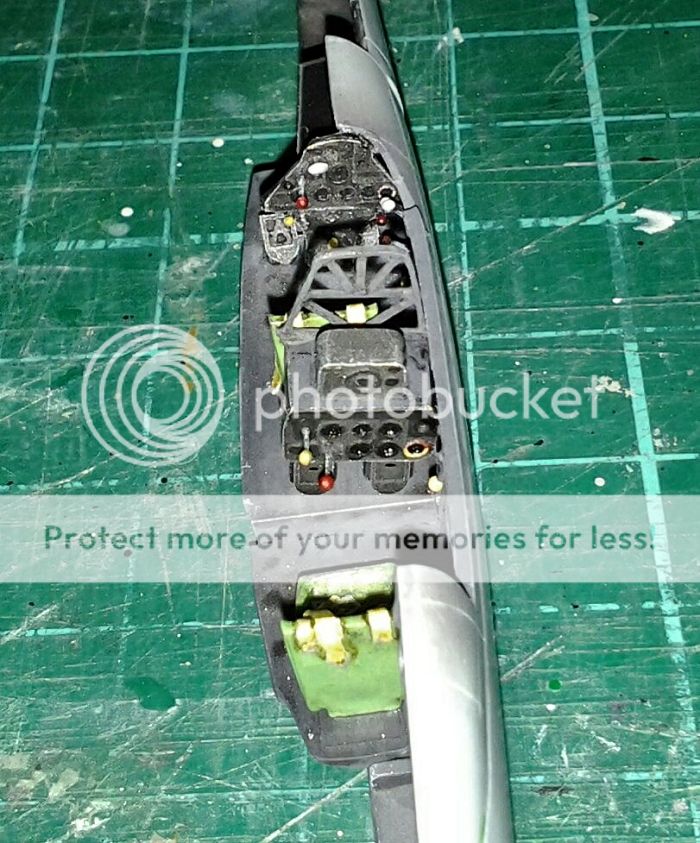

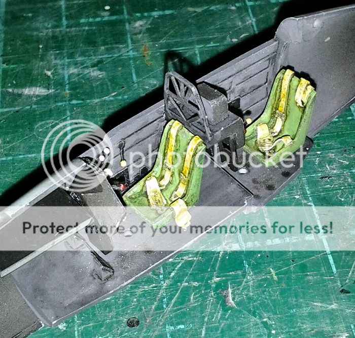

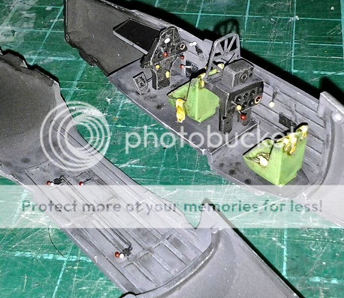

After bulking out the knobs with a little blob of Kristal Klear I got down to painting the cockpit. I sprayed the floor, sidewalls and rollover frame grey then feathered some black in at the nose and tail to give the illusion of depth when assembled. The panels were sprayed black and the seats got some green. A few reference photos I've found online had green seats and I think it gives a nice contrast to all that grey in there, plus the belts look good with it. The knobs got a dab of either red, white or yellow and then I went blind painting two bezels half red, half yellow! (Enzo, as usual it was all done with my favourite brush
)A dry brushing of grey followed by steel highlighted thing nicely then I filled the instruments with Humbrol Clear to simulate glass. The cockpit got an all over thin black wash but I went to town on the seats. After painting the belts and buckles I gave the seats a Sap Green oil wash to add some depth to the colour without dulling it followed by a Ochre Yellow wash for the belts. The final stage was a black wash applied only around the buckles and shadow areas of the belts. The floor looks a bit wonky in the photos because it's not glued in yet
I've really enjoyed working with this PE, it was easier than I thought it was going to be and has taught me some new skills. Although it would have been good to remember to breathe occasionally when gluing and painting it! I'll get some more photos tomorrow in daylight, the flash on my tablet makes everything look harsh on screen.

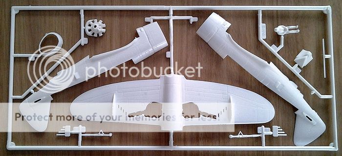

I won these on eBay tonight from two different sellers within ten minutes of each other so the timing is perfect because I can do a Cuban F-47
The FAEC flew the F-47D-35-RA so I will have to make the dorsal* fin because the kit is an early bubble top without one, but apart from that it'll be OOB. I'm also going to build it wheels up, something I've not done for a long time so it should be a fun project.***UPDATE*** Now they've been delivered I've updated the photos.

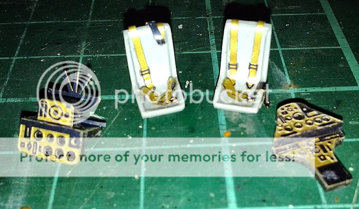

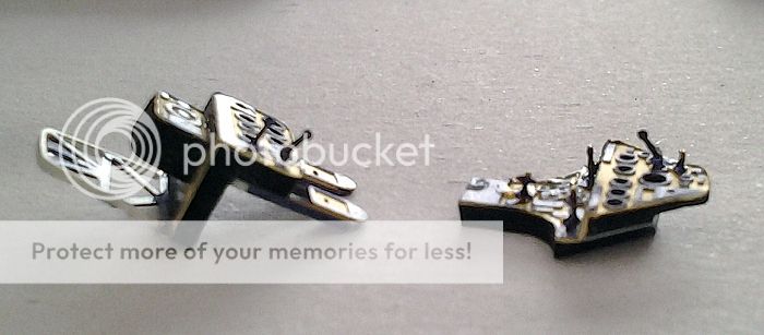

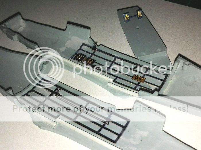

Got a fair bit of the PE done tonight. The sidewalls and seats are finished and I've backed the instrument panels with plasticard. I've added the little panel on top of the rear panel and fitted the front rudder pedals as well. It wasn't as bad as I thought it would be but it would have helped if the instructions had proper side views of where things go on the side walls. Still got a lot to do to refine the fit of the panels and quite a few levers and knobs to add but I'm getting there.

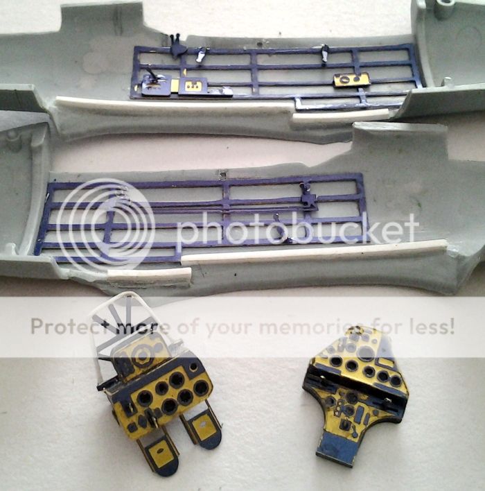

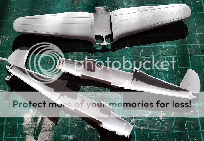

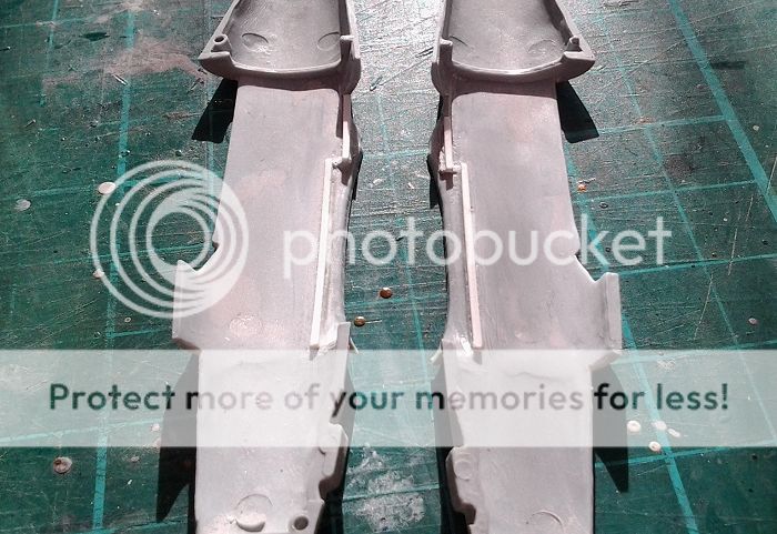

Everything is now scribed and I've assembled the wings. I added some strip to the kit "rails" that position the floor to make it easier to test fit, which I'm going to be doing a lot of...
I've also removed the instrument panel pegs and filled the injection marks, a bit of green putty followed by a little Mr. Surfacer + some sanding and I've got a nice blank canvas to work with.

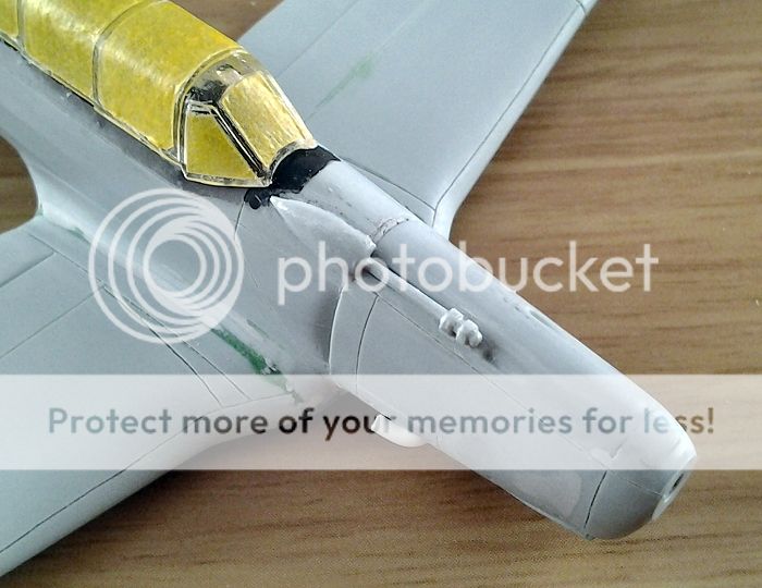

I spent most of yesterday working on another project but I painted a few details and got the intake decals on. The intake decals are the only disappointing part of the kit, they're cut straight so curve the wrong way when on and are also too short. Come on Airfix, It can't be that hard to work out the correct shape and length! (Here's a hint, longer and curved forward.)
Today I took the canopy back off today so I could apply the black anti-glare decal. I had to cut a section out because of the probe being in the way but I touched it up with a little paint. I also spent some time painting more detail part and added a tail navigation light. I'll spend some time making the windscreen wiper tonight and might glue the canopy back on properly.

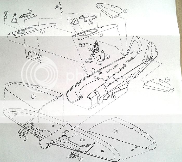

Made a bit of a start on this one already. I've scribed the upper wings and starboard fuselage, cleaned up the cockpit floor and seats and I've prepared a few bits of the PE set. Hopefully I'll finish scribing the rest of the kit tomorrow and figure out the fit of the PE in the fuselage, the instructions are a bit vague
