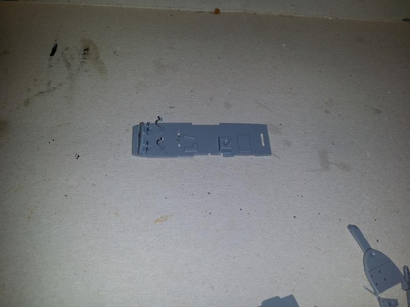

    This build is kicking my backside at every turn.  Martin did you find that even though the walkway decals said 72 they were in fact 1/48 and didn't fit do I ended up using the airfix walkways I tried trimming the blocks by the tramission tunnel but it still doesn't look right.

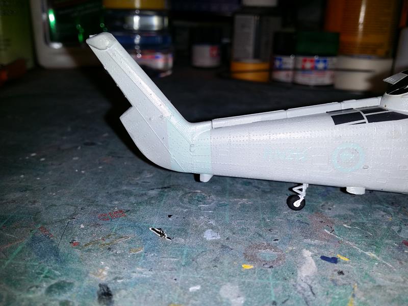

    There is a roundel and RNZN markings and the fuselage band in this picture.  HONEST
    Rodders
    EDIT just looked at the decals and the do look darker on the paper. also shown the 1/48 walkways

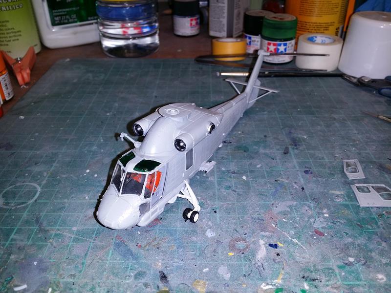

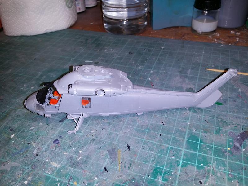

  4. I have had a go and I managed to get the blinking glass back in after cleaning it up
    Paint on have to touch up the engine intakes and a few other places and then ready for decaling.
    Kit states the underside of the rotors are black and the tops grey does the panel think that the grey would be somewhere around DK sea grey or medium sea grey?
    Anyway Pictures
    Not sure if I shall have the doors open or shut The belts are decals
    After the touching up then on to decals
    Rodders
    • Like 3

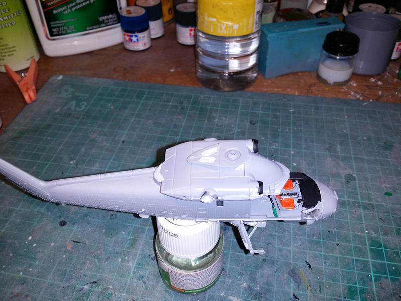

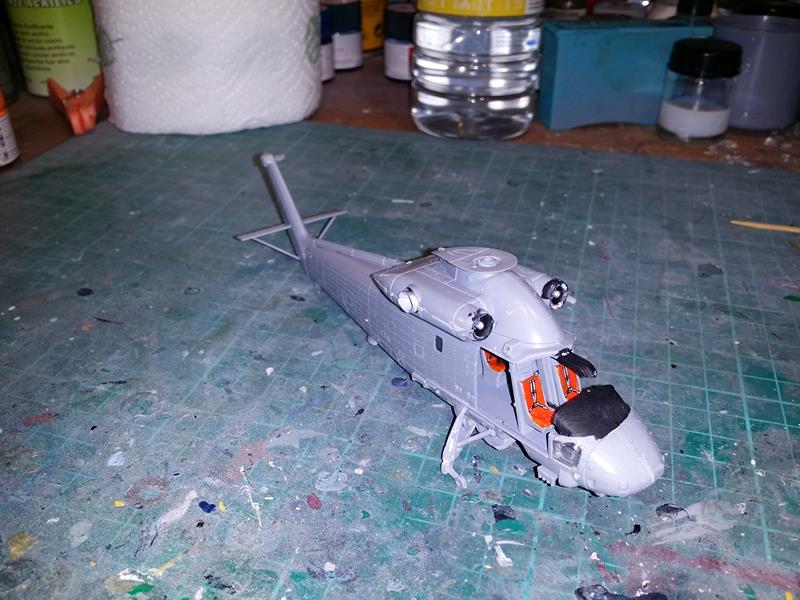

  6. A little more progress

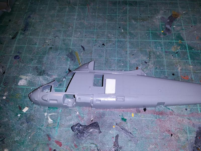

    The kit has some horrendous sink marks which I filled with Mr Surfacer 500  You can see some on the top by the rotor housing and on the wheel struts in this photo
    The fulsalage was held in the air to allow plenty of time for the wheel axels to set as they do not appear to be the strongest joint going
    Tail stabilisers added and getting ready for the masking
    All joints and sinkmarks are filled and the join as best I could do in the insides of the exhausts  The pictures I have see of the prototype aircraft seem to have the launchers under the cockpit but are not clear so I have added them.
    All done and ready for masking the wheel bays and various bits more when I have done it
    Rodders

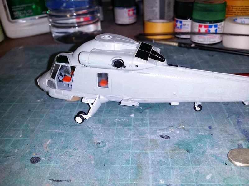

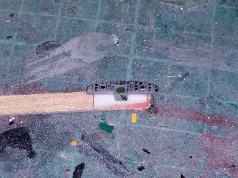

  7. I have not progressed much further other than coating the clear parts with floor polish ready for placing in the model.  I don't know how many of you use superglue for  fixing clear parts I admit when I was told it could be done I was skeptical but if you cover the clear bits with Kleer it does work and you don't get the problem with the glass falling in when you try to mask it.
    Thank you all for the stories and helpful hints along with where I can spend money (got to get the G conversion)  I hope to have it buttoned up by the end of the weekend.
    Rodders

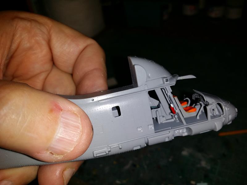

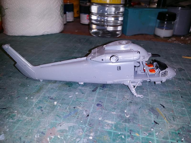

    I didnt see this one but it has the info that I need  A few updates
    Instrument panel painted ready for putting in the fuselage side
    As you can see I use coffee sticks and the little self advisive pads to hold the IP to make it easier to paint
    Here it is in the side of the a/c (yes I bite my nails)
    Uisng the link Stevehnz supplied I see that it didnt have the tube launchers on the side so they had to come out
    First put in some plasticard to fill the gurt hole
    Then using MR surfacer500 fill in the gaps and prime

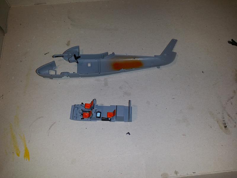

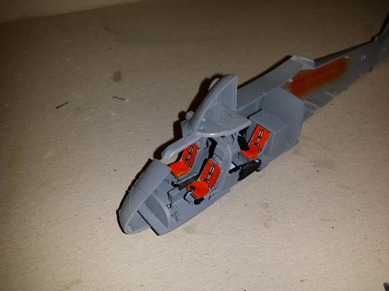

  11. Cabin coming together I have decided that hopefully by the time I have primer and a couple of coats of paint and a varnish they may not be too prominent.
    I know that decals for seatblts are not everyones cup of tea but they are fine for my style of modelling.
    The top VDU is in place the orange is an airbrush test on the primed cabin wall to see how it would turn out it will be hidden when its closed up..
    I assume that the area under the VDU would be some sort of desk and that is why I have placed a decal to represent the writing area.
    Rodders

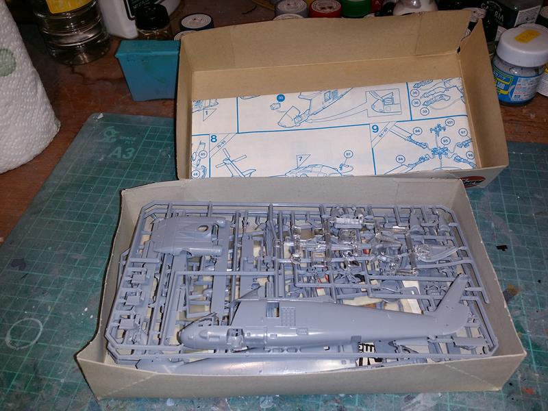

    As you can see the box features the kit made up and the inside is cramed full of sprues.
    Lots of pieces

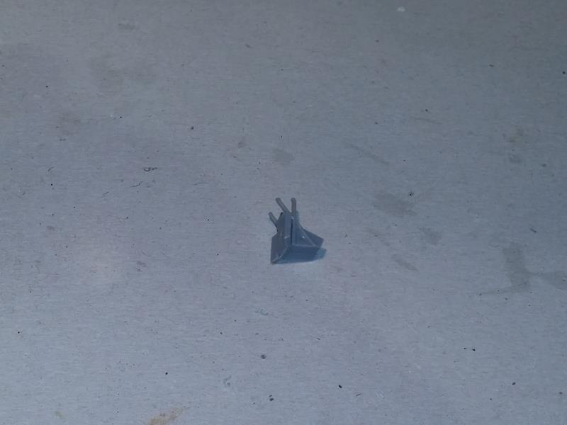

    Unfortunately the model as lots of sink marks as well as injector pin marks but then again that is what Mr Surfacer is made for.  I wonder how I got along without this marvellous product before.  This is the radar screen that hangs down from the roof and as you can see there is an awful sink mark but it will be filled and you wont know the difference.
    So onto the building I don't normally take long to build a model and I cant see this being any different
