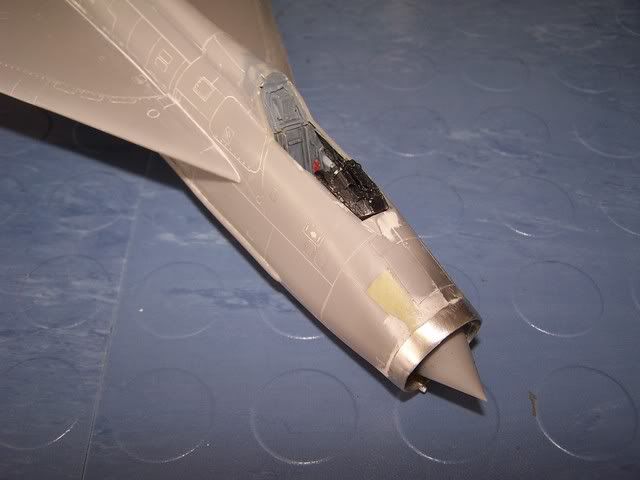

Rather than use the kit part, I used Milliput to blank off the blank canon panel
Left side of model - now looking like a Lightning
Detail added to undercarriage bays. I used P.E (Airwaves?) salvaged from an old build. Added detail from fuse wire, plastic card etc.,
Another view of the shiny nose ring

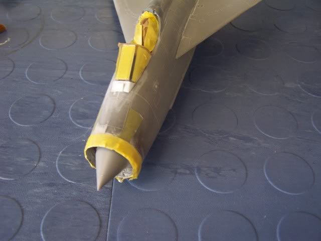

Canopy has been added and masked off. I've added some plastic card framing + de-misting ducts
Ready for Halfords Grey Primer- and then a nice coat of Gloss black!!!

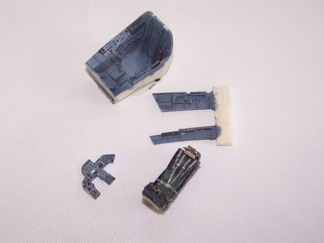

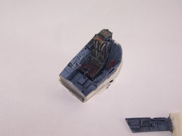

Just a small update. The cockpit done and the HUD seeing as the kit doesnt have one.

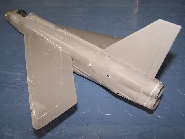

Well...she's taking shape......
Intake trunking added, along with the cockpit tub. Dremel came to the rescue here as I had to remove acres of resin and plastic to get the tub to fit snugly on the trunking...
fuselage halves nailed, and fin added...
I'm using Aeroclub's white metal nose ring - added weight and I hope to polish it up - nice and shiny!!
It is considerably larger than the kits plasticitem, so I've begun to remove excess metal....dremel again. There are a few pot marks in the metal - I may have to solder these holes... I've also added some lead sheet aft of the cockpit - don't want a tail sitter!!
