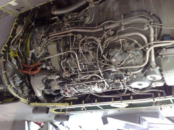

atdb27
Hi Keef,
I'm also looking forward to seeing those open panel areas filled with detail. What an undertaking!
Just one thing so far you need to take another 17mm from the front of where you have cut so far for the engine access door!!!
The kit panel line is understandably confusing but rest assured that is not realy a true engine access panel line. I fill mine in.
If you don't have any good pics to show you what I mean then PM me and I will forward some pics for you.
On part 43 build stage 8 you need to have 5mm from each side removed from it and add this to the fuselage half lower edge.
Also what line have you used along the lower edge of the door? It was NOT straight.
As both engine doors would be removed for servicing both a/brake actuating arms would be disconnected from the airbrake its self AND retracted .
Therefore both a/b's would be open further (if still fitted) than that of a normal operational situation.
Finally you will need to open up 3 panels along the top as these allowed for the engine removal hardware to be attached to the a/f.
Adrian ex 14 Sqdn Sootie
