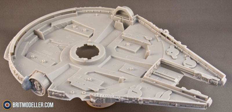

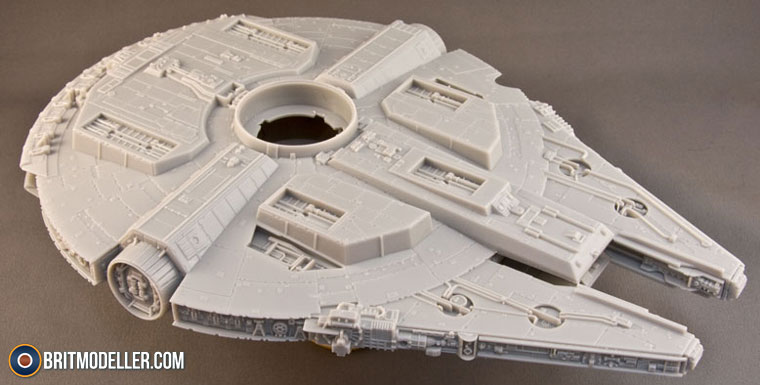

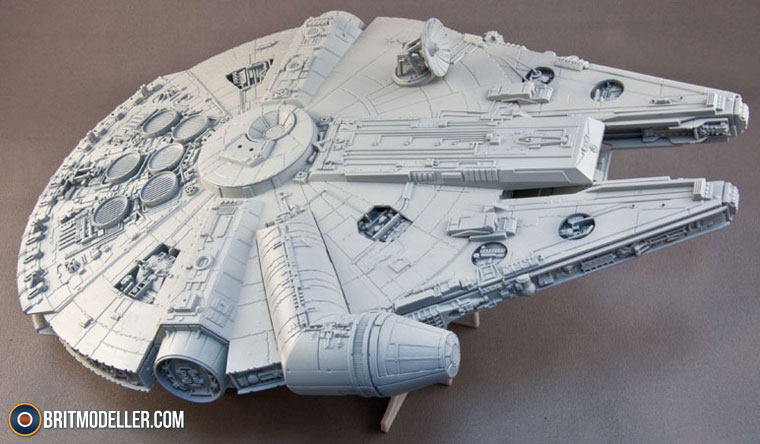

Well... first item for work was to clean up the central sprues that sit in the middle of the two hull parts. Easy to do, and so I moved on to snippiing off a couple of the round equipment bay inserts on the cargo jaws up front. Because of the way they're sprued up, all you have to do is nip them close to the attachment lugs and clip them in. They really are THAT good a fit. A little dribble of liquid glue, and some pressure for a short while, and we're done. The same process was used for all of the many inserts, the detail of which is excellent! No shadow of a doubt, the detail is the crispest (as previously mentioned in the review), and extra spruelets have been added around the edges to ensure that the detail gets a full fill of styrene during the moulding process. Well worth the effort of nipping them off.
I had a few misgivings about simply gluing the side walls into the bottom of the hull, as I felt that if I didn't get them perfectly square, it could cause fit issues with the upper hull when it came time to close it up. As a precaution, I installed a few parts, and did a test fit - no problems encountered at all, as the mounting lugs are precise, so I ploughed on. Here you should take the time to remove any mould seams on the edges of the parts, as although you can't see some of them, others are on view.
The instructions show you attaching the big round endy things (yes, those again) being attached later in the build when the hull is joined. I didn't want to have any hull parts lying around to be painted off the hull, so I joined them to the bottom half, again, checking alignment by test fitting the top hull as I went along. Everything fits beautifully, and I will be able to keep the two hull parts separate until after painting, so I can paint the cargo jaws insides easily with my airbrush. The cockpit amd crew tube would also be able to be click-fitted later if you so choose, but I suspect I'll be attaching mine once I have the cockpit painted, which fits INSIDE the tube parts, so can't be left off until later.

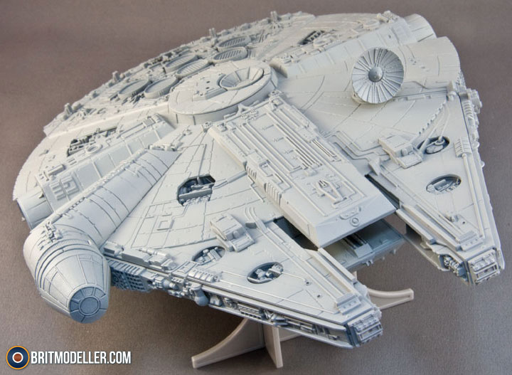

So how does it look so far? Good... the build has been a breeze, and I think has taken me about 30 minutes so far. The quality of the moulding really shows in the speed and ease of construction smile.gif
That chunk of blutak was just there to hold a joint closed while the glue set.

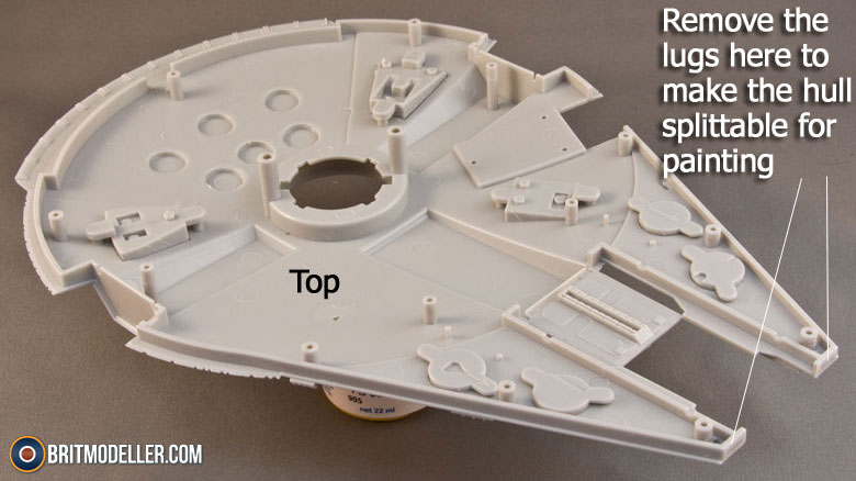

The front panel of the jaws locks the two halves of the hull together, so would have stopped me from splitting it for painting, so I lopped off the lugs from the top of the hull to solve that issue. I clipped the hull halves together while the glue set though, just to make sure they ended up in the right place.
I've also built up the antenna and am working on the cockpit area now. Just need some refs... Jeff? smile.gif

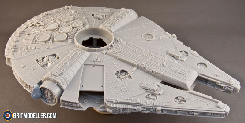

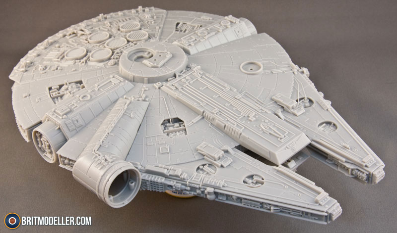

Some odds & sods of additional work done - not pictured is the completed antenna, 7 landing gear legs, some adaptations to the cockpit to make it slide fit into the tunnel, and a little bit of general tidying up of the remaining small parts.
On the subject of painting, which will probably begin soon, did you know that the used the Federal Standard a long time ago in a galaxy far far away? Me neither hmmm.gif

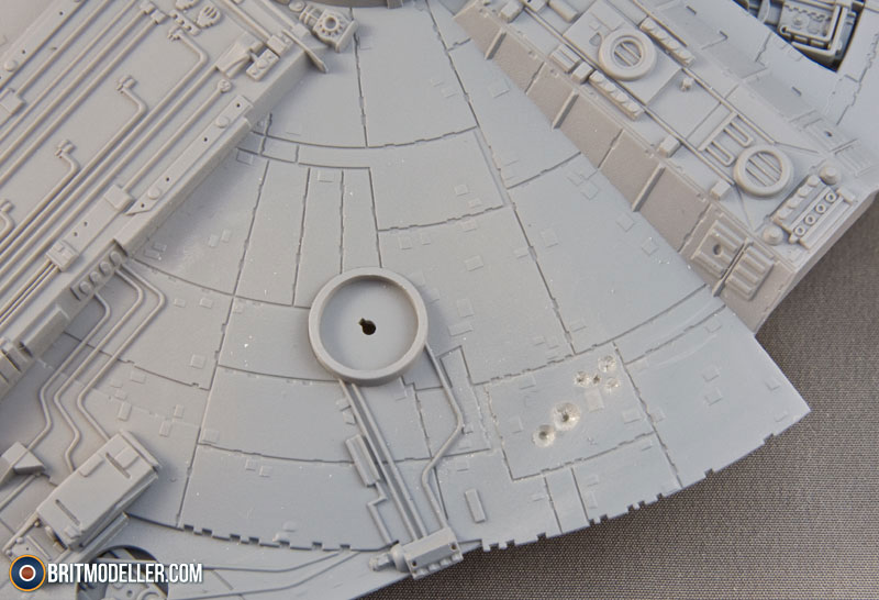

Funny... I've just had a look through all the pics, and there's only one bit of battle damage that required me to dig into the plastic, and that's just outboard of the forward looking antenna on the port topside. I Dremelled the basic shape, then used a curved blade to roughen them up, and dropped a little liquid glue to melt the rough bits a bit. While the glue was still wet, I pressed the tip of my blade into the sloped edges in a spoke pattern, to give it a bit of texture smile.gif
Madmonk
Mike,
Damage looks good and ties in with shot in Sculpting a Galaxy book.

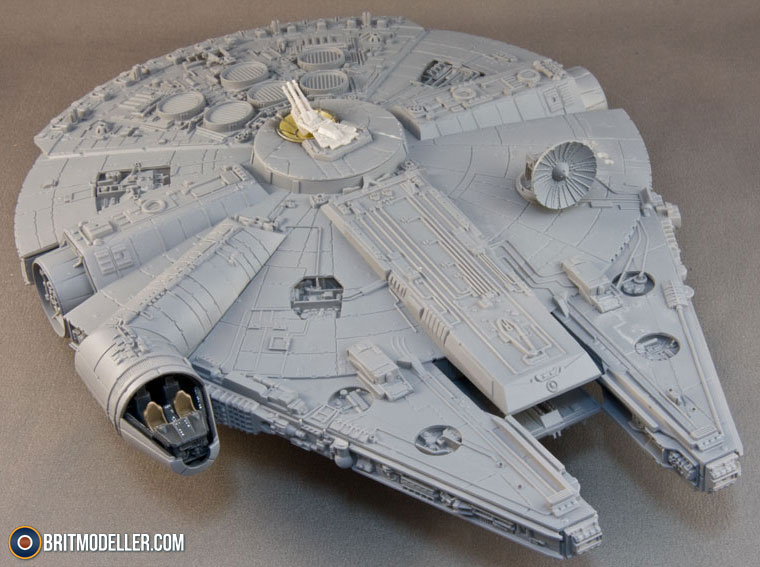

I bit the bullet and painted the cockpit today - a base coat of Lifecolor Panzer Grey highlighted with Barley Grey, the front seats hand painted and highlighted with Polish Officer's uniform color, and some white dots here & there to simulate lighting. The white strip across the back of the cockpit is a small strip of white decal from a left over Tamiya sheet.
It looks a lot better at 100% magnification with a pair of eyes, and everything is toned down when placed under the cockpit glazing.
I also gave the two cannon bays the same treatment, giving each one a bit of extra depth with some black wash in the recesses (not pictured).
Well, there are a couple of scars you could add on the underside, if you wanted too. smile.gif
Mike
Thanks Paul - I've added a scraggy looking strip of damage like the big one of the two on the rear underside - a lot of the other less serious damage is paint effects, so I'll probably do the rest that way. I've put her on her legs, glued on the cannon bay glazing and masked it with Tamiya tape - I didn't bother with the masks, as by the time I'd cut them out, I may as well have cut tape in position. Didn't take too long, and it was easier to cut the circular central windows in situ than cut out the circular masks shrug.gif

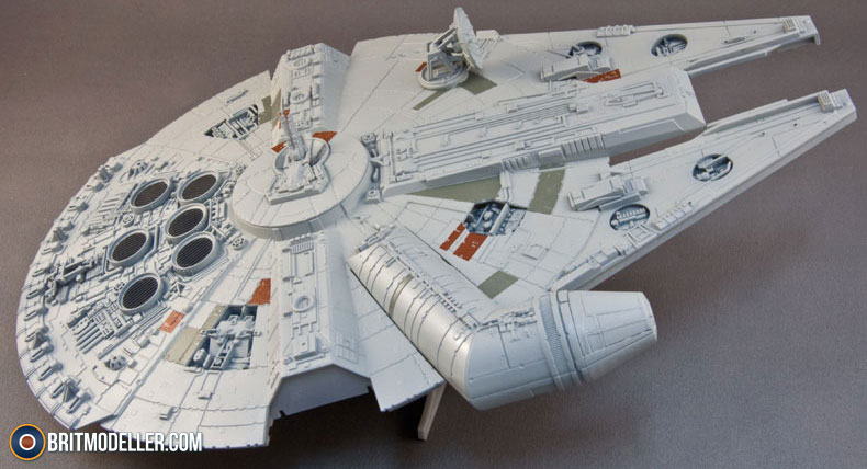

I got round to putting the first layer of paint on the Falcon today, after using up a bit of Panzer Grey to apply some shadows to the recessed equipment bays. I used Xtracrylix XA1137 - Light Gull Grey, as it appears to be an almost perfect match to the elusive (in the UK at least) Polly S Grime that the original models were painted with. it also has the benefit of being acrylic, which suits my mode of operation, and in stock, which suits my wallet happy.gif
It's just a lazy, drifted on coat at the moment, and I'll review, adjust and tidy it up tomorrow when I've had a chance to look at it in daylight. I think a quick thanks should go both to Smiffy for the tip on the correct color, and to Daz for pointing out a useful alternative smile.gif
