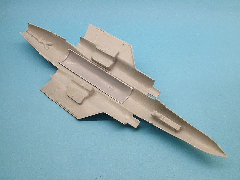

Step 1 - Know the enemy! Here are the fuselage halves for the Bucc and they flex like mad and the fit is all over the place. At this point you can (1) sit on your duff and clog up message boards with saying how the kit is unbuildable (2) form a lynch mob and go march on castle Airfix or (3) try this.
Biggest problem with the kit is the shape - the Buccaneer is an awkward Johnny to mould due to the complex curves and fuselage break down. With the thinness of the plastic there's a lot of air inside that fuselage and combined with some batches of mouldings that were run off the moulds before the plastic had cooled, the fit is alarming on a dry run. However, its not as bad at first glance.

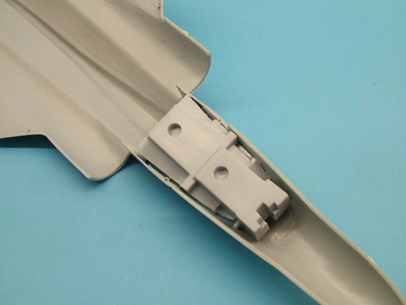

Step 2 - We need to firm up that fuselage so in goes the bomb-bay of choice which stiffens up the underside no end. Airfix thoughtfully provide an arrow for the hard of thinking!
Step 3 - Same goes for the cockpit, be it the kit one or aftermarket.

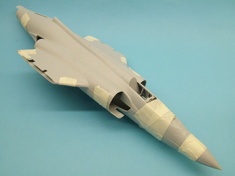

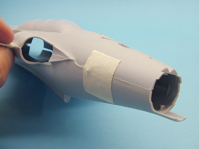

Step 6 - Fix the trailing edge together and bind with tape, adjusting the fit as you go. I always use EMA Plastiweld, its a fast setting solvent.
Step 7 - Repeat on other side then start to work your way aft, fixing the rear fuselage sections together and binding with tape. If you wish, you could run superglue inside with a squirt of accelerator to really firm things up. Repeat both sides. You should now have a Bucc with a firm back end.

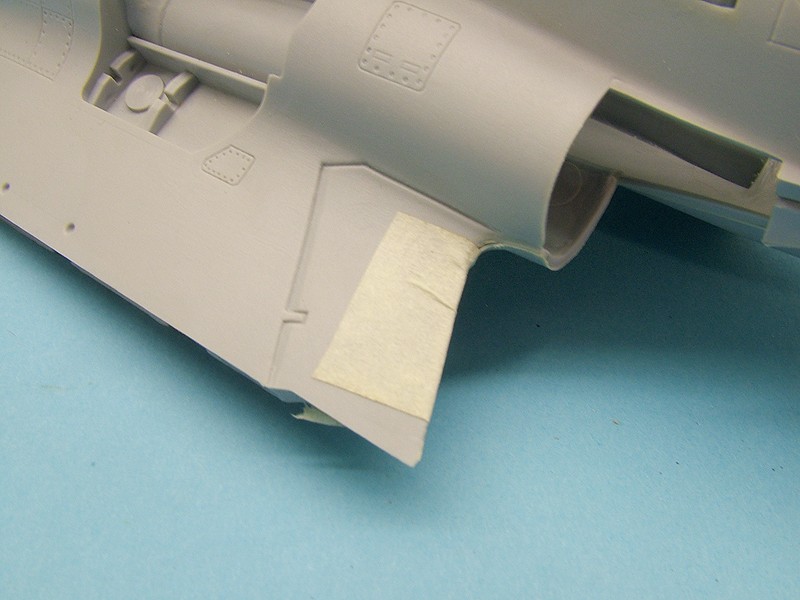

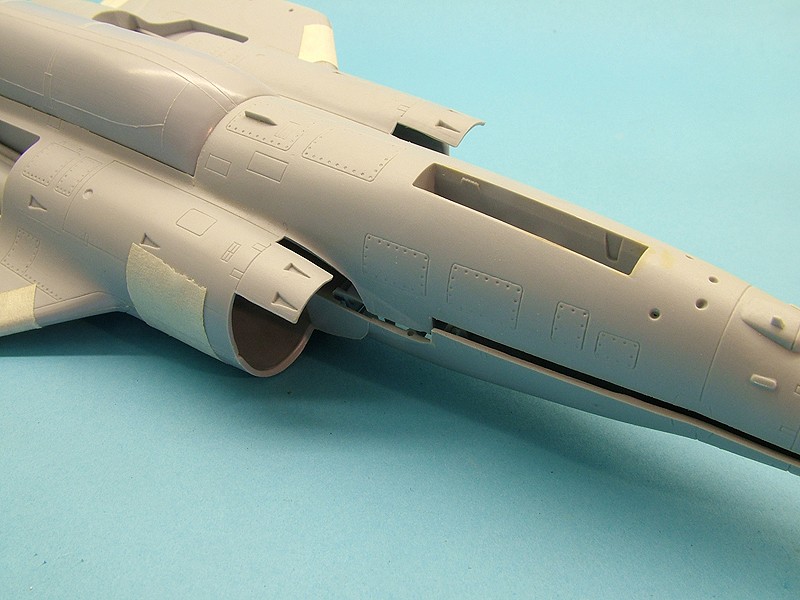

Step 8 - Work your way into the leading edges of the wings, gluing and binding before moving onto the intake areas. Here the mating surfaces are a little thin so reinforcing with superglue is not a bad idea. Repeat both sides. Don't worry if there are still gaps on the front end because...
Step 9 - All you have to do is run some glue into join and hold it together few a few moments before binding with tape. Again work your way forward right up to the nose, repeating both sides.

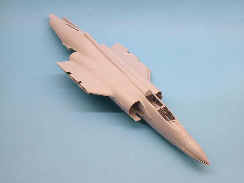

Step 10 - Ta da! You should now have a perfectly straight, firm fuselage with no flexing. One of the plus points about the soft-ish plastic used in the kit is that it makes cleanup a little easier, which will be dealt with in the next update.

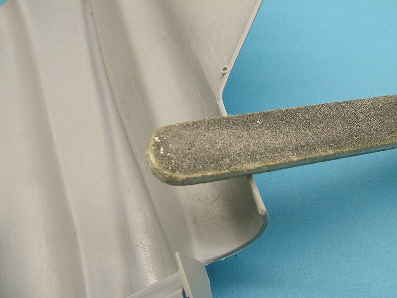

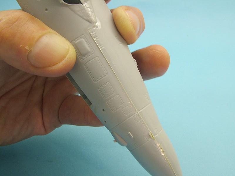

Tape removed, time to clean up those seams. Best tool for the job is one of these, a foam-back sanding block. They smooth down plastic in no time and also conform to curves so you get no flat spots.
Five minutes work and the front end is cleaned up with no filler needed. You can also take this opportunity to sharpen up the "beak" a little.
The back end also cleans up in no time but there is a "lip" of plastic just aft of the exhausts which needs paring down with a knife blade.
This is easily fixed with a smidgen of filler. Likewise the slight step in the aft fairing can just be given a coat of filler and then smoothed over - minimal sanding needed when dry. The more observant student will have noticed that's the first time we've broken the filler out on this kit.

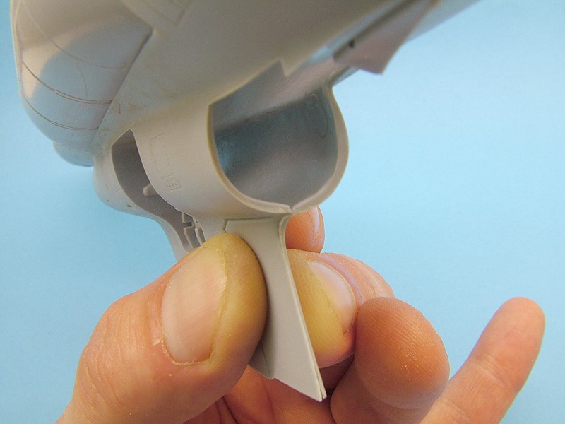

The intakes need care in aligning, for some reason the port-side ones are always a little tricker to fit than the starboard-side ones. If might be best to slightly bend down the lower panel that juts out from the fuselage and align the bottom of the intakes there before fixing into place. That way the top of the intake should line up with the rest of the fuselage. This is probably about the worst it gets and will need a little filler.
