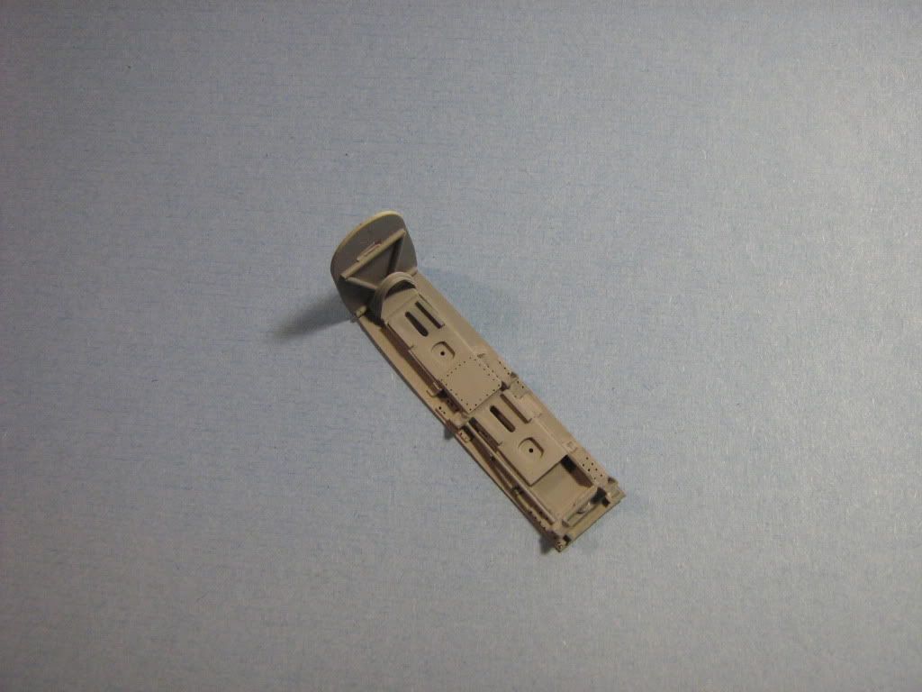

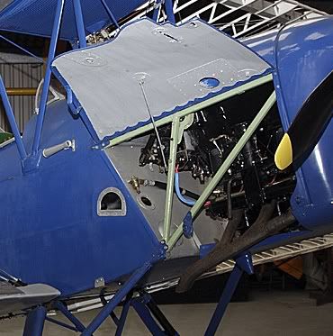

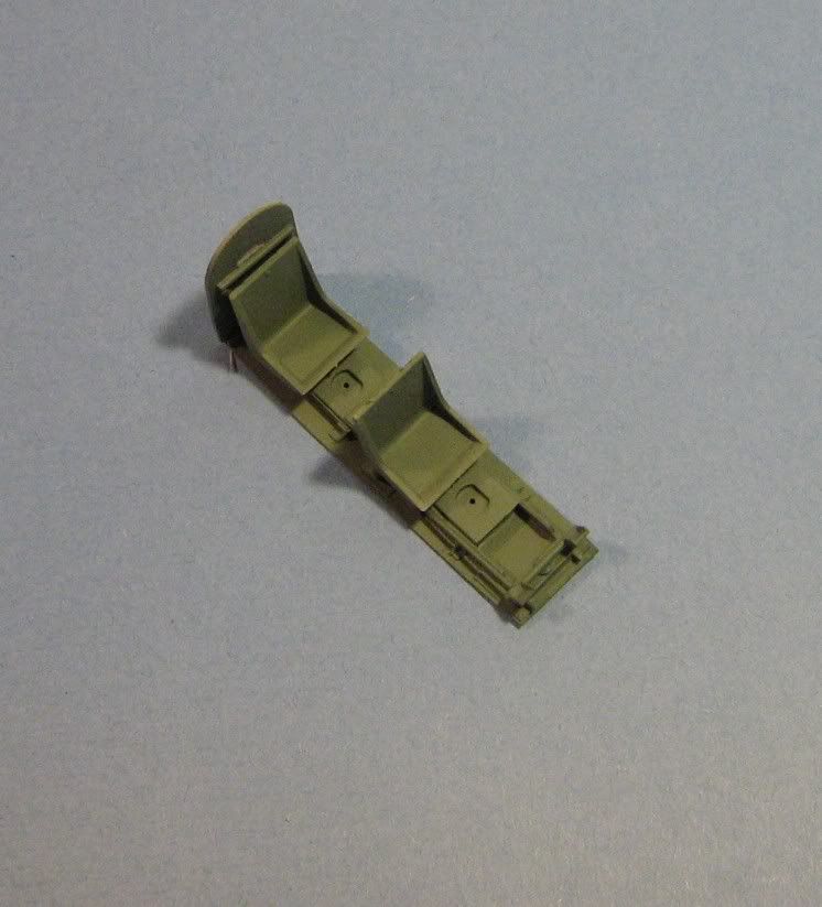

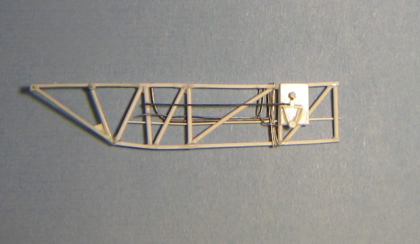

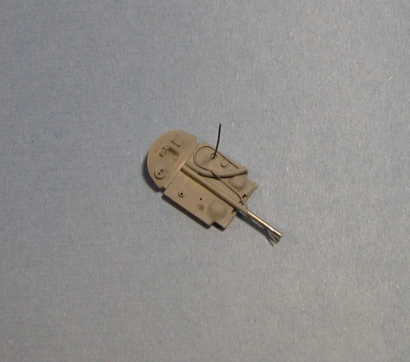

hacker Posted April 2, 2011 Author Share Posted April 2, 2011 Could you please take photos of various sprues. I would not mind trying to build this plane.Is there any aftermarket goodies for it ? OLiver As far as I know there is no after market parts for this so scratchbuild is the way to go on this. Sooo with out further delay lets get to work First order of business is to remove the molded in detail of the kit as it will be replaced with a new tubular framing Next l started the frame work. This is what l got so far but as l go along with this build l will modify or add stuff like throttle controls. This is the new cockpit floor. I used the kit center piece as it is basically correct but l detailed it and added the missing rudder peddles. Dry fitting the seats on to see how it looks. l am undecided on the front office as pictures and drawings l have show a different seat arrangement. I will have to look at my options here While l as at it l removed the details from the front of the fire wall and detailed the back of it like it should look Well that is all for now later 1 Link to comment Share on other sites More sharing options...

worm Posted April 4, 2011 Share Posted April 4, 2011 (edited) Great work but did you know that the Revell kit front seat is wrong, its more of a bucket type which fixed the the side frames as you can just see in the photos below. All the best Steve Edited April 4, 2011 by worm 1 Link to comment Share on other sites More sharing options...

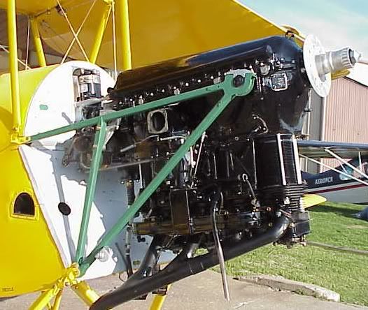

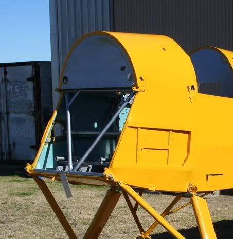

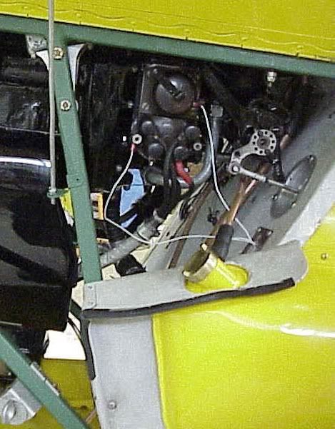

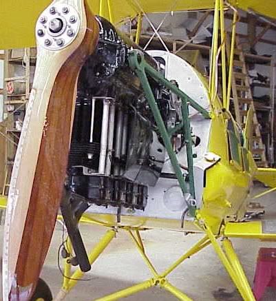

hacker Posted April 5, 2011 Author Share Posted April 5, 2011 Great work but did you know that the Revell kit front seat is wrong, its more of a bucket type which fixed the the side frames as you can just see in the photos below.All the best Steve nice shots very useful to me but what l need is some fire wall shots without the engine if that is possible? Link to comment Share on other sites More sharing options...

Dave Gibson Posted April 7, 2011 Share Posted April 7, 2011 nice shots very useful to me but what l need is some fire wall shots without the engine if that is possible? I told you before, contact Barney. He is a plethora of information on Tiger Moths. Dave. Link to comment Share on other sites More sharing options...

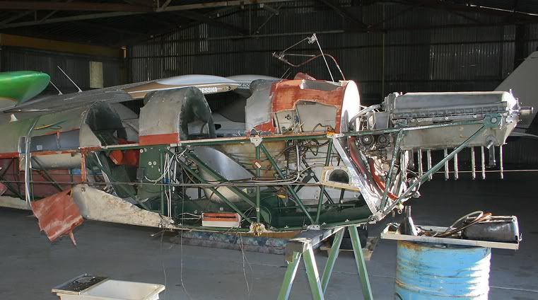

worm Posted April 7, 2011 Share Posted April 7, 2011 Found these pictures, hope they are of some help. All the best Steve 1 Link to comment Share on other sites More sharing options...

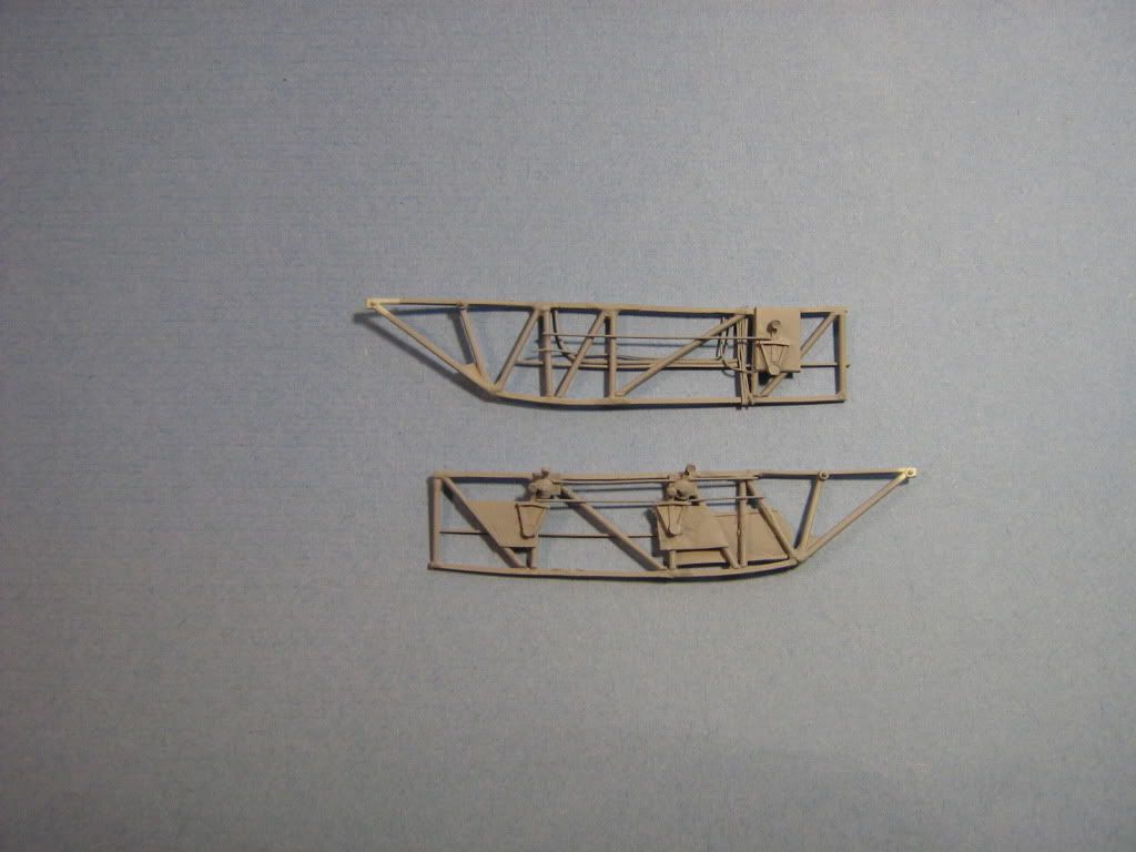

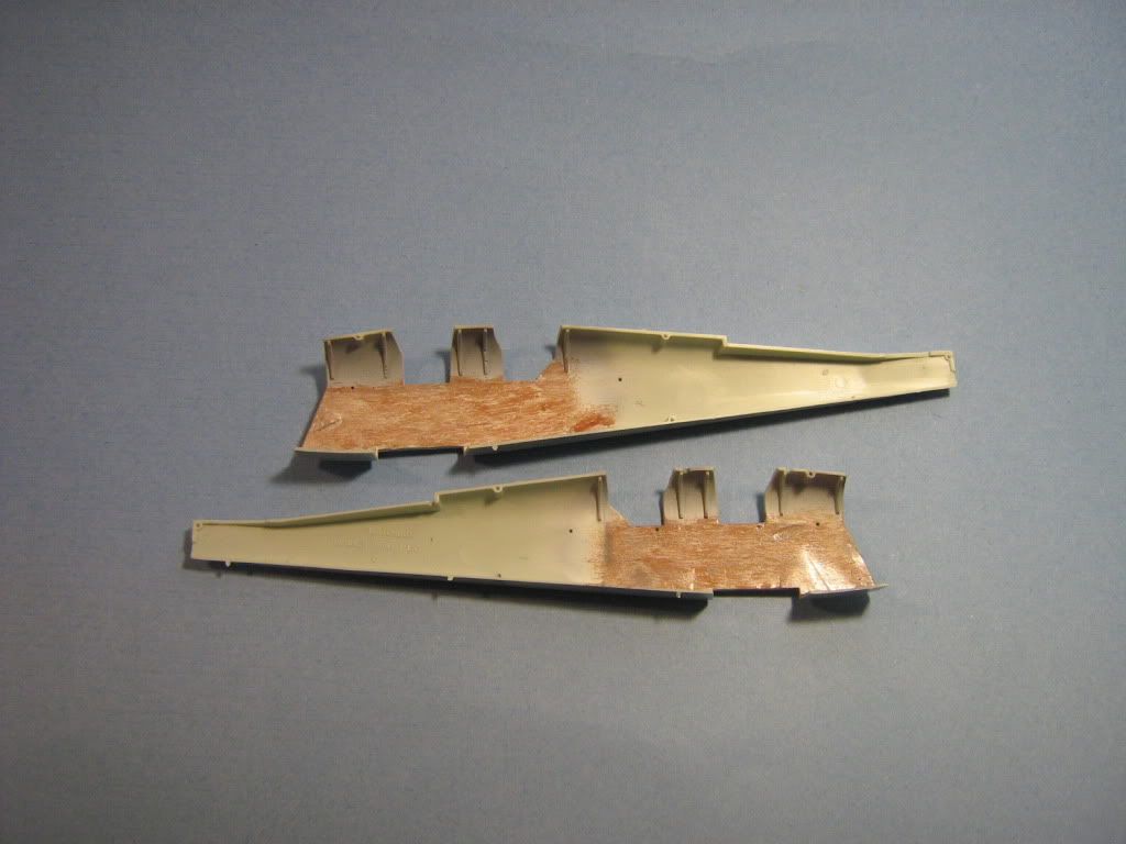

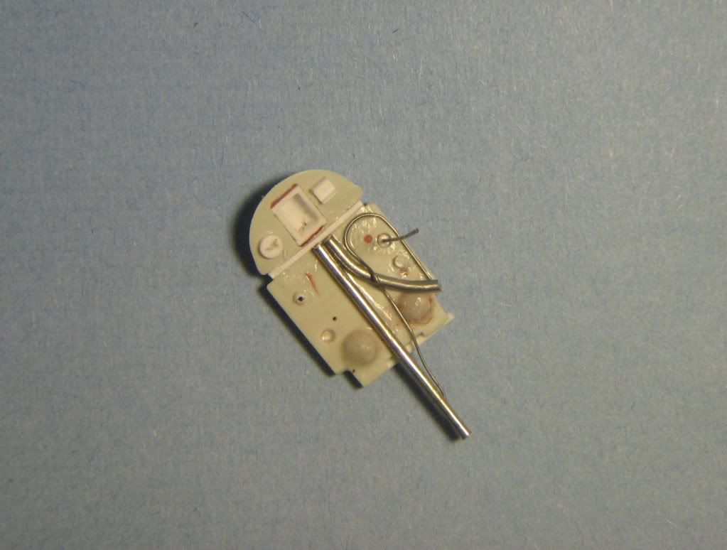

hacker Posted April 25, 2011 Author Share Posted April 25, 2011 Well finally got some work into the Tigermoth. Here is what l got to post so far here are the two side tubular framing detailed and ready to paint l managed to get some firewall pictures without the engine in the way. pretty sparse but never the less better then the kit version. The two bulges for the rudders inside the cockpit was made from ends of 1/72 WWII 500lb bombs cut off as close the top as possible and sanded to height. Still some detailing to do after painting l put a shot of Floquil grey primer on everything. The black dots on the cockpit floor is where l made rivits and it is black marker in the hopes when l spray the british interior green on it it will show darker The insides of the fuselage is fabic on the sides and wood on the top. According what l found out it is Egyptian Cotton linen so it was white. Then there was 7 coats of red primer on the outside and it bled through giving the effect l tried to duplicate. Once that dries l will mask it off and spray the tops the interior green along with the rest of the parts. That maybe at a later date that is all for now later 2 Link to comment Share on other sites More sharing options...

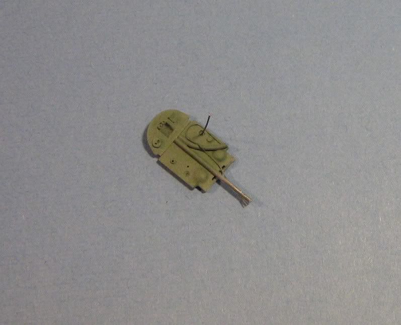

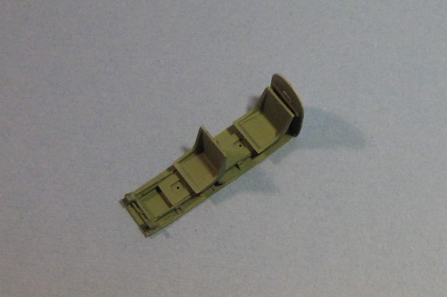

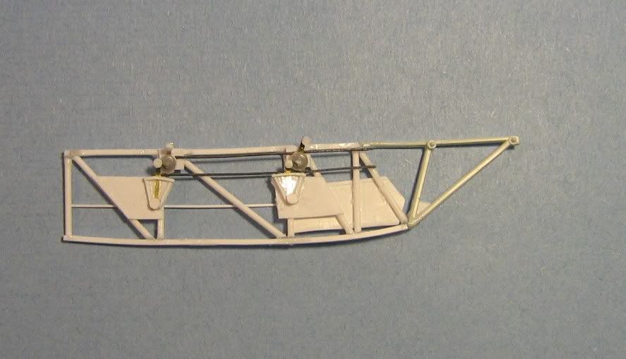

hacker Posted April 26, 2011 Author Share Posted April 26, 2011 You're making great progress. The interior is a massive improvement over the basic kit one.Keep up the good work. Thanks for the vote of confidence. l got up early this morning and did some airbrushing before the wife came home from work. l managed to get the interior green on the parts. Here how they look at the moment l put the side framing in to see how it looks. It looks as it should even though l don't have the floor in as of yet Now that the airbrushing is down for now l can do a little brush painting to detail it and do some dry brushing on the other parts Hopefully l will have more to post later. Once this is done it is on to the engine later 1 Link to comment Share on other sites More sharing options...

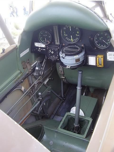

k5054nz Posted April 26, 2011 Share Posted April 26, 2011 This is fascinating and very educational to watch as you progress, Hacker. I have often admired others' DH.82 models and having had both maintenance and flight experience in/on various Tigers, combined with the re-release of this kit, has made me seriously consider sacrificing the credit card once more. What references are you using fir the interior? And do you have a specific aircraft in mind to model? 1 Link to comment Share on other sites More sharing options...
hacker Posted April 26, 2011 Author Share Posted April 26, 2011 What references are you using fir the interior? And do you have a specific aircraft in mind to model? l got my information from various sources. l don't have the Haynes Tigermoth owner's manual but l got enough info gathered over a period of time to help. As for a specific aircraft l really don't know. At first for something different l was going to do a RCN Tigermoth but info is scarce as rocking horse poop. May go with a silver RAF post war scheme or go with war period scheme of yellow and camo 1 Link to comment Share on other sites More sharing options...
