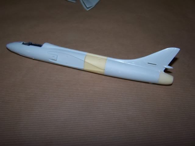

AnonymousAA72 Posted January 26, 2008 Share Posted January 26, 2008 If your going to back date the wings you will also need to change the F6 engine pieces, as their is more of a slope up to the jet pipe. I am researching hunters at the moment an read about the difference in shape the other day. Thanks for that Steven, but I think that you're preaching to the converted (So to speak!!). We've had many a lively debate on here (and a few other websites) over the last few years on the differences between the Avon 100 (and Sapphire) powered Hunters as opposed to the 200 series! As a matter of interest here's an F4 conversion I started last year (and not managed to finish - yet!!) The starboard wing leading edge has been converted by using the kits L.E. and hacking off the surplus plastic.... The 100 series tail pipe (and centre section) are from Model Alliance... Link to comment Share on other sites More sharing options...
