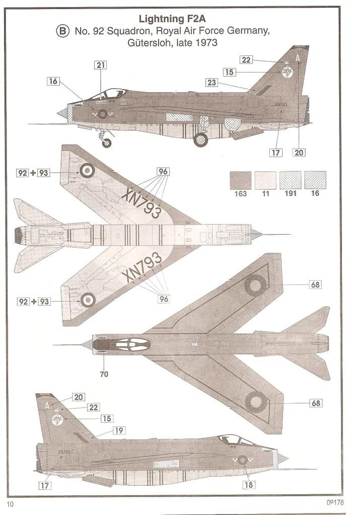

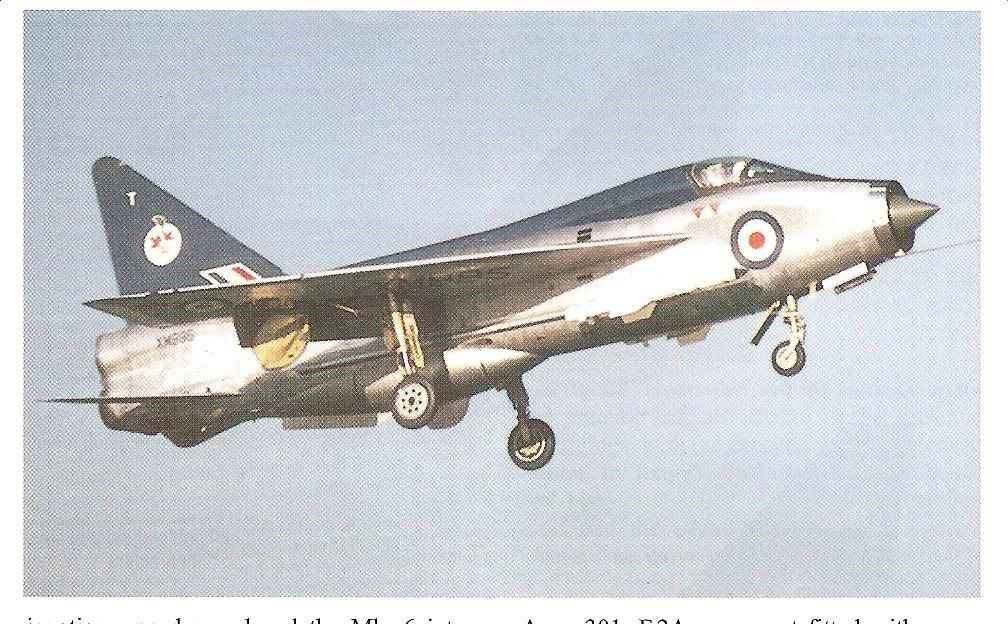

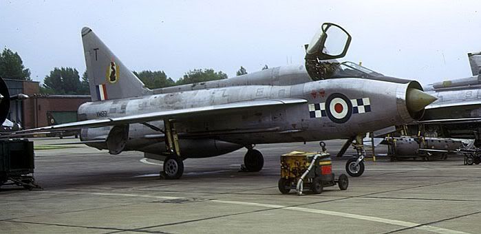

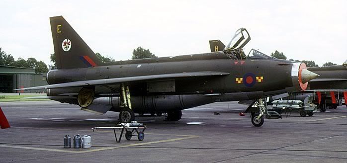

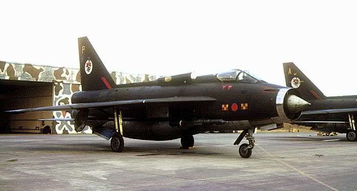

Derek Bradshaw Posted December 22, 2007 Share Posted December 22, 2007 (edited) John/Bex: No problems Here are some additional 92 Sqn F.2A pictures (with full credits to the Vertical Reality website for their use here): Careful study of these pictures appear to show some form of very lightly anodised gold colour on the u/c legs and inner doors (I think that someone else pointed this out earlier as well). The above Airfix 1/48 Lightning F.2A colour scheme guide for a 92 Sqn aircraft. The colour call out for the undercarriage is Humbrol 16, which is gold. My suggestion, and it is only a suggestion, would be to paint the undercarriage aluminium silver as standard, and once fully dried, give the whole u/c area a coat of two of Johnson's clear acrylic floor polish. Once this is dry, apply a couple of coats of Tamiya tranparent yellow paint. This should give you an effect very similar to the photographs (alternatively, you could simply mix equal parts of gold and silver together, in order to achieve a similar, albeit less sophisticated effect!). Unless someone involved with these aircraft at Squadron level can definitively tell us all what the colour actually is, I suspect very few people would have grounds to snag you on this issue. HTH Derek Edited December 22, 2007 by Derek Bradshaw Link to comment Share on other sites More sharing options...
