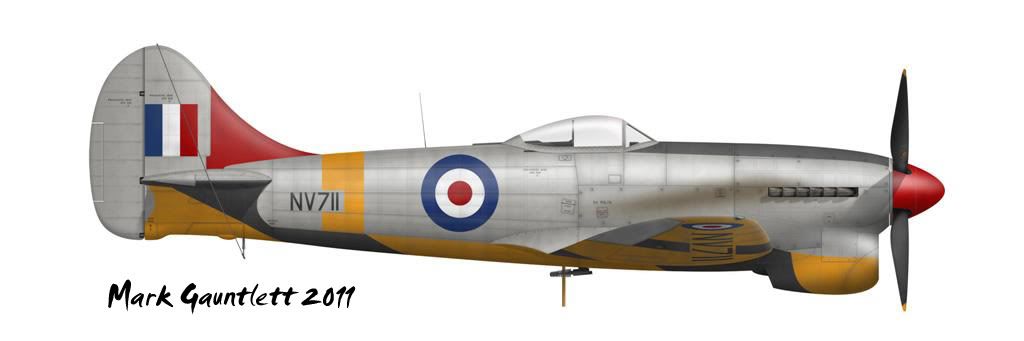

StephenMG Posted September 27, 2011 Share Posted September 27, 2011 (edited) Hello Mark, Thanks for that information regarding the spring.I didn't like to suggest that as a possibility,but it makes sense.I think that we discussed that possibility back in 1956,but it was a long time ago.You have added more information for other would-be TT5 modellers,so between us,we may unravel the mystery.Somebody out there may have close-up photographs, Bill. It's an interesting topic this because target tugs tend to get forgotten about (not 'sexy' enough I suppose!) and so details are hard to come by. I've recently finished some 4-view artwork of a TT.5 (amongst other marks) for a forthcoming Tempest book and had trouble determining details then. Consequently my drawing captures the overall look of the banner attachment but not much detail. I based it mostly on one photo which shows the thing fairly well but, again, not much of the detail. I'll see if I can find it again and post a link. I'd be very interested to see your drawings as well if it's not too much trouble? Mark Edit: Found it, have a look at this photo which shows the spring fairly well but no other detail sadly. Ignore the comments about the "skirts" though - they are clearly the lowered flaps! Edited September 27, 2011 by StephenMG Link to comment Share on other sites More sharing options...
baldeagle Posted September 27, 2011 Share Posted September 27, 2011 It's an interesting topic this because target tugs tend to get forgotten about (not 'sexy' enough I suppose!) and so details are hard to come by. I've recently finished some 4-view artwork of a TT.5 (amongst other marks) for a forthcoming Tempest book and had trouble determining details then. Consequently my drawing captures the overall look of the banner attachment but not much detail. I based it mostly on one photo which shows the thing fairly well but, again, not much of the detail. I'll see if I can find it again and post a link.I'd be very interested to see your drawings as well if it's not too much trouble? Mark Edit: Found it, have a look at this photo which shows the spring fairly well but no other detail sadly. Ignore the comments about the "skirts" though - they are clearly the lowered flaps! Link to comment Share on other sites More sharing options...

StephenMG Posted September 27, 2011 Share Posted September 27, 2011 (edited) Wonderful stuff baldeagle! A couple of comments which might help, 1. The panel at 8 normally says "CHOP HERE FOR EMERGENCY RESCUE" which accounts for some of the illegible lettering you mention. Not sure about the top line though. 2. Both panels in 12 should read "AILERON GEAR" 3. The rear towing gear in 13 acts a support and guide for the guard cable around the tailplane, fin and rear fuselage. The towing cable does not pass through it as I think you mentioned previously. This is a reduced version of one of my book illustrations (albeit of a Pembrey-based aircraft) which might be of interest. Mark Edited September 27, 2011 by StephenMG Link to comment Share on other sites More sharing options...
baldeagle Posted September 27, 2011 Share Posted September 27, 2011 Hello Mark, T hanks for the comments regarding the Tempest details,also for filling in the blanks regarding the stencil details.I've long wondered what the words could be! I must apologise for the messy way that the information presented on the site.For some reason,the size of the drawings and key went over the top.The information is all there,however and I hope that you will find it useful.Your Tempest drawing is new to me and is the first that I have seen to nearly get the towing shackle right.As you have undoubtedly seen from my sketches,the front end was slightly different on NV723. It's possible,but unlikely,that more than one design existed,of course.In what book was your Pembrey "Tempest" drawing published?-Is it still in print, so that I can try to find a copy? It's sad to look at those pictures of me in the aircraft.I was only eighteen and still had a good head of hair! Regards, Bill Link to comment Share on other sites More sharing options...
