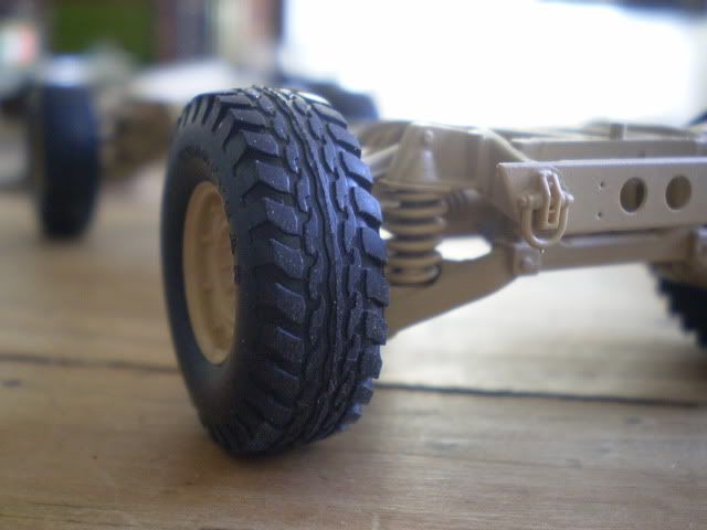

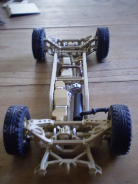

bought this on sunday (always liked the tamiya models) everything has had one coat of paint/spray and needs touching up
chassis assembled and painted (sorry for poor pic)
Posted Image
i really like the tyres,im thinking of 'weighting' them
Posted Image

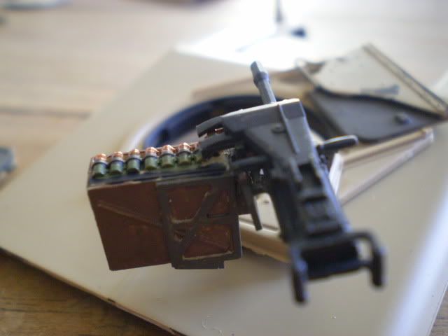

grenade launcher
Posted Image

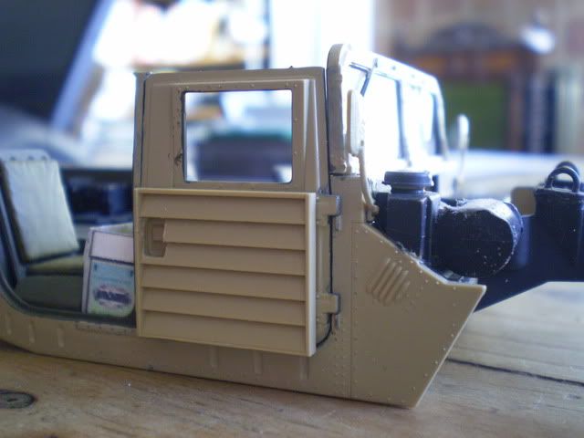

added CIP panels to the doors.CIP panels are from the tamiya modern US kit the door handle holes were a pain
Posted Image

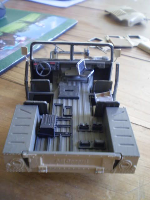

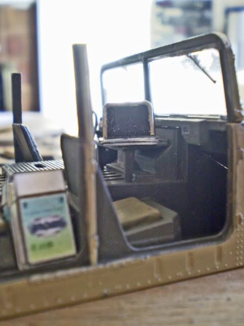

interior painted i scratch built the laptop though the keyboard is a challenge!! and the bottled water box,thinking of using left clear sprue for bottles
Posted Image
Posted Image

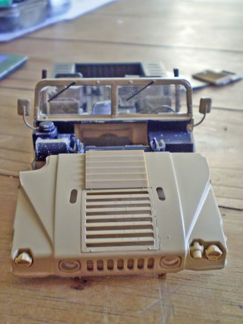

the hood needs some work to make it fit properly,the recess on the left needs filing and the engine part also requires some filing,also the lights inside the hood need cutting away as this also cause's the bad fit of the hood
Posted Image
dry fitted
Posted Image

Nice work. The laptop sure looks like Panasonic Toughbook. I brought one of these kits after reading the Marcus Nicholls build in TMMI issue 100.
The weighted look on tyre explained in this issue of TMMI.
This build up shows a styrene cube glued to wheel rim and small drop of thick cyno applied to cube and passed into the tyre. It says the inner face of tyre adheres to the cube, pulling the tread inwards. The chassis was then weighted with paint jars allowing the glue to cure. I am not sure how good this will go. If feel its lot better to try than buy those expensive aftermarket goodies.

sling seat added for the gunner
Posted Image
Posted Image
