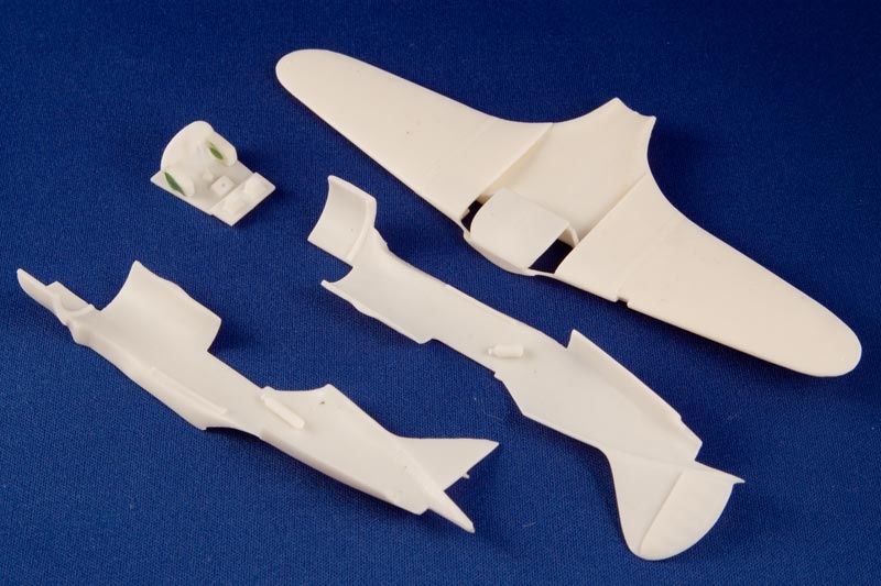

In common with most kits of low-wing monoplanes, the lower wing is moulded in one piece to which the upper wing halves must be fixed. There is a raised flaw on the inside surface of one of the upper wing halves, but this is easy to remove. This is a good time to tape everything together for a test fit (a good idea with any kit, but particularly so with limited run kits). I found there was a slight gap in the join between the upper wings and the fuselage, cause by the span of the lower wing being a little too wide. I reduced the gap by sanding down the tips of the lower wing a little to make the span shorter. I then glued the fuselage halves together, followed by the one-piece tail plane. This part fits well and requires only the slightest dab of filler.

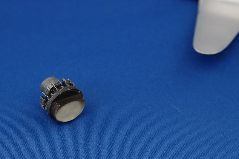

The engine itself is beautifully cast. I sprayed it with Alclad Black Primer and then drybrushed it with Citadel metallic acrylics to show off the detail. It fits into the fuselage really well, although I had to cut a chunk out of the pouring stub as it interfered with the wing spar

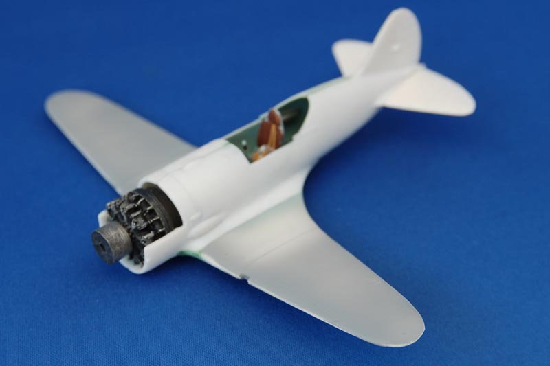

The front of the fuselage is comprised of the upper and frontal engine cowling. These fit well and required little filler. Those wishing to show off the resin engine will need to cut the upper cowling in order to pose it open. The airscrew fits quite tightly into its hub; so much so that I didn’t need to use any glue to fix the two parts together. I painted the airscrew black, but on checking references I think perhaps it should be a natural metal colour. Ah well, it can always be put right later!

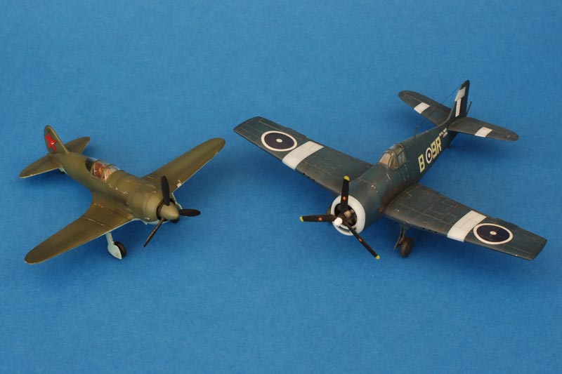

The diminutive size of the Polikarpov I-185 can be seen in this picture, posed next to a Revell Hellcat.

Looks more like one of the GeeBee racers, didn't realize just how small it was.
