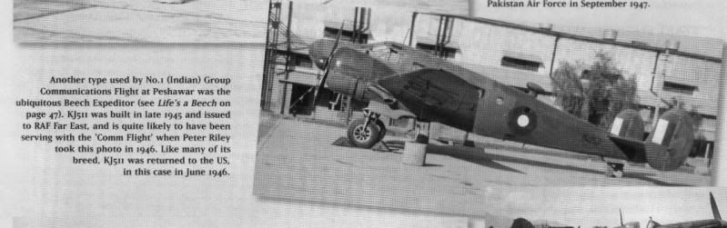

airjiml2 Posted June 30, 2010 Share Posted June 30, 2010 Another twist - I hope that we can rule out US equivalent colours? (Yes, because as LL aircraft, these would have been delivered in USAAF bare metal.) Yes you can rule out U.S. equivalent colours, but only because they are two tone upper surfaces. However, I don't think we can definitively state that all Expeditors were delivered in bare metal. Some of the HB serial Expeditors diverted to the BCATP in Canada were natural metal and some were OD over NG. In fact I would guess that HD775 is OD over NG. Jim Link to comment Share on other sites More sharing options...
timbo33 Posted June 30, 2010 Share Posted June 30, 2010 Could this show TSS over Azure Blue? I think it could, although we are again in the region of interpreting white as light blue on somewhat less-than-firm ground. If you believe it has to be blue, then sure, but it can't be proven not-white from the photo. The difference in contrasts from KJ511 are considerable. .....and there was me assuming it was DE/DG/Sky....... Link to comment Share on other sites More sharing options...
