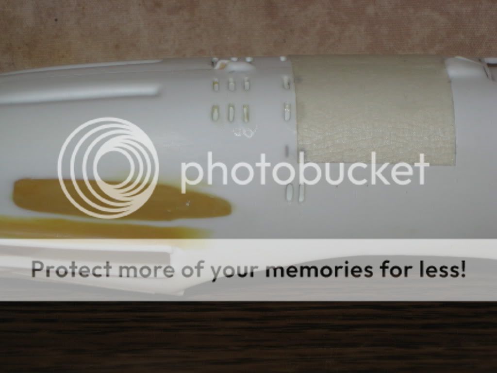

How did you get those cowling vents cut out so precisely? They look great.

LOL yeah I know another Macchi,but I tossed a coin to decide whether it was going to be a Macchi or Fiat G.50 build.Guess the G.50 will wait awhile longer.As for the cowling vents I ploted them out with tape first then used a 1 mm. dia. drill bit to drill them out. After that it was simply clean the cuts up with a knife and a round file.The photo of the vents was the second run,the opposite side of the fuselage are not as neat.They're going to need a little reworking to look right.It's a good thing the fuselage shell is nice and thick.

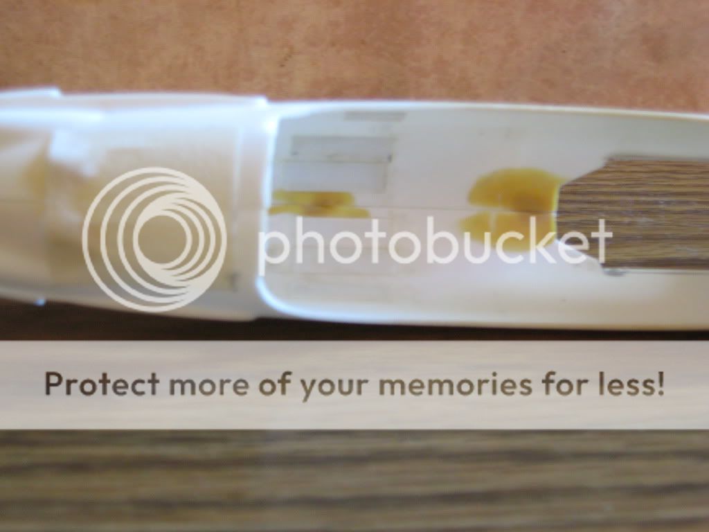

This first photo is of the fuselage halves stuffed with Tamiya Epoxy Putty. The putty will serve to act as a backup for reshaping the Macchi hump and eliminating some misplaced/incorrect details on the fuselage.Luckily the fuselages general outline isn't too far off,however most if not all the nose sections vent and scoops will need replacing.
Posted Image
After allowing the putty to set and dry overnight I've begun the reshaping of the hump.Still not totally finished at this point,as I believe the final reshaping will require the fuselage halves to be joined.

Posted Image
Posted Image
These two photos show how I closed off the cowling vents and the end results.This was by far the least time consuming as well as the easiest progress made all week.

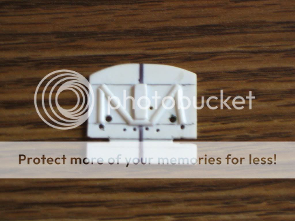

The forward bulkhead to enclose the engine bay as well as reinforce the wing to fuselage join.

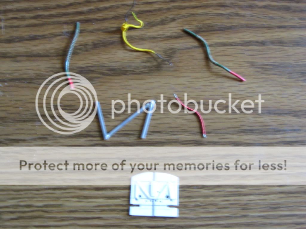

The final photos for today.Just a little bit of the pipes and tubing to be installed in the engine bay later on.
