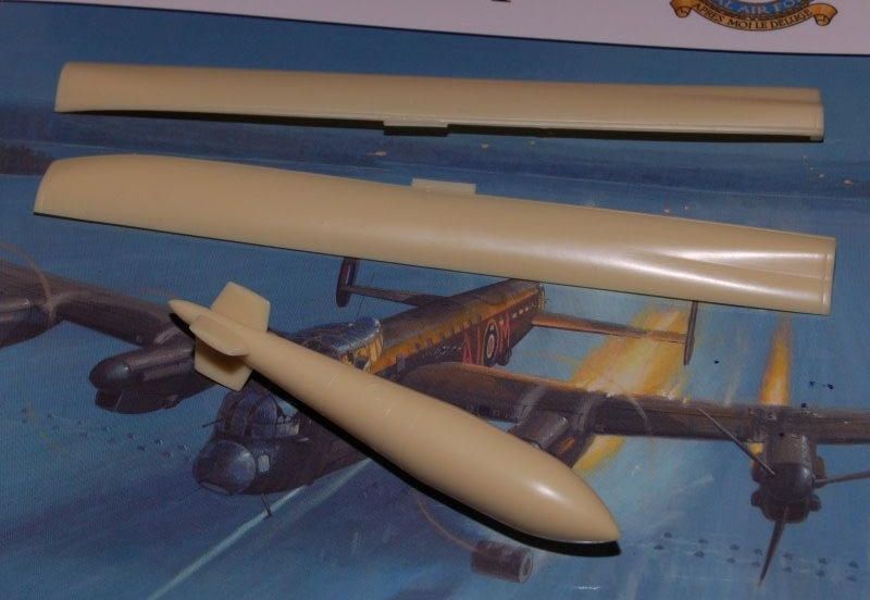

Not much to it I reckon, these are the extra sprues that come with the kit.
DSCF2851
& a close up of the bomb, bomb bay liner & nose turret fairing.
DSCF2853
The kit fuselage does not have the top turret cut out either. Sing out if you want any more photos or PM me an email addy if you want scans of the destructions. ;)

So on the real aircraft, was it a liner to the bomb bay as well? I had thought it was more or less just the removal of the bay doors.
Share this post
Link to post
Yes, there was an aerodynamic fairing front and rear for the bomb bay.
Under the bomb, however, it'd be the normal bomb bay "roof", correct?
Sort of. See here for an image of the bomb bay mods, although I think it shows the smaller tallboy being carried.
I'd wondered that too, but Harry's photo shows that it did have a full length cover, though the kit part is simplifies, there are obviously bomb steadies & some sort of framing/channel  where the bomb steadies fix. Not too had to do with some plastic card & milliput. The bomb shackle, like a ginormous bike chain might be harder to replicate likewise the bomb but doable, luckily there's lots of photos on the net. Let's know f you want measurements for the bomb.
